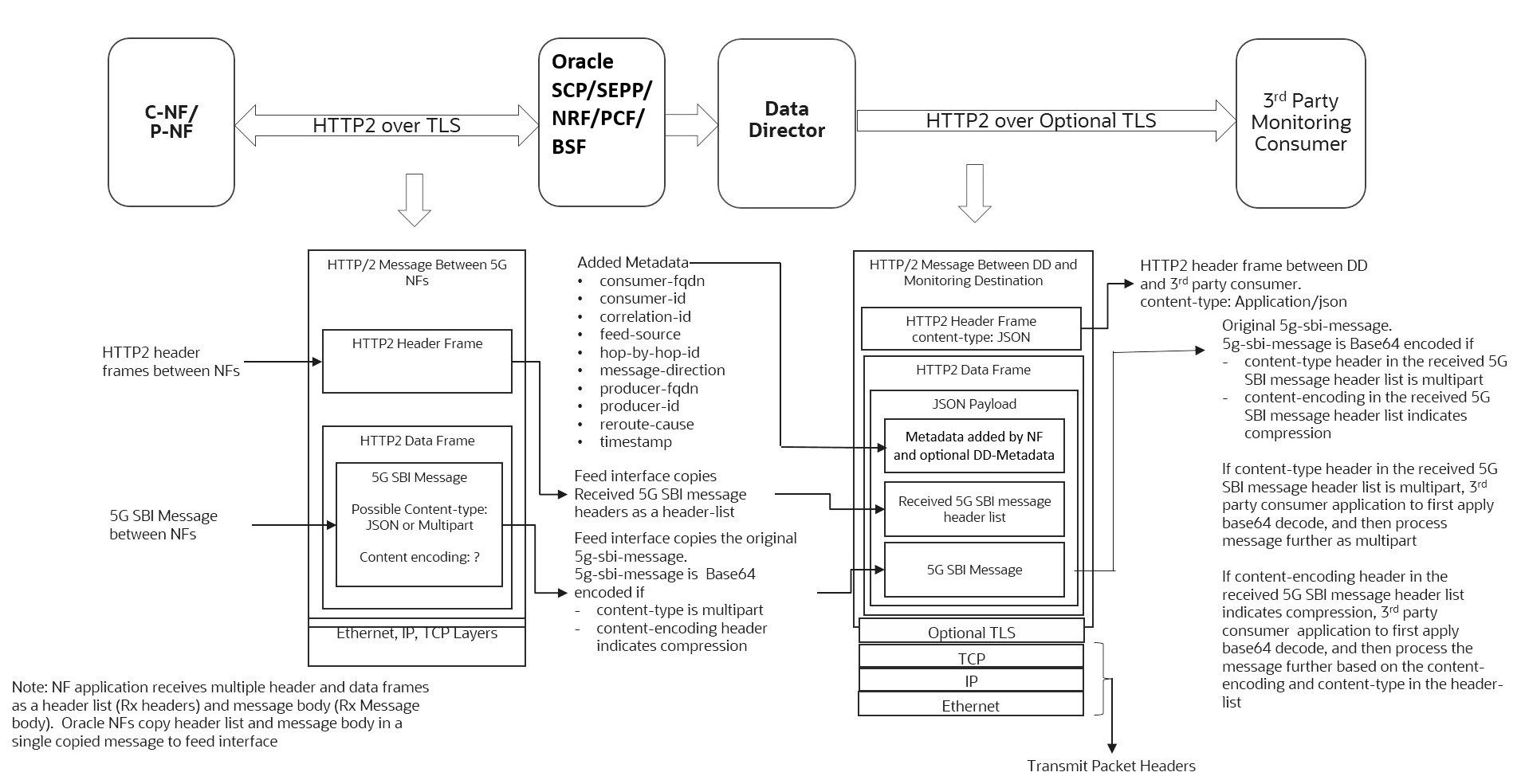

HTTP2 Message Format
Data Director supports HTTP2 feed for forwarding from Data Director to third-party monitoring consumer applications. 5G monitoring data is forwarded to third-party monitoring consumer using HTTP2 POST requests. The following components are delivered as JSON payload in the HTTP2 data frames:
- Original received 5G SBI message headers as a header-list.
- Original received 5g sbi data as 5g-sbi-message
- Metadata-list added by NF
The 5g-sbi-message forwarded to third-party consumer application is Base64 encoded if:
- The content-type header in the received 5G SBI message header list is multipart
Or
- The content-encoding in the received 5G SBI message header list indicates compression
If the "content-type" header in the received 5G SBI message header list is labeled as "multipart," the third-party consumer application performs an initial base64 decode. Subsequently, the application proceeds to process the message as multipart content.
When the "content-encoding" header in the received 5G SBI message header list shows compression, the third-party consumer application first applies base64 decode. Then, it processes the message further based on the content-encoding and content-type in the header list.

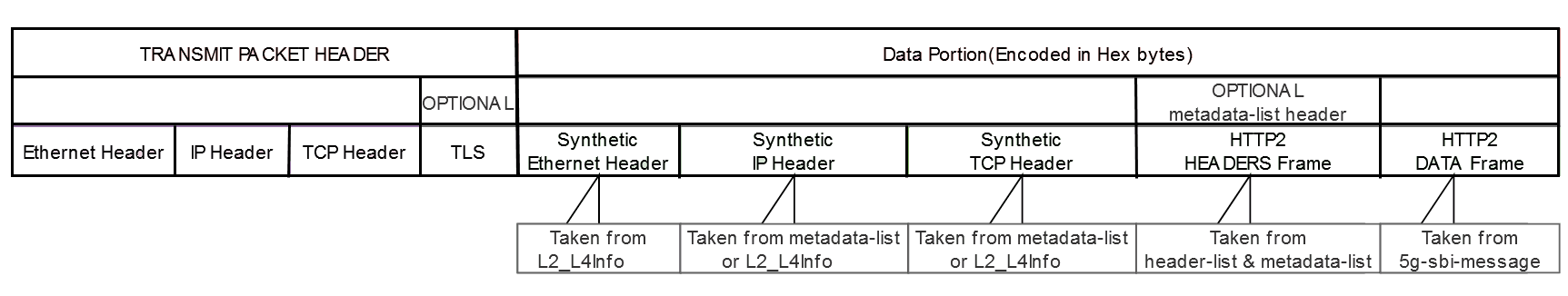

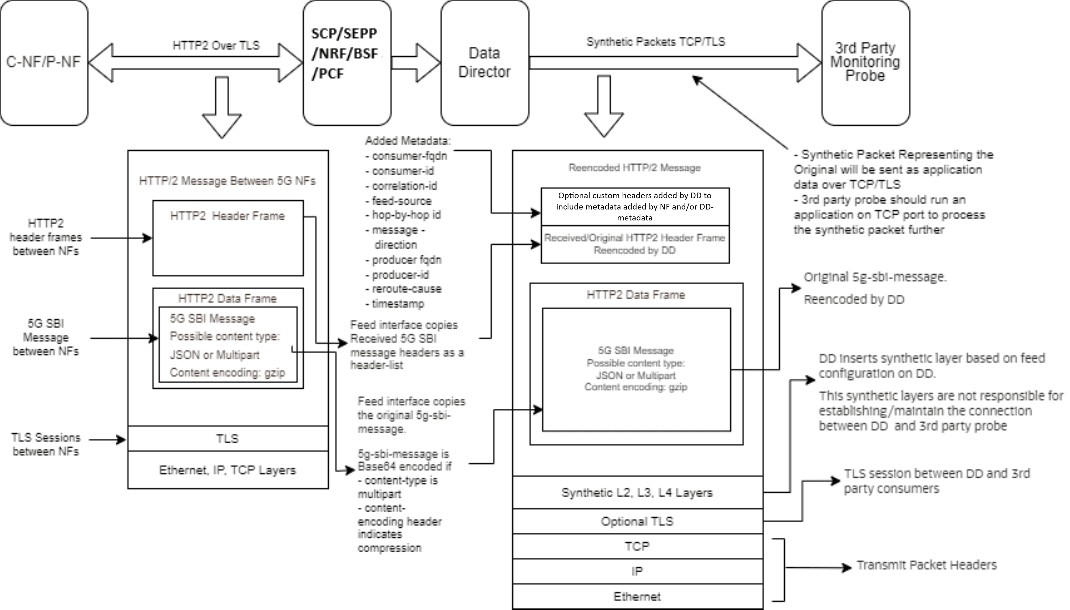

Synthetic Packet Message Format
OCNADD converts incoming JSON data into network transfer wire format and sends the converted packets to the third-party monitoring applications in a secure manner. The third-party probe feeds the synthetic packets to the internal monitoring applications. The feature helps third-party vendors to eliminate the need of creating additional applications to receive JSON data and converting the data into probe compatible format, thereby saving critical compute resources and associated costs.

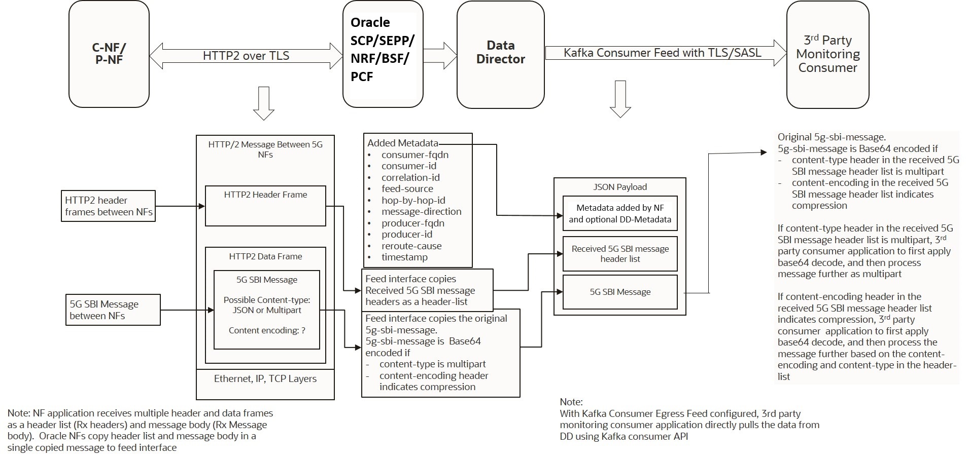

Kafka Consumer Egress Feed Message Format
OCNADD supports the external Kafka consumer applications using the external Kafka Feeds. This enables third-party consumer applications to directly consume data from the Data Director Kafka topic, eliminating the need for any egress adapter.
Clients need to be authenticated through either SASL or SSL (mTLS) for authorization by Kafka. As a result, enabling external Kafka feed support requires specific settings to be activated within the Kafka broker. This ensures mandatory authentication of Kafka clients by the Kafka service.
OCNADD only allows authorized and authenticated third-party applications to use the Data Director Kafka service. Application authorization is handled using the KAFKA ACL (Access Control List) functionality. Access control for the external feed is established during Kafka feed creation. Presently, third-party applications are exclusively allowed to READ from a specific topic using a designated consumer group.
3.2.2.2 Third-Party Feed Format
Third-Party HTTP2 Feed Format
A third-party HTTP2 feed contains the following components:
Figure 3-1 Third-Party HTTP2 Feed Format
Following TLS options are supported:
- TLSv1.2 (minimum) with oracle approved TLS Ciphers
- TLSv1.2 with Static Key Cipher support (TLS_RSA_WITH_AES_128_GCM_SHA256)
- No TLS (H2C)
Third-Party Synthetic Feed Format
A third-party synthetic feed contains the following components:

Following is an example for the JSON data without optional dd-metadata-list:
"version": "1.0.0",
"metadata-list": {
"timestamp": 1675675430883500606,
"correlation-id": "029d2736-1111-92c8",
"consumer-id": "b159694e-8138-4826-bde2-ed6d82571b26",
"producer-id": "adb514c8-b9fa-450a-bda2-4bd73140b974",
"consumer-fqdn": "AUSF.d5g.oracle.com",
"producer-fqdn": "UDM.d5g.oracle.com",
"message-direction": "TxRequest",
"feed-source": {
"nf-type": "SCP",
"nf-instance-id": "02043348-a5a4-41bf-84c2-945881b22ab2",
"nf-fqdn": "SCP.d5g.oracle.com"
"header-list": {
":scheme": "http",
":method": "PUT",
":authority": "10.100.101.100:443",
":path": "/nnrf-nfm/v1/nf-instances/029d2736-1111-4c48-92c8",
"x-http2-scheme": "http",
"accept": "application/json",
"content-type": "application/json",
"user-agent": "AUSF-029d2736-1111-4c48-92c8",
"via": "UDM.d5g.oracle.com",
"content-length": "1200"
"5g-sbi-message": {
"nfInstanceId": "029d2736-1111-4c48-92c8-{{.nfID}}",
"nfType": "AUSF",
"nfStatus": "REGISTERED",
"plmnList": [
"mcc": "130",
"mnc": "52"
"fqdn": "AUSF.d5g.oracle.com",
"interPlmnFqdn": "AUSF-d5g.oracle.com",
"ipv4Addresses": [
"192.168.2.100"
"ipv6Addresses": [
"2001:0db8:85a3:0000:0000:8a2e:0370:7334"
"capacity": 2000,
"load": 0,
"locality": "US_East",
"ausfInfo": {
"groupId": "ausfgroup",
"supiRanges": [
"start": "987654000000000",
"end": "987654000049999"
"nfServices": [
"serviceInstanceId": "029d2736-1112-4c48-92c8-{{.nfID}}",
"serviceName": "nausf-auth",
"versions": [
"apiVersionInUri": "v1",
"apiFullVersion": "1.0.0",
"expiry": "2018-12-03T18:55:08.871+0000"
"nfServiceStatus": "REGISTERED",
"scheme": "http",
"apiPrefix": "",
"defaultNotificationSubscriptions": [
"notificationType": "LOCATION_NOTIFICATION",
"callbackUri": "http://somehost.oracle.com/callback-uri"
"allowedPlmns": [
"mcc": "130",
"mnc": "52"
"allowedNfTypes": [
"NRF",
"AMF",
"UDR",
"AUSF",
"NSSF",
"UDM"
"capacity": 500,
"load": 0,
"supportedFeatures": "2"
Example for JSON Data With Optional dd-metadata-list
Following is an example for the JSON data with optional dd-metadata-list:
"version": "1.0.0",
"metadata-list": {
"message-direction": "RxRequest",
"feed-source": {
"nf-type": "SCP",
"header-list": {
":scheme": "http",
":method": "PUT",
"dd-metadata-list": {
"method": "PUT",
"ingress-authority": "10.100.101.100:443",
"path": "/nnrf-nfm/v1/nf-instances/029d2736-1111-4c48-92c8",
"consumer-via": "UDM.d5g.oracle.com"
"5g-sbi-message": {
"nfType": "AUSF",
"plmnList": [
"mcc": "130",
"mnc": "52"
"ipv4Addresses": [
"192.168.2.100"
"ipv6Addresses": [
"capacity": 2000,
"load": 0,
"ausfInfo": {
"supiRanges": [
"nfServices": [
"versions": [
"scheme": "http",
"apiPrefix": "",
"allowedPlmns": [
"mcc": "130",
"mnc": "52"
"allowedNfTypes": [
"NRF",
"AMF",
"UDR",
"AUSF",
"NSSF",
"UDM"
"capacity": 500,
"load": 0,

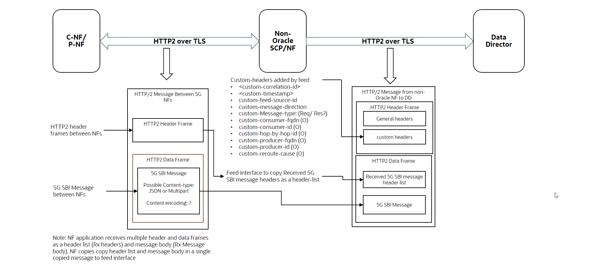

3.3 Inbound Protocols for Non-Oracle NFs
Data Director currently supports HTTP2 Ingress Feed type, over which it received the 5GSBI messages and metadata added by the Non-Oracle NFs.
Non-Oracle NFs should be sending mirrored copy of actual HTTP2 request or response message (HTTP Header + Body) in the body of HTTP2 messages using POST method. The metadata fields from Non-Oracle NFs can be present either in "MESSAGE_HEADER" or "MESSAGE_BODY".
3.3.1 Data Transformation & Metadata Mapping
The message transformation functionality will allow data conversion and mapping from Non-Oracle NF to Oracle NF data which will be consumed by DD internal services for data processing. The conversion framework will provide capabilities to map the following metadata fields with OCNADD for processing.
The metadata fields from Non-Oracle NFs can be present either in "MESSAGE_HEADER" (as custom headers) or "MESSAGE_BODY". Based on the value of the parameter "metadataLocation" while creating configuration, the ingress adapter will take the attributes and perform the transformation of these fields to the Oracle Data Director format. If metadata is present in message body, then additional fields are required to be configured.
Metadata Mapping
Table 3-12 Metadata Mapping
| Oracle Attribute Name | Ingress Attribute Name | Presence | Static Value(Default) | Description |
| correlation-id | <Ingress-attribute-name> | M | NA | Correlation id is mandatory to correlate all mirrored request and response messages of a transaction. If custom correlation id is not provided DD will attempt to retrieve this from 3gpp-Sbi-Correlation-Info header if available. It must be present in either of the two attributes. |
| timestamp | <Ingress-attribute-name> | M | NA | This property defines the timestamp of the request when it is initiated. |
| message-direction | <Ingress Attribute name(list)> | M | NA |
It consists of both the messages direction (ingress or egress) and the message type (Request or Response). The non-Oracle feeds may send messages direction and message type in different custom headers. Oracle ingress adapter will combine both and map it to the supported OracleNfFeedDto. |
| consumer-fqdn | <Ingress Attribute name> | O | NA | The consumer fqdn will be mapped with the received value of configured ingress attribute name in custom headers. If the value is not present, then it will be skipped. |
| consumer-id | <Ingress Attribute name> | O | NA | The consumer id will be mapped with the received value of configured ingress attribute name in custom headers. If the value is not present, then it will be skipped. |
| hop-by-hop-id | <Ingress Attribute name> | O | NA | The hop by hop id will be mapped with the received value of configured ingress attribute name in custom headers. If the value is not present, then it will be skipped. |
| producer-fqdn | <Ingress Attribute name> | O | NA | The producer fqdn will be mapped with the received value of configured ingress attribute name in custom headers. If the value is not present, then it will be skipped. |
| producer-id | <Ingress Attribute name> | O | NA | The producer id will be mapped with the received value of configured ingress attribute name in custom headers. If the value is not present, then it will be skipped. |
| reroute-cause | <Ingress Attribute name> | O | NA | The reroute cause will be mapped with the received value of configured ingress attribute name in custom headers. If the value is not present, then it will be skipped. |
| feed-source-nf-type | <Ingress Attribute name>, Use feed-source Host Address mapping | M | <default-nf-type> |
The "nf type" for OracleNfFeedDto will be mapped from the ingress attribute name which is provided during feed creation. However, if attribute name is not present in the custom headers, then feed-source host IP address will be taken from "custom-forward-for" or "x-forwarded-for" header if present and a look up will be performed from feed source host address mapping to get the nf-type. If the x-forwarded-for header is not present then Source IP of the request will be used. If the source IP is not present in the feed source host address map, then default value will be used for mapping. However, it is recommended to use default value when only one NF is producing data. |
| feed-source-nf-instance-id | <Ingress Attribute name>, Use feed-source Host Address mapping | C | <default-nf-instance-id> |
The "nf instance id" for OracleNfFeedDto will be mapped from the ingress attribute name which is provided during feed creation. However, if attribute name is not present in the custom headers, then feed-source host IP address will be taken from "custom-forward-for" or "x-forwarded-for" header if present and a look up will be performed from feed source host address mapping to get the nf-instance-id. If the x-forwarded-for header is not present then Source IP of the request will be used. If the source IP is not present in the feed source host address map, then default value will be used for mapping. However, it is recommended to use default value when only one NF is producing data. |
| feed-source-nf-fqdn | <Ingress Attribute name>, Use feed-source Host Address mapping | C | <default-nf-fqdn> |
The "nf instance fqdn" for OracleNfFeedDto will be mapped from the ingress attribute name which is provided during feed creation. However, if attribute name is not present in the custom headers, then feed-source host IP address will be taken from "custom-forward-for" or "x-forwarded-for" header if present and a look up will be performed from feed source host address mapping to get the nf-fqdn. If the x-forwarded-for header is not present then Source IP of the request will be used. If the source IP is not present in the feed source host address map, then default value will be used for mapping. However, it is recommended to use default value when only one NF is producing data. |
| feed-source-nf-pod-instance-id | <Ingress Attribute name> | O | <default-nf-pod-instance-id> |
The "nf pod instance id" for OracleNfFeedDto will be mapped from the ingress attribute name which is provided during feed creation. However, if attribute name is not present in the custom headers, then default value will be used for mapping. It is recommended to use default value when only one NF is producing data. |
