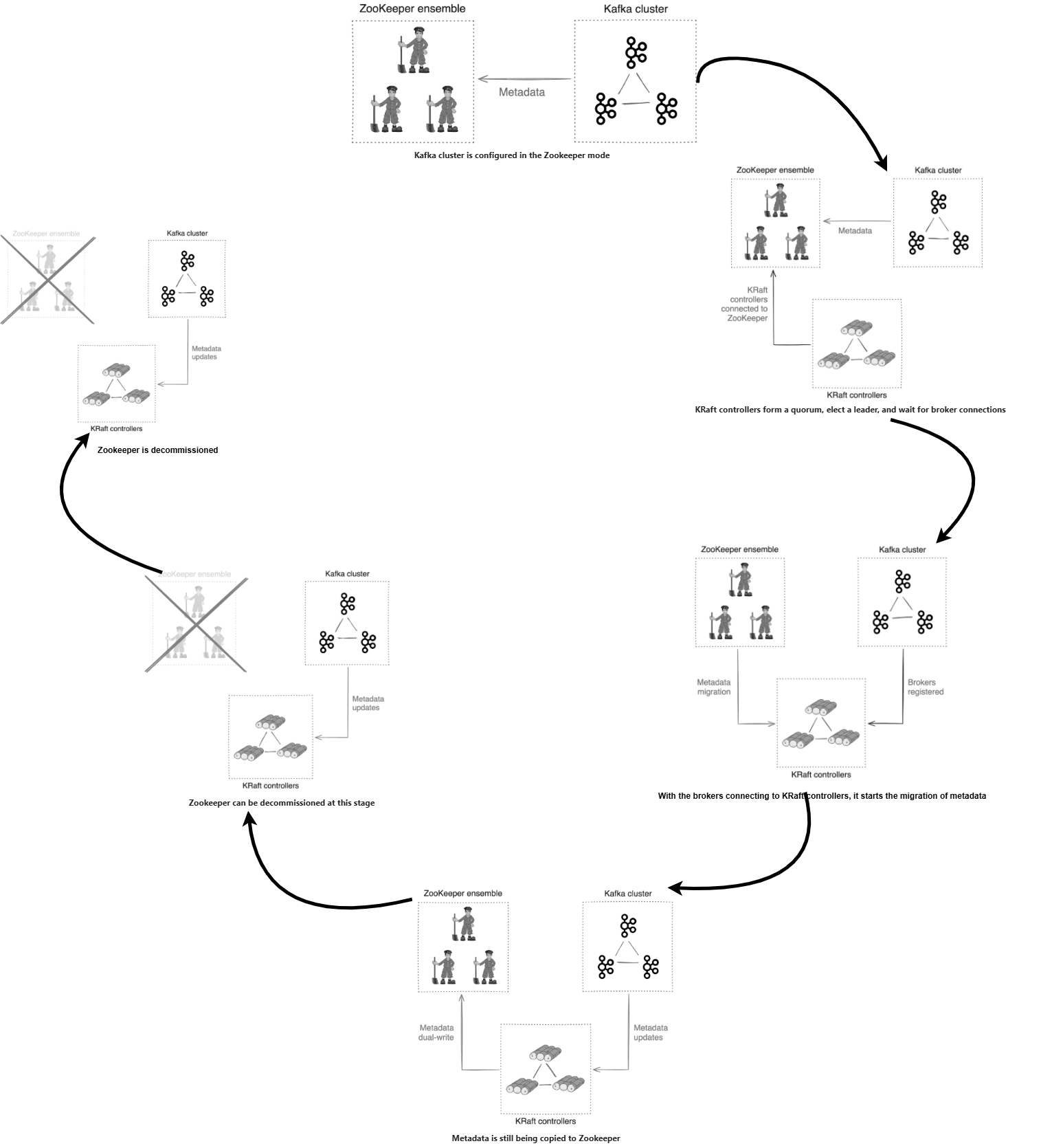

The following sections describes the procedure for Kafka Zookeeper to Kraft Migration.
Kafka cluster management using Zookeeper has already been deprecated and will be removed in an upcoming Kafka release. It is recommended to use the Kafka KRaft controller for cluster management and to migrate Zookeeper-based Kafka cluster deployments to KRaft-controlled deployments.
This section provides an overview of the migration flow and outlines the procedure to facilitate the migration of a Zookeeper-based Kafka cluster to a KRaft-controlled Kafka cluster in Data Director.
