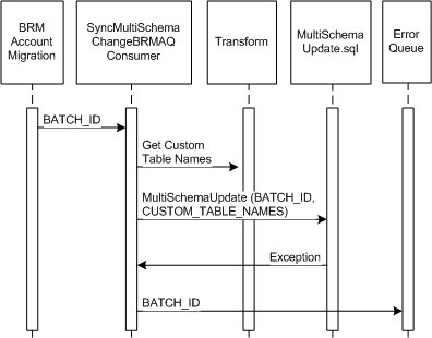

Synchronizing Cross-References for Migrated Accounts
When you migrate accounts across BRM schemas, the cross-references for the accounts are synchronized from BRM to Oracle AIA as follows:
  1. When you migrate accounts across BRM schemas, AMM populates a MIGRATED_OBJECTS_T cross-reference table in the primary BRM database with the batch ID, and old and new POIDs of all the objects that have been migrated successfully.
  2. When the BRM account migration is complete, an AccountInfoChange business event is generated and published to an Advanced Queue (AQ) database queue. The AccountInfoChange business event includes the batch ID and BRM object POIDs.
  3. Oracle AIA retrieves the AccountInfoChange business event from the AQ database queue and updates the information in the Oracle AIA database by calling the SyncMultiSchemaChangeBRMAQ consumer service.
  4. The SyncMultiSchemaChangeBRMAQ service reads the batch ID and BRM object POIDs from the AccountInfoChange business message from the AQ and passes the message to the SyncMultiSchemaChangeBRMRequester service.
  5. The SyncMultiSchemaChangeBRMRequester service does the following:
    1. Reads the AIAConfigurationProperties.xml file for a list of custom cross-reference tables. See Configuring Oracle AIA to Work with BRM in Multischema Environments for more information.
    2. Calls the MultiSchemaUpdate PLSQL procedure.
    3. Adds a message to the error queue if an error is found. See Handling Errors for more information.
  6. MultiSchemaUpdate PLSQL procedure updates the Oracle AIA cross-reference table by doing the following:
    1. Retrieves the batch ID, custom table and database link names from the BRMMultiSchemaConsumer service.
    2. Connects to MIGRATED_OBJECTS_T cross-reference table using a database link.
    3. Locates the old POID values and updates the new POID values in the AIA cross-reference table.
    4. Deletes the entries in MIGRATED_OBJECTS_T cross-reference table when Oracle AIA receives the data.
Table J-2 illustrates the flow when updating cross-references in a multischema migration.
Figure J-1 Updating Cross-Reference Data Sequence Diagram

The SyncMultiSchemaChangeBRMAQ consumer is a mediator-based service called by the BRM AQ after a multischema migration. It reads the BATCH_ID and BRM instance ID in the AccountInfoChange message from the AQ and passes it to the SyncMultiSchemaChangeBRMRequester service.
About the SyncMultiSchemaChangeBRMRequester Service
The SyncMultiSchemaChangeBRMRequester service is a BPEL service that accepts the AccountInfoChange message from the SyncMultiSchemaChangeBRMAQ consumer and invokes the MultiSchemaUpdate.sql process. It performs the following actions:
  1. Reads the AIAConfigurationProperties.xml file for a list of custom cross reference tables. See Configuring Oracle AIA to Work with BRM in Multischema Environments for more information.
  2. Invokes MultiSchemaUpdate.sql.
  3. Adds a message to the error queue if an error is found. See Handling Error Notifications for Order Lifecycle Management for more information.
About the MultiSchemaUpdate.sql Process
MultiSchemaUpdate.sql is a PLSQL process which is called by the BRMMultiConsumer service after a multischema migration to update the Oracle AIA cross reference table. It performs the following actions:
  1. Retrieves the BATCH_ID and CUSTOM_TABLE_NAMES.
  2. Connects to the BRM MIGRATED_OBJECTS_T cross-reference table using a database link.
  3. Locates the old POID values and updates the new POID values in the Oracle AIA cross reference table.
