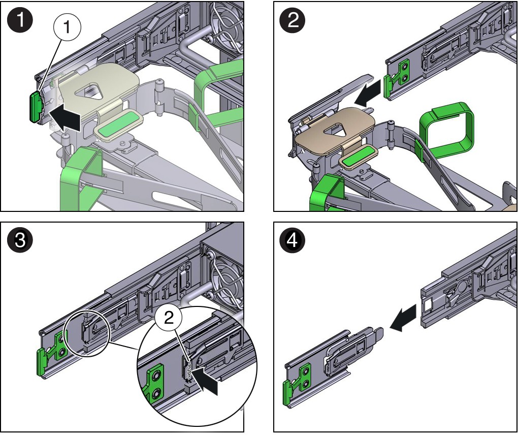

  4. To disconnect connector D:
    1. Press the green release tab (callout 1) on the slide-rail latching bracket toward the left and slide the connector D out of the left slide-rail [1 and 2].
      When you slide connector D out of the left slide-rail, the slide-rail latching bracket portion of the connector remains in place. You disconnect connector D in the next step.
      After you disconnect connector D, do not allow the CMA to hang under its own weight. Throughout the remainder of this procedure, the CMA must be supported until all the remaining connectors are disconnected and the CMA can be placed on a flat surface.
      Figure 5-21 Disconnecting CMA Connector D from the Left Slide-Rail
      Pressing the green release tab and sliding connector D out of the left slide-rail while the latching bracket remains in place.
      Call Out Description
      1 Connector D release tab (green)
      2 Slide-rail latching bracket release tab (labeled PUSH)
    2. Use your right hand to support the CMA and use your left thumb to push in (toward the left) on the slide-rail latching bracket release tab labeled PUSH (callout 2), and pull the latching bracket out of the left slide-rail and put it aside [3 and 4].

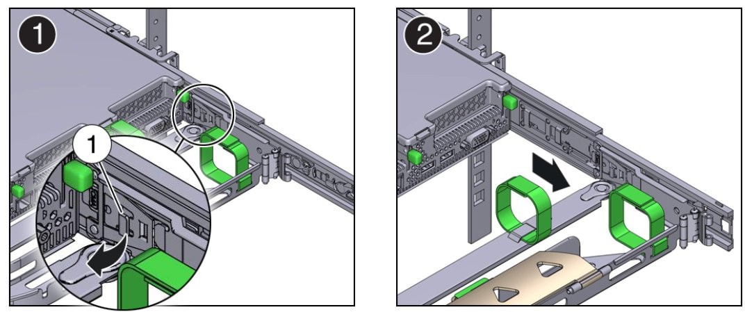

  6. To disconnect connector B:
    1. Place your right arm under the CMA to support it and grasp the back end of connector B with your right hand.
    2. Use your left thumb to pull the connector B release lever to the left, away from the right slide-rail (callout 1), and use your right hand to pull the connector out of the slide-rail [1 and 2].
      Figure 5-23 Disconnecting CMA Connector B from the Right Slide-Rail
      Supporting the CMA while pulling the release lever and removing connector B from the right slide-rail.
      1 Connector B release lever

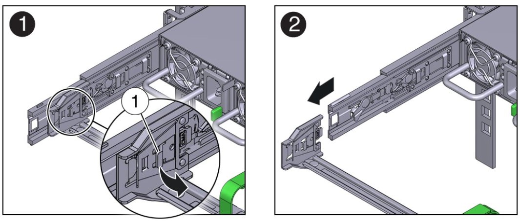

  7. To disconnect connector A:
    1. Place your left arm under the CMA to support it and grasp the back end of connector A with your left hand.
    2. Use your right thumb to pull the connector A release lever to the right, away from the left slide-rail (callout 1), and use your left hand to pull the connector out of the slide-rail [1 and 2].
      Figure 5-24 Disconnecting CMA Connector A from the Left Slide-Rail
      Supporting the CMA while pulling the release lever and removing connector A from the left slide-rail.
      1 Connector A release lever
