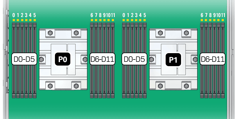

DIMM and Processor Physical Layout
The physical layout of the DIMMs and processor(s) is shown in the following figure. When viewing the server from the front, processor 0 (P0) is on the left.
DIMM layout
Each processor, P0 and P1, has twelve DIMM slots (D0-D11), six on each processor side. Each DIMM slot supports a single memory channel, for total of twelve DDR5 memory channels per processor (0-11).

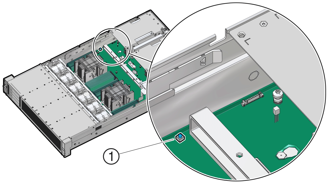

Use the Server Fault Remind Button
When you press the server Fault Remind button [1], an LED located next to the Fault Remind button lights green which indicates that there is sufficient voltage present in the fault remind circuit to light any fault LEDs that were lit due to a component failure. If this LED does not light when you press the Fault Remind button, it is likely that the capacitor powering the fault remind circuit has lost its charge. This can happen if the Fault Remind button is pressed for several minutes with fault LEDs lit, or if power is removed from the server for more than 15 minutes.
The following figure shows the location of the Fault Remind button on the motherboard.
fault remind button

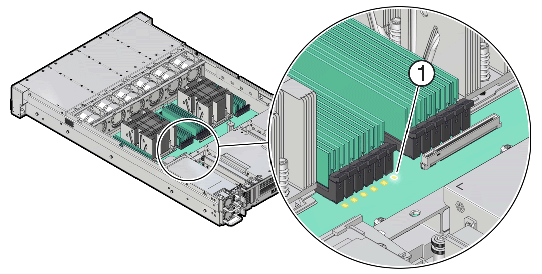

  2. Identify and note the location of the failed DIMM by pressing the Fault Remind button on the motherboard. See Use the Server Fault Remind Button.
    Failed DIMMs are identified with a corresponding amber LED on the motherboard.
    • If the DIMM Fault LED is off, then the DIMM is operating properly.
    • If the DIMM Fault LED is on (amber), then the DIMM is failed and must be replaced [1].
    DIMM fault LED

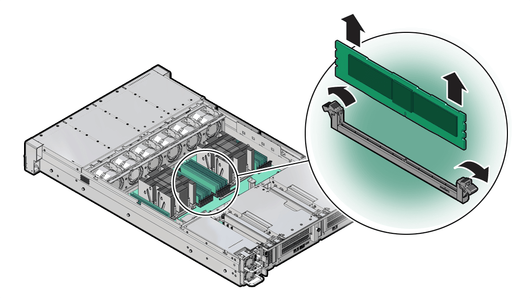

  3. To remove the failed DIMM, do the following:
    1. Rotate both DIMM slot ejectors outward as far as they go. The DIMM is partially ejected from the slot.
    2. Carefully lift the DIMM straight up to remove it from the slot.
    remove DIMM
  4. Replace each failed DIMM with either another DIMM of the same rank size (quad-rank or dual-rank) or leave the slot empty. For DIMM replacement instructions, see Install a DIMM.

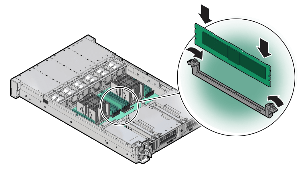

Install
  1. Unpack the replacement DIMM and place it on an antistatic mat.
  2. Ensure that the replacement DIMM matches the size, type, and rank of the DIMM it is replacing.
    See DIMM Population Rules and Populate DIMMs for Optimal System Performance.
  3. Install a DIMM.
    1. Ensure that the ejector tabs are in the open position.
    2. Align the notch in the replacement DIMM with the connector key in the connector slot.
      The notch ensures that the DIMM is oriented correctly.
    3. Push the DIMM into the connector slot until the ejector tabs lock the DIMM in place. If the DIMM does not easily seat into the connector slot, verify that the notch in the DIMM is aligned with the connector key in the connector slot.
      Caution:
      If the notch is not aligned, damage to the DIMM might occur.
    install DIMM
  4. Repeat Step 3 until all replacement DIMMs are installed.
