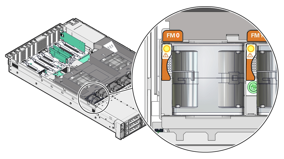

  3. Identify the faulty fan module. Each fan module has a fan service action required status indicator (LED) that is located next to the module. If the LED is amber, the fan has failed. The location of the fan status LED is shown in the following figure.
fan status
LED Color and State Meaning
Amber – The fan module is faulty. The front Top Fan LED and the front and back panel Fault-Service Required LEDs are also lit if the system detects a fan module fault.

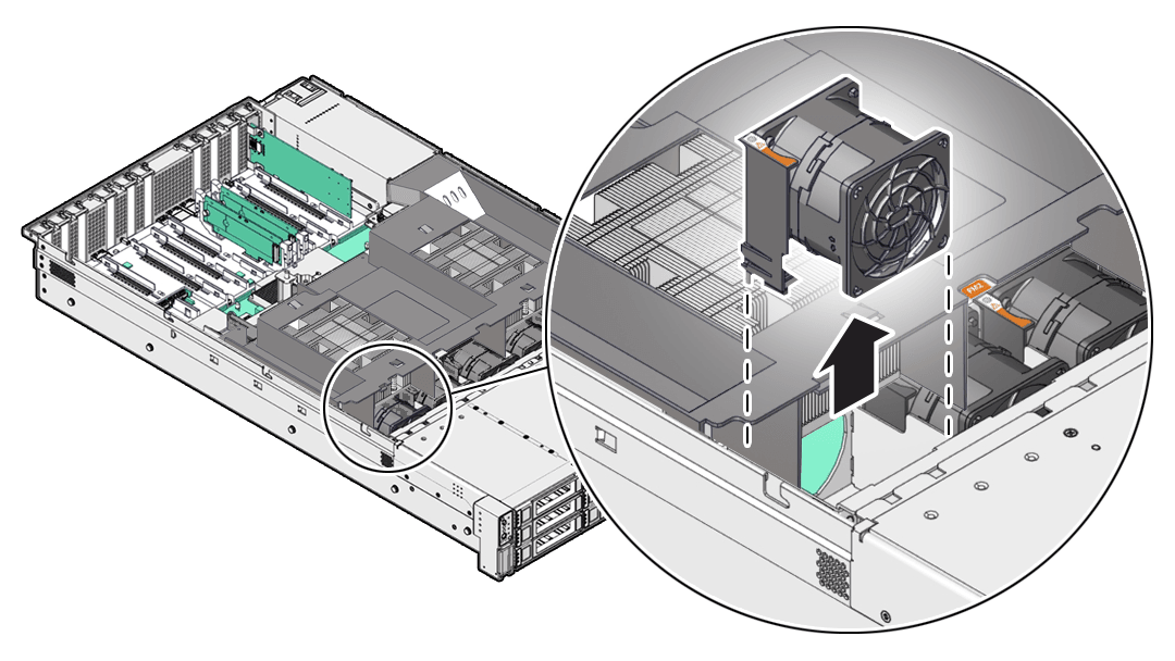

  1. Using your forefinger and thumb, lift the fan module straight up and out of the chassis and set it aside on an antistatic mat.
    fan remove

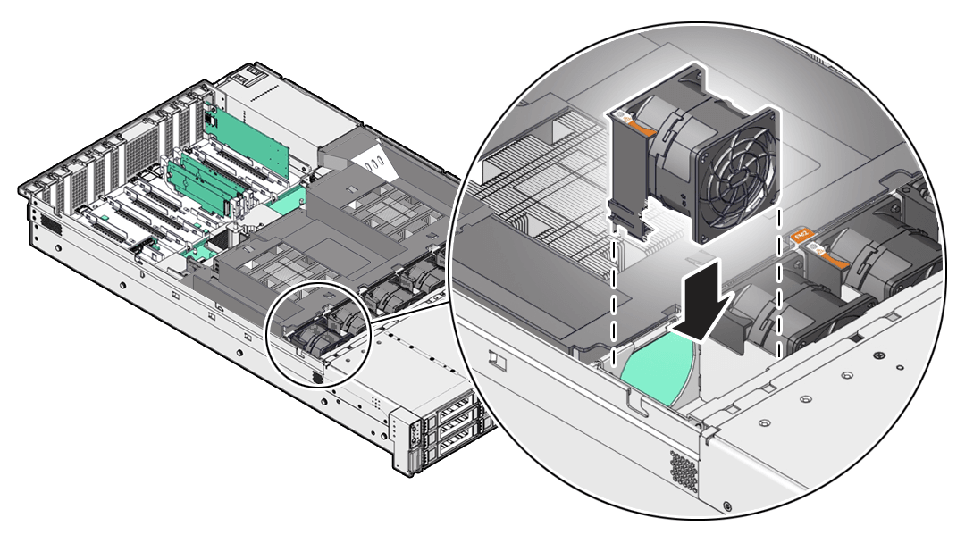

Install
  1. Remove the replacement fan module from its packaging, and place it on an antistatic mat.
  2. With the server top cover removed, install the replacement fan module into the server. The fan modules are keyed to ensure that they are installed in the correct orientation.
    install fan
  3. Press down on the fan module to fully seat the fan module.
  4. Verify that the fan module status indicator (LED) for the replacement fan module is not illuminated.

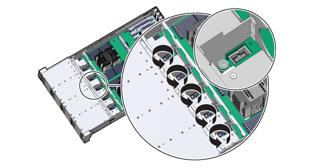

Fan Tray
Remove
Perform this procedure only when servicing Disk backplane, SAS cables, and Motherboard assembly replaceable components.
  1. Remove all fan modules from the fan tray. See "Remove a Fan Module" in this guide.
  2. Remove the air baffle. See "Remove the Air Baffle" in this guide.

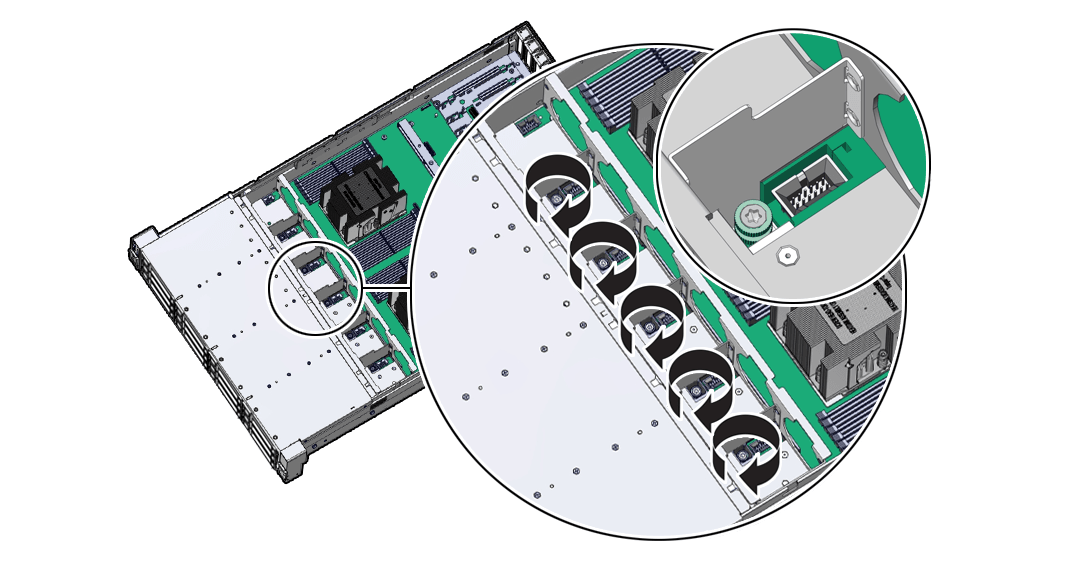

  3. Using a Torx T25 screwdriver, loosen the five spring-mounted screws that secure the fan tray to the server chassis.
    loosen screw
  4. When removing the fan tray, slightly tilt the fan tray to the left to decompress the cables, before the operation.
    tilt fan tray
    Ensure all motherboard cables are clear of the fan tray and fan tray gasket.

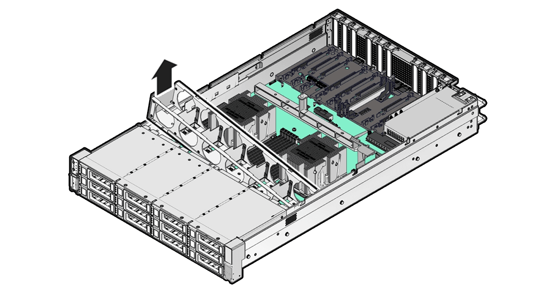

  5. Lift the fan tray from the server.
    remove fan tray
  6. Continue with the next step in the service procedure.
Install
Perform this procedure only when servicing Disk backplane, SAS cables, and Motherboard assembly replaceable components:

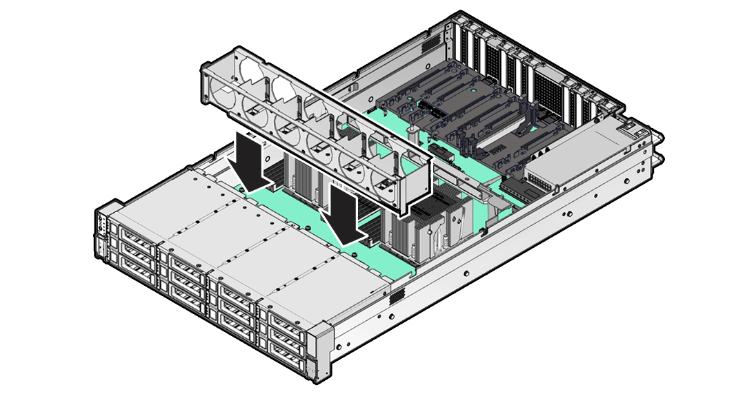

  1. Lower the fan tray into the server.
    install fan tray
  2. When installing the fan tray, the fan tray should first be slightly tilted to the left to compress the cables, before the operation.
    tilt fan tray
  3. Using a Torx T25 screwdriver, tighten the five spring-mounted screws that secure the fan tray to the server chassis.
    tighten screws
