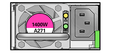

The server supports model A271 and A271a (1400 watt) power supplies. The power supply (PS) provides conversion from the AC lines to the system, accepting 220 volts AC (VAC) only. The PSUs are hot-pluggable, and in most cases provide fully redundant “1+1” power, allowing the system to suffer the loss of a PS or an AC feed with no loss to system availability.

The following status indicators (LEDs) are lit when a power supply fault is detected:
  • Front and back panel Fault-Service Required LEDs
  • Rear Power Supply Fault-Service Required LED located on the server front panel
  • Amber Fault-Service Required LED on the faulty power supply
PS module
For more information, see Power Supply Status Indicators.

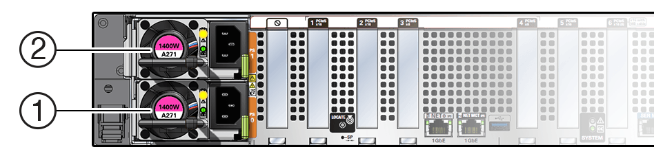

    PS location
  2. Identify which power supply requires replacement.
    Callout Description
    2 PS1 Power supply 1
    1 PS0 Power supply 0
    A lit amber Fault-Service Required LED on a power supply indicates that a failure was detected. You also can use the Oracle ILOM show faulty command at the Oracle ILOM command-line prompt (->) to identify a power supply failure.

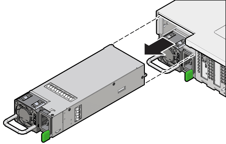

  5. Disconnect the power cord from the failed power supply.
  6. Grasp the power supply handle and push the power supply latch to the left. Open the power supply handle if the handle is folded flush. Open the velcro straps if present.
    remove PS
  7. Pull the power supply out of the chassis.
    Caution:
    When you remove a power supply, be sure to replace it with another power supply within 60 seconds; otherwise, the server might overheat due to improper airflow.

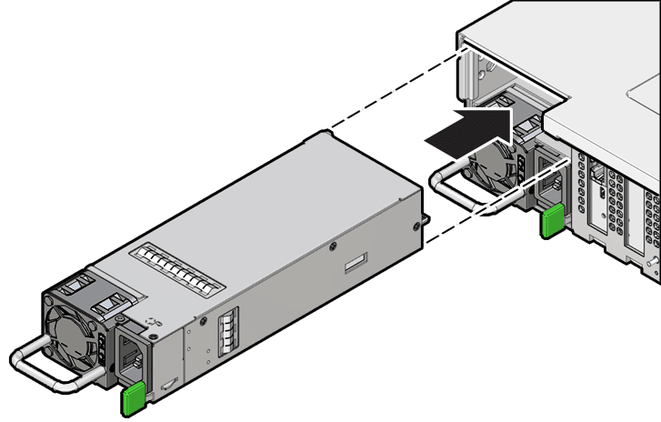

Install
Caution:
Always replace the failed power supply with the same type model of power supply.
  1. Remove the replacement power supply from its packaging, and place it on an antistatic mat.
  2. Align and orient the replacement power supply with the empty power supply slot.
  3. Slide the power supply into the slot until it is fully seated. You will hear an audible click when the power supply fully seats.
    install PS
  4. Reconnect the power cord to the power supply.
  5. Verify that the amber Fault-Service Required LED on the replaced power supply and the Fault-Service Required LEDs are not lit on the front and back panels. After you replace Power Supply 0, you must reset the Oracle ILOM service processor (SP) to propagate the key identity properties (KIP) data to the new power supply.
