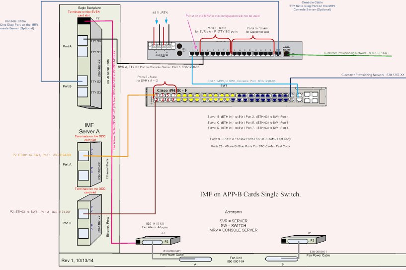

B.2 Network Overview
Network Connections
There are two kinds of network connections: Single Switch and Dual Switch. Table B-1 and Table B-2 illustrate the networks and how they are connected.
Table B-1 Single Switch Cabling Chart
| Cable Part Number | To | From |
| 830-1220-XX Serial Roll Over | Server A, TTY S2 Port, 830-1407-XX | Console Server Diag Port (Optional) |
| 830-1220-XX Serial Roll Over | Server A, TTY S0 Port, 830-1407-XX | Console Server, Port 3 |
| 830-1413-XX Fan Alarm Cable | Card/Server A, (P2) 830-1407-XX | EAGLE Backplane Fan Connector (J3), 830-1410-XX |
| 830-1174-XX CAT 5 Straight | Card/Server A Port A (P2) ETH01, 830-1102-XX | Switch 1, Port 1 |
| 830-1174-XX CAT 5 Straight | Card/Server A Port B (P2) ETH03, 830-1102-XX | Switch 1, Port 2 |
| 830-1220-XX Serial Roll Over | Switch 1 Console Port | Console Server, Port 1 |
| 830-1357-XX CAT 5 Straight | Console Server, Ethernet Port | Customer Provisioning Network |
| 830-1357-XX CAT 5 Straight | Switch 1, Port 47 | Customer Provisioning Network |
| Cabling for Servers B, C, D, E, F | ||
| 830-1174-XX CAT 5 Straight | Card/Server B Port A (P2) ETH01, 830-1102-XX | Switch 1, Port 3 |
| 830-1174-XX CAT 5 Straight | Card/Server B Port B (P2) ETH03, 830-1102-XX | Switch 1, Port 4 |
| 830-1174-XX CAT 5 Straight | Card/Server C Port A (P2) ETH01, 830-1102-XX | Switch 1, Port 5 |
| 830-1174-XX CAT 5 Straight | Card/Server C Port B (P2) ETH03, 830-1102-XX | Switch 1, Port 6 |
| 830-1174-XX CAT 5 Straight | Card/Server D Port A (P2) ETH01, 830-1102-XX | Switch 1, Port 7 |
| 830-1174-XX CAT 5 Straight | Card/Server D Port B (P2) ETH03, 830-1102-XX | Switch 1, Port 8 |
| STC Cards (E5-ENET-B)
(2) 830-1174-XX cables per card. (2) 830-1102-XX cable adapters per card. Adapters will be plugged onto each card on the backplane (Port A&B) Cables will plug into the (P3) port on each adapter. |
| Fast Copy (E5-ENET-B)
(2) 830-1174-XX cables per card. Cables will plug into the (P2) port on both existing adapters. |
| For the STC or Fast-Copy cards, the A Port of each card will be plugged into the Yellow switch ports (ports 9-27), and the B ports on the Blue ports (ports 28-46) in the single switch configuration. | ||
Figure B-1 IMF Interconnect Single Switch Configuration

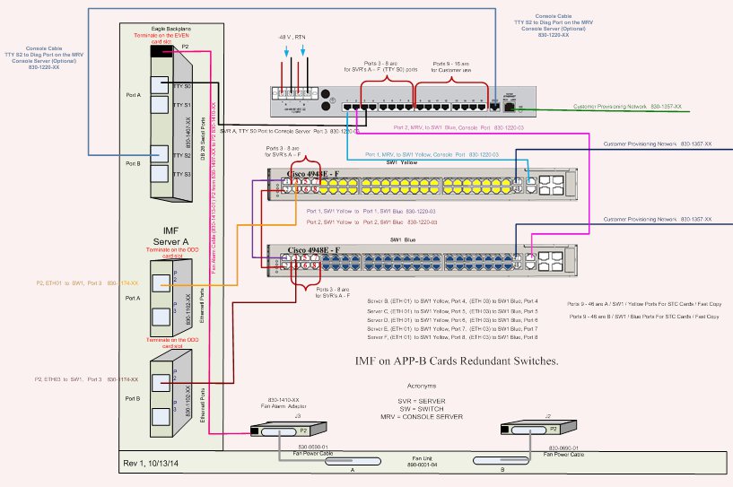

IMF Dual Switch Configuration
Table B-2 Dual Switch Cabling Chart
| 830-1220-XX Serial Roll Over | SW1 Yellow Port 1 | SW1 Blue, Port 1 |
| 830-1220-XX Serial Roll Over | SW1 Yellow Port 2 | SW1 Blue, Port 2 |
| 830-1174-XX CAT 5 Straight | Card/Server A Port A (P2) ETH01, 830-1102-XX | SW1 Yellow, Port 3 |
| 830-1174-XX CAT 5 Straight | Card/Server A Port B (P2) ETH03, 830-1102-XX | SW1 Blue, Port 3 |
| 830-1220-XX Serial Roll Over | SW1 Yellow, Console Port | Console Server, Port 1 |
| 830-1220-XX Serial Roll Over | SW1 Blue, Console Port | Console Server, Port 2 |
| 830-1357-XX CAT 5 Straight | SW1 Yellow, Port 47 | Customer Provisioning Network |
| 830-1357-XX CAT 5 Straight | SW1 Blue, Port 47 | Customer Provisioning Network |
| 830-1174-XX CAT 5 Straight | Card/Server B Port A (P2) ETH01, 830-1102-XX | SW1 Yellow, Port 4 |
| 830-1174-XX CAT 5 Straight | Card/Server B Port B (P2) ETH03, 830-1102-XX | SW1 Blue, Port 4 |
| 830-1174-XX CAT 5 Straight | Card/Server C Port A (P2) ETH01, 830-1102-XX | SW1 Yellow, Port 5 |
| 830-1174-XX CAT 5 Straight | Card/Server C Port B (P2) ETH03, 830-1102-XX | SW1 Blue, Port 5 |
| 830-1174-XX CAT 5 Straight | Card/Server D Port A (P2) ETH01, 830-1102-XX | SW1 Yellow, Port 6 |
| 830-1174-XX CAT 5 Straight | Card/Server D Port B (P2) ETH03, 830-1102-XX | SW1 Blue, Port 6 |
| 830-1174-XX CAT 5 Straight | Card/Server E Port A (P2) ETH01, 830-1102-XX | SW1 Yellow, Port 7 |
| 830-1174-XX CAT 5 Straight | Card/Server E Port B (P2) ETH03, 830-1102-XX | SW1 Blue, Port 7 |
| 830-1174-XX CAT 5 Straight | Card/Server F Port A (P2) ETH01, 830-1102-XX | SW1 Yellow, Port 8 |
| 830-1174-XX CAT 5 Straight | Card/Server F Port B (P2) ETH03, 830-1102-XX | SW1 Blue, Port 8 |
| The A Port of each card will be plugged into the Yellow switch ports, and the B Port of each card will be plugged into the Blue switch ports. | ||
Figure B-2 IMF Interconnect Dual Switch Configuration
