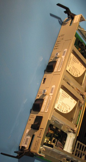

4 Installing and Removing E5-APP-B Cards
This chapter covers provisioning rules and installation and removal procedures for E5-APP-B cards.
4.1 Introduction
This chapter describes how to install and remove an E5-APP-B card from an EAGLE shelf, as well as shut down procedures for specific applications.
E5-APP-B cards are installed in an EAGLE in pairs to operate redundantly and provide high availability service.Although installed in an EAGLE slot in an EAGLE shelf, an E5-APP-B card does not use the IMT bus. However, the E5-APP-B card does use power provided by the EAGLE frame. Because the E5-APP-B card is not detected on the IMT bus, it is not calculated into the power consumption needs of the unit; Therefore, certain power requirements apply to the E5-APP-B card. Refer to the Obtaining the EAGLE Power Calculator to manually determine EAGLE frame power consumption needs with the E5-APP-B card installed. With EAGLE Release 45.0, E5-APP-B will be part of the frame Power Calculation automatically if it is entered into the EAGLE System.

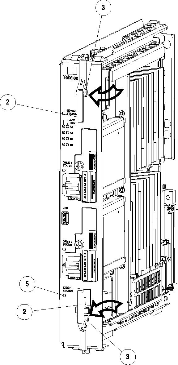

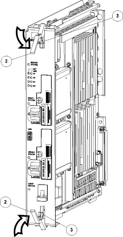

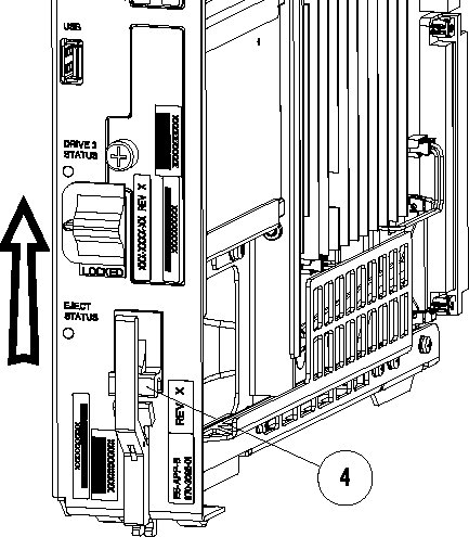

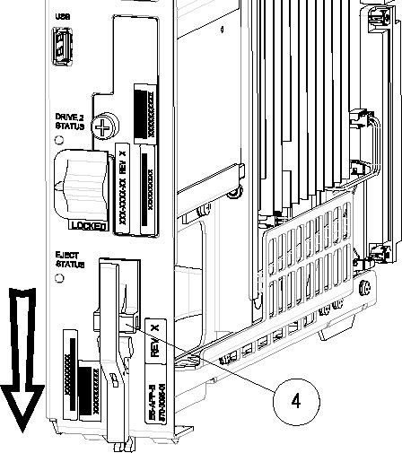

4.4 Removing an E5-APP-B Card
Procedure - Remove E5-APP-B card
Theshutdown, init 6 or halt commands will not shut down the E5-APP-B card.
