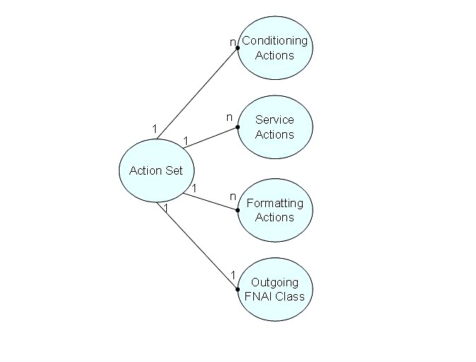

An Action Set consists of three types of Actions and an outgoing FNAI class:
- Conditioning Actions (CAs; up to 12 per Action Set) determine how a digit string is manipulated prior to applying service-specific behavior Digit manipulation includes number conditioning to international format and extraction of digits to use in formatting the outgoing digit string.
- Service Actions (SAs; up to 8 per Action Set) determine what service-specific behavior to apply to a digit string (such as corrective dialing and number portability checking).
- Formatting Actions (FAs; up to 12 per Action Set) determine how the outgoing digit string is formatted after Service Action execution.
- Outgoing FNAI Class (outgoing FNAI or OFNAI ; one per Action Set) setting communicates the NAI of the outgoing digit string to the calling service.
Figure 4-1 shows the relationship between Actions and Action Sets.
Figure 4-1 Action and Action Set Relationship

Figure 4-2 shows the Formatting Action Execution for FA Example 4.
Table 4-9 FA Example 4
| Generic Example | ||
Assumptions:
| Formatting Action set = {FA1=PFXA, FA2=RN, FA3=PFXB, FA4=DN}{FA=PFXA, RN, PFXB, DN} | ||
| Action | ==> | Resulting Outgoing Digit String |
| Begin | ==> | |
| PFXA | ==> | c |
| RN | ==> | c1234567890 |
| PFXB | ==> | c1234567890b |
| DN | ==> | c1234567890b669192252645 |
Figure 4-2 Formatting Action Execution Example
