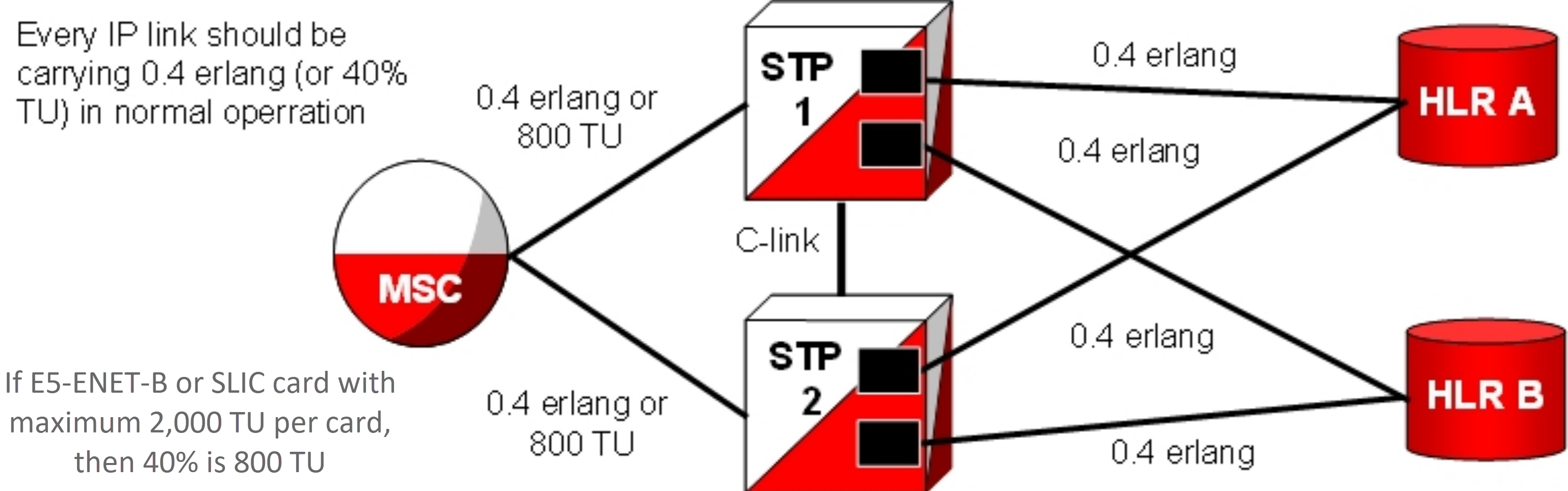

In SS7 signaling, a transaction is typically defined as one MSU transmitted and one MSU received, and assumes a worst-case scenario of that many MSUs both transmitted and received simultaneously per second.
IP signaling capacity is not usually constrained by the IP network (bandwidth), but rather by the processing platform (CPU or memory). The cost of a given transaction varies based upon the feature set triggered by the transaction. Not all MSUs are the same, and not all configurations are the same. Rather than to continue to engineer product capacity for the worst case and thereby penalizing customers who are not using worst-case scenarios, Oracle is providing the Transaction Unit (TU) model to allow customers flexibility in how to use application or card capacity.
Under the TU model, a transaction unit indicates the relative cost of an IP signaling transaction; the base transaction unit is 1.0. Some transactions are more expensive than others in terms of IP signaling card capacity. A transaction that is less expensive than the base has a transaction unit less than 1.0, and a transaction that is more expensive is greater than 1.0. The total transaction units consumed by an MSU are the sum of the base transaction unit value and the additional transaction unit value. Transaction Units per Second (TPS) are then calculated with the total transaction unit value and the Advertised Card capacity.

- For an IPSG card, the total capacity per card is considered as one erlang
                        Erlang is a statistical measure of the volume of telecommunications traffic. Traffic of one erlang refers to a single resource being in continuous use, or two channels being at 50% use, and so on.
- In a normal scenario, run the card at a maximum of 40% total capacity (0.4 erlang)
- In failover scenarios, the card runs at 80% of total capacity (0.8 erlang)
The IPSG can be configured to support M2PA B-, C-, and D-Links; or to support A- and E-Links (see the note in M3UA (MTP Level 3 User Adaptation Layer) Protocol for more information about A-links).
Every IP link should carry 0.4 erlang (or 40% TU) in normal operation. For an E5-ENET-B card with a maximum of 2,000 TU per card, 40% is 800 TU. This scenario is depicted in dimensioning1.html#GUID-E908036A-6B47-4B2A-A78F-41CC839157E6__V2248532.
Figure 5-1 SIGTRAN: Every IP Link at 0.4 Erlang
If the linkset to STP2 fails, another linkset to STP1 now carries 0.8 erlang. For a SLIC card with a maximum of 2,000 TU per card, 80% is 1,600 TU. This scenario is depicted in dimensioning1.html#GUID-E908036A-6B47-4B2A-A78F-41CC839157E6__V2248536.
Figure 5-2 SIGTRAN: Failover at 0.8 Erlang

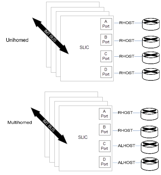

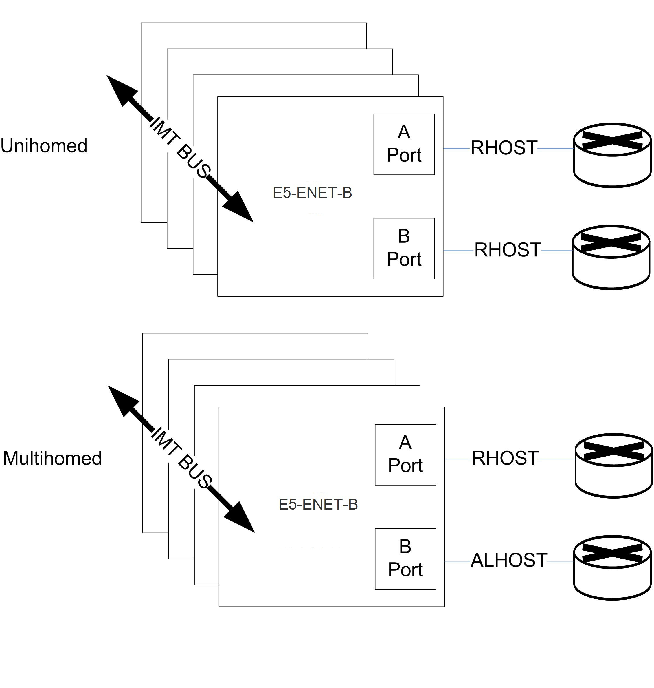

Unihoming versus Multihoming
EAGLE can be deployed with completely redundant IP network paths, each of which must be capable of sustaining the worst-case traffic load. Either of these two methods can be applied, depending on the application used:
- Unihomed links (for M2PA links)
- Multihomed links (for M2PA, M3UA links)
Unihoming
For unihoming, a set of IPSG cards, which are configured for worst-case traffic load, hosts one signaling link per linkset. Each signaling link is assigned to a unihomed SCTP association, where half of the associations are assigned to one independent IP network path, and the other half are assigned to another independent IP network path. Each network path must have dedicated bandwidthsufficient to sustain the worst-case traffic load.
Since each IPx card maintains a single static IP route table utilized by all Ethernet interfaces or ports, associations from only one of the local hosts (IP ports) of an IP card to a particular remote host address is possible. Associations from multiple local hosts of an IP card to the same remote host address is not possible.Multihoming
For multihoming, a set of IPSG cards, which are configured for worst-case traffic load, is hosting one signaling link per linkset. Each signaling link is assigned to a multihomed SCTP association, which is mapped to an IP network having at least two completely redundant paths. Each network path must have dedicated bandwidth sufficient to sustain the worst-case traffic load.
Multihoming is very important for M3UA connections because it is the only means of lossless handover in the event of a path failure.
Multihoming provides network-level resilience for SCTP associations by providing information on alternate paths to a signaling end point for a single association.
SCTP multihoming supports only communication between two end points, of which one or both are assigned with multiple IP addresses on possibly multiple network interfaces. Each IPx card maintains a single static IP route table, utilized by both Ethernet interfaces or ports. By checking the destination address in this IP route table, the router determines the port from which the message is transmitted by the IPx card.
This means that it is not possible to have a route to a single destination from both ports of an IP card – it must be one port or the other. SCTP multihoming does not support communication ends that contain multiple end points (i.e., clustered end points) that can switch over to an alternate end point in case of failure of the original end point.
Figure 5-3 Unihoming versus multihoming

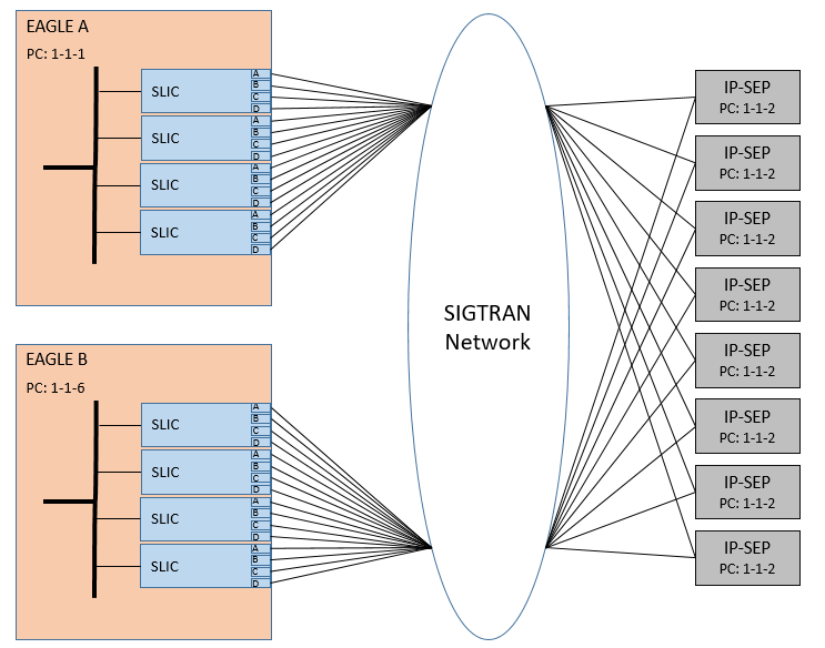

Mated Signal Transfer Point Redundancy
If a completely redundant IP network path is not available, then a redundancy model that relies on a mate Signal Transfer Point for IP path redundancy is supported by Oracle. This model is less robust but also less expensive.
Figure 5-4 Mated Signaling Transfer Point Redundancy With 4-Port SLIC Cards
