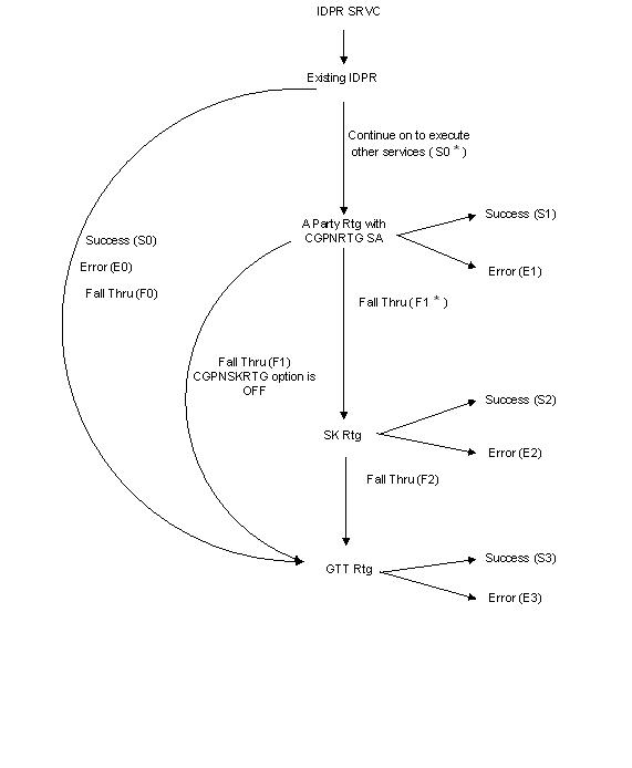

Measurements for the IDP A-Party Routing feature are described in .IDP A-Party Routing and IDP Service Key Routing Measurements Figure 7-1 illustrates the impact of the IDP A-Party Routing feature measurements pegging on the IDPR registers.
Figure 7-1 IDP A-Party Routing Impact on IDP Relay Measurements
Table 7-2 IDP A-Party Routing and IDP Relay Pegs
| IDP A-Party Routing and Service Key Routing Pegs | IDP Relay Pegs |
IDPAPTYRTD = S1 IDPAPTYSKR = S2 IDPAPTYGTT = F1 + F2 |
IDPRMSERR = E0 + E1 +E2 IDPRMSFAIL = F0+ F1+ F2 IDPRMSSUCC = S0 + S1 + S2 IDPRMSRCV = IDPRMSERR + IDPRMSFAIL + IDPRMSSUCC |
Note: GTT success (S3) and GTT failure (E3) measurements registers are pegged separately. |

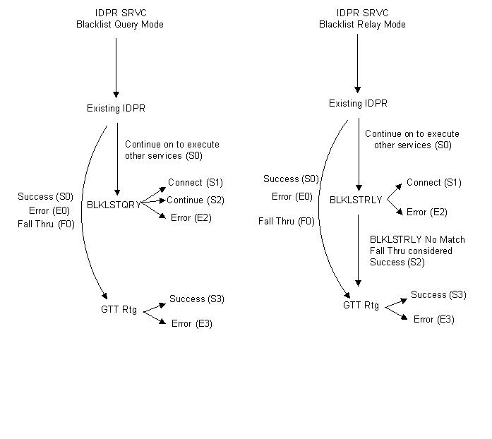

Measurements for the IDP A-Party Blacklist feature are described in IDP A-Party Blacklist Measurements. Figure 7-3 illustrates the impact of the IDP-A-Party Blacklist feature measurements pegging on the IDPR registers.
Figure 7-3 IDP A-Party Blacklist (Query and Relay) Impact on IDP Relay Measurements
Table 7-4 IDP A-Party Blacklist and IDP Relay Pegs
| IDP A-Party Blacklist Pegs | IDP Relay Pegs |
IDPBKLCONN = S1 IDPBKLCONT = S2 |
IDPRMSERR = E0 + E2 IDPRMSFAIL = F0 IDPRMSSUCC = S0 + S1 + S2 IDPRMSRCV = IDPRMSERR + IDPRMSFAIL + IDPRMSSUCC |
