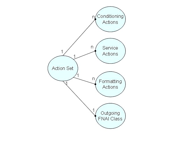

An Action Set consists of three types of Actions and an outgoing FNAI class:
- Conditioning Actions (CAs; up to 12 per Action Set) determine how a digit string is manipulated prior to applying service-specific behavior Digit manipulation includes number conditioning to international format and extraction of digits to use in formatting the outgoing digit string.
- Service Actions (SAs; up to 8 per Action Set) determine what service-specific behavior to apply to a digit string (such as corrective dialing and number portability checking).
- Formatting Actions (FAs; up to 12 per Action Set) determine how the outgoing digit string is formatted after Service Action execution.
- Outgoing FNAI Class (outgoing FNAI or OFNAI ; one per Action Set) setting communicates the NAI of the outgoing digit string to the calling service.
Figure 4-1 shows the relationship between Actions and Action Sets.
Figure 4-1 Action and Action Set Relationship

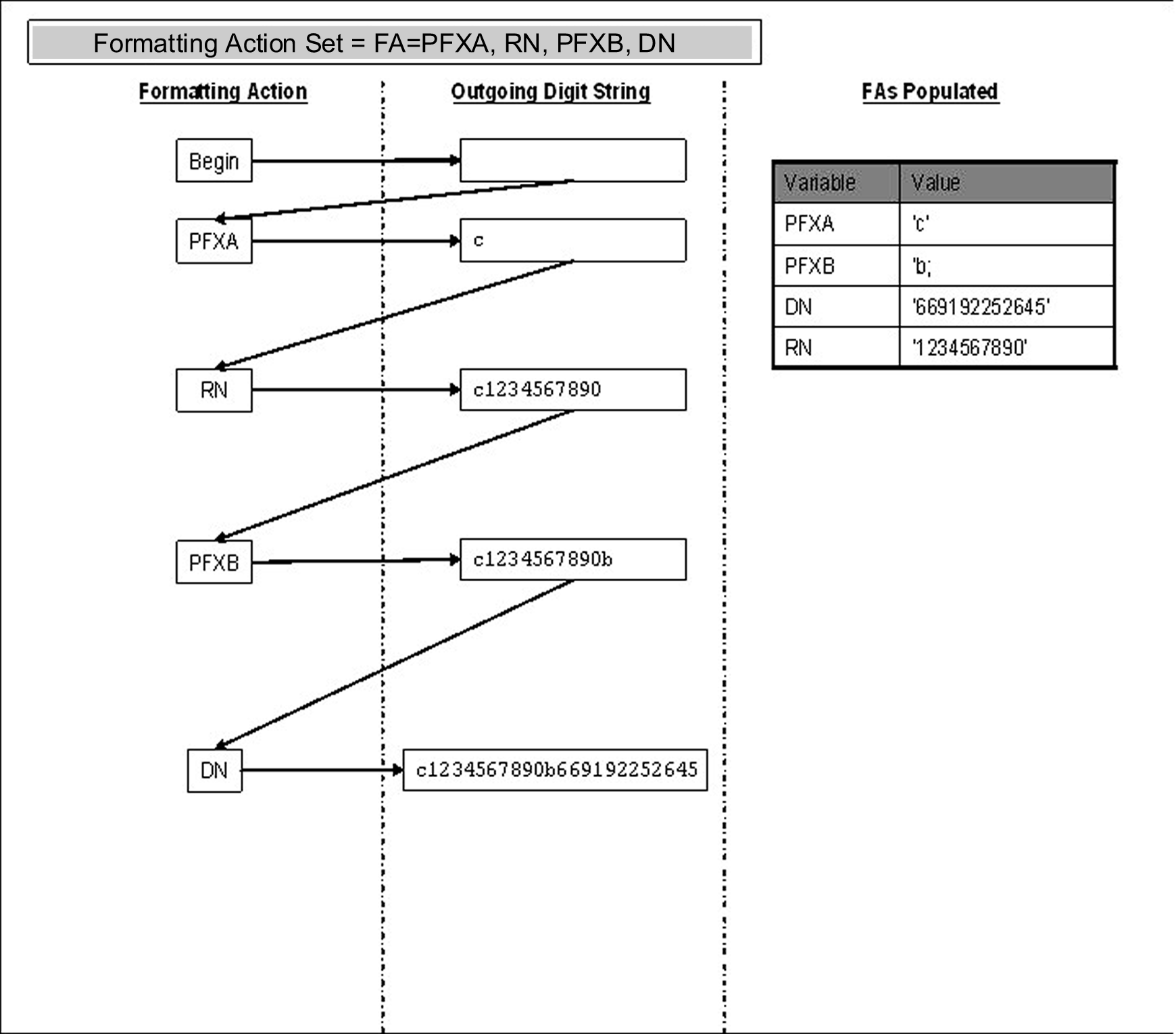

Formatting Actions
Formatting Actions (FAs) are applied after Service Action execution and determine how the outgoing digit string is formatted. The digits associated with each provisioned Formatting Action are made available during Conditioning Action execution and Service Action execution. The outgoing digit string is constructed by inserting digits associated with each FA into the string. If values are empty (no digit value assigned), they are skipped.
The behavior of a Formatting Action does not differ between services; however, each service defines the Formatting Actions that it supports. NPP allows up to 12 Formatting Actions to be associated with one Action Set. Formatting Actions are executed in the order of the consecutive numbers of the provisioned Formatting Action parameters, or in the sequenced list of comma-separated FA parameter values.
Valid Formatting Actions are listed in Table 6-4.
- CC + AC + SN
- CC + DN
- ZN
Service Actions might also have to be provisioned, depending on the particular Formatting Action.
Formatting Action List Type for Response Messages (FATYPE)
In addition to the Formatting Actions used to format the outgoing digits of the relayed message, Formatting Action List Types are used to format outgoing digits in the response messages generated by the services using NPP. These Formatting Action List Types are provisioned with the Formatting Actions to provide various combinations of digit formatting for different conditions. The service using NPP defines the service-specific usage of the Formatting Actions List Types. Valid values for Formatting Action List Types are shown in Table 6-5.
Formatting Action Execution
Conditioning Actions and Service Actions populate Formating Action digit string values that are used to construct the outgoing digit string during Formatting Action execution.
Formatting Action execution occurs after Service Action execution is complete for a digit string. The Service Action can indicate whether Formatting Action execution will or will not occur for the string.
NPP begins with an empty outgoing digit string, and inserts digits into the string in the order in which the Formatting Action values are provisioned in a sequenced list of comma-separated parameter values consecutively number parameter values. If a provisioned Formatting Action is not populated, the outgoing digit string is not modified for that Formatting Action.
After successful digit string processing and Formatting Action execution, NPP sends an outgoing NAI value (see Outgoing FNAI Class with the outgoing digit string to the calling service.
Formatting Actions Examples
The effects of Formatting Actions on digit strings are shown in Table 4-6, Table 4-7, Table 4-8, and Table 4-9. The examples include assumptions for required Conditioning Actions and Service Actions.
Table 4-6 FA Example 1
| Example 1: Standard national calls all receive the same handling | ||
Assumptions:
| Formatting Action set = {FA1=RN, FA2=DN}{FA=RN, DN} | ||
| Formatting Action | ==> | Resulting Outgoing Digit String |

Figure 4-2 shows the Formatting Action Execution for FA Example 4.
Table 4-9 FA Example 4
| Generic Example | ||
Assumptions:
| Formatting Action set = {FA1=PFXA, FA2=RN, FA3=PFXB, FA4=DN}{FA=PFXA, RN, PFXB, DN} | ||
| Begin | ==> | |
| PFXA | ==> | c |
| RN | ==> | c1234567890 |
| PFXB | ==> | c1234567890b |
| DN | ==> | c1234567890b669192252645 |
Figure 4-2 Formatting Action Execution Example
