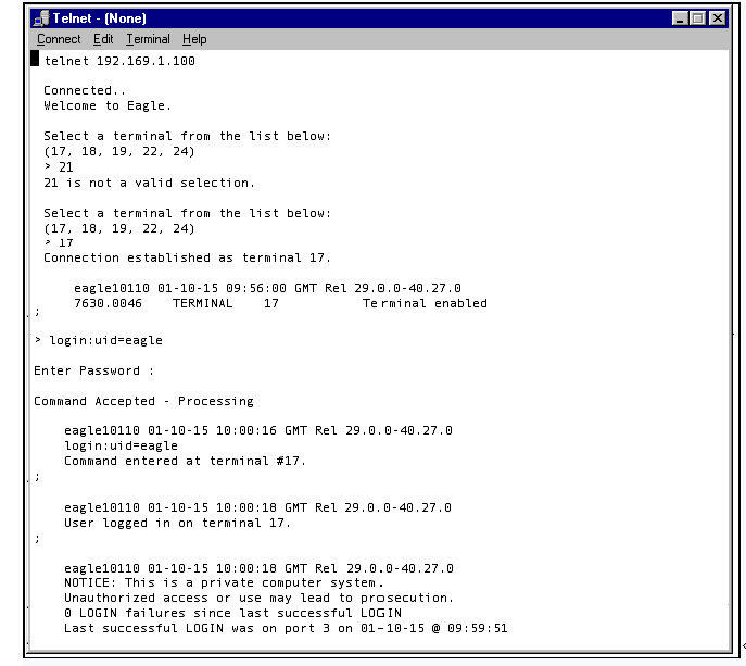

Telnet Terminals
Telnet is a user command using the underlying TCP/IP protocol for accessing remote computers. Telnet provides a connection from a remote (client) to a host (server) computer; the client keyboard and monitor (or window) act as if physically attached to the host computer. Remote users log on as if they were local users with whatever privileges may have been granted to the specific applications and data on the remote computer. Remote users, after they log in, can use the same services as a local user.
The IP User Interface feature permits any standard telnet client to act as an EAGLE terminal. This IP-based access provides a standard interface through which EAGLE commands are entered from a telnet session to the EAGLE. The EAGLE then provides command responses back to the remote telnet terminal.
Up to 3 E5-IPSM cards or E5-ENET-B cards running the IPS application (IPSM cards) in the EAGLE, with IP connectivity, enable telnet clients to connect from anywhere on the customer’s IP LAN. The EAGLE must be on the customer’s LAN or WAN. Each IPSM card provides 8 telnet terminal ports (IDs 17-24 for the first card installed, 25-32 for the second card installed, and 33-40 for the third card installed), which are automatically made available when the card is installed and provisioned. See the chg-trm command description in this manual for more information about configuring telnet terminals.
From the telnet client, the remote user connect to any one of the equipped IPSM cards available by entering the command telnet <IP address>. For example,
telnet 192.168.1.100
The remote user then selects a terminal number from a list of available terminals. If an incorrect terminal number (one not listed in the prompt) is selected, the prompt appears again. (After three incorrect tries, the session is closed.) After the session is accepted, an EAGLE welcome message appears. At this point, broadcast messages (if provisioned) will begin to appear. See #GUID-E573776A-E620-417A-A015-12E7A4862A2C/FIG_I1M_M44_1ZB.
Figure 2-2 Telnet Terminal Seclection and Login
After a connection is made, the remote user can log in using a pre-provisioned user ID and password. (The user ID and password must be provisioned from an existing serial terminal.) The login command can be typed directly, without typing <Ctrl-A> first.
