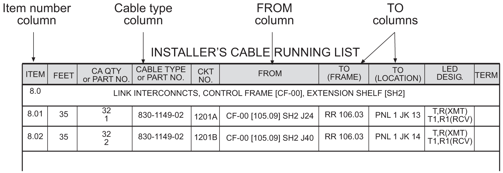

  1. Locate the Installer’s Cable Running List in the Equipment Specification for the site.
    Refer to Figure C-1 for an example.
    Figure C-1 Installer’s Cable Running List Example
    img/t-labeling-cables-im-fig1.jpg

  3. Take one cable and identify the cable’s part number in the Cable Type column of the cable running list.
  4. Match the cable with its corresponding pair of labels:

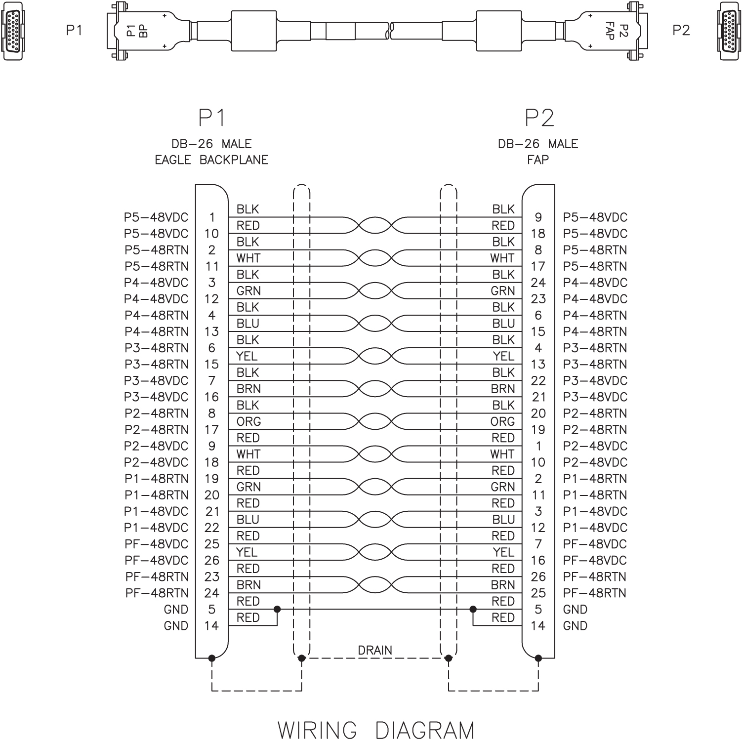

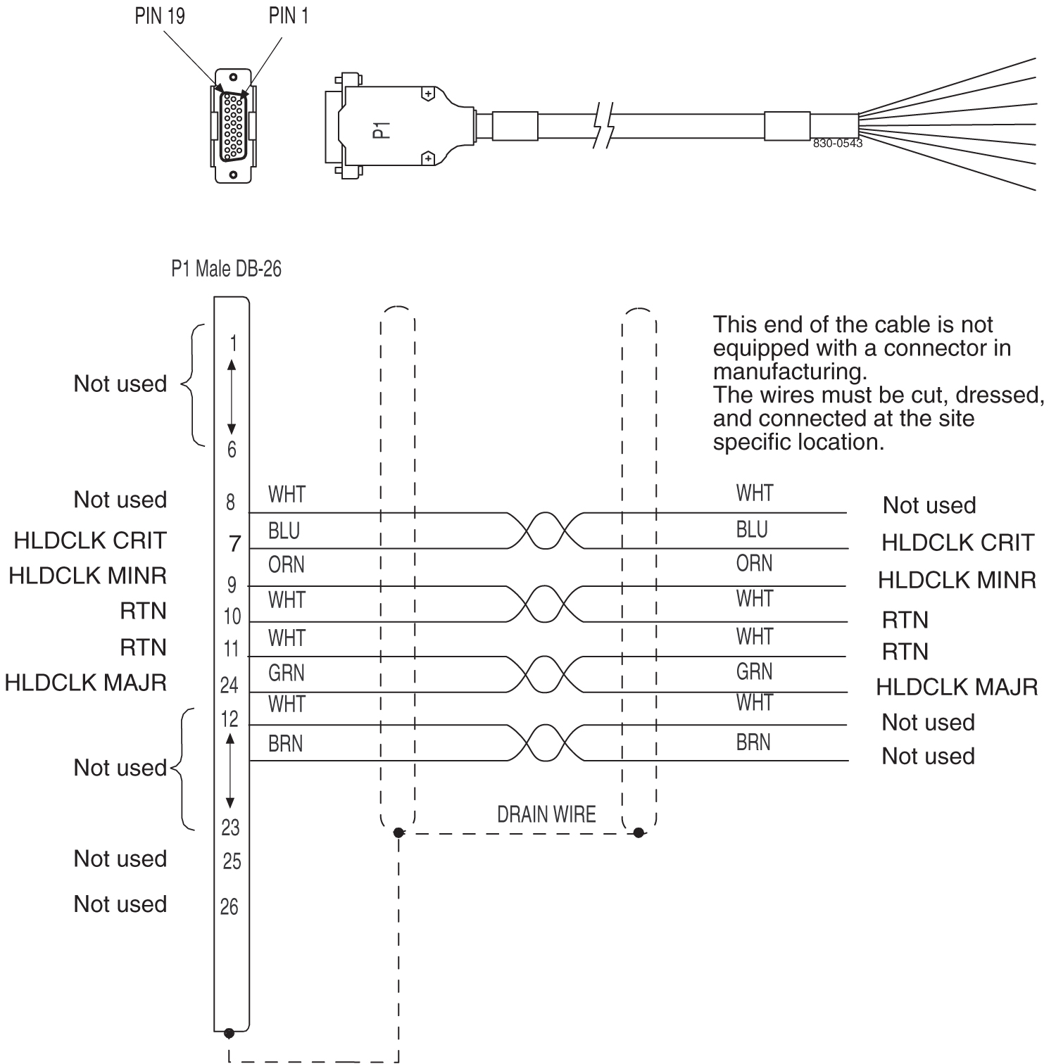

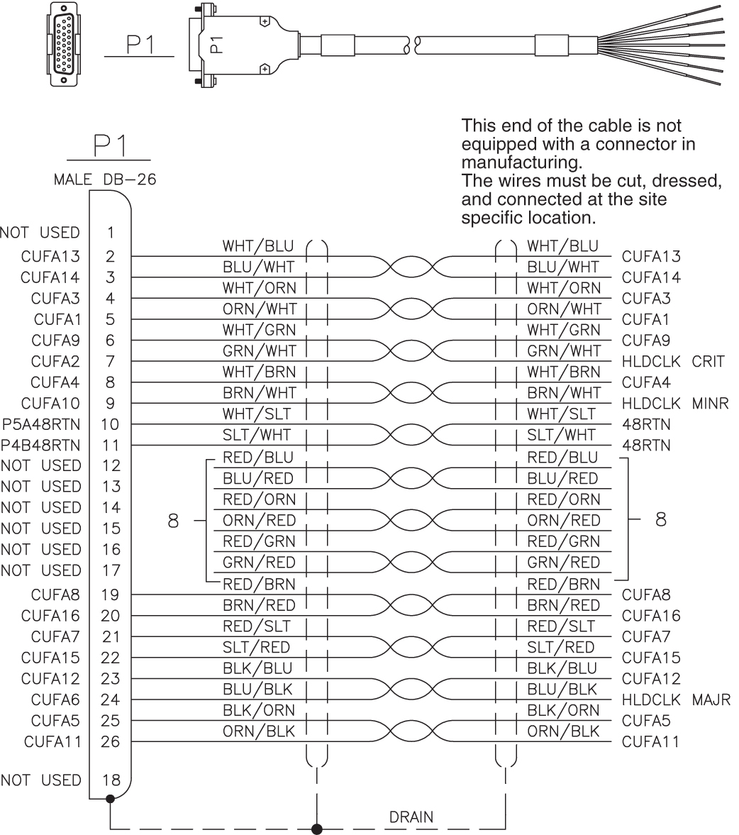

Alarm Cable (Holdover Clock)
Figure C-2 Holdover Clock Alarm Cable
img/r-alarm-cable-holdover-clock-im-fig1.jpg

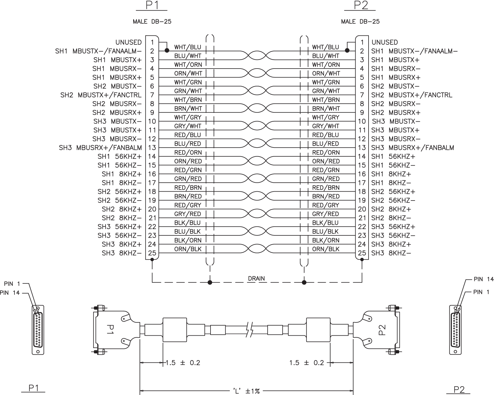

Figure C-3 Clock Cable
img/r-b-clock-cable-im-fig1.jpg

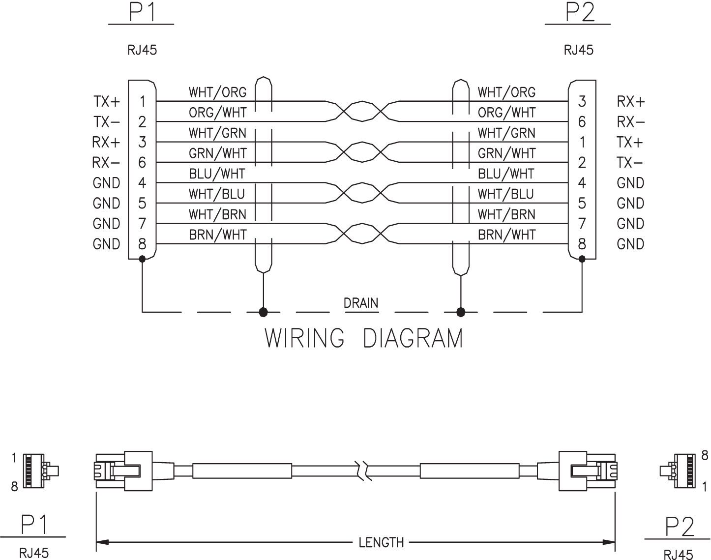

Crossover (CAT-5) Cable
Table C-3 Crossover CAT-5 Cable
Part Number Length
North American International meters feet
830-0723-01
830-1173-01
0.30
1
830-0723-02
830-1173-02
0.90
3
830-0723-03
830-1173-03
1.37
4.5
830-0723-xx
830-1173-xx
available in many more lenghts
Figure C-4 Crossover CAT-5 Cable
img/r-crossover-cat-5-cable-im-fig1.jpg

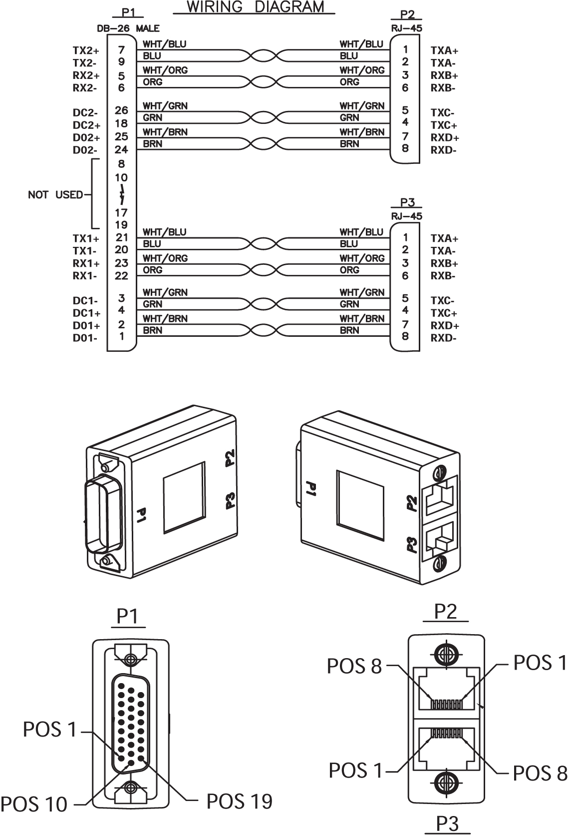

E5-ENET ADAPTER (DB26 Male-to-Dual RJ45)
The Ethernet cable pinouts differ between the E5-ENET card and the DCM or single-slot EDCM cards.
Adapter 830-1102-02 is required for installation of the E5-ENETwhen the DCM cable is replaced with a CAT5 straight-through cable 830-1174-xx. The adapter is connected to the backplane and the CAT5 straight-through cable cable is connected from the other side of the adapter to a switch, or a hub, or a patch panel (same place the DCM cable was terminated). If the card inserted into the slot does not match the backplane connector, the interface will not function.
Figure C-5 DB26 Male to Dual RJ45 Adapter
img/r-e5-enet-adapter-db26-male-dual-rjj45-im-fig1.jpg

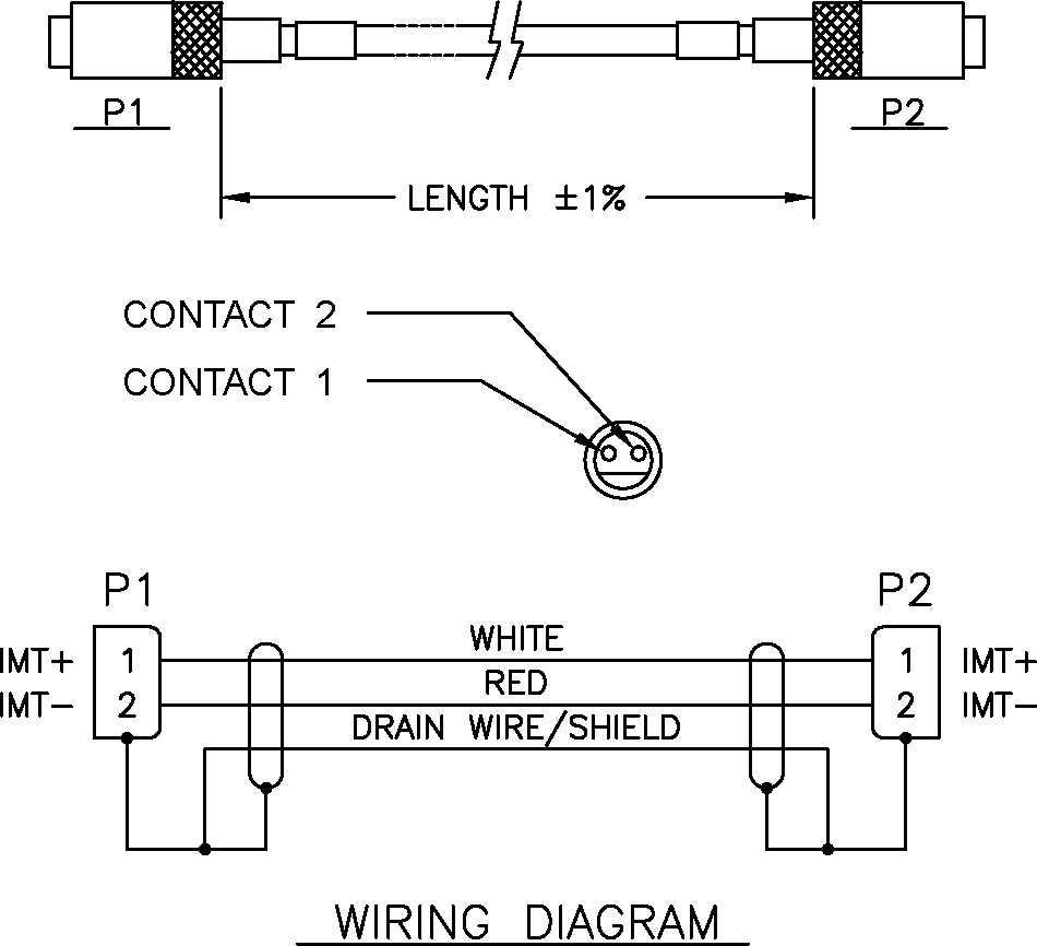

IMT Cable High Speed
Table C-6 Interface Cable High Speed

Figure C-8 IMT Cable
img/830-1344-xx-hi-speed-imt.jpg

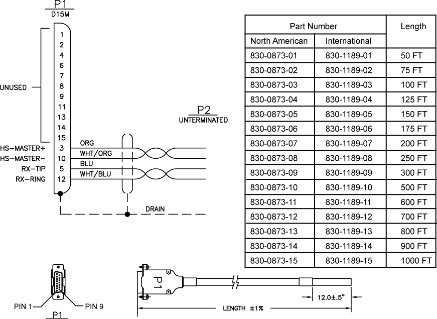

Source Clock Cable (BITS/High-speed)
Figure C-9 Source Clock Cable (BITS/High-speed)
img/t-hs-clock-cable-830-0873-1189.jpg

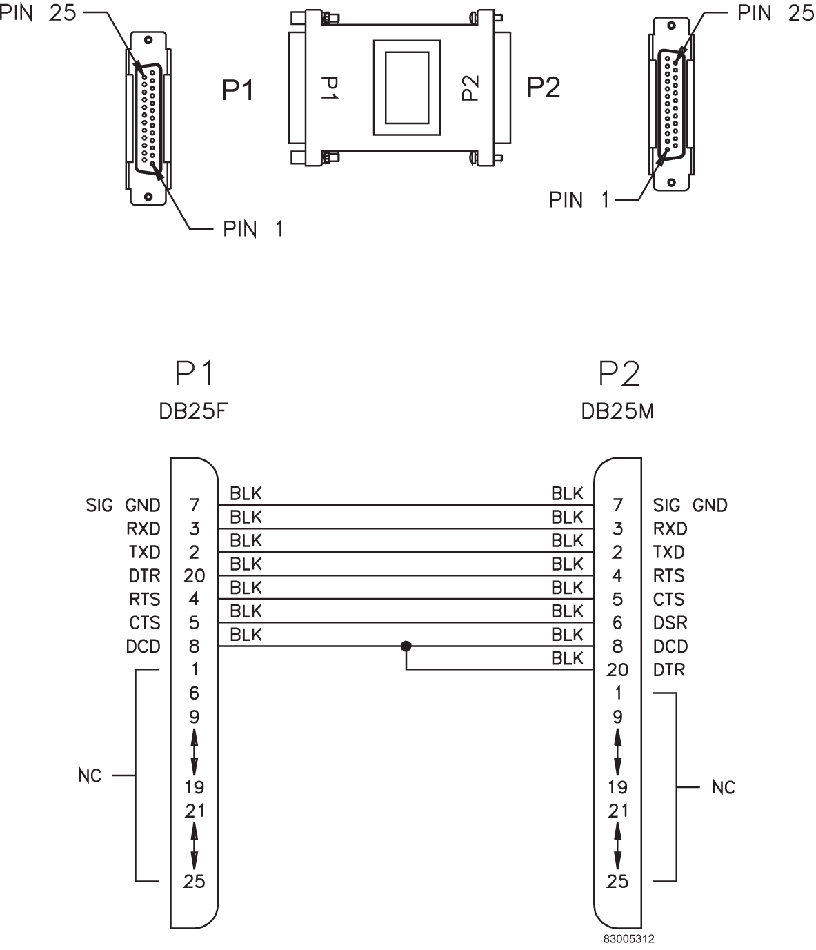

Serial Interface, Terminal, and Printer Adapter
Figure C-12 Serial Interface, Adapter
img/r-serial-interface-terminal-printer-adapter-im-fig1.jpg

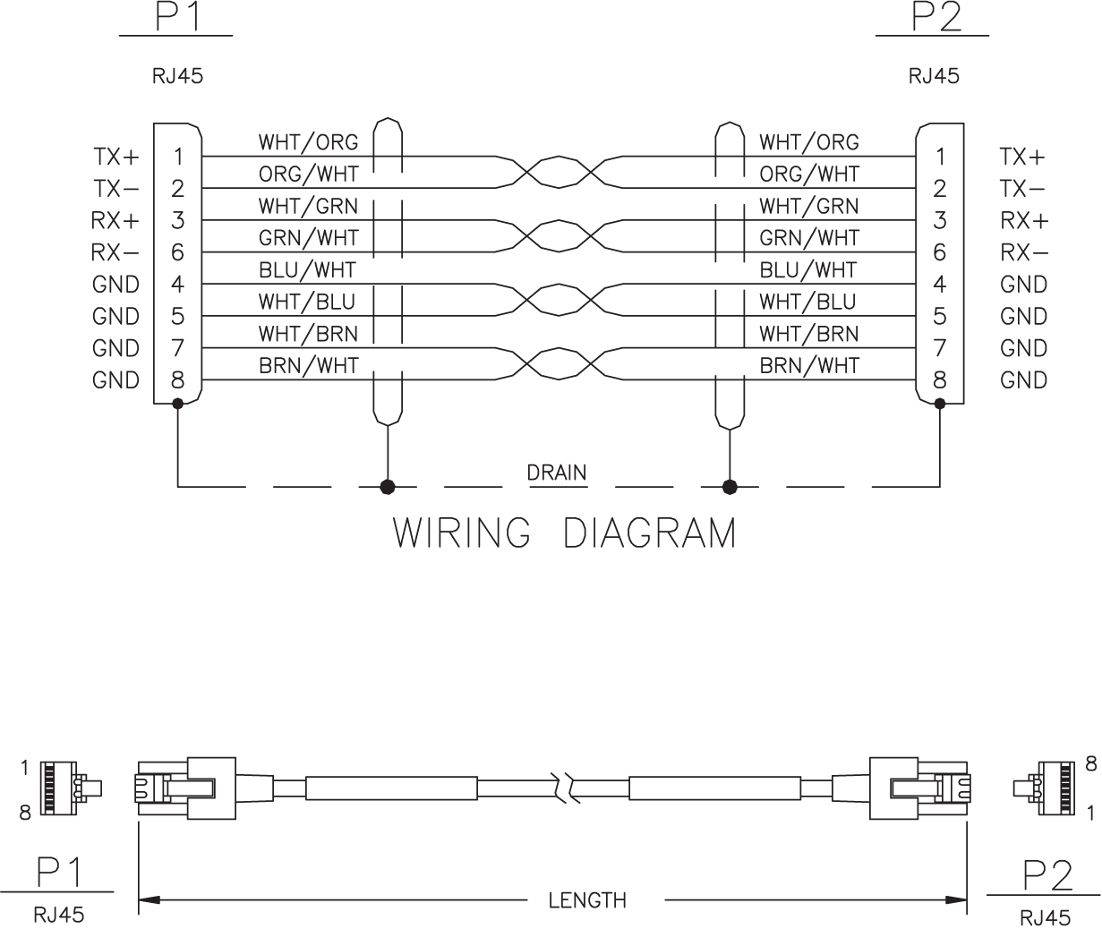

Shielded Straight Through Cable (CAT-5)
Table C-9 Shielded Straight Through CAT-5 Cable
Part Number Length
  meters feet
830-1174-10
30.48
100.0
830-1174-43
60.96
200.0
830-1174-63
91.44
300.0
Figure C-13 Straight Through Cable (CAT-5)
img/r-straight-through-cable-cat-5-im-fig1.jpg

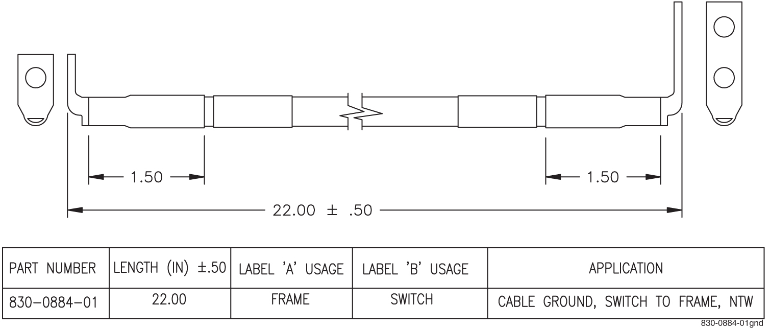

Switch-to-Frame Ground Cable
Figure C-14 Switch to Frame Ground Cable
img/r-switch-frame-ground-cable-im-fig1.jpg

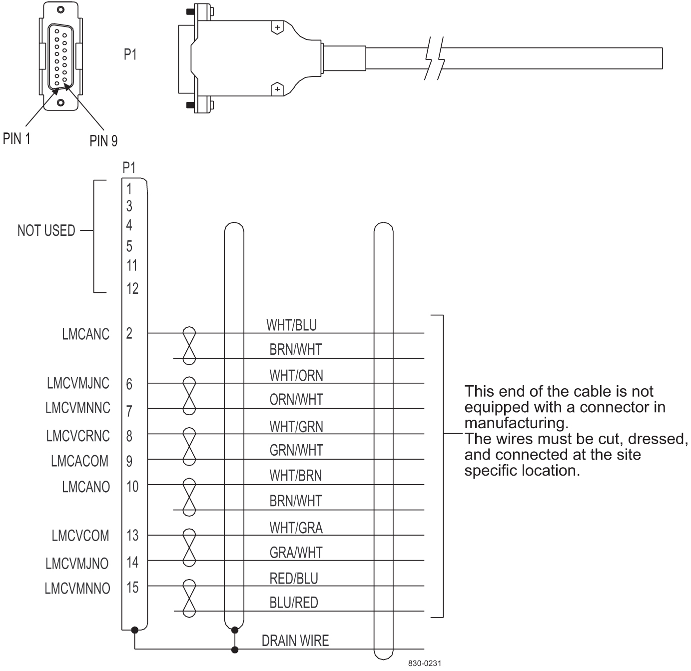

Local Maintenance Center Cable
Table C-10 Local Maintenance Center Cable
Part Number Length
North American International feet meters
830-0231-01
830-1144-01
50
15.25
830-0231-02
830-1144-02
75
22.88
830-0231-03
830-1144-03
100
30.50
830-0231-04
830-1144-04
125
38.13
830-0231-05
830-1144-05
150
45.75
830-0231-06
830-1144-06
175
53.38
830-0231-07
830-1144-07
200
61.00
830-0231-08
830-1144-08
250
76.25
830-0231-09
830-1144-09
300
91.50
830-0231-10
830-1144-10
500
152.50
830-0231-11
1000
305.00
Figure C-15 Local Maintenance Center Cable
img/r-local-maintenance-center-cable-im-fig1.jpg

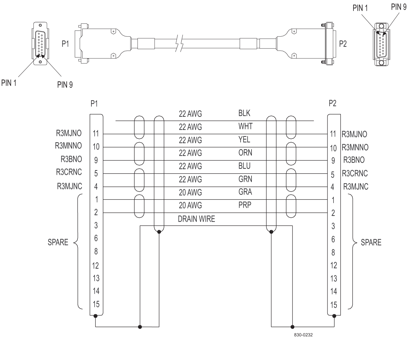

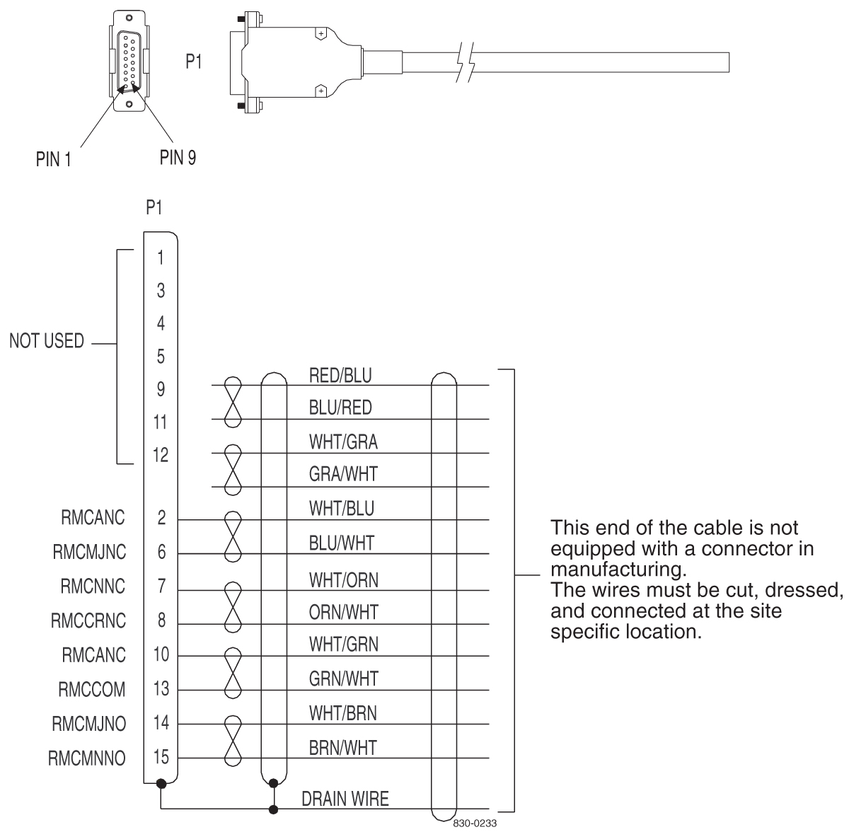

Remote Maintenance Center Cable
Table C-11 Remote Maintenance Center Cable
Part Number Length
830-0233-01
830-1146-01
50
15.25
830-0233-02

Figure C-16 Remote Maintenance Center Cable
img/r-remote-maintenance-center-cable-im-fig1.jpg
