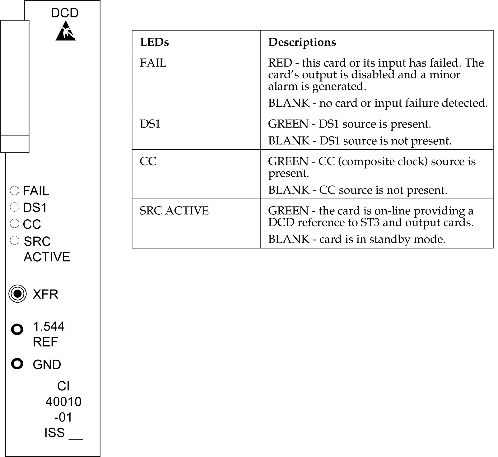

CI, Clock Interface Card, Holdover Clock
Figure A-1 Holdover Clock CI Card LEDs

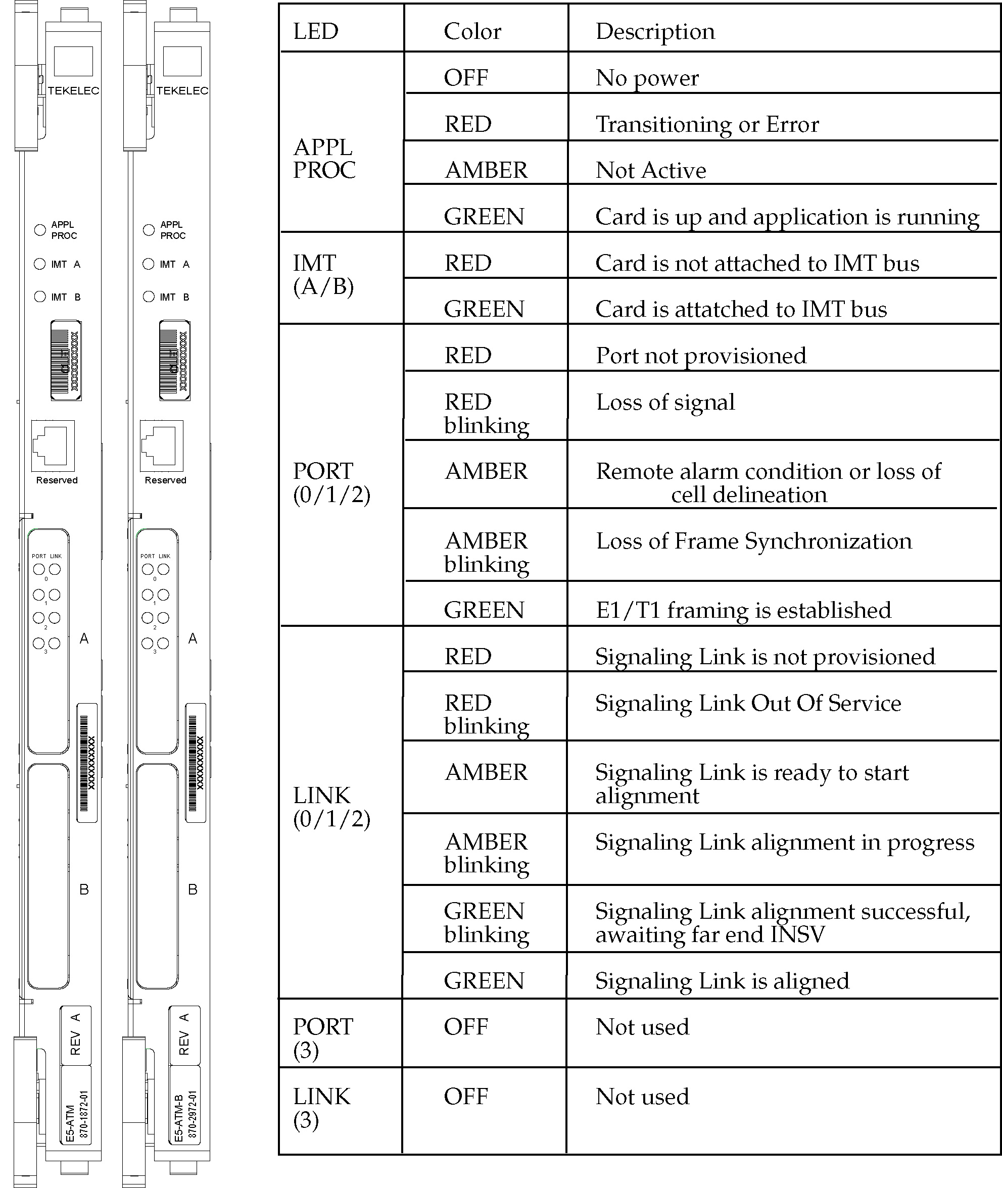

E5-ATM-B Interface Module
Figure A-2 E5-ATM-B Interface Module

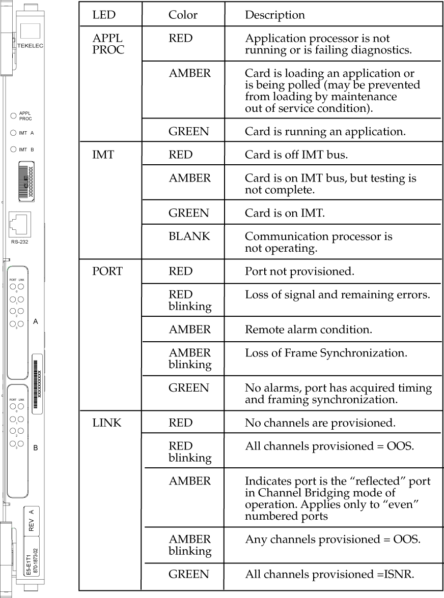

E5-E1T1-B Interface Module
Figure A-3 E5-E1T1-B Interface Module
img/r-e5-e1t1-b-leds.jpg

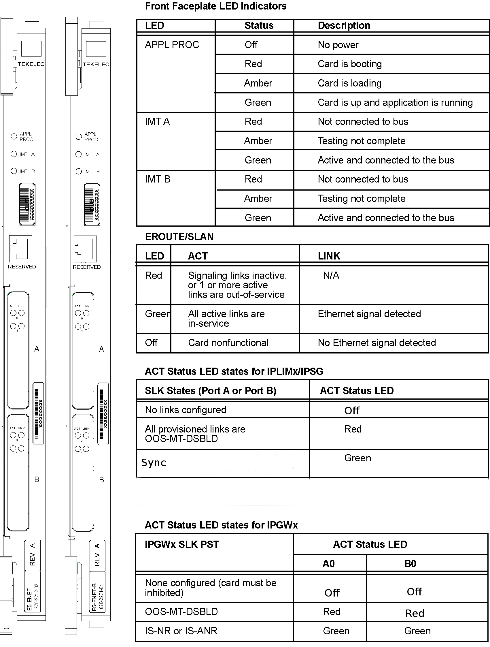

E5-ENET-B Interface Module
Figure A-4 E5-ENET-B Interface Module
img/r-e5-enet-b-leds.jpg
Must be used with the E5-MASP card.
The E5-ENET-B is provisionable for multiple functions, but does not support multiple functions on a single card simultaneously.

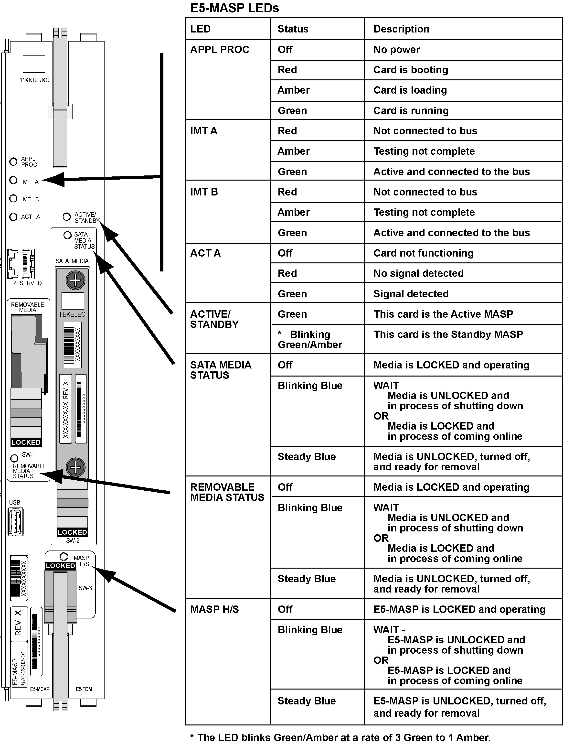

E5-MASP Card
Figure A-5 E5-MASP Card
img/870-2903-xx-e5-masp-led-table.jpg

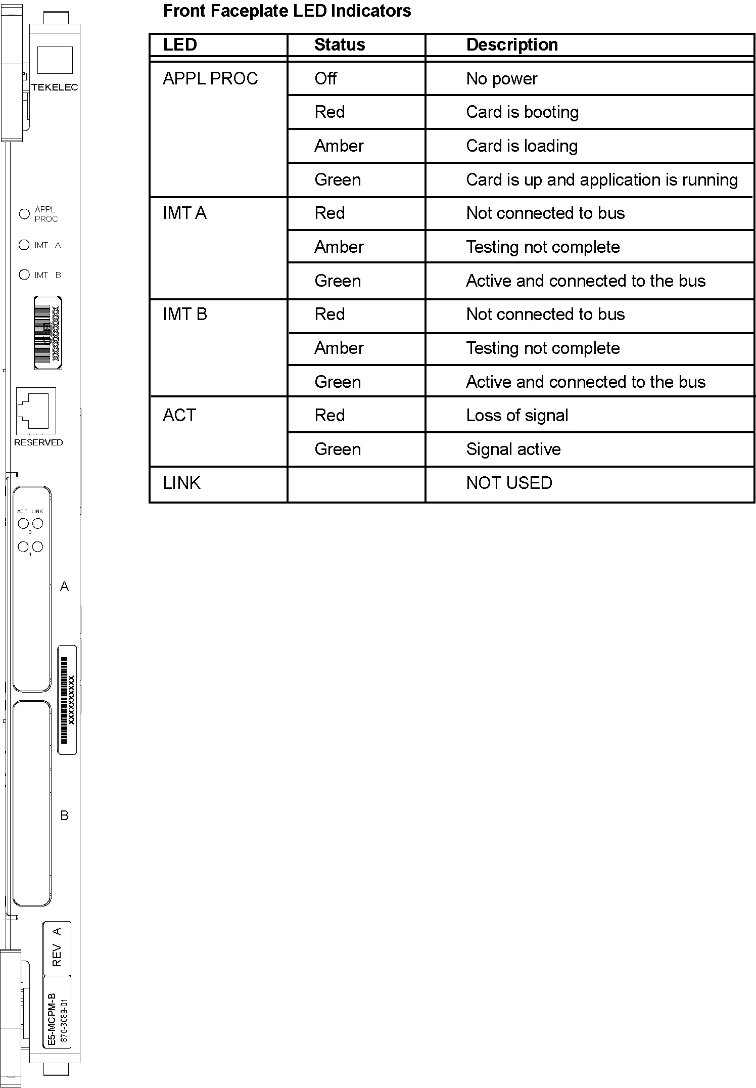

Figure A-6 E5-MCPM-B Module
img/r-e5-e1t1-e5-e1t1-interface-module-im-fig1.jpg
img/r-e5-mcpm-b-leds.jpg

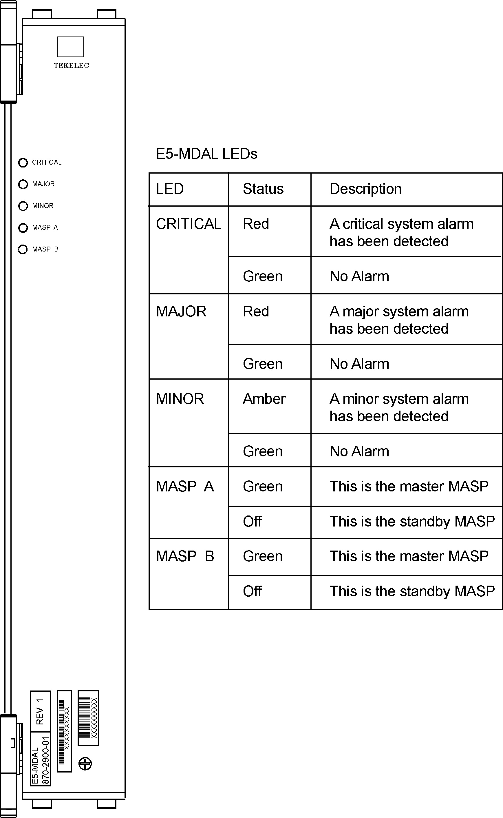

E5-MDAL Card
Figure A-7 E5-MDAL Card
img/870-2903-xx-e5-mdal.jpg

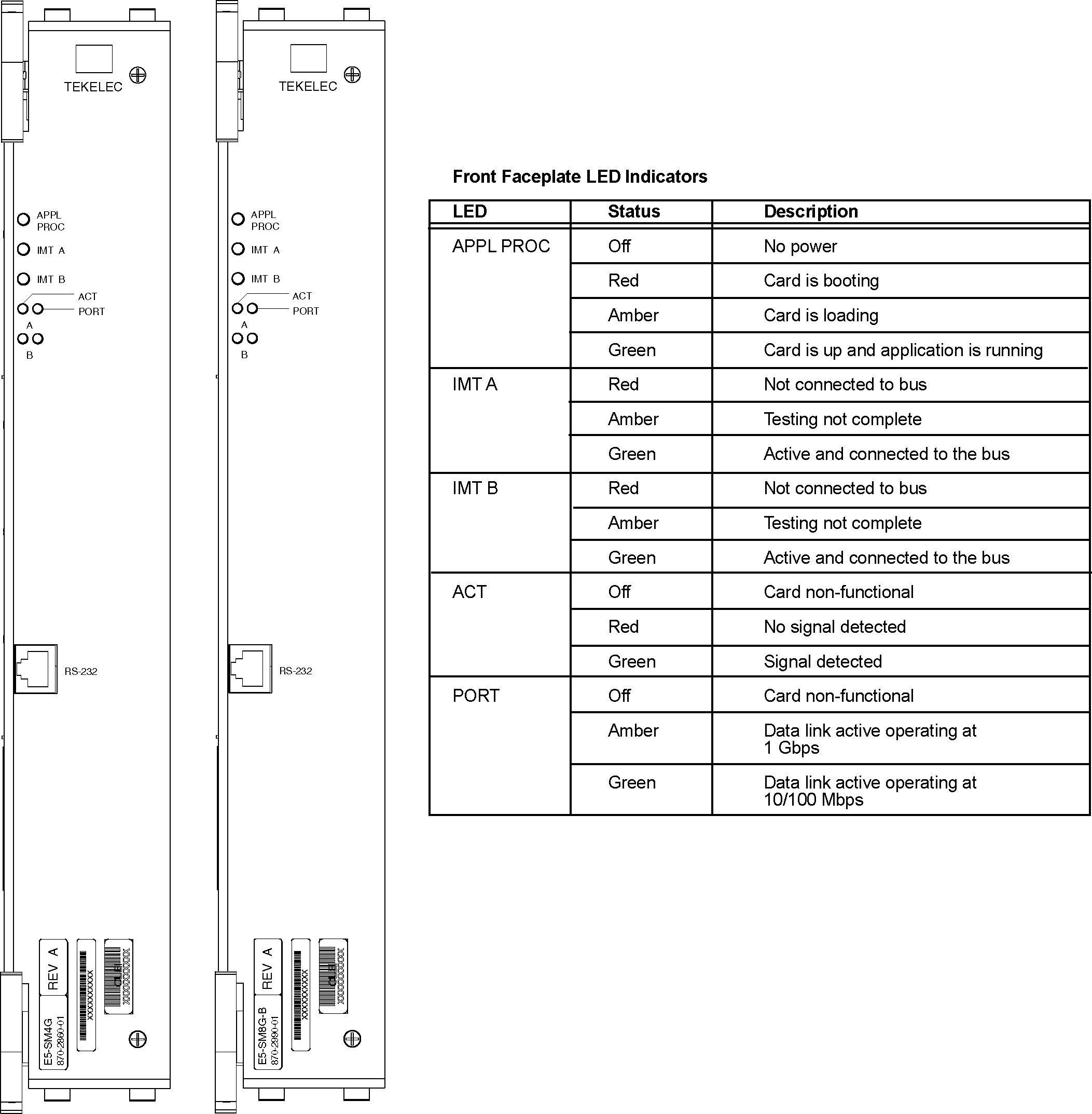

E5-SM8G-B Module
Figure A-8 E5-SM8G-B Interface Module
img/r-e5-sm8g-b-leds.jpg
Table A-1 E5-SM8G Interface Module LEDs
LED Color Descriptions
APPL
PROC
Red
Application processor is not running or is failing diagnostics.
Amber
Card is loading an application or is being polled (may be prevented from loading by maintenance-out-of-service condition)
Green
Card is running an application.
IMT
Red
Card is off IMT bus
Amber
Card is on IMT bus, but testing is not complete.
Green
Card is on IMT bus
Blank
Communication processor is not operating.
ACT
Red
No signal detected
Green
Signal detected
Off
Card nonfunctional
PORT
Amber
Data link active operating at 1 Gbps
Green
Data link active operating at 10/100 Mbps
Off
Card non-functional

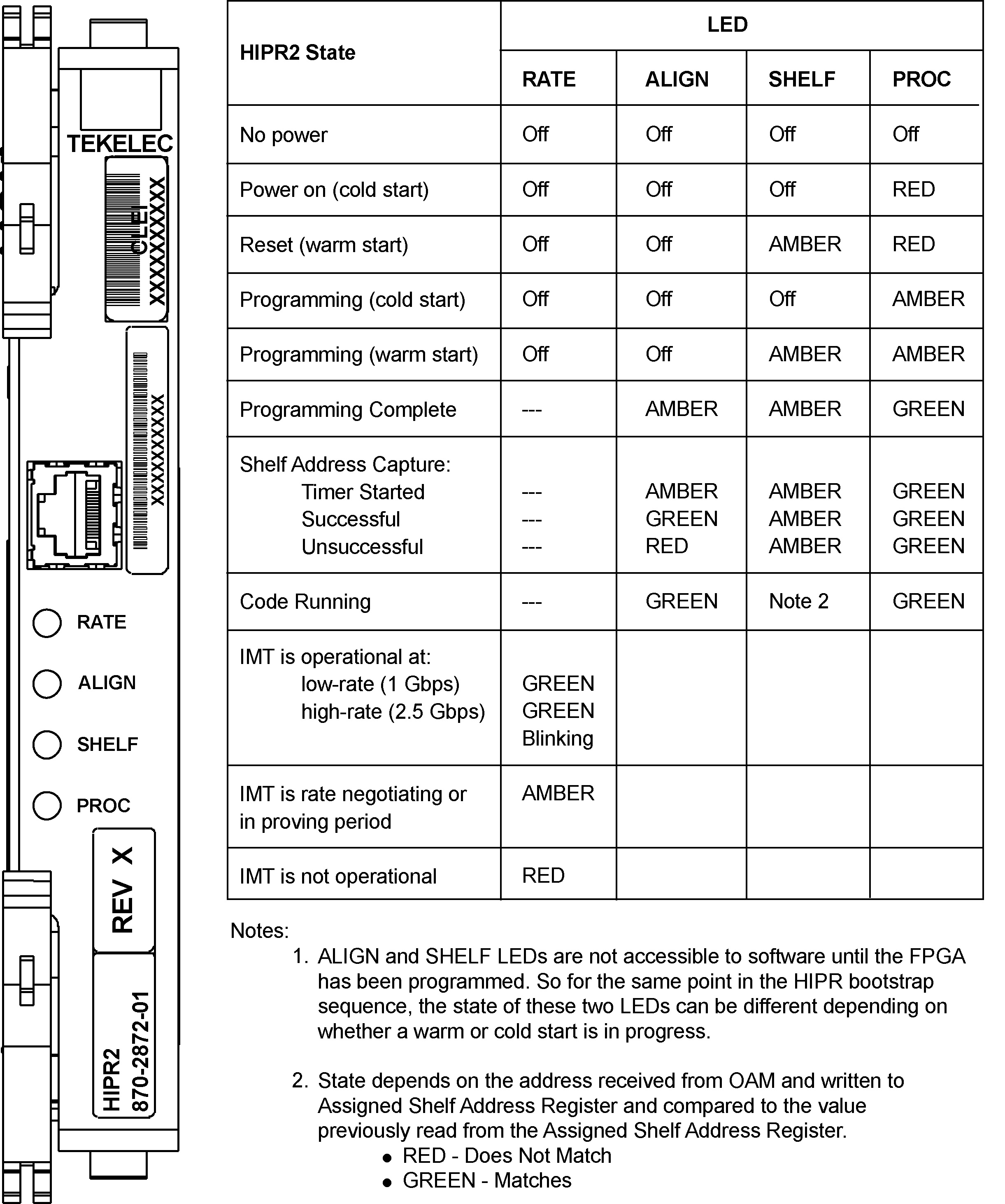

HIPR2, High-Speed IMT Packet Router 2 Module
Figure A-9 HIPR2 LEDs

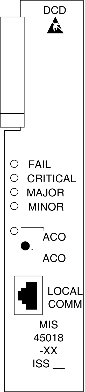

MIS, Maintenance Interface System, Holdover Clock
Figure A-10 Holdover Clock MIS Card LEDs
img/r-mis-maintenance-interface-system-holdover-clock-im-fig1.jpg
Table A-2 MIS LEDs
LEDs Descriptions
FAIL
RED – This card or its power supply has failed.
BLANK – No card or power supply failure detected.
CRITICAL
RED – Holdover clock system has failed.
BLANK – No holdover clock system failure detected.
MAJOR
RED – Holdover clock system or any holdover clock card has a major alarm.
BLANK – No major alarm detected.
MINOR
YELLOW – Holdover clock system or any holdover clock card has a minor alarm.
BLANK – No minor alarm detected.
ACO
GREEN – The ACO push button has been pressed to silence the alarm during an alarm state.

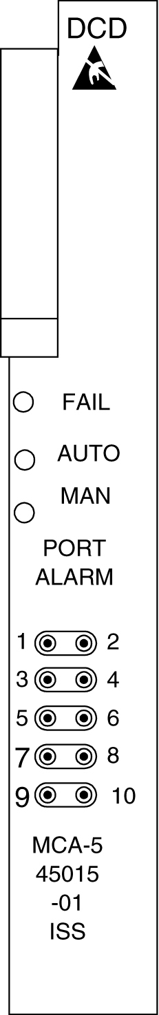

MCA, Matrix Controller Assembly Card, Holdover Clock
Figure A-11 Holdover Clock MCA Card LEDs
img/r-mca-matrix-controller-assembly-card-holdover-clock-im-fig1.jpg
Table A-3 MCA LEDs
LEDs Descriptions
FAIL
RED – This card has failed or there is a loss of all input references to this card.
BLANK – No card or input reference failure detected.
AUTO
GREEN – Indicates output failure was protected automatically.
BLANK – No failures detected.

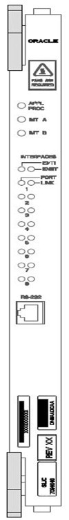

SLIC Module
Alarms and LEDs
The SLIC has 21 LEDs visible on the faceplate. The LEDs are visible with the aid of a light pipe, which directs the light from the LED to the front panel.
Figure A-12 SLIC Module
img/c-slic-front-oracle.jpg
Table A-4 SLIC Front Panel LEDs
LED Name Control Colors Definition
APPL FPGA / Application Software Off / Red / Green
Off - No power
Red - Card is booting
Green - Card is running Application
IMTA LIIC FPGA / Communication Software Red / Green
Red -Not connected to BUS
Green - Active and Connected to Bus
Amber - MUX card on the same shelf is seated and not inhibited; bus not available
IMTB LIIC FPGA / Communication Software Red / Green
Red - Not connected to BUS
INTERFACES E1/T1 FPGA / Application Software Green / Off
Green - Enabled
Off - Disabled
INTERFACES ENET FPGA / Application Software Green / Off
Green - Enabled
Off - Disabled
PORT1-PORT8 PHY / Application Software Off / Red / Green
Off - Not configured
Red - Cable removed and/or not synced
Green - 10/100Mb link speed
LINK1-LINK8 FPGA / Application Software Off / Red / Green
Off - No SLKS configured
Red - All Configured SLKS OOS
Green - All SLKS aligned
