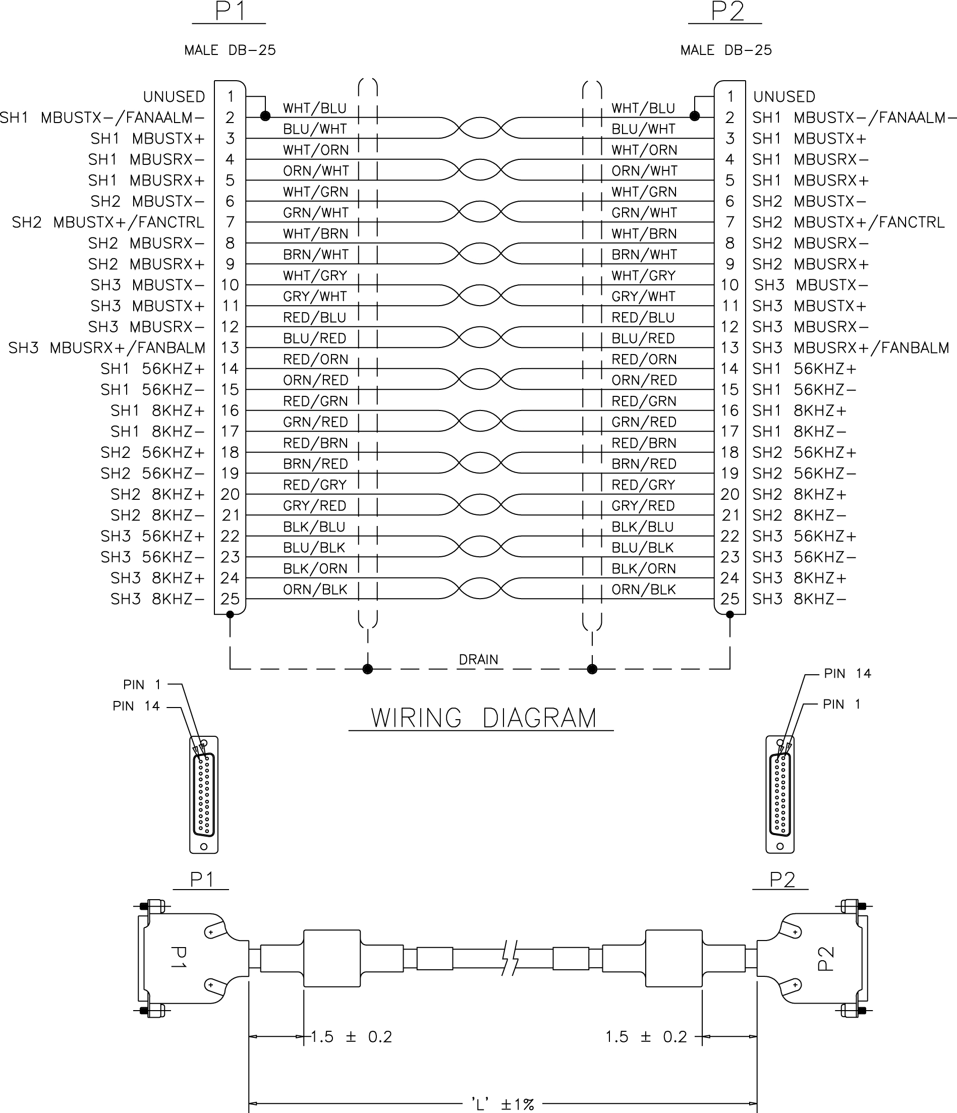

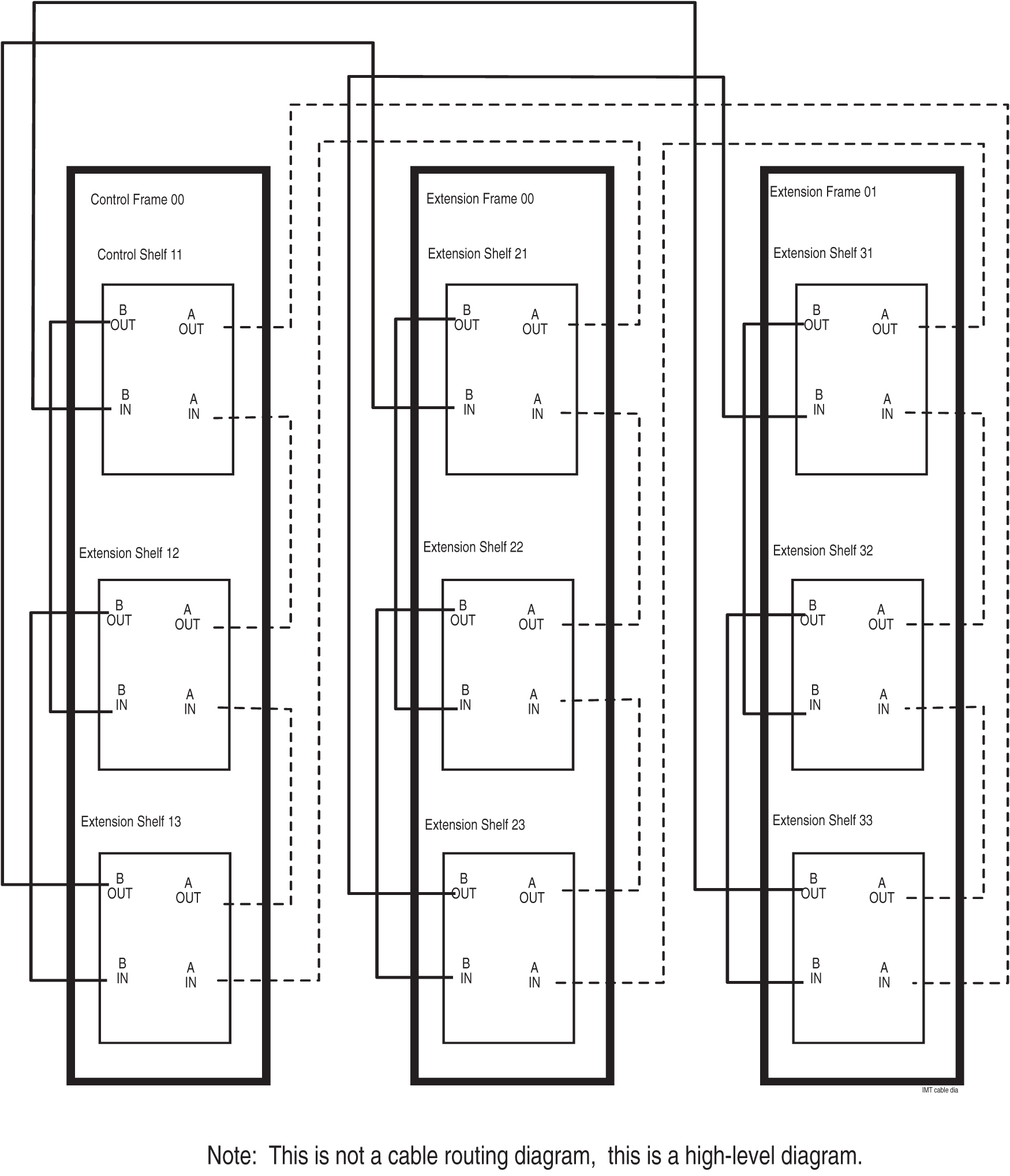

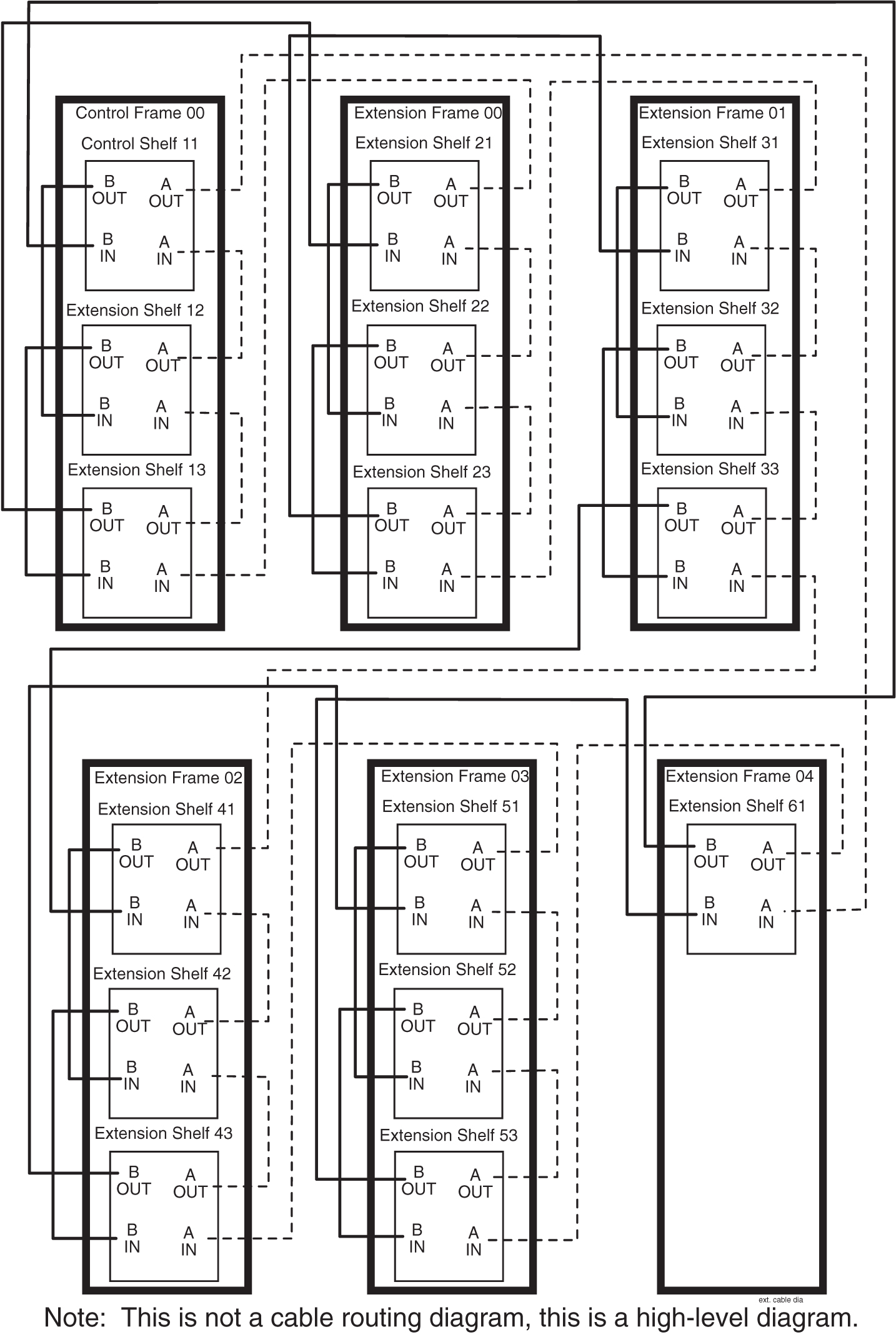

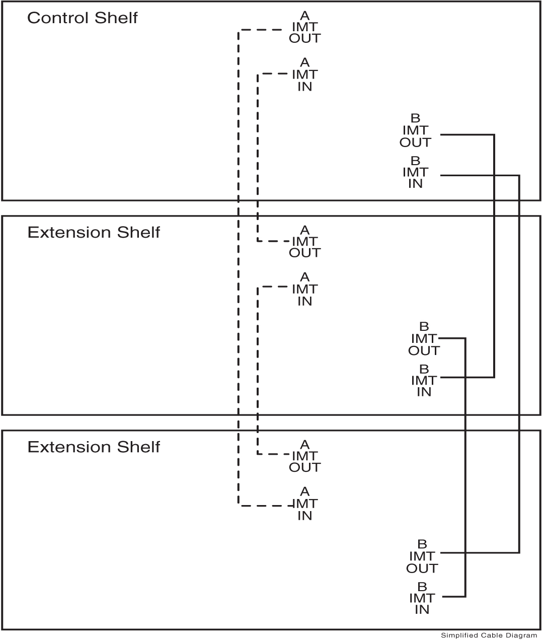

Install IMT Cables
The Interprocessor Message Transport (IMT) cables are specific lengths, based on their application. Termination information is furnished on the cable labels. Refer to Cables and Adapters and Part Numbers
danger:
Always wear a wrist strap or other electrostatic protection when handling printed circuit cards and other electrostatic-sensitive devices.
Procedure — Install IMT Cables
  1. Route the cable and connect to the backplane connector specified on the cable label.
    The IMT cables route down the left side of the frames, see Figure 6-4.
  2. For the IMT cables, tighten the barrel securely on each connector.
    Figure 6-1 Interprocessor Message Transport Cables
    img/t-install-imt-cables-im-fig1.jpg
  3. Dress each cable and secure with cable ties.
    Ensure that each cable tie strap is cut flush with the cable tie head so that no sharp edges are exposed.
    Figure 6-2 Three-Frame Configuration
    img/t-install-imt-cables-im-fig2.jpg
    Figure 6-3 Six-Frame Configuration
    img/t-install-imt-cables-im-fig3.jpg

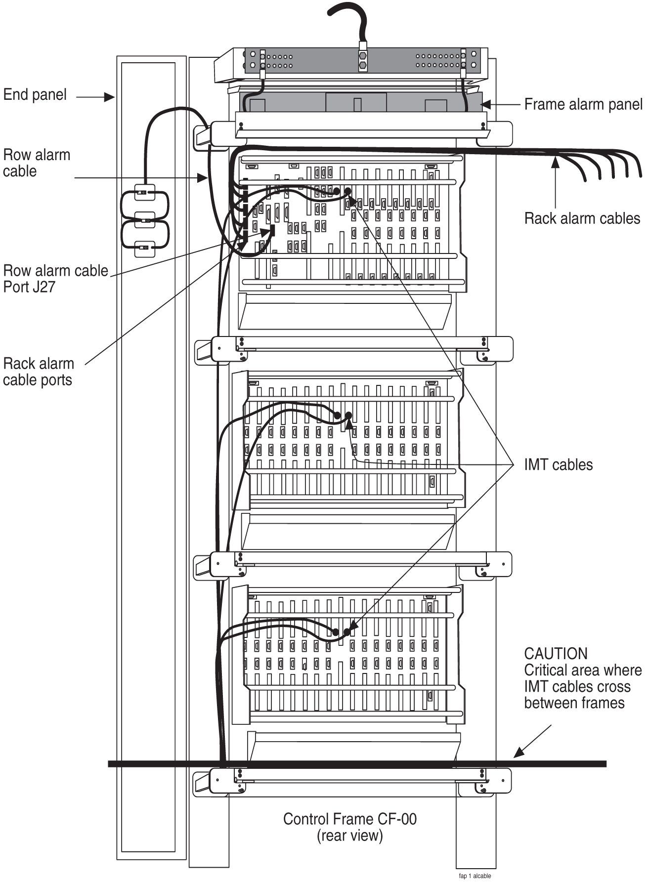

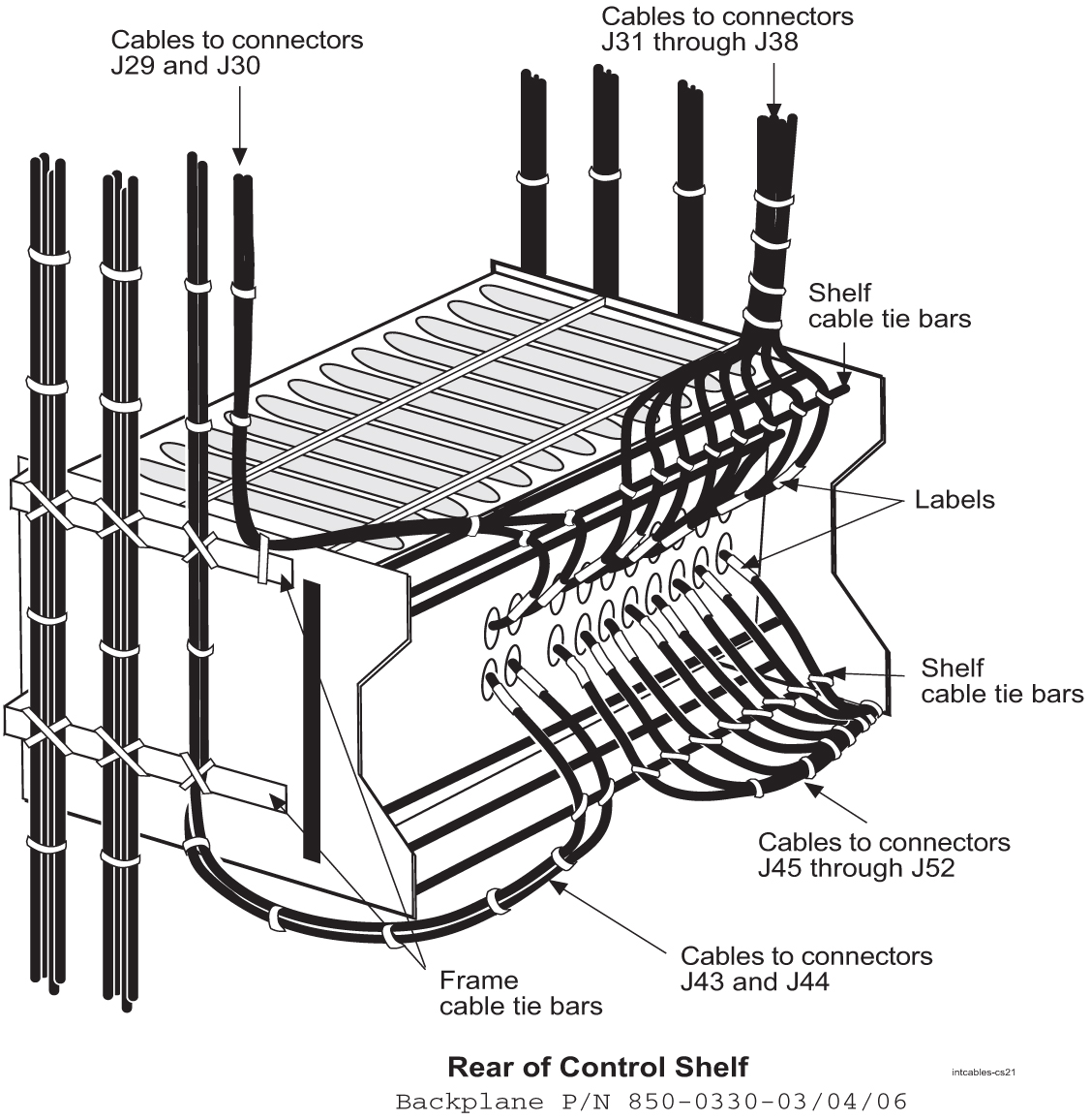

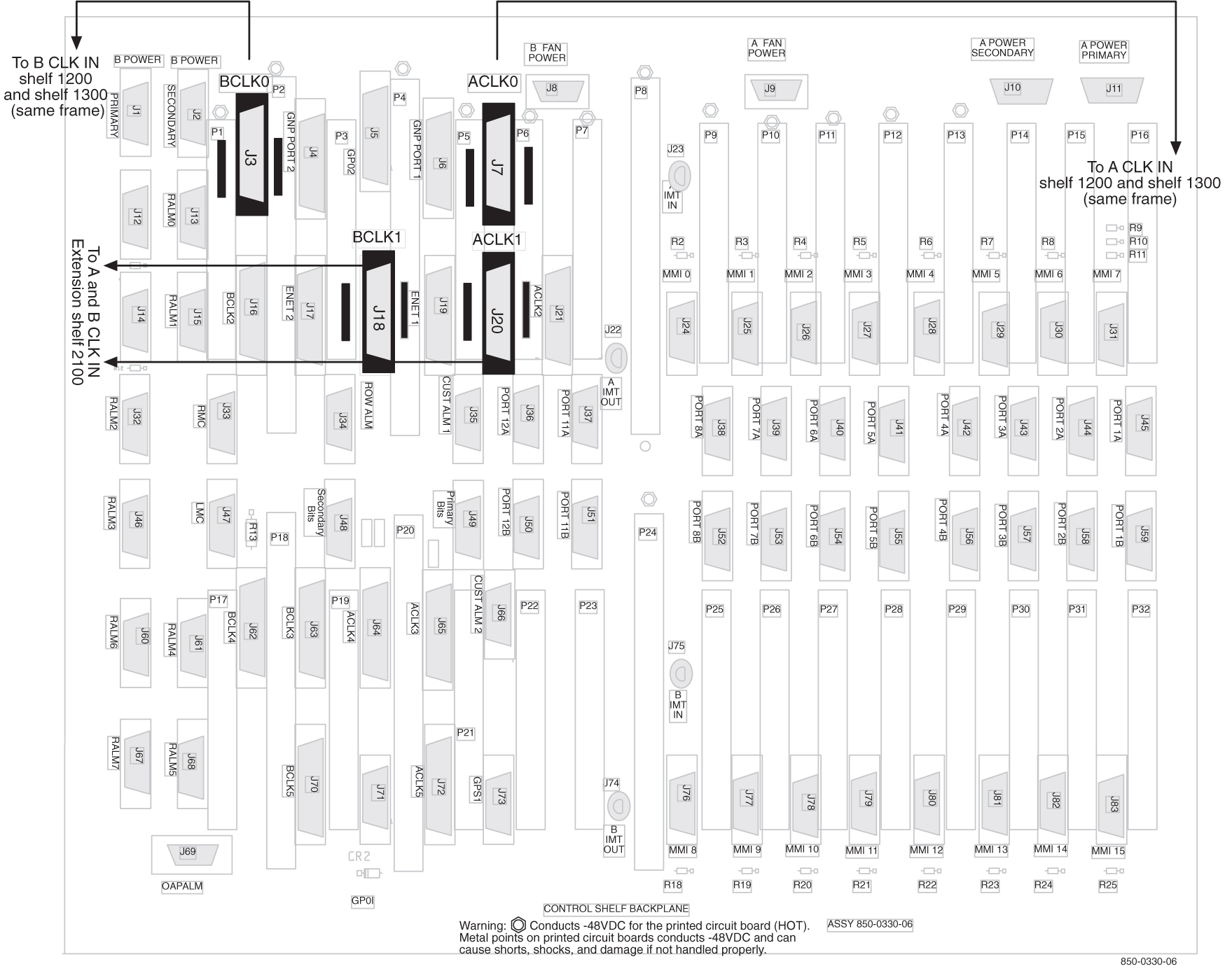

Rack Alarm and Row Alarm Cable Routing

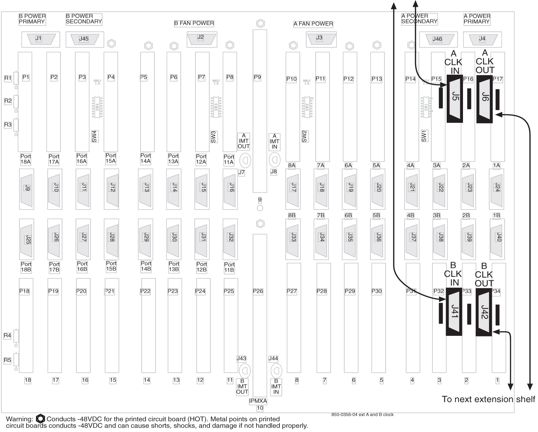

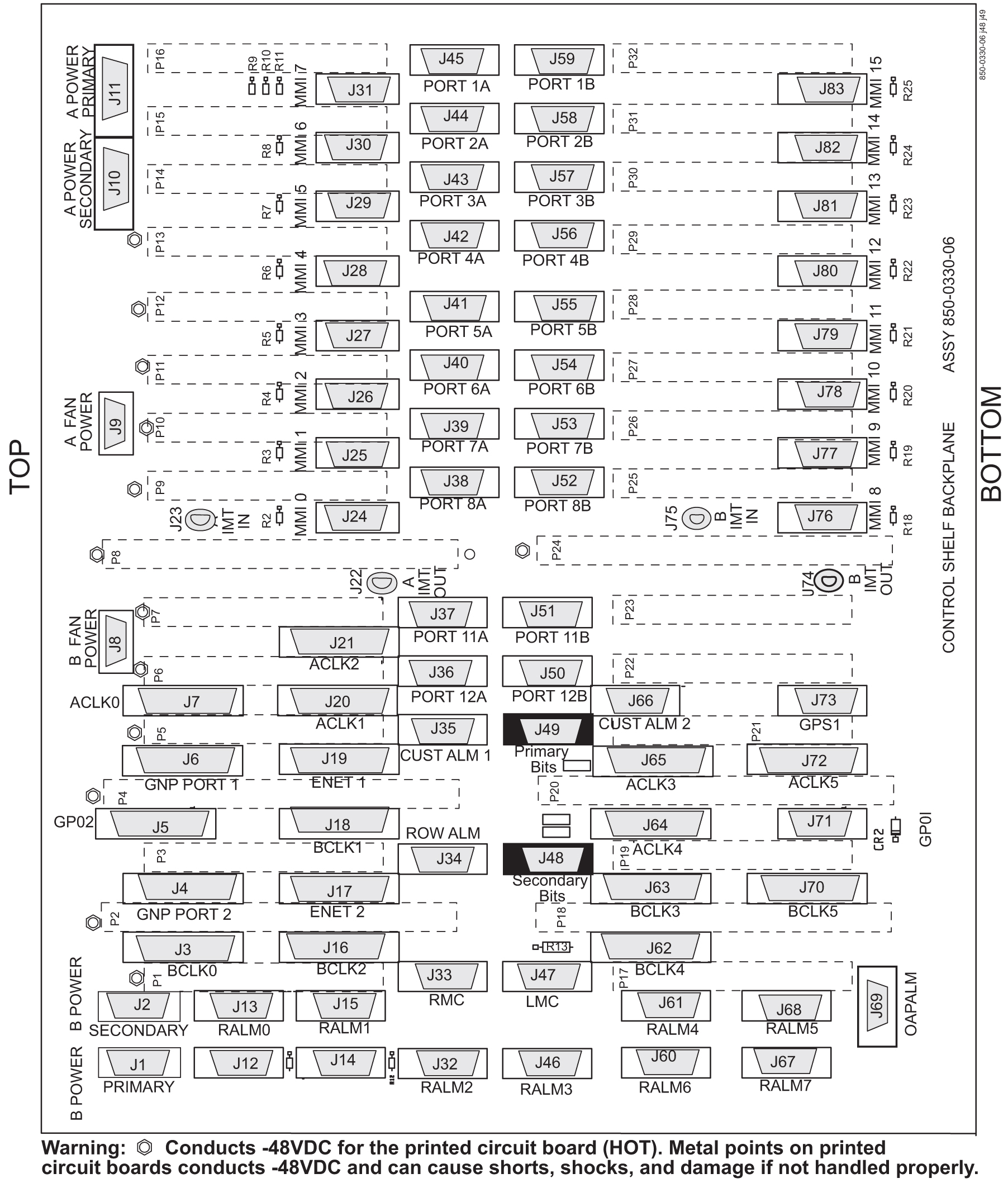

The rack alarm cable leads from ports in the control backplane and connects up to six frames in the row. See Figure 6-4 and A Clock and B Clock Cable Replacement.
The row alarm cable leads from J34 on backplane 850-0330-06/07 or 7333412 on the control shelf backplane and terminates in the control frame end panel.
The clocking and fan control signals used to support frame 6 and frame 7 are eliminated in the 850-0330-06 or -07 version and later of the Control Shelf Backplane because those frames are no longer supported in the EAGLE STP system.
Figure 6-4 Control Shelf Cabling
img/c-rack-alarm-row-alarm-cable-routing-im-fig1.jpg

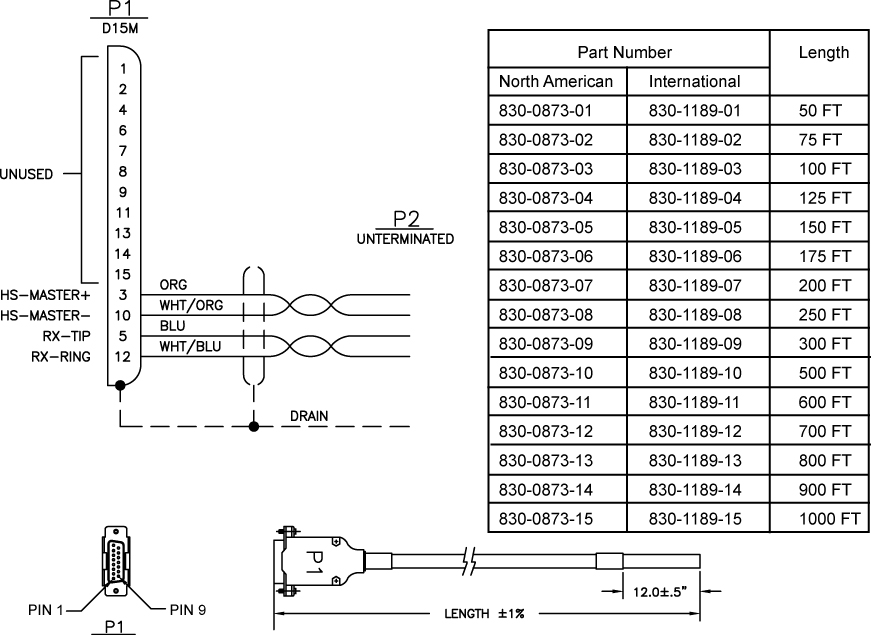

Interface Cable Installation
The procedure in this section is used to install the interface cables. The interface cables, one per signaling link, contain solid conductor twisted pairs for both directions of transmission in a single shield. They have connectors at one end for connection to the system backplanes.
Run Link Interface Module (LIM) cables on traverse arms, behind IMT and clock cables.

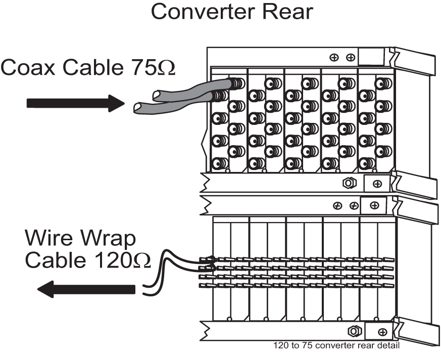

The ends without connectors are normally terminated on a DSX cross-connect panel with wire-wrap terminals.

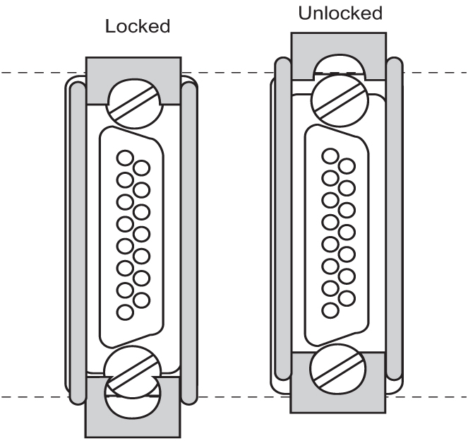

  1. Secure the connector to the designated receptacle on the DSX panel.

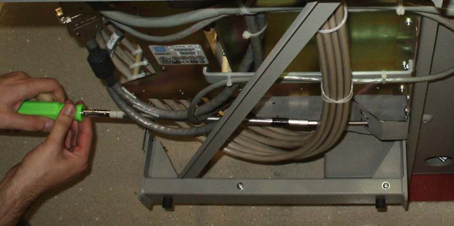

  2. Plug the connector in and turn one of the connector screws to start the screw into the threaded hole.
  3. Start the other screw into the other threaded hole.
    With both screws started alternate tightening the screws until both screws are snug, finger tight. Complete tightening to FIVE inch-pounds only, NO MORE or the screws will twist off and the connection can be broken.
    Tightening must be done in an alternating pattern.
    Termination information is furnished in the Cable Running List in the Equipment Specification for the site. See the Interface Cable Installation Order for a typical interface cable cross-connect panel connection.
    All cable ends must be labeled “TO” and “FROM” location information from Port to Backplane.

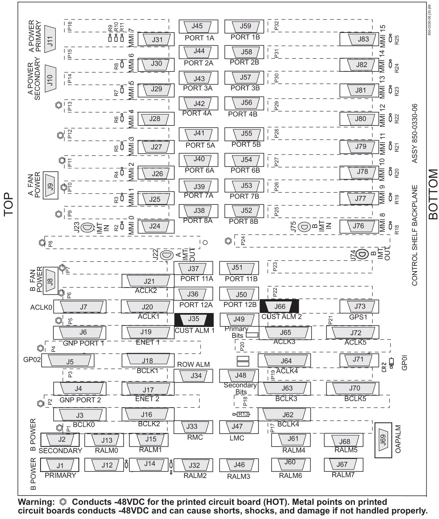

Control Frame CF-00 Backplane
(P/N  850-0330-04/06/07) or 7333412
Control shelf 11
1101 A through 1108 A (P/N 850-0330-06 or -07 connectors J45 through J38)
1101 B through 1108 B (P/N 850-0330-06 or -07 connectors J59 through J52)

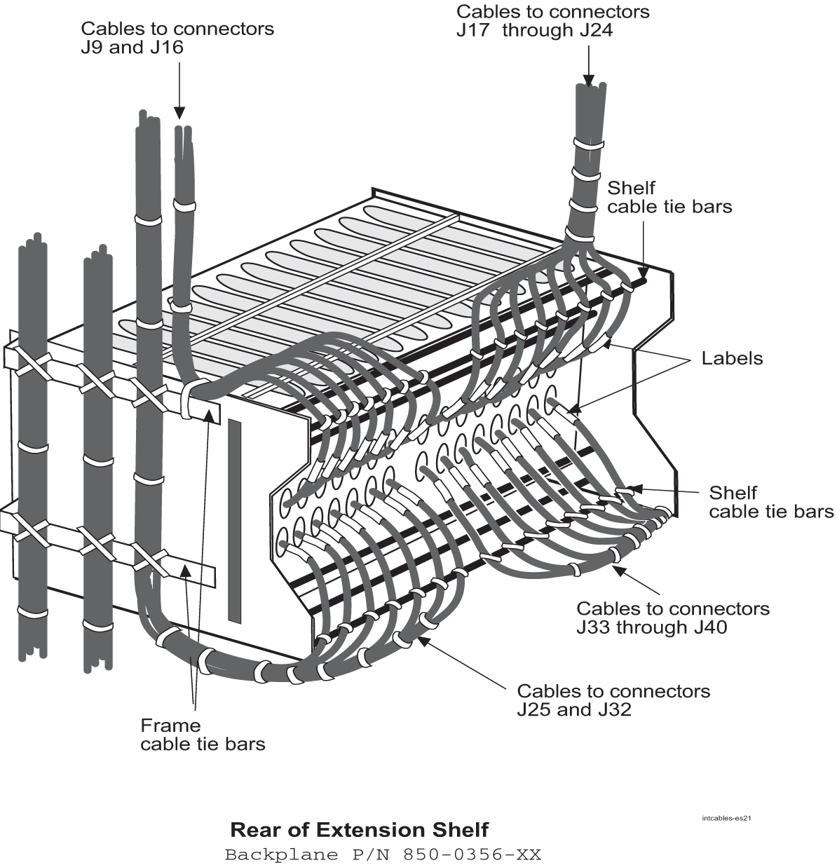

Examine the labels on the ends of the interface cables to determine the system backplane connection location “FROM” information on label and DSX cross-connect panel location “TO” information on label for each cable.
Run the cables on the cable rack to the cross-connect panel on the Miscellaneous Frame in groups of eight. There are four groups per extension shelf and groups per control shelf (a total of 20 per control shelf). The jack numbering on the cross-connect panel determines which side of the frame to run the cable. Viewing the frame from the rear, cables going to jacks #1 through #32 are run on the right side of the frame and cables #33 through #64 are run on the left side of the frame.
Procedure — Install Interface Cable
  1. Secure connector to its respective receptacle on the backplanes. See Interface Cable Installation.
  2. Tie cables to the shelf cable tie bar at the rear of the shelf.
  3. Pull slack from each cable towards the cross-connect panel.
  4. Dress cable bundles neatly and tie to the cable tie bars at the side of the frame.
  5. Lace the bundles to the cable rack.
    All cables must be laced onto the top traverse arms of each frame. Only lacing is used from the top traverse arms and above, on the frame and on the cable rack.
    Where the cable leaves the cable rack, the cable must be protected with fiber paper through out the system.

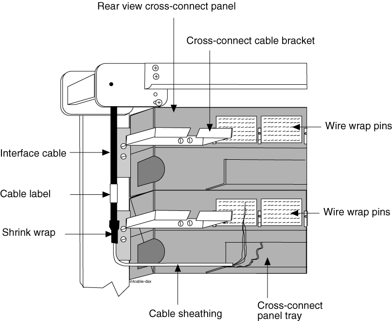

Procedure — Preparing Cables for Wire-Wrap
  1. Remove the insulation from the cable where it is even with the bracket of the associated cross-connect panel as shown in Figure 6-5.
    Do not remove the inner sheath.
  2. Attach the label for the cross-connect end of the cable approximately two inches above the end of the insulation.
  3. Apply a 1-1/2-inch length of 1/4-inch shrink-wrap tubing, taking care to center the tubing on the end of the cable insulation.
    Use heat gun to shrink tubing.
    Do not overheat the cable.
  4. Run the interface cable wires through the cross-connect panel cable tray.
  5. Remove the cable sheathing directly below the cross-connect jack.
  6. Cut the wires to length, strip and wire-wrap to the cross-connect panel.
  7. Cut the cable tie strap flush with the cable tie head.
    Figure 6-5 Interface Cable Cross-Connect Panel Connection
    img/t-recommended-tools-6-im-fig1.jpg
  8. Label DSX panel

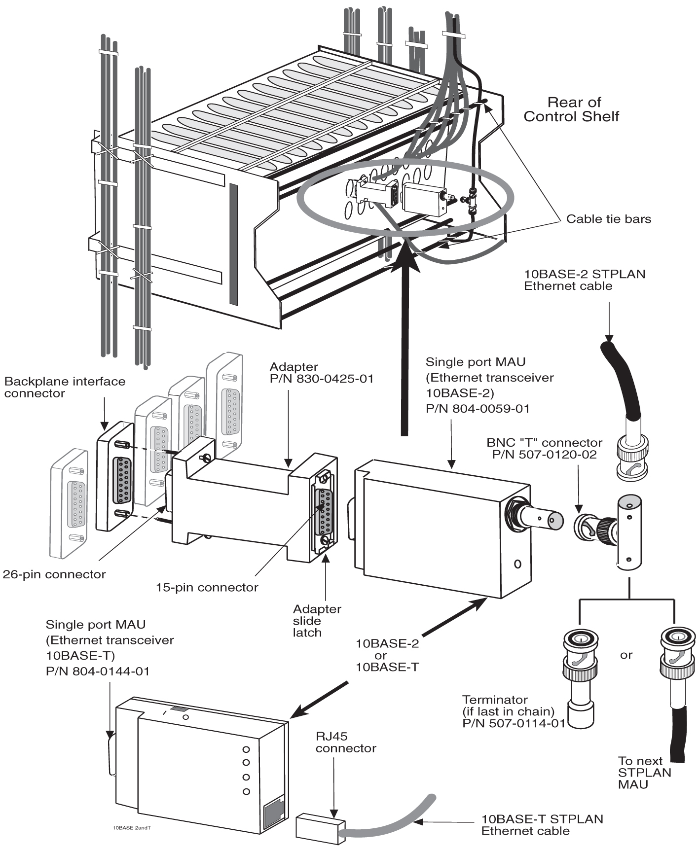

LAN Ethernet Cable Installation for ACM
This section contains the procedures for installing the Local Area Network (LAN) Ethernet cable, see Figure 6-7 for the location of equipment. The LAN provides selected data to a remote host system through an Ethernet network. In the system, communications with the host is interfaced through an Application Communication Module (ACM). Communications with the ACM is accomplished through:
  • The system backplane interface connector associated with that particular ACM
  • A 15-pin to 26-pin adapter
  • A single port Ethernet transceiver Media Access Unit (MAU)
  • A 10BASE-2 Thin net coax connection or 10BASE-T twisted pair connection to the Ethernet network
  1. Run each 10BASE-2 Thin net coax cable or 10BASE-T twisted pair cable from the Ethernet network onto the cable rack.
  2. Run each cable down the respective side of the system, outside the cable tie bars, and around the top or bottom edge of the terminating shelf.
    Use Table 6-1 to locate the ACM backplane interface connector for each Ethernet connection.
    The ACM location number in Table 6-1 consists of the shelf (left two digits) and the slot (right two digits) that contain the ACM. For example, an ACM location of 1108 indicates slot 08 of the Control Shelf (shelf 11). For ACMs located in an Extension Shelf, replace “XX” in the ACM location number with the number for that shelf (12, 13, 21, 22, 23, 31, 32, or 33).

    J45
    1102
    J44
    1103
    J43
    1104
    J42
    1105
    J41
    1106
    J40
    1107
    J39
    1108
    J38
    1111
    J37
    1112
    J36
    Backplane (P/N 850-0356-03) Connector
    Extension Shelves (XX is shelf location)
    XX01
    J24
    XX02
    J23
    XX03
    J22
    XX04
    J21
    XX05
    J20
    XX06
    J19
    XX07
    J18
    XX08
    J17
    XX11
    J16
    XX12
    J15
    XX13
    J14
    XX14
    J13
    XX15
    J12
    XX16
    J11
    XX17
    J10
    XX18
    J9
  3. Attach a BNC connector to the end of the 10BASE-2 coax cable.
    If necessary, attach an RJ45 type connector to the end of the 10BASE-T twisted pair cable.
  4. Secure each cable, see Figure 6-7 to its respective connector on the system backplane as follows:
    1. Plug the 26-pin side of the adapter into the backplane interface connector.
    2. Start one of the adapter connector screws, and then alternately tighten the two adapter screws.
    3. Ensure the adapter slide latch is in the unlocked (up) position see to Figure 6-6.
    4. Plug the single port MAU into the adapter.
    5. Move the adapter slide latch to the locked (down) position.
    6. For the 10BASE-2 MAU, push the BNC connector on the coax cable onto the MAU and lock the connector in place by twisting the connector clockwise.
      For a 10BASE-T MAU, push the RJ45 connector into the MAU until it snaps into place.

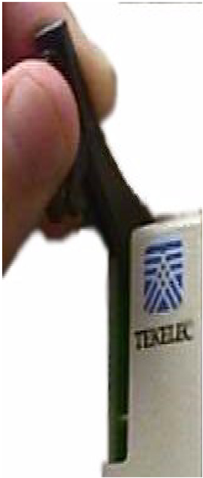

      Figure 6-6 Adapter Slide Latch
      img/t-recommended-tools-7-im-fig1.jpg
  5. Tie-wrap each cable to the cable tie bar at the rear of the shelf and then to the cable tie bars at the side of the frame.
  6. Pull the slack back toward the other end of the cables and lace to the cable rack.
  7. Ensure that each tie-wrap strap is cut flush with the tie-wrap heads so that no sharp edges are exposed.
    Figure 6-7 LAN Ethernet Cable Installation
    img/t-recommended-tools-7-im-fig2.jpg

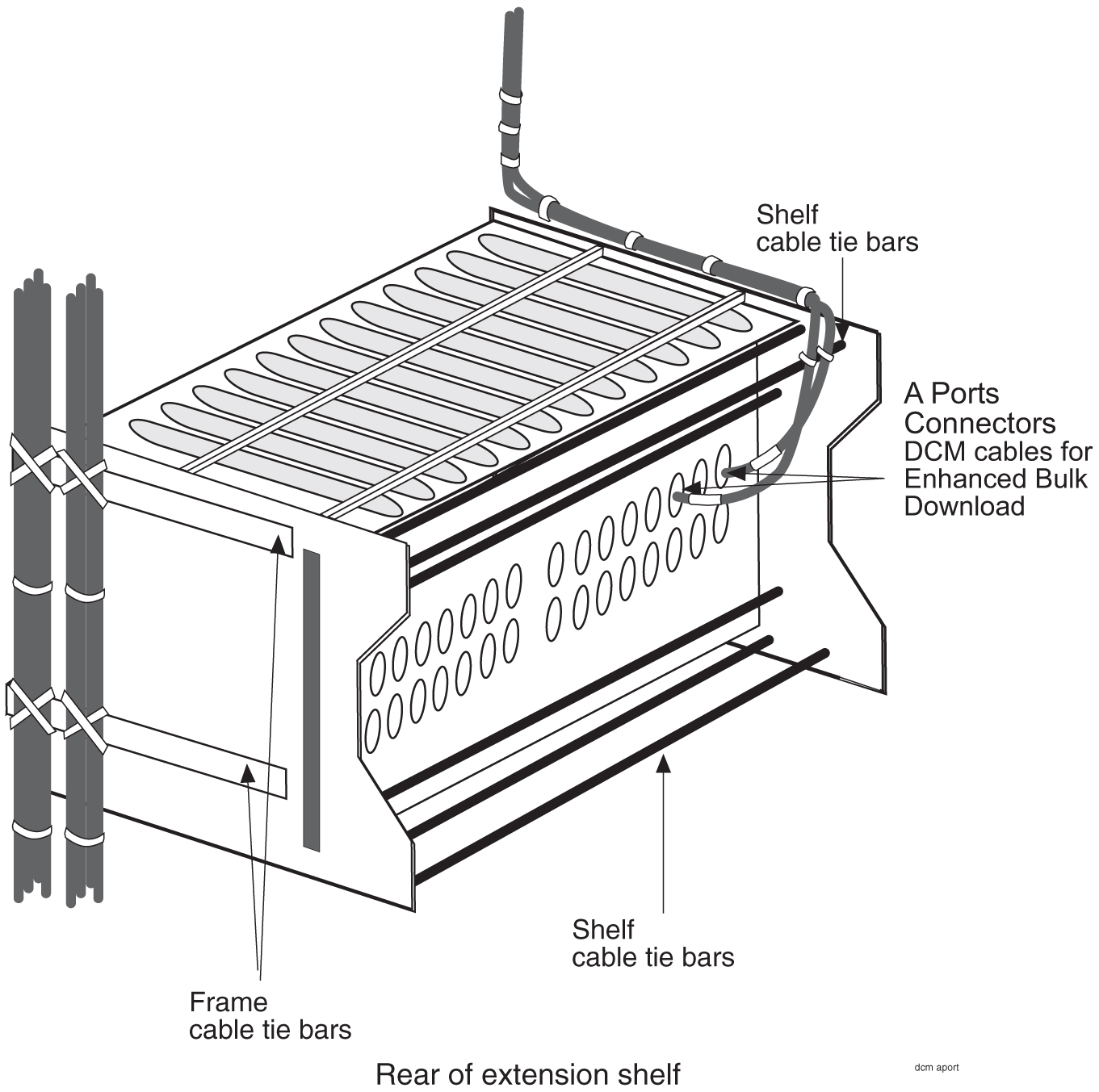

E5-ENET/E5-ENET-B and Fan Option, EDCM, E5-SM4G/E5-SM8G-B Cabling
E5-ENET/E5-ENET-B and EDCM Modules
The following cabling procedures apply to E5-ENET/E5-ENET-B,EDCM and E5-SM4G/E5-SM8G-B cards in the latest EAGLE.
  1. When the Database Communications Module (E5-ENET/E5-ENET-B) cards have been configured in the system, run the Ethernet cables straight through.
  2. The Ethernet cables have a DB26 connector on the system end, and a RJ45 on the other end of the cable.
    One cable is required for each E5-ENET/E5-ENET-B card.
  3. On the system end (DB26), if the card is in slots 1,3,5, or 7, the cable is run down the right side of the frame (as seen from the back of the frame).
    If E5-ENET/E5-ENET-B cards are in slots 11,13,15, or 17, the cables is run down the left side of the frame (as seen from the back of the frame).
  4. Run the cable off the side of the cable rack on the correct side of the frame.
    Route the cable down the traverse arms to the correct shelf location.
  5. Route the cable around the top edge of the shelf and connect it to the A connector, of the odd numbered card slot where the E5-ENET/E5-ENET-B card is located, see Figure 6-8.
    Caution:
    Always trim tie-wrap flush and turn the trimmed tie-wrap to the rear of the cable bundle when facing the rear of the frame.
  6. All cable ends must be labeled “TO” and “FROM” location information on both ends.
    Figure 6-8 E5-ENET/E5-ENET-B Family Cabling, Enhanced Bulk Download
    img/t-dcm-fan-option-edcm-edcm-dsm-cabling-im-fig1.jpg
    Figure 6-9 Interface Cable Routing, Control Shelf
    img/t-dcm-fan-option-edcm-edcm-dsm-cabling-im-fig2.jpg
    Figure 6-10 Interface Cable Routing, Extension Shelf
    img/t-dcm-fan-option-edcm-edcm-dsm-cabling-im-fig3.jpg

  1. Locate the card to be removed.
    To ensure no loss of service, be sure to check that the green LED on the card is not lit when you remove the card.
  2. Push the inject/eject clamps outward from the card’s faceplate (top clamp in the “UP” position, bottom clamp in the “DOWN” position). Pull the levers away from the shelf until they are parallel to the floor.
    Gently pull the card towards you until the card clears the shelf.
    Figure 6-11 Push Inject/Eject Clamps Outward
    img/t-removing-card-existing-eagle-5-iss-system-im-fig1.jpg
  3. Place the card you have removed in an electrostatic discharge (ESD) protective container, or place the card in the spare card storage shelf.
  4. Be sure that the replacement card has the same part number and revision number as the card you have just removed (unless this is an upgrade).
  5. Open the ejector levers on the replacement card.
    Carefully align the card’s edges with the top and bottom card guides. Then push the card along the length of the card guides until the rear connectors on the card engage the mating connectors on the target shelf backplane.
  6. Press the front of the card’s faceplate using constant pressure until you feel the card’s progress cease.

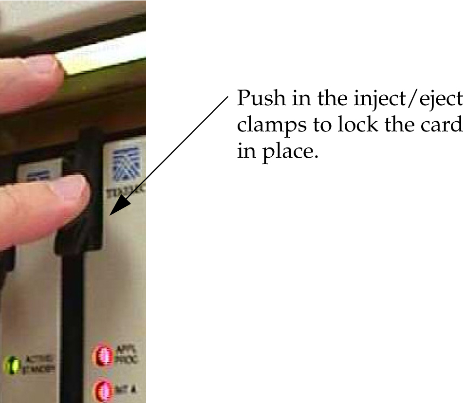

  7. Push in the top and bottom inject/eject clamps.
    This locks the card in place and ensures a strong connection with the pins on the target shelf backplane.
    Figure 6-12 Push in Inject/Eject Clamps

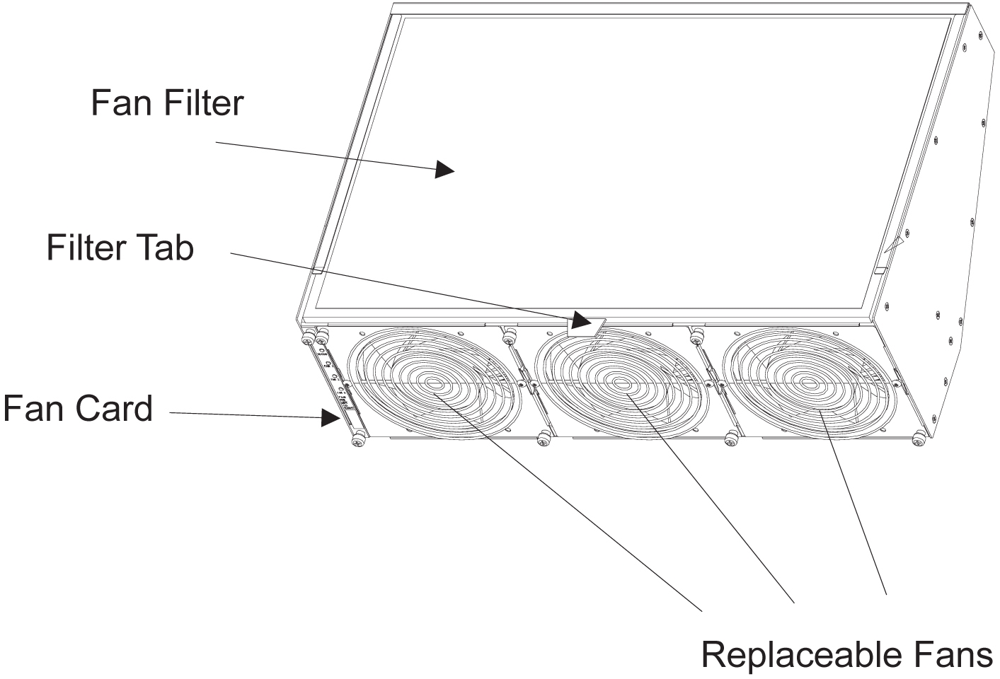

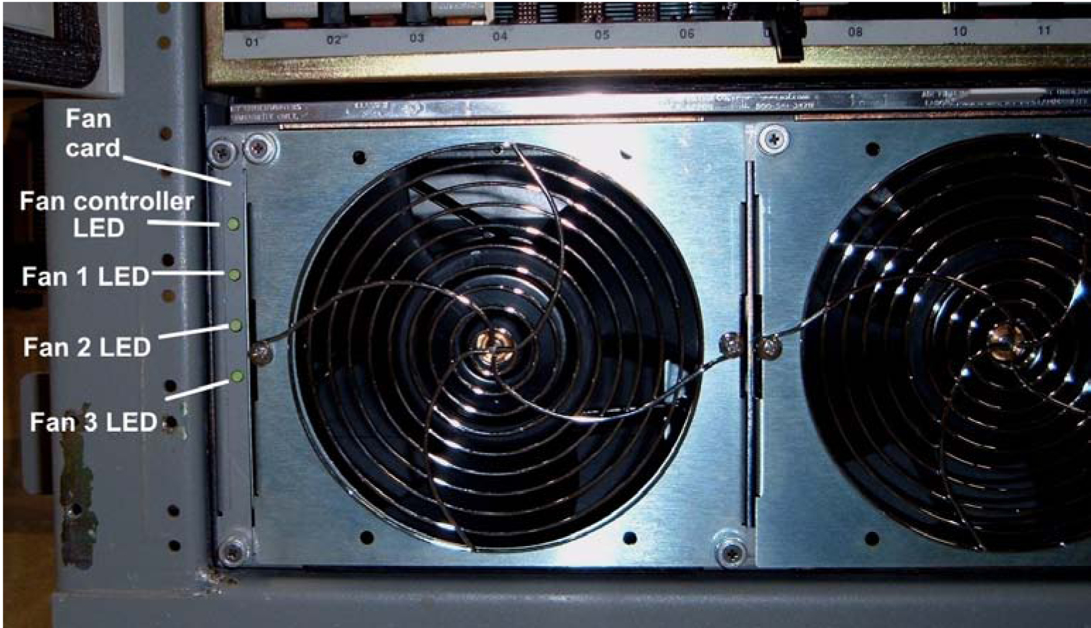

Fan Assembly Installation and Cabling
warning:
Do not carry exposed metal keys or tools in pockets or on belts when working on or around system equipment.
warning:
Do not wear metal rings, watches, or jewelry on wrists or hands when working on system equipment or other related electrostatic sensitive components. Always wear a wrist strap or other electrostatic protection when handling printed circuit cards and other electrostatic sensitive devices.
Caution:
Be sure to install the fan assembly 890-0001-04 before installing the HCMIM card.

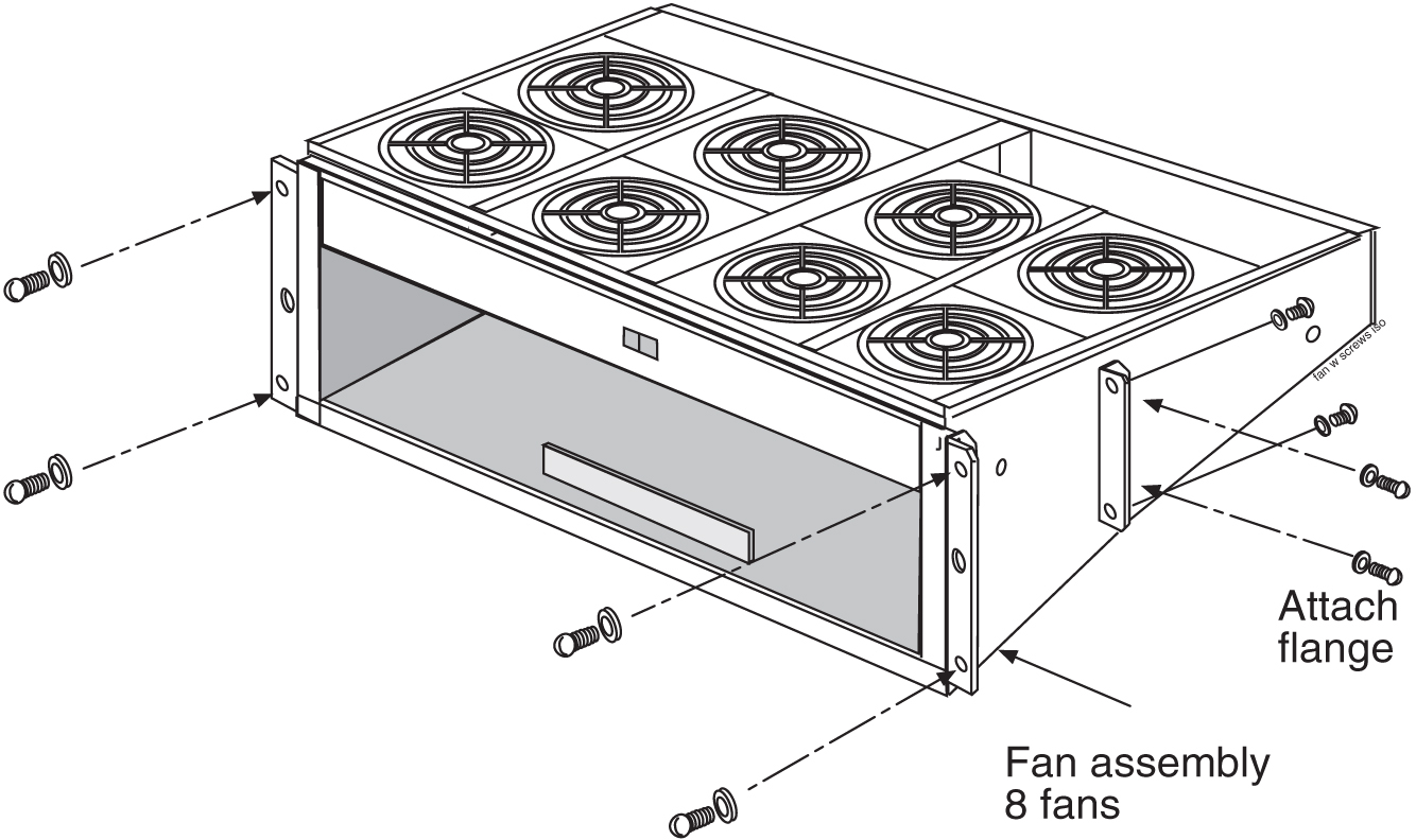

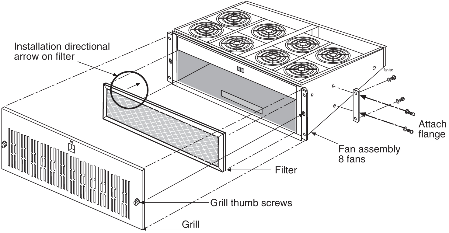

This section shows how to install the optional Fan Assembly 890-0001-04 and Fan Assembly 890-1038-01/890-1038-02. All of these fan assemblies can be installed in the standard frame and the Heavy Duty Frame. Be sure to determine which type of frame you have before performing these procedures.
Installing Fan Assembly 890-0001-04
Beginning with EAGLE software release 33.0, all systems with HCMIM cards must have the 890-0001-04 fan assembly installed.
Tools needed:
  • #1 Flat screwdriver
  • #2 Philips screwdriver (long)
  • Fiber Paper (Approximately 2’ x 3’)
  • 5/16” ratchet socket wrench
  • Tie Wraps
Procedure — Install and Retrofitting Fans

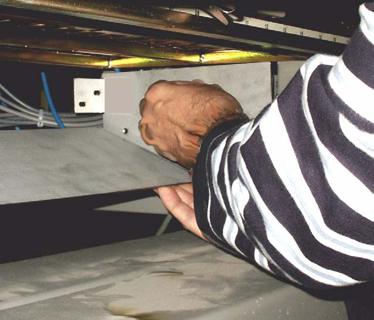

  1. Determine which shelves will have HCMIM modules installed and be aware of hardware that needs to be retained or installed in a specific way.
  2. Place a piece of fiber paper on the top of the shelf below where the fan is to be installed to ensure that nothing will drop into equipment below the new fan.

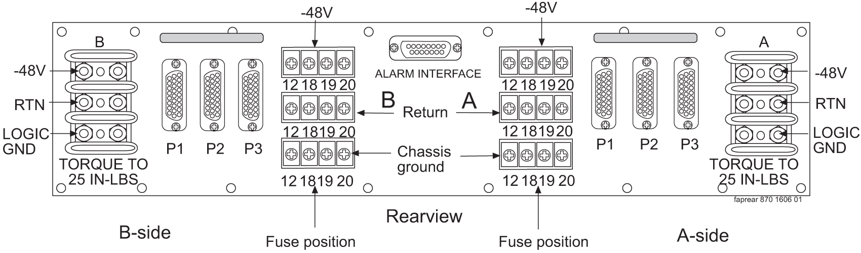

  3. Make sure to pull both dummy fuses from the appropriate fuse locations for the A and B fan power. Use the following guidelines to determine fuse locations:
    • The fuse card located on the Fuse and Alarm Panel is marked FAN A and FAN B. Fuse positions 6, 12, and 18 are the correct locations on the FAP faceplate.
    • Fuse position 6 is for the fan unit directly below the x100 shelf.
    • Fuse position 12 is for the fan directly below the x200 shelf.
    • Fuse position 18 is for the fan directly below the x300 shelf.
    • All fans are to be fused at 3As, with blue flags, per feed. Fill out the fuse card completely.
    • Ensure the FAP fuse location for the fan is properly labeled.

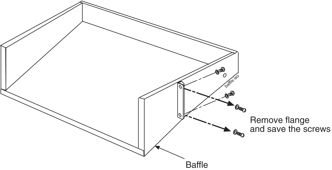

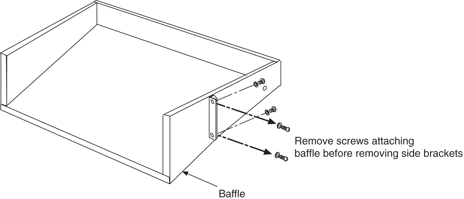

  4. If you are installing the fan assembly into an existing frame, remove the four screws (two on each side) that attach the air baffle to the mounting brackets. Do not remove the screws holding the side brackets to the frame at this time. Support the baffle while you remove the screws.
    Figure 6-13 System Air Baffle
    img/c-installing-fan-assembly-890000104-im-fig1.jpg
  5. Remove the baffle through the front of the frame. Then, remove the two screws holding the left and right side baffle brackets to the frame and remove the brackets.
  6. Install the new side brackets for the new fan tray into the frame. The side brackets are installed from the front of the frame just below the shelf containing that cards that require the fan. Use the 12-24-x1/2 screws provided to attach the brackets to the left and right front frame rails. The top screw hole is 5/16 inch below the shelf containing the cards. Be sure not to completely tighten the brackets at this time.
    Figure 6-14 Attach side fan bracket to front frame rail
    img/c-installing-fan-assembly-890000104-im-fig2.jpg

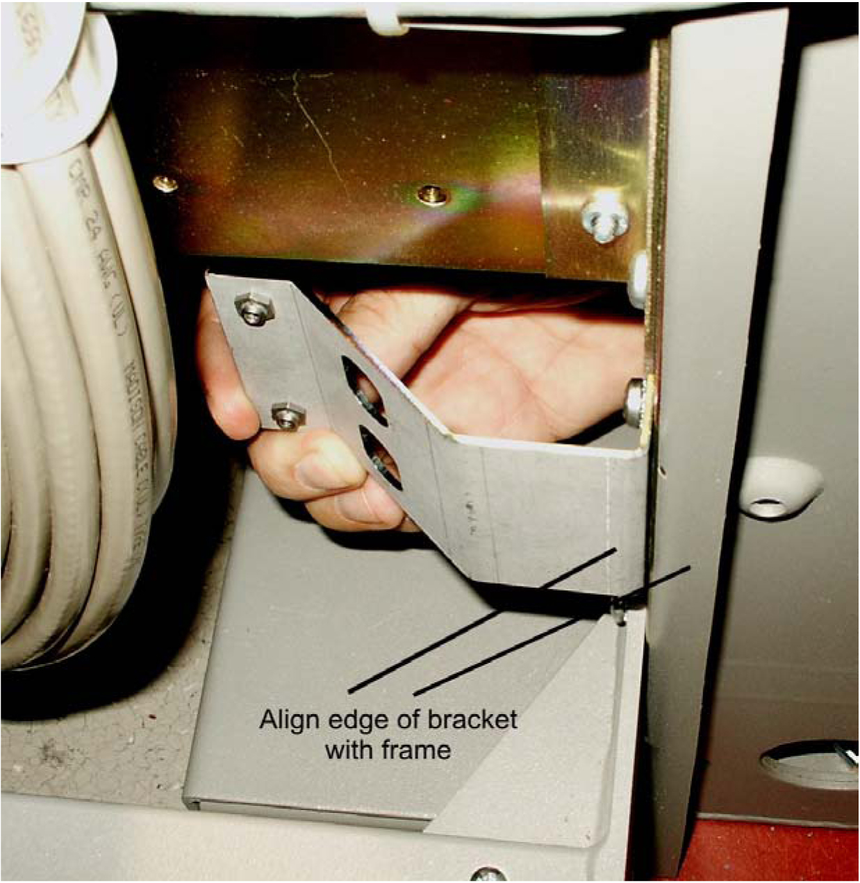

  7. Slide the brackets in toward the center of the frame so the outside of the bracket is flush with the side of the frame as shown in Figure 6-15.
    Figure 6-15 Slide the side fan brackets flush with the Frame
    img/c-installing-fan-assembly-890000104-im-fig3.jpg

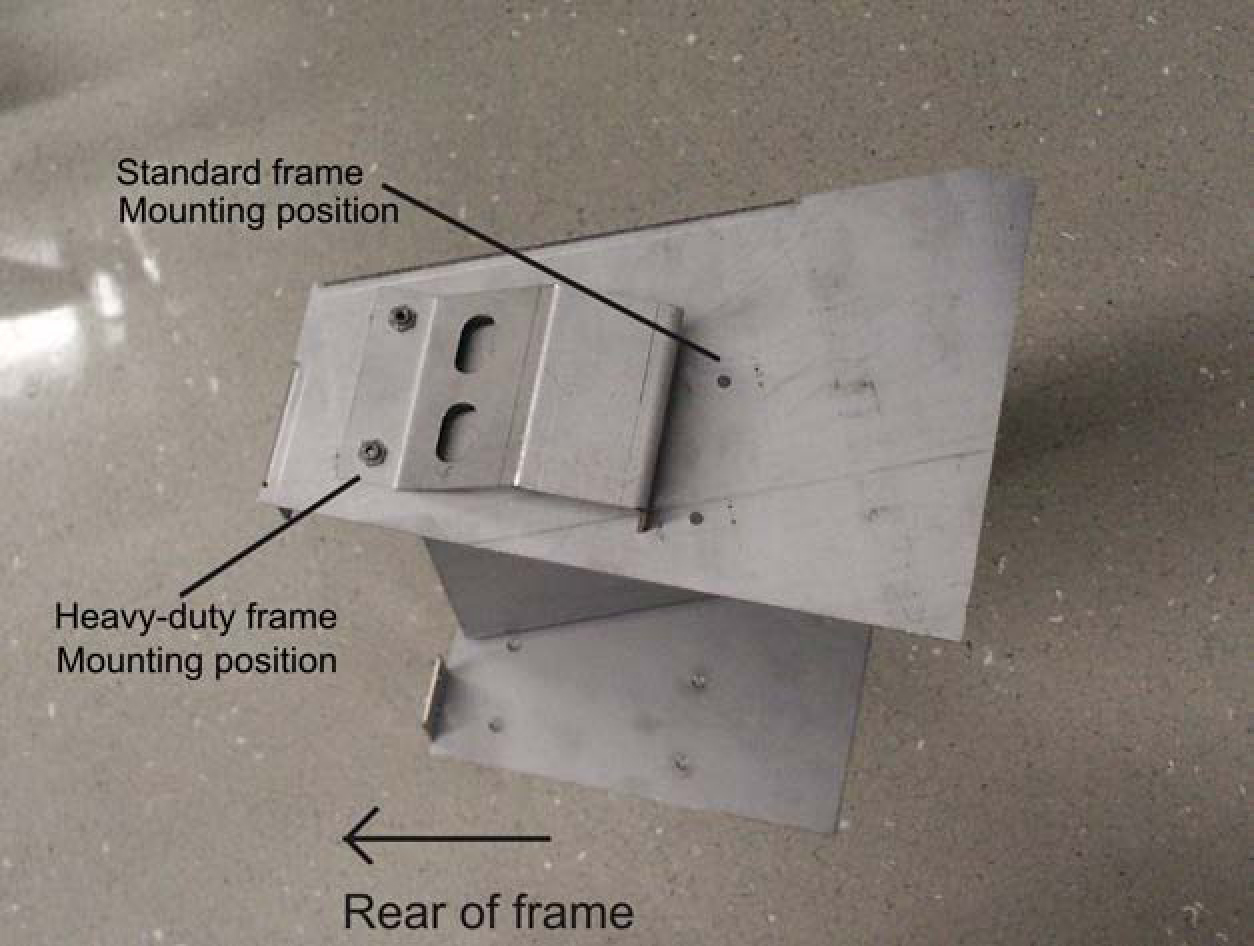

  8. Verify whether the frame type is a standard or heavy duty so that you can ensure the fan tray bracket will be mounted correctly. Use the following mounting positions:
    • Use the side holes on the fan tray bracket that are closest to the front of the frame if you are installing in a standard frame.
    • Use the holes closest to the rear of the frame if installing in a heavy duty frame.
      Figure 6-16 Side bracket mounting positions on fan tray bracket.
      img/c-installing-fan-assembly-890000104-im-fig4.jpg

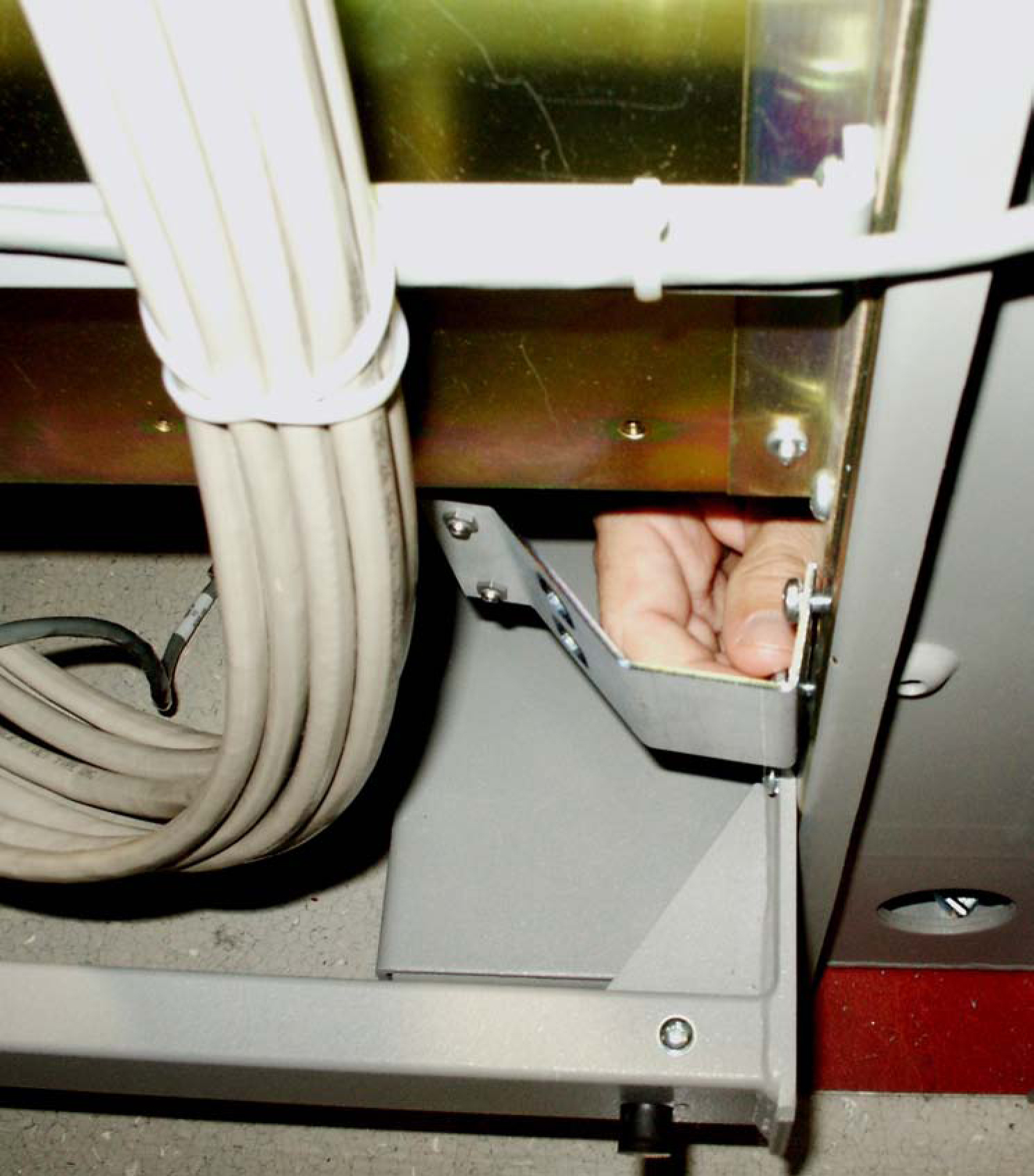

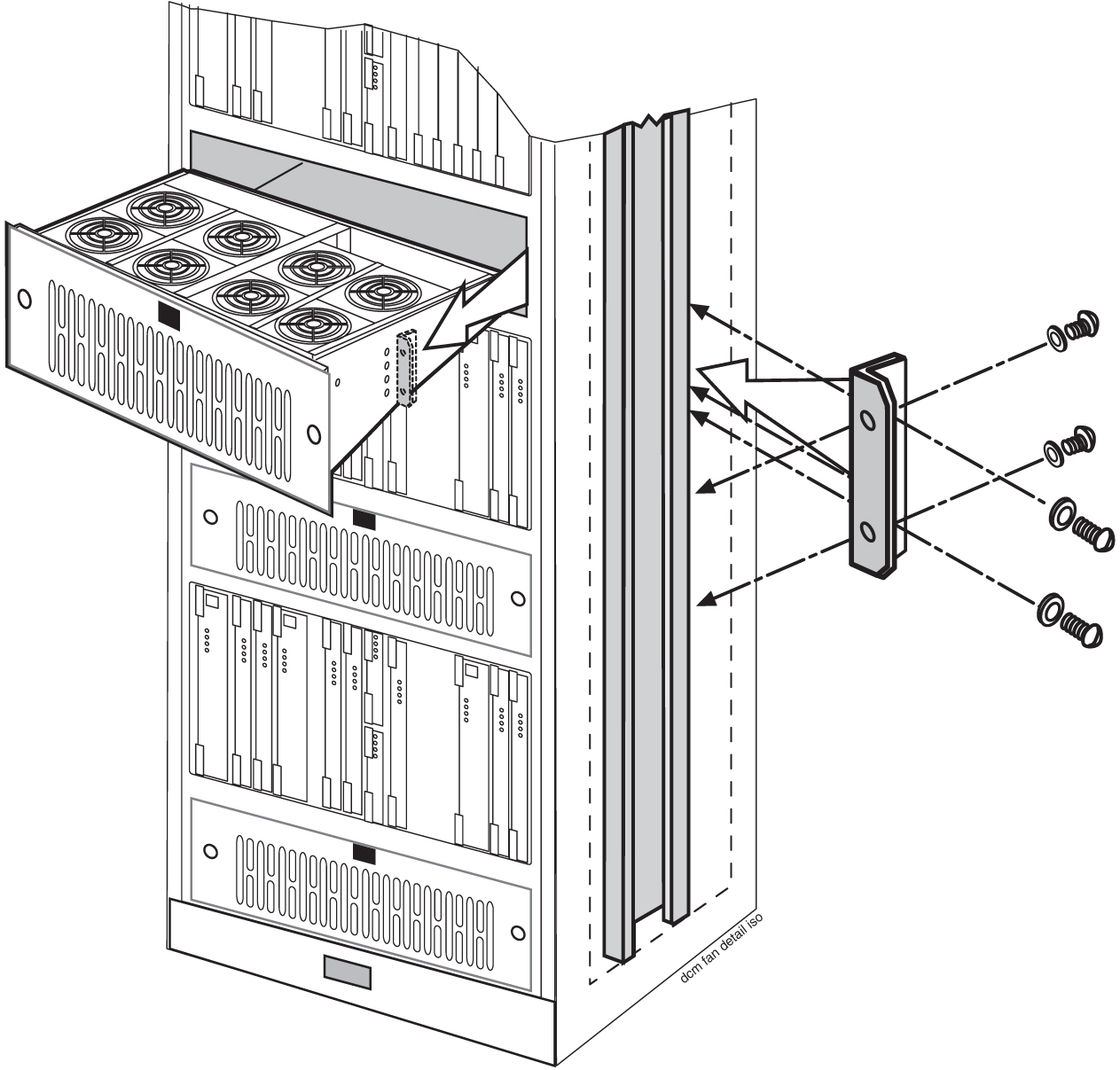

  9. Insert the fan tray bracket (P/N 652-0012-01) into the space left by the baffle under the card shelf. The untightened side brackets will slide outward slightly to accommodate the fan tray bracket as it is inserted. They should remain flush against the fan tray bracket.
    Figure 6-17 Insert fan tray bracket
    img/c-installing-fan-assembly-890000104-im-fig5.jpg
    When inserting the fan tray bracket, be sure not to pinch cables between the bottom of the shelf and the fan tray bracket.
  10. From inside the frame, screw the fan tray bracket to the side brackets with one hand while using the other hand to support the fan tray bracket. Use two 8-32 phillips screws for each side bracket. See Figure 6-18.
    Figure 6-18 Attaching the fan tray bracket to the side brackets - inside front
    img/c-installing-fan-assembly-890000104-im-fig6.jpg

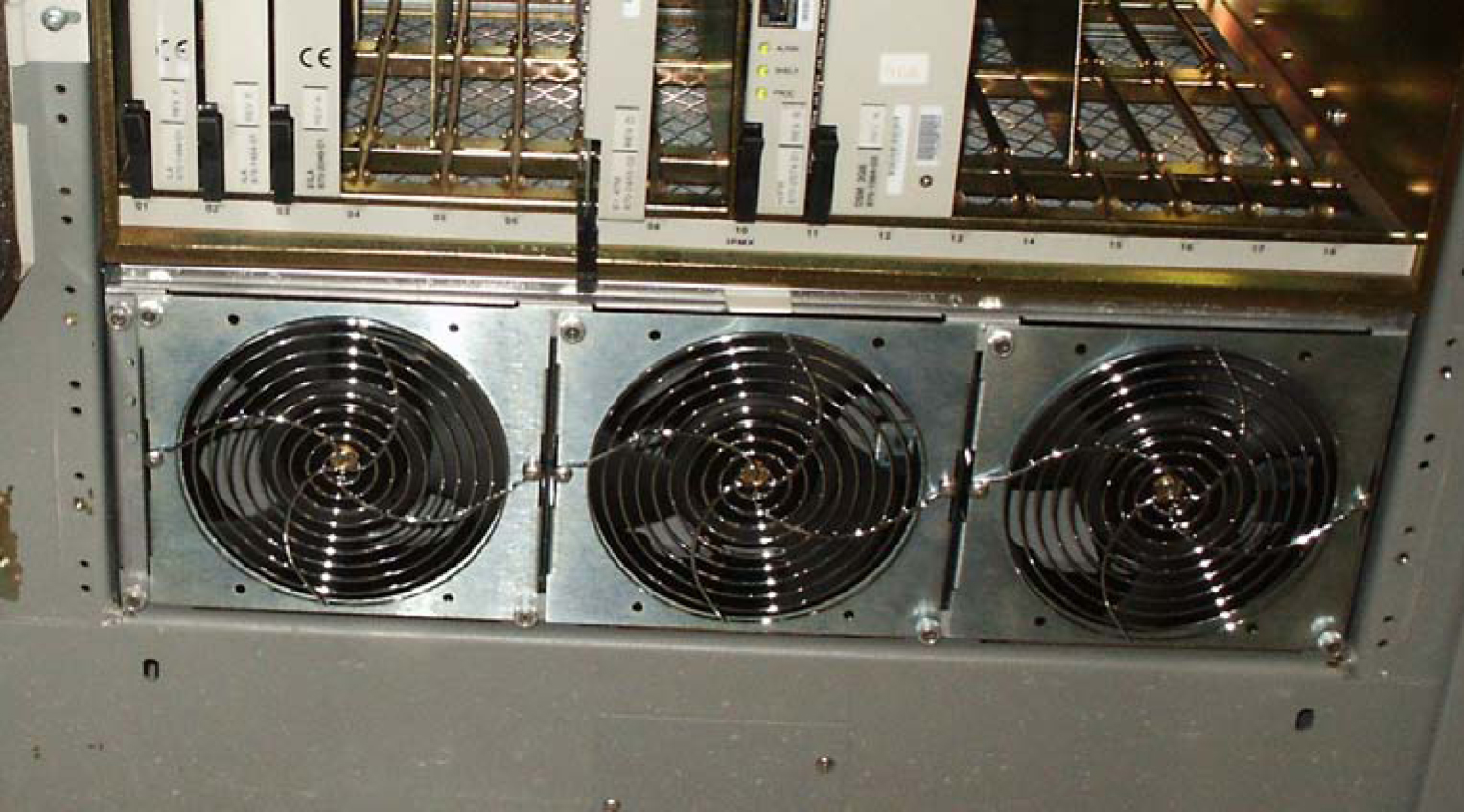

  11. Remove the new fan tray from the container. The fan tray is shipped with the three fans already installed.
    Figure 6-19 Fan Tray
    img/c-installing-fan-assembly-890000104-im-fig7.jpg
  12. Insert the fan tray into the fan tray bracket. You might need to tilt the fan tray up as it is pushed in so that it is completely inserted into the bracket. After insertion, be sure the front of the fan tray is recessed in 1/2 inch with respect to the front frame rails.
    Figure 6-20 Fan tray inserted into fan tray bracket in the frame- front view
    img/c-installing-fan-assembly-890000104-im-fig8.jpg

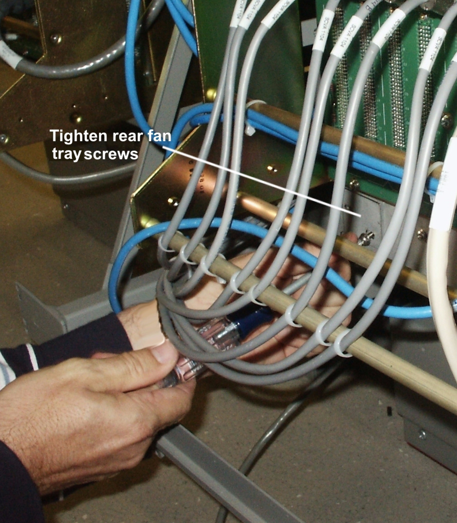

  13. When the fan tray is aligned and in place, attach the fan tray to the fan tray bracket by tightening the screws on the left and right sides of the rear of the fan tray bracket. There are two screws on each side. These screws must be tightened from the rear of the frame.
    Figure 6-21 Tighten rear fan tray screws
    img/c-installing-fan-assembly-890000104-im-fig9.jpg
  14. At this time check and tighten all screws, including the screws holding the side brackets to the frame. The side bracket screws should be tightened fully from the rear of the frame. Use a long hex driver or flat head screw driver.
    Figure 6-22 Tighten fan side bracket screws
    img/c-installing-fan-assembly-890000104-im-fig10.jpg
  15. Remove the piece of fiber paper on the top of the shelf below where the fan assembly was installed. This procedure is complete.
    Caution:
    Before powering up the fans, ensure that the shelf directly above the fan does not contain any empty slots. Install an air management card in any empty slots to ensure proper air flow. These filler cards have no electrical connection to the system. See Card Installation and Replacement for general card installation guidelines.

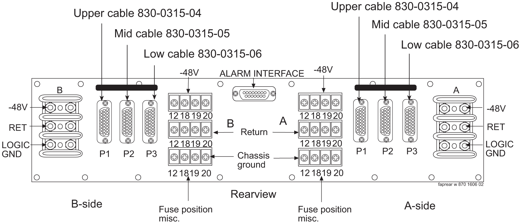

Installing Fan Cables

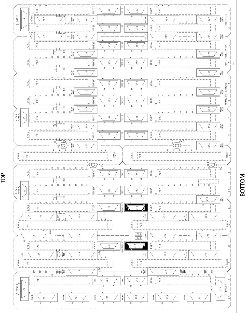

On the control and extension shelf backplanes, the connectors are marked A FAN POWER and B FAN POWER.
  • Control shelf:
    On backplane (P/N 850-0330-06 or -07) the connectors are A FAN POWER, J-9 and B FAN POWER, J-8.
    These connectors are located at the upper middle of the backplane on both the control shelf and the extension shelves.
  • Extension shelf: The backplane connectors are A, J-3 and B J-2.
  • For A fan power:
    The fan cable 830-1157-01 is included with the fan assembly. Plug one end of the cable into J-9 on the backplane. Route the cable to the left of the frame, faced from the rear, and to the assembly, to the connection marked FAN A POWER.
  • For B fan power:
    Plug one end of the cable 830-1157-01 into J-8 on the backplane. Route the cable to the right of the frame, faced from the rear, and to the fan assembly, to the connection marked FAN B POWER. Form and dress the two cables together and check the security of all of the connections.
  1. To cable the fan assembly, plug a cable onto the shelf on backplane FAN A POWER, and connector J9.
    Tighten the screws on the connector.
  2. When the cable is connected to the backplane route the cable to the top tie-down rod and secure the cable with a tie-wrap.
  3. Route the cable to the right side of the frame.
    Run the cable between the shelf and the traverse arms.
    Caution:
    Do not form the cable with the LIM cables.
  4. Secure the fan cables to the back side of the traverse arm using tie-wraps.
  5. Plug the other end of the cable onto the fan unit connector marked FAN A POWER.
  6. The other fan cable (P/N 830-0690-01) plugs into the backplane connector J8.
  7. Route the cable out to the top tie down rod and secure it using a tie-wrap.
    Run the cable down between the shelf and traverse arm.
    Caution:
    Do not form FAN POWER cables with LIM cables.
  8. Secure the cables to the back side of the traverse arms using tie-wraps.
  9. Plug the other end of the cable onto the fan unit connector marked FAN B POWER.

  2. Fifteen seconds after both the A side and B side power is connected to the fan assembly all of the LEDs on the fan controller card (located on the left side of the front of the fan assembly) are green.
    Figure 6-23 Fan card with LEDs on front of fan assembly
    img/t-powering-fan-assembly-im-fig1.jpg

  1. Determine where the fan assembly will be installed and be aware of hardware that needs to be retained or installed in a specific way, see Figure 6-25.
  2. Place a piece of fiber paper on the top of the shelf below where the fan is to be installed, to ensure that nothing will drop into the area and equipment below.
    1. The fan unit is secured with the same screws that are removed from the frame holding the baffle in place.
    2. The brackets are installed from the rear of the frame using the screws provided with the brackets (standard frame).
    3. When the brackets are attached, secure them to the frame using external tooth washers and four screws.
  3. Remove the four screws, two on each side, from the mounting brackets on the frame that hold the baffle in place, on both sides.
    This will allow the removal of the baffle.
    Figure 6-24 System Air Baffle
    img/t-installing-fan-assembly-890103801-or-890103802-im-fig1.jpg
  4. Place the screws in a safe place because they are used later in this procedure.
  6. Remove the fan unit from the container and remove the grill and filter from the unit assembly.
    The fan is shipped with the side flange not attached. Set the grill and filter in a safe location; it will be used later in this procedure.
    Figure 6-25 Fan Assembly with Grill and Filter
    img/t-installing-fan-assembly-890103801-or-890103802-im-fig2.jpg

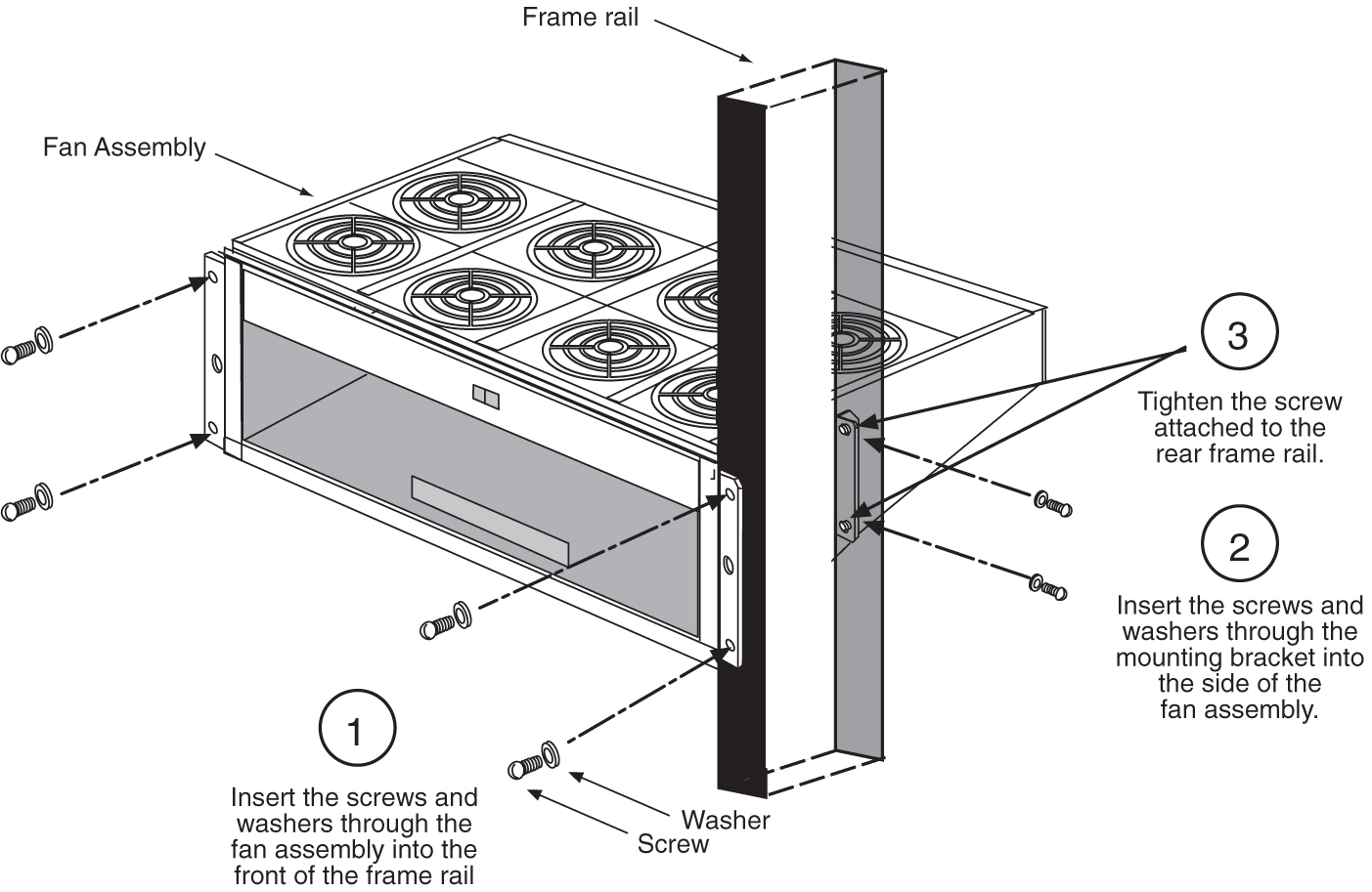

  7. Install the fan unit in the space left by the baffle.
    Figure 6-26 Installing Fan Assembly
    img/t-installing-fan-assembly-890103801-or-890103802-im-fig3.jpg
    Figure 6-27 Fan Bracket Installation
    img/t-installing-fan-assembly-890103801-or-890103802-im-fig4.jpg
  8. Secure the fan unit with the same screws that were removed from the frame holding the baffle in place.
    Do not tighten the screws at this time to allow for some minor adjustment. See Figure 6-27.
    When mounting the fan unit, be sure not to pinch cables between the bottom of the shelf and the fan unit.
  9. From the front of the frame, install the four screws and tighten.
    At this time, check and tighten all screws
    Figure 6-28 Fan with Brackets and Screws
    img/t-installing-fan-assembly-890103801-or-890103802-im-fig5.jpg
  10. Return to the back of the frame and tighten the screws in the mounting brackets into the side of the fan unit.
  11. When the fan unit is aligned and in place, tighten the screws in the brackets on the sides of the frame.
  12. Reinstall the fan filter.
    The filter has an arrow stamped on the top edge to indicate the direction of the air flow. The arrow points toward the fans.
  13. Install the fan grill, placing it back on the front of the unit and FINGER TIGHTEN the thumb screws on the front of the grill.
  14. Remove the piece of fiber paper on the top of the shelf below where the fan is to be installed.
  • Control shelf:
  • For A fan power:
    The fan cable is included with the fan assembly. Plug one end of the cable into J-9 on the backplane. Route the cable to the left of the frame, faced from the rear, and to the assembly, to the connection marked FAN A POWER.
  • For B fan power:
    Plug one end of the cable into J-8 on the backplane. Route the cable to the right of the frame, faced from the rear, and to the fan assembly, to the connection marked FAN B POWER. Form and dress the two cables together and check the security of all of the connections.

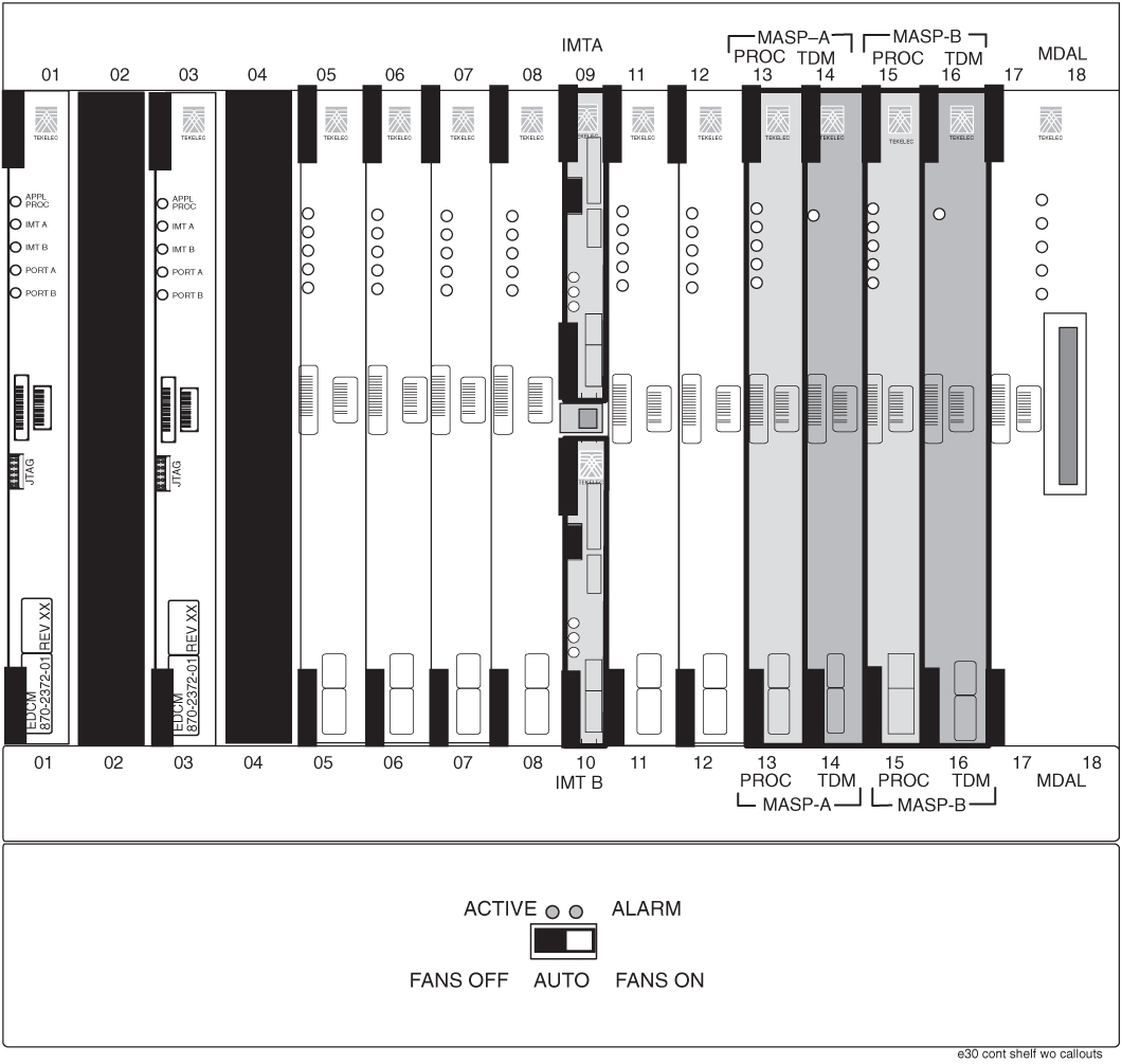

  2. When the fan units are powered up, the switch in the middle front of the fan unit must be turned to the ON position.
    Do not set the switch to the AUTO position.

Procedure — Replace or Add HS source Timing Clock Cables with backplane (P/N 850‑0330‑06/07)
  1. Before starting the cable replacement, physically locate the:
    • primary and secondary composite clock and high‑speed clock connections at the backplane of the customer composite clock source (customer will provide positions).
    • existing composite clock cables (P/N 830‑0226‑xx) that are routed from the primary and secondary composite clock connections of the customer clock source to the Primary BITS and Secondary BITS clock connectors J49 and J48 on the control shelf. Figure 6-31 shows the location of these connectors on the control shelf backplane.
    Figure 6-31 Control Shelf (P/N 850-0330-06 or -07) BITS Connectors
    img/t-replacing-b-frame-clock-cables-im-fig7.jpg

  9. At the output panel of the customer composite clock source, locate the end of the composite/BITS clock cable (P/N 830‑0226‑xx) that was disconnected in 8 and remove all wires.
  10. Connect the new high‑speed source clock and composite cable (P/N 830‑0873‑xx or P/N 830‑1189‑xx) to the site HS clock source.
    1. Cut the wires to length and strip.
    2. Wire‑wrap to the appropriate IDLE (primary or secondary) clock connections on the customer clock source. Refer to the cable wire coding (P/N 830‑0873‑xx or P/N 830‑1189‑xx) shown in Figure 6-32 for connection information.
      • Connect the HS clock source to the orange and white/orange wires.
      • Connect the composite clock source to the blue and white/blue wires.
    Figure 6-32 Wire Coding of High‑Speed source and Composite Clock Cable (P/N 830‑0873‑xx or P/N 830‑1189‑xx)
    img/t-hs-clock-cable-830-0873-1189.jpg
  11. Connect P1 of the high‑speed source and composite clock cable (P/N 830‑0873‑xx or P/N 830‑1189‑xx) connector end to the appropriate IDLE ckock connector(J48 or J49). Tighten the connector with a slotted screw driver.
    After the cable (P/N 830‑0873‑xx or P/N 830‑1189‑xx) wires are attached correctly to the site clock sources and connected to the control shelf (J48 or J49), the EAGLE terminal returns the message that alarms have been cleared:

  17. At the output panel of the customer composite clock source, locate the end of the composite/BITS clock cable (P/N 830‑0226‑xx) that was disconnected in 15 and remove all wires.
  18. Connect the new high‑speed source clock and composite cable (P/N 830‑0873‑xx or P/N 830‑1189‑xx) to the site HS clock source.
    Figure 6-33 Wire Coding of High‑Speed source and Composite Clock Cable (P/N 830‑0873‑xx or P/N 830‑1189‑xx)
  19. Connect P1 of the high‑speed source and composite clock cable (P/N 830‑0873‑xx or P/N 830‑1189‑xx) connector end to the appropriate ckock connector(J48 or J49). Tighten the connector with a slotted screw driver.

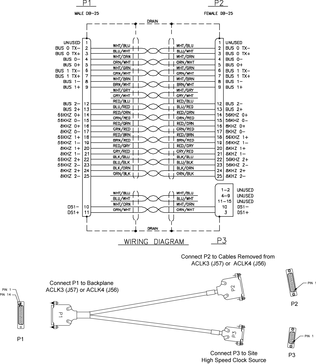

On systems with control shelf backplane (P/N 850‑0330‑03/04), the high‑speed source clock cable (P/N 830‑0873‑xx or P/N 830‑1189‑xx) sends only high‑speed clock signals to the EAGLE. The existing composite clock cables (P/N 830‑0226‑xx) continue to provide the low‑speed clock connections to connectors J42 and J41 (Primary BITS and Secondary BITS) on the backplane. The HS cables (P/N 830‑0873‑xx or P/N 830‑1189‑xx) send the HS primary and secondary clock signals through adapter cables (P/N 830‑0846‑01) to connectors J57 and J56 on the backplane. The two connectors are labeled ACLK3 and ACLK4.
This procedure describes the steps required to install the HS clock cables on the EAGLE with control shelf backplane (P/N 850‑0330‑03/04) using adapter cable (P/N 830‑0846‑01).

Connectors ACLK3 and ACLK4 propagate system A clocks to frame 3 (shelves 4100, 4200, and 4300) and frame 4 (shelves 5100, 5200, 5300). System A clock signals to cards in these shelves will be lost during this procedure. If the EAGLE contains these shelves with cards installed the cards switch automatically to the system B clock sources when the A clock sources are removed.

    Figure 6-34 shows the location of these connectors on the control shelf backplane.
    Figure 6-34 Control Shelf (P/N 850-0330-03 or -04) BITS Connectors
    img/850-0330-04.jpg
    warning:
    Metal points on the PCB conduct ‑48VDC and can cause shorts, shocks, and damage if not handled properly.

    Figure 6-354 shows the connector pin outs of the high‑speed source clock cable adapter cable (P/N 830‑0873‑xx or P/N 830‑1189‑xx).
    Figure 6-35 Wire Coding of High‑Speed source and Composite Clock Cable (P/N 830‑0873‑xx or P/N 830‑1189‑xx)

  11. Connect the adapter cable (P/N 830‑0846‑01) P1 (DB25) to ACLK3 connector J57 on the control shelf backplane. Tighten the connector with a slotted screw driver.
    Figure 6-36 High-Speed source Timing Adapter Cable (P/N 830‑0846‑01)
    img/t-high-speed-adapter-cbl-830-0846-01.jpg
  12. Connect the adapter cable (P/N 830‑0846‑01) P2 (DB25) to the end of the ACLK cable removed in Step\ Tighten the connector with a slotted screw driver.
    This step reconnects the ACLK3 signals to shelves 4100, 4200, 4300.

  1. Remove the plastic panels from the back of all shelves that require the frame clock cables be replaced.
  2. Install Pin Protector Assembly on all shelves that require the frame clock cables be replaced.
    The pin protectors are placed over the ID pins directly to the right and left of the A CLK IN cables connectors on each shelf. Shelf ID pins must be covered with pin protectors. If contact is made with the ID pins, the shelf may lose its identity.

    Figure 6-39 Backplane P/N 850-0330-06 or -07 Control Shelf
    img/t-replacing-b-frame-clock-cables-im-fig3.jpg
    Figure 6-40 Backplane P/N 850-0356-04 Extension Shelf
    img/t-replacing-b-frame-clock-cables-im-fig4.jpg
  9. Remove the other end of the frame clock cable from the next shelf’s A CLKIN connector.
  10. Select the new frame clock cable (P/N 830-0398-xx or P/N 830-1150-xx) and connect it to the A CLKOUT connector, refer to 8
  11. Route the clock cable in the frame following the routing directions in this manual.

    Figure 6-41 Backplane P/N 850-0330-06 or -07 Control Shelf
    Figure 6-42 Backplane P/N 850-0356-04 Extension Shelf
  9. Remove the other end of the frame clock cable from the next shelf’s B CLKIN connector.
  10. Select a new frame clock cable and connect it to the B CLKOUT connector, refer to 8.

Alarm Cable Termination
The rack alarm cable for the control frame may be factory installed at both ends or the row alarm cable may come from the factory installed at the alarm end-panel only.
danger:
warning:
Always trim tie-wraps flush and turn the trimmed tie-wraps to the rear of the cable bundle, when facing the back of the frame.
The rack alarm cables lead from ports in the system control backplane and connect with other frames in the row.
The backplane alarm ports are:
  • FAP (Frame and Alarm Panel) in the control frame J13 on 850-0330-06 or -07
  • FAP extension frame 00 J15 on P/N 850-0330-06 or -07
  • FAP extension frame 01 J32 on P/N 850-0330-06 or -07
  • FAP extension frame 02 J46 on P/N 850-0330-06 or -07
  • FAP extension frame 03 J61 on P/N 850-0330-06 or -07
  • FAP extension frame 04 J68 on P/N 850-0330-06 or -07
  • End panel J34 on P/N 850-0330-06 or -07 (use cable row alarm cable 830-1145-01)
  • J35 and J66 o 850-0330-06 or -07 to holdover clock
  • J69 on 850-0330-06 or -07 to OAPF
  • LMC J47 on850-0330-06 or -07
  • RMC J33 on 850-0330-06 or -07
From the rear of the frame these cables should be routed from the connector around the left side of the frame. Route the cables up the side of the frame to the FAP and secure the cables with lacing cord to the cross arms on the side of the frame. Across the top of the frame secure the cables to the cross arms above the FAP with lacing cord also.
Alarm cables should not be formed with power cables and should have a lacing cord approximately every three inches. There should be no less than two lacing cord ties between frames.
If the end panel does not mount on the control frame, the cable will route the same as alarm rack cables, from port J34 on backplane 850-0330-06 or -07 from the rear of the frame, up the left side of the frame, across the top of the FAP, and formed and dressed with the alarm rack cables to the end panel.

There are 16 I/O ports on the control shelf backplane that are used to support external printers, terminals, or modems.
Use terminal/printer cable 830-0535-xx or 830-1154-xx. Different combinations of adapters are possible, see Table 6-3.
Refer to Cables and Adapters for detailed cable and adapter connector information.
  1. See the “Cable Running List” in the Equipment Specification to determine how to connect the external cables.
    All cable ends must be labeled with “TO” and “FROM” location information from Port to Backplane.
  2. Place the cables on the cable rack.
    Feed the cable ends (with connectors) down the side of the system, outside the cable tie bars, around the top or bottom edge of the control shelf and fan out to the connectors.
  3. Secure each connector to the designated receptacle on the control shelf backplane.
    Plug the connector in, start one of the connector screws, fully tighten the second screw, then fully tighten the first screw.
  4. Tie-wrap each cable to the cable tie bar at the rear of the shelf.
  5. Dress the cables neatly and tie-wrap to the cable tie bars at the side of the frame.
    Pull the slack in the cable back toward the other end of the cables and lace to the cable rack.
  6. Ensure that each tie-wrap strap is cut flush with the tie-wrap head so sharp edges are not exposed.
  7. Attach any necessary adapter to the end of the cable, see 1 of this procedure; then attach cable or cable plus adapter to the device.

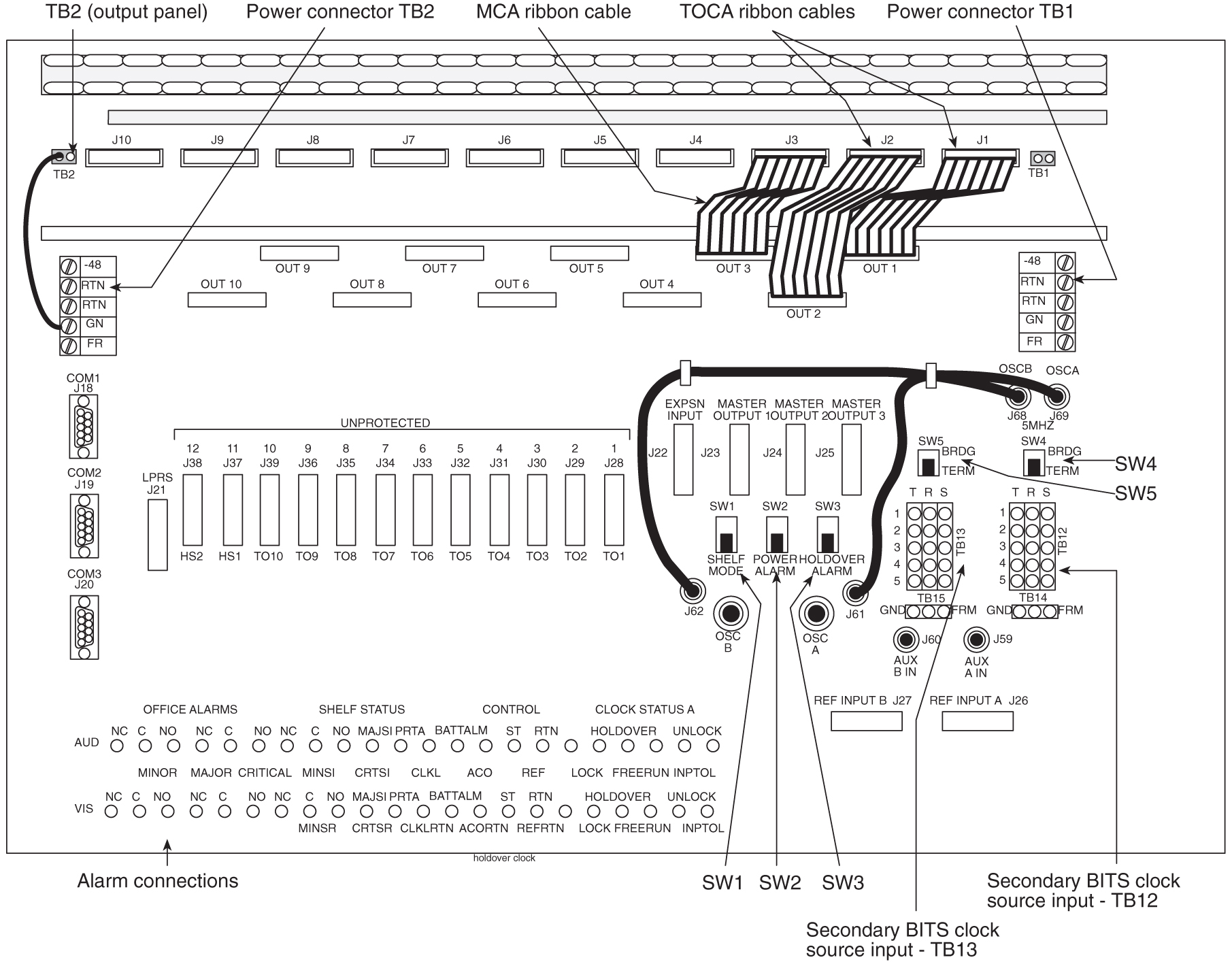

Holdover Clock Installation
The holdover clock option and its associated output panel are normally factory installed in a miscellaneous frame. Use the following procedures to complete the holdover clock installation.
Card Placement

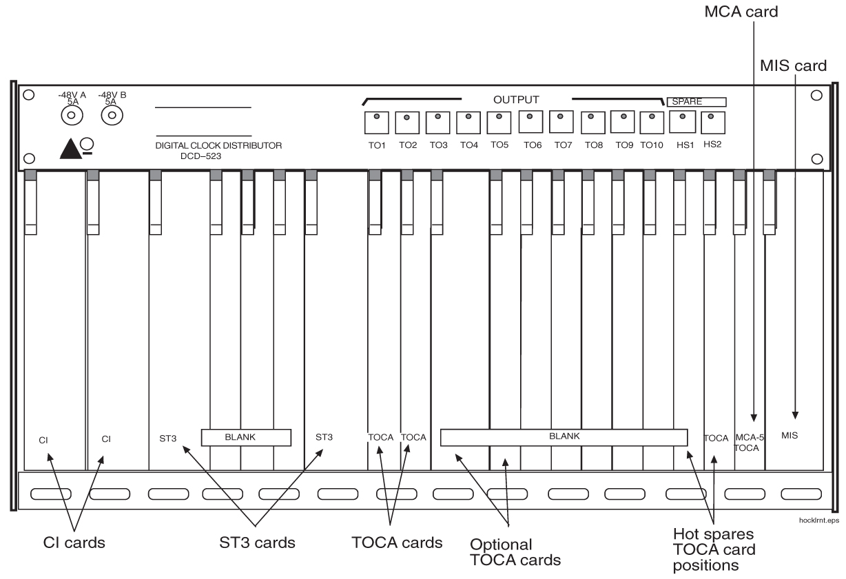

The holdover clock cards must be installed in the positions illustrated in Figure 6-43. Check that the proper cards are installed in the indicated locations.
Figure 6-43 Holdover clock
img/c-holdover-clock-installation-im-fig1.jpg

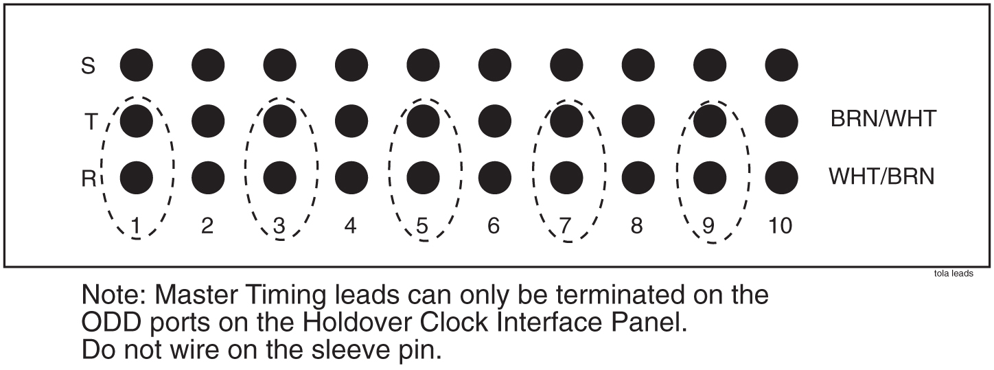

Figure 6-44 TOLA Source Timing Leads
img/c-output-panel-connections-im-fig1.jpg

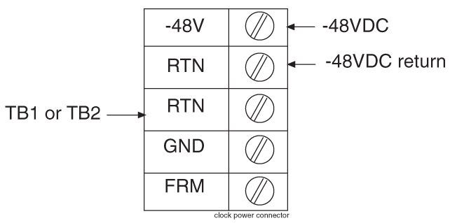

Power Connections
Check that the holdover clock power connections are installed according to Table 6-3 for holdover clock and fuse and alarm panel connections.
See Figure 6-45 and Figure 6-46 for holdover clock connector locations.
See Figure 6-47 and Figure 6-48 for fuse and alarm panel connector locations.

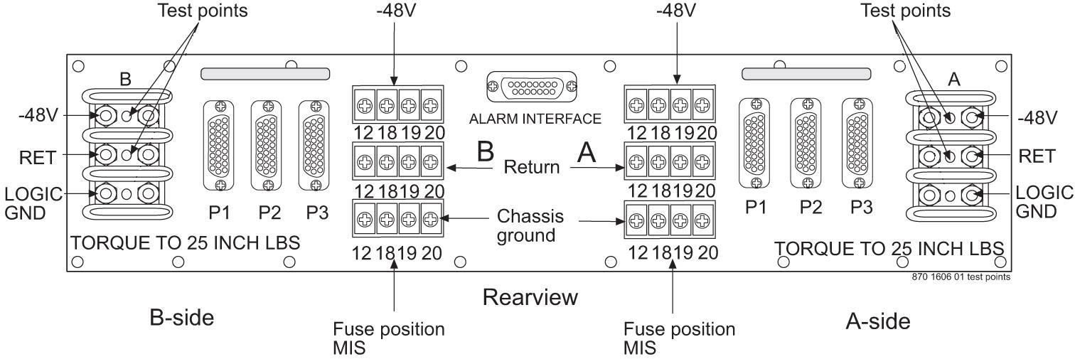

Table 6-3 Holdover Clock Wire Colors and Connections
Holdover Clock Connector Wire Color FAP Connection
TB1 –48VDC
Red
 B side –48VDC #1
TB1 RTN
Black
 B side –48VDC return #1
TB2 –48VDC
Red
 A side –48VDC #1
TB2 RTN
Black
 A side –48VDC return #1
TB1 GND
White
 A side Chassis GND
TB2 GND
White
 B side Chassis GRD
Figure 6-45 Holdover Clock Power Connector
img/c-output-panel-connections-im-fig2.jpg
Holdover Clock Switch Settings
Set the switches on the back of the holdover clock to the following positions, see Clock Input DIP Switch Settings:
  • SHELF MODE (SW1) - ST3 (down)
  • POWER ALARM (SW2) - MAJ (down)
  • HOLDOVER ALARM (SW3) - MAJ (down)
  • REFA (SW4) - TERM (down)
  • REFB (SW5) - TERM (down)
The Dual In-line Package (DIP) switch settings for the Clock Input are:
  • Transmission 1.544 mb -TI (On)
  • Composite Clock - CC (Off)
  • Extended Superframe Format - ESF (On)
  • Bipolar 8Bit Zero Substitution - B8ZS (On)

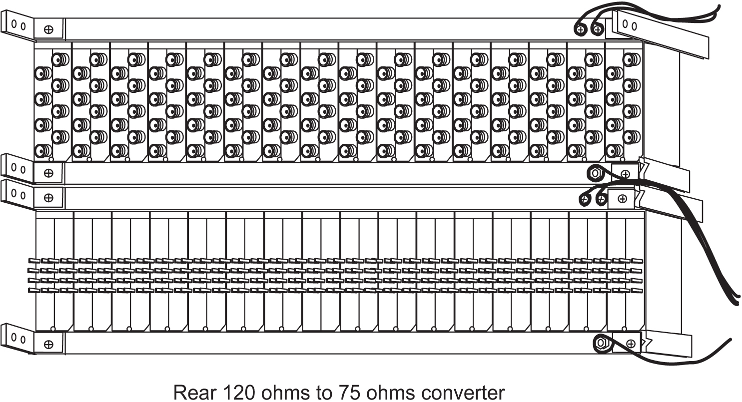

    Figure 6-46 Holdover Clock and Output Panel, Rear
    img/r-clock-input-dip-switch-settings-im-fig1.jpg
The Fuse and Alarm Panel connections for the Holdover Clock are shown in Figure 6-47.
Figure 6-47 Holdover Clock FAP Connections
img/r-clock-input-dip-switch-settings-im-fig2.jpg
Figure 6-48 Holdover Clock FAP Connections
img/r-clock-input-dip-switch-settings-im-fig3.jpg

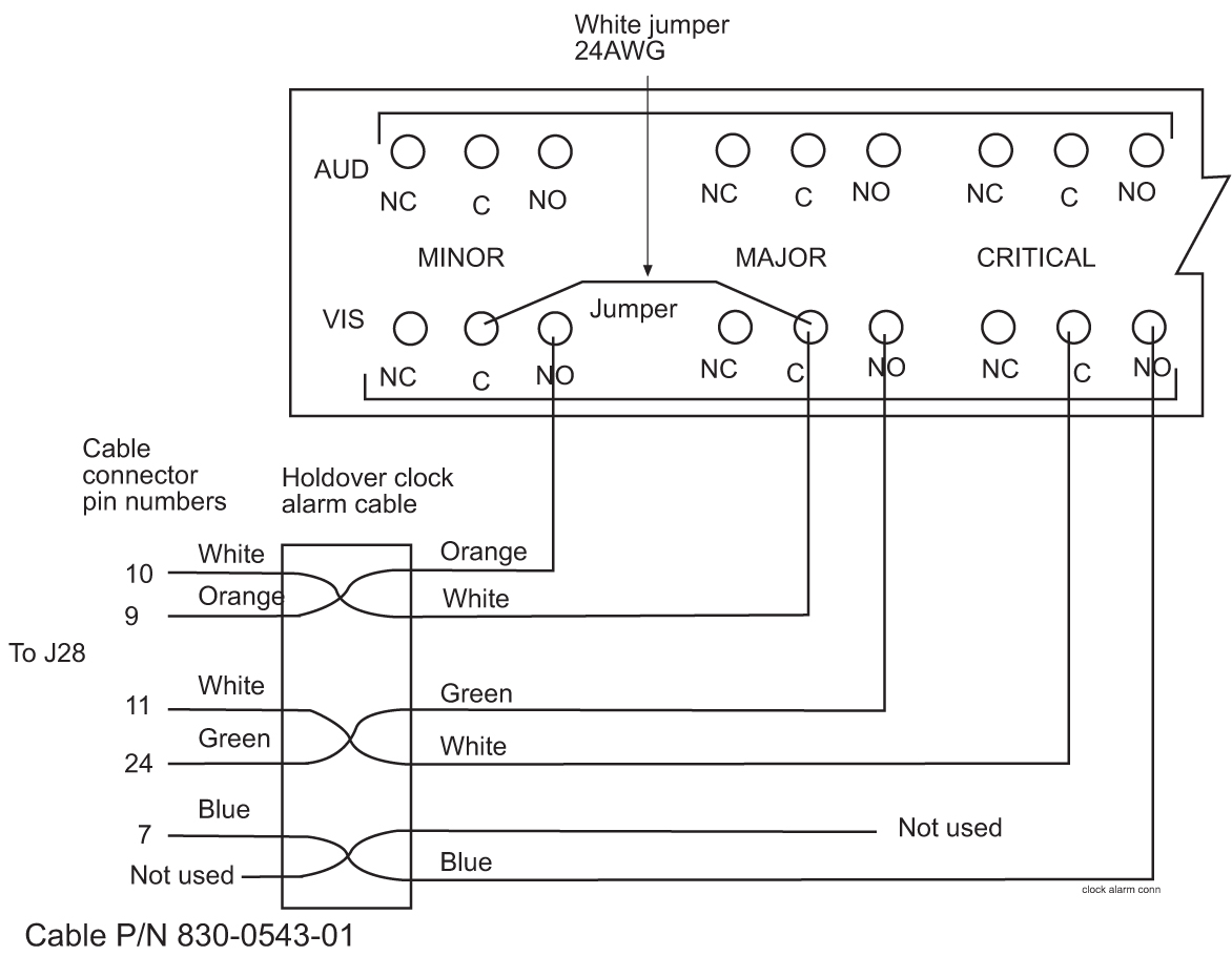

Holdover Clock Alarm Connections
The installation connections are shown in the wiring layouts in Figure 6-50 and Figure 6-51.
A holdover clock alarm cable is used to send alarms from the holdover clock to the control shelf backplane.
  1. Before using the following procedures, loosen the screws holding the clear plastic cover on the back of the holdover clock and remove the cover by lifting it off of the screws
  2. Connect the DB26 connector of the holdover clock alarm cable to the EXTALM connector and CUSTALM 1 connector J35, J66 on backplane (P/N 850-0330-06 or -07) on the system control shelf backplane, see Figure 6-49.
    Secure connector screws.
  3. EXTALM cable connects directly to the Holdover clock.
    The external alarm cable is an optional cable that may go from the EXTALM to a terminal block see Figure 6-50.

  10. Wire-wrap a 24-gauge jumper-wire between the minor and major common alarm connector pins as shown in Figure 6-50.
  11. Cut the wires to length, strip, and wire-wrap to the holdover clock at the locations shown in Figure 6-50.
    Figure 6-50 Holdover Clock Alarm Connections
    img/t-holdover-clock-alarm-connections-im-fig2.jpg
  12. Tie-wrap the alarm cable to the lower holdover clock cable tie bar.

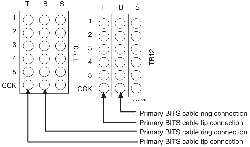

BITS Clock Source Cables
This cable connects the holdover clock to the central office Building Integrated Timing System (BITS) clock sources.
  1. Connect the cables to the primary and secondary central office BITS clock sources.
  2. Route the cables to the system’s miscellaneous frame containing the holdover clock.
  3. Route the cables down the right side (viewed from the rear) of the frame.
  4. Pull the slack out of the cable towards the holdover clock.
  5. Dress the cable neatly and tie-wrap to the cable tie bars at the side of the frame.
    All cables must be laced (no tie-wraps) onto the top traverse arm and above to the cable rack.
  6. Remove the outer insulation of each cable even with the top of the output panel.
  7. Apply a 1-1/2-inch length of shrink-wrap tubing.
    Center the tubing on the end of the cable insulation before shrinking tubing with a heat gun.
  8. Cut the wires to length, strip, and wire-wrap to the holdover clock at the locations, TB12 and TB13, see Figure 6-51.
    See Clock Input DIP Switch Settings for locations of these connectors.
    Figure 6-51 BITS Clock Source Connections
    img/t-bits-clock-source-cables-im-fig1.jpg
  9. Ensure that each tie-wrap strap is cut flush with the tie-wrap head and turned to the rear of the cable so that no sharp edges are exposed.

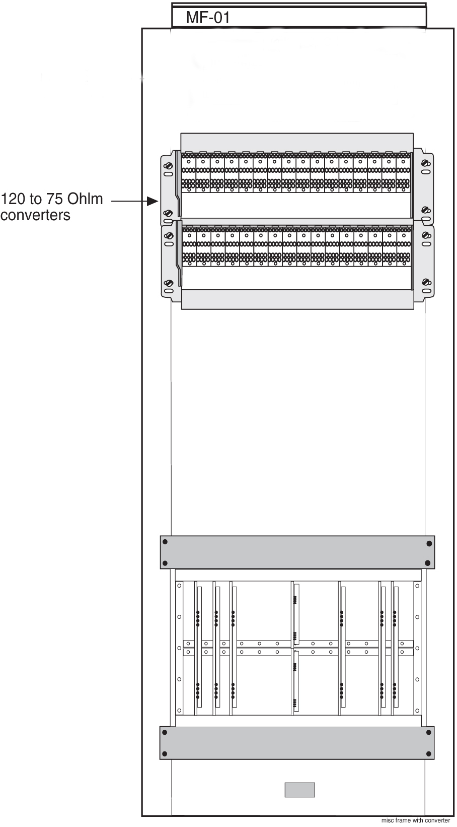

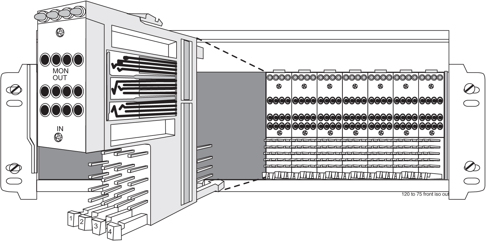

Ohms Converter International Market
The ohms converter is used mostly outside of North America. The converter Super Multiple-Interface Cross-Connect (SuperMIX) is a modular device for cross-connecting, patching, and monitoring these digital signal rates:
  • E1 (2.048 Mb/s at 120 Ohms impedance)
The third party SuperMIX modules backplanes will be configured to accommodate a variety of input/output (I/O) termination connector types. Any combination or “mix” of backplanes in one chassis is acceptable. Refer to Telect® “SUPER MULTIPLE-INTERFACE CROSS-CONNECT (SUPERMIX) USER MANUAL” 110339 issue A Rev. 1
This information is for 120 to 75 ohms only.
Figure 6-52 Miscellaneous Frame with 120 Ohm Converter
img/c-ohms-converter-international-market-im-fig1.jpg
Customers may purchase the miscellaneous frame from Oracle.

Figure 6-53 120 Ohms Converter and Shelf
img/c-ohms-converter-international-market-im-fig2.jpg

Figure 6-54 120 Ohms Converter Rear
img/c-ohms-converter-international-market-im-fig4.jpg
Figure 6-55 Converter Rear Detail
img/c-ohms-converter-international-market-im-fig5.jpg

Verify -48VDC
The following procedure verifies –48VDC.
  1. Turn on breaker, or insert fuse for control frame A side –48VDC power source.
  2. Check for nominal –48VDC at the control frame fuse and alarm panel A side test point.
    For test points used see Figure 6-56 and Figure 6-57.
    Input voltage range is -40 VDC to -57.5 VDC.
    Figure 6-56 Test Points 1U FAP (P/N 870-2804-01)
    img/r-fuse-alarm-panel-1u-im-fig2.jpg
    Figure 6-57 Test Points 3U FAP (P/N 870-2320-03)
    img/c-48vdc-power-source-im-fig2.jpg
  3. Repeat 1 and 2for the control frame B side –48VDC power source.
