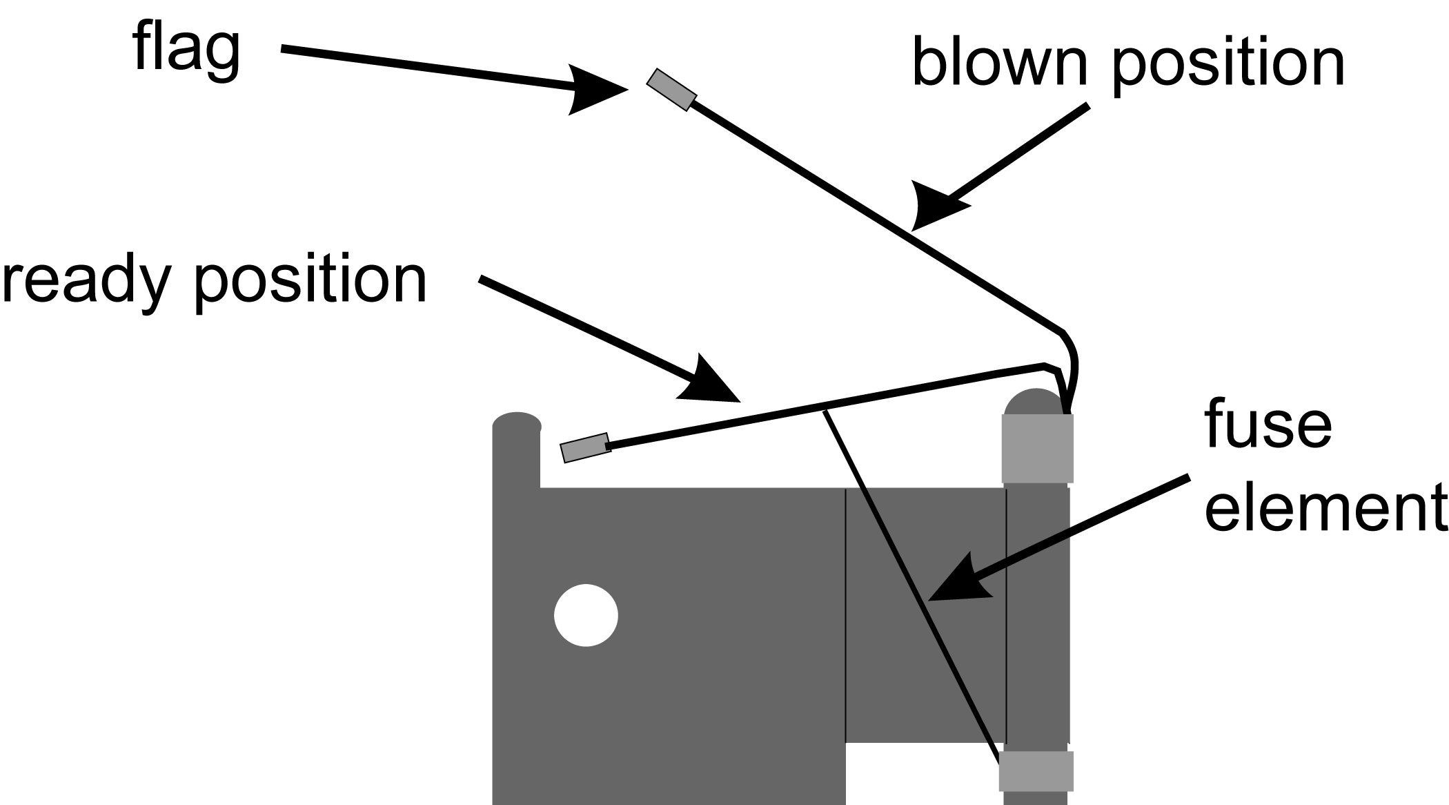

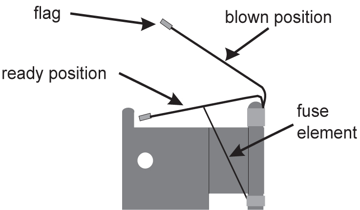

Fuses
The fuse and alarm panel uses GMT-type fuses of different amperage ratings for individual circuit protection. If a frame circuit fuse is blown the alarm is indicated by an LED on the front panel and a small colored flag on the fuse shows the fuse that has failed (refer to Figure 5-1. Refer to Maintenance for procedures on replacing fuses and the FAP assembly.
Caution:
Always use a fuse of the same type and amperage rating when replacing a failed fuse.
Figure 5-1 Fuse (GMT Brand Shown)
img/r-fuses-hws-fig1.jpg
Table 5-1 Fuse Color Codes of Alarm Flags

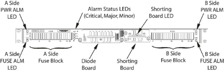

Fuse and Alarm Panel (P/N 870-2804-01)
The FAP (P/N 870-2804-01) is a low-profile (1U) unit that can be installed in the Control Frame (CF) and the Extension Frame (EF).
The Power Alarm LED indicates the input power state to the FAP. The LED is green when input power is applied to that bus of the FAP and is red when there is no input power to that bus of the FAP. An unlit Power Alarm LED indicates a failed LED or no input power to either bus of the FAP.
Alarm LEDs to indicate Critical, Major, and Minor alarms are located to the left of the diode board. The LEDs indicate alarms generated by the system that are applicable to that frame which the FAP is installed.
The FAP contains a Diode board and a Shorting board. These boards are located at the front center of the FAP. The FAP also contains two fuse blocks, one to the left (A-side) and one to the right (B-side) of diode and shorting boards, consisting of 20 fuse positions each. The Fuse Alarm LED indicates the failure of a fuse.
The diode board in the FAP contains power diodes and circuitry which allow one bus to pick up the entire load when there is a loss of input power on the other bus.
The Shorting board allows the removal of the diode board without taking down the system. This permits periodic maintenance of the diodes without having to power down or remove the unit from the shelf. For maintenance operation, the Shorting board has to be removed, flipped over, and reinstalled. In the bypass position, both A and B power is connected to the fuse blocks so the diode board can be safely removed. The Shorting board has an LED which is off when the board is in normal operational mode and is green when in the bypass mode of operation. With the Shorting board in the bypass mode, the OR’ing function is not available. Refer to Maintenance for additional information to place the FAP into Maintenance Mode of operation.
Figure 5-2 and Table 5-2 describes the front panel configuration of the fuse and alarm panel (P/N 870-2804-01).

Table 5-3 presents possible alarm LED states and corresponding fuse conditions.
Table 5-3 Fuse State and LED condition (P/N 870-2804-01).
Fuse State A side Fuse State B side Fuse LEDs A side Fuse LEDs B side
No fuses blown
No fuses blown
Green
Green
No fuses blown
At least 1 fuse blown
Green
Red
No fuses blown
Red
Green
Red
Red
Shorting board enabled (in bypass mode), Shorting board LED is green.
Red
Red
Shorting board in normal operational mode, Shorting board LED is off. No fuses blown.
Green
Green

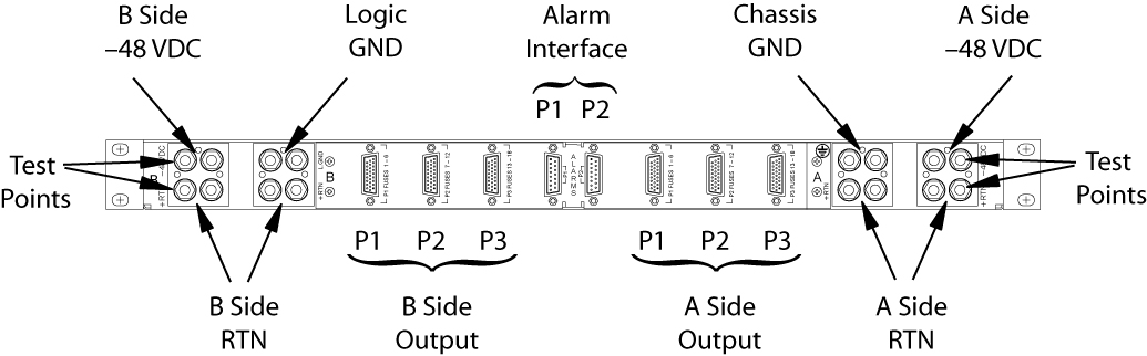

Figure 5-3 and Table 5-4 describes the rear panel configuration. Refer to Installation for cabling connection information.
Figure 5-3 Fuse and Alarm Panel Rear (P/N870-2804-01).
img/r-fuse-alarm-panel-1u-im-fig2.jpg
Table 5-4 Fuse and Alarm Panel Rear Items (P/N870-2804-01).
Fuse Panel Item Description
Input Terminal Block A
Input and Return for power source A and FAP Chassis Ground
Input Terminal Block B
Input and Return for power source B and FAP Logic Ground
–48VDC Outputs A
26-pin “D” connectors for A-side outputs:
  • P1 - Fuses 1 through 6
  • P2 - Fuses 7 through 12
  • P3 - Fuses 13 through 18
–48VDC Outputs B
26-pin “D” connectors for B-side outputs:
Alarm Interface
15-pin “D” connectors:
  • P1 to the EAGLE
  • P2 to a power distribution breaker panel
Table 5-5 presents the power requirements and physical dimensions for the FAP.
Table 5-5 Fuse and Alarm Panel Specifications (P/N 870-2804-01).
Dimensions
Height
Width
Depth
1.75 inches (4.4 cm)
21.5 inches (53.8 cm)
10 inches (25 cm)

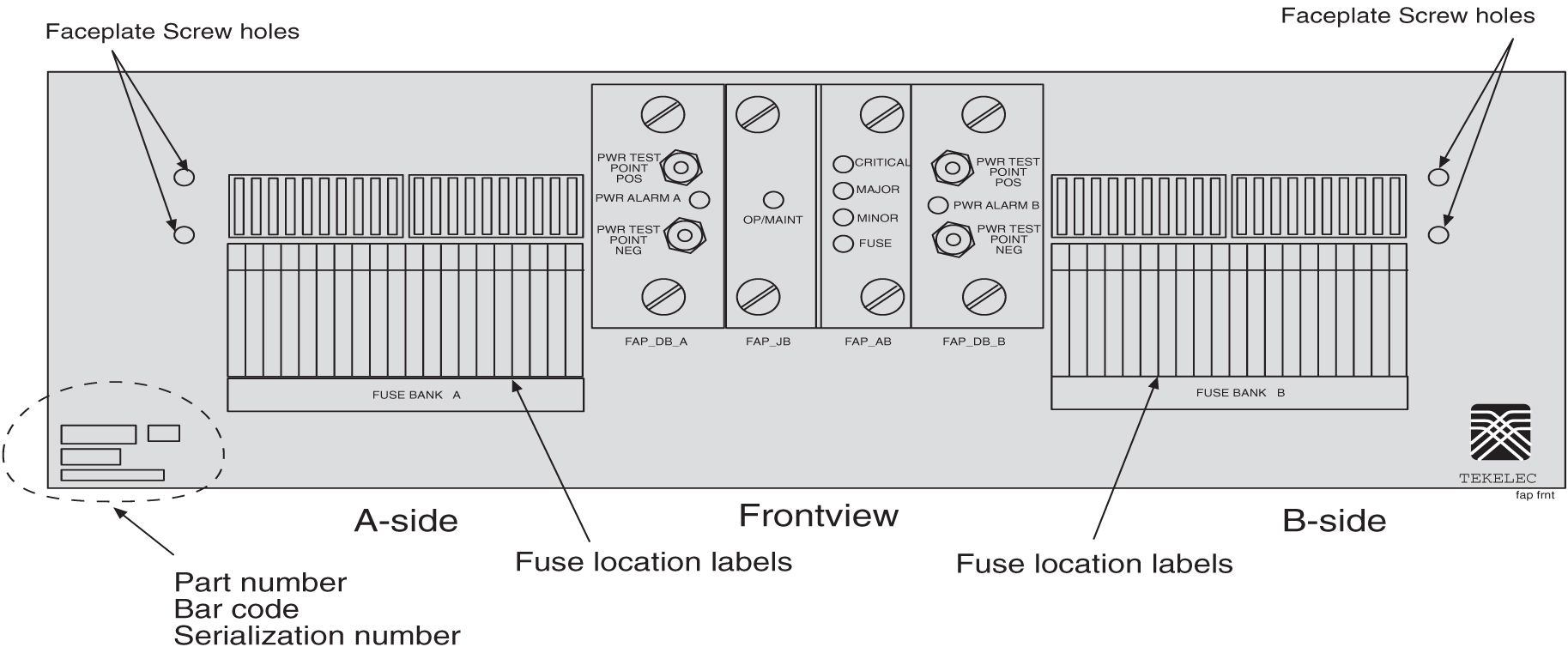

Fuse and Alarm Panel (P/N 870-1606-xx/870-2320-xx)
The FAP P/N 870-1606-xx can be installed in standard frames. The FAP P/N 870-2320-xx can be installed in heavy duty frames.
The FAP contains an alarm board, two diode boards, and a jumper board. These boards are located at the front center of the FAP. The fuse holders are to the left and right of these boards as shown in Figure 5-8.
The alarm board contains a FUSELED to indicate a failed fuse (for either bus A or B) and LEDs to indicate Critical, Major, and Minor alarms generated by the system that are applicable to that frame which the FAP is installed.
There are two diode boards in the FAP, one for bus A and one for bus B. Each diode board contains power diodes and circuitry which allow one bus to pick up the entire load when there is a loss of input power on the other bus. An LED indicates the input power state to the FAP. The LED is green when input power is applied to that bus of the FAP and is red when there is no input power to that bus of the FAP.
The Maintenance (Jumper) board allows the removal of one or both diode boards without taking down the system. The Jumper board has two connectors and a connector plug. During normal operation, the connector plug is seated on the first connector. For maintenance operation, the jumper board has to be removed and the connector plug moved to the second connector. In the maintenance position, the connector plug connects both A and B power feeds to the fuse panels so one or both diode boards can be safely removed. The OP/MAINTLED is green when the Jumper board is in normal operational mode and is red when in the maintenance mode of operation. Refer to Maintenance.
Figure 5-8 and Table 5-6 describes the front panel configuration of the fuse and alarm panel (P/N 870-1606-xx/870-2320-xx).
Figure 5-8 Fuse and Alarm Panel (P/N 870-1606-xx/870-2320-xx) Front
img/r-fuses-hws-fig6.jpg
Table 5-6 Fuse and Alarm Panel Front Items
Fuse Panel Item
Description
Fuse Positions
Two groups of 20 GMT fuses
PWR ALARM
LED indicator for A or B diode board input power
  • Green - input power applied
  • Red - no input power to board
OP/MAINT
LED indicator for mode of operation
  • Green - normal
  • Red - maintenance
FUSE
LED indicator for fuse fail alarm
  • Green - normal
  • Red - blown fuse
CRITICAL
LED indicator for frame critical alarm
MAJOR
LED indicator for frame major alarm
MINOR
LED indicator for frame minor alarm

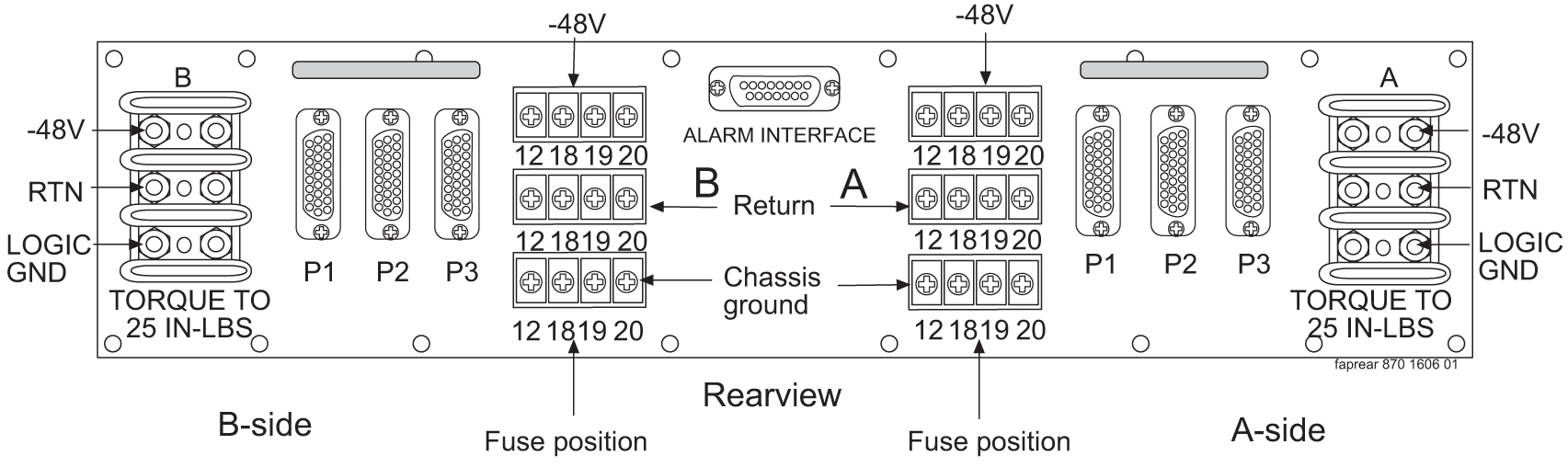

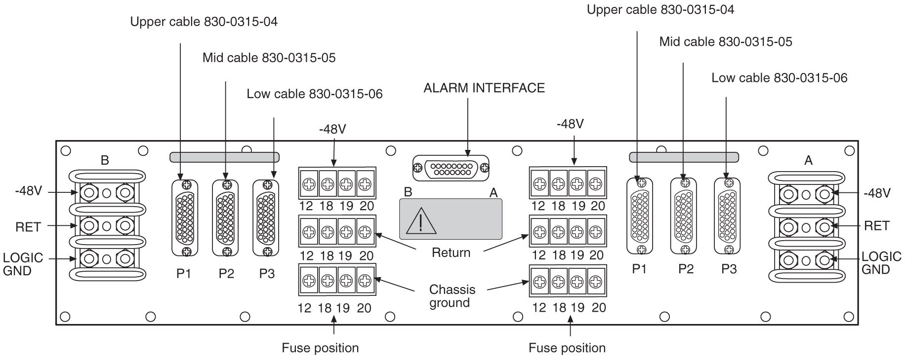

Figure 5-9 describes the rear panel configuration of fuse and alarm panel (P/N 870-1606-xx). Refer to Installation for cabling connection information.
Figure 5-9 Fuse and Alarm Panel (P/N 870-1606-xx/870-2320-xx) Rear
img/r-fuses-hws-fig7.jpg
Table 5-7 Fuse and Alarm Panel (P/N 870-1606-xx/870-2320-xx) Rear
Logic Ground, Return, and Input for power source A
Logic Ground, Return, and Input for power source B
Output Terminal Block A
–48VDC, Chassis Ground, and RTN for Fuse location 12, 18, 19, and 20 for side A.
These are miscellaneous extra capacity fuses refer to Provision Rules for FAP Fuse Locations .
Output Terminal Block B
–48VDC, Chassis Ground, and RTN for Fuse location 12, 18, 19, and 20 for side B.
–48VDC, Chassis Ground, and RTN Outputs A
26-pin “D” connectors, P1, P2, and P3 for A-side outputs.
–48VDC, Chassis Ground, and RTN Outputs B
26-pin “D” connectors, P1, P2, and P3 for B-side outputs.

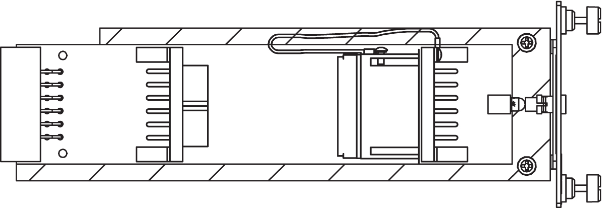

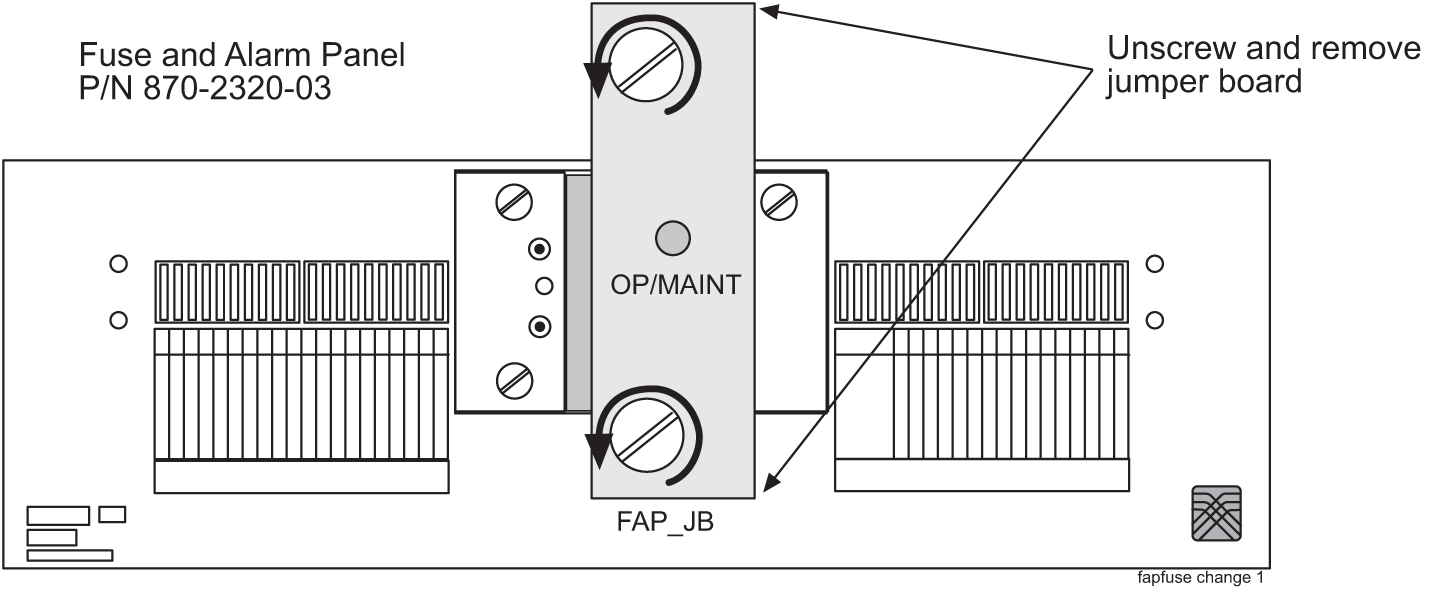

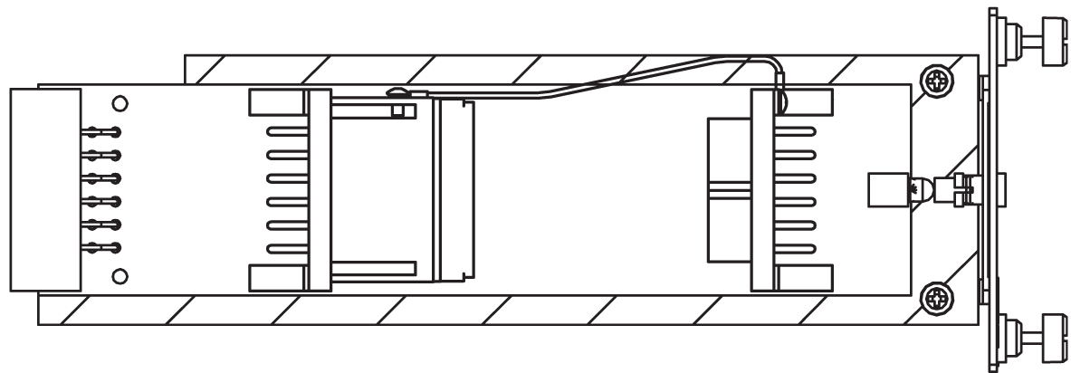

Jumper Board
The Jumper board has two connectors and a connector plug. During normal operation, the connector plug is seated on the first connector. For maintenance operation, the jumper board has to be removed and the connector plug moved to the second connector. In the maintenance position, the connector plug connects both A and B power feeds to the fuse panels so one or both diode boards can be safely removed. The OP/MAINT LED is green when the Jumper board is in normal operational mode and is red when in the maintenance mode of operation.
Maintenance Mode
Use this procedure to place the jumper board into maintenance mode. Maintenance mode allows the removal of one or both diode boards without taking down the system.
Procedure — Maintenance Mode
  1. Locate the jumper board on the Fuse and Alarm Panel (FAP). See Figure 5-10.
    Figure 5-10 Jumper Board FAP
    img/c-jumper-board-mode-im-fig1.jpg
  2. Remove the Jumper Board (FAP_JB) by turning the top and bottom screws to the left until they disengage.
  3. Pull the board straight out of the FAP until the board is clear of the frame.
  4. On the jumper circuit board, unclip the 12-pin connector jumper from P71 and re-attach it to P72. Insert it until the plastic retaining clips “snap”. See Figure 5-11. Note that the jumper has a retaining strap so it will not get dropped or lost. This repositioning overrides the diodes, establishing a direct connection between the input and fuse panels.
    Figure 5-11 Jumper Connector - Maintenance Mode.
    img/c-jumper-board-mode-im-fig2.jpg
  5. Slide the jumper board back into the FAP and verify both of the following alarms display:
    • the OP/MAINT LED lights red on the FAP
    • an EAGLE fuse alarm displays on the terminal
    You may now remove either or both diode circuit boards without affecting EAGLE service.
    Using the jumper override negates the backpower protection usually provided by the diode board.
    The jumper board maintenance mode procedure is completed.
Procedure — Operational Mode
  2. Unscrew the two thumbscrews securing the FAP jumper board and remove the board.
  3. On the jumper circuit board, unclip the 12-pin connector jumper from P72 and re-attach it to P71. Insert it until the plastic retaining clips “snap”. See Figure 5-12. Note that the jumper has a retaining strap so it will not get dropped or lost. This repositioning establishes a connection between the diode boards with the input and fuse panels.
    Figure 5-12 Jumper Connector - Operational Mode.
    img/c-jumper-board-mode-im-fig3.jpg
  4. Slide the jumper board back into the FAP. Verify the OP/MAINT LED lights green. The fuse alarm LED returns to green.
    The jumper board operational mode procedure is completed.
  3. On the jumper circuit board, unclip the 12-pin connector jumper from P72 and re-attach it to P71. Insert it until the plastic retaining clips “snap”. Note that the jumper has a retaining strap so it will not get dropped or lost. This repositioning establishes a connection between the diode boards with the input and fuse panels.
    Figure 5-13 Jumper Connector - Operational Mode.

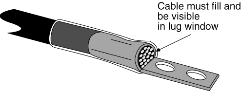

  5. Strip the cable ends, slide a one-inch length of clear heat-shrink tubing over and past the portion of stripped cable.
  6. Apply non oxidizing grease to the stripped end of the cable, and install the lug.
    The stripped cable must fill lug completely to the end of the barrel of the lug and be visible in the end window of the lug.
    Figure 5-14 Lug Installation
    img/t-recommended-tools-4-fig-cable-lug.jpg
    Input Power and RTN use straight, two hole lugs, 1/4-inch hole on 5/8-inch centers, long barrel with window (P/N 804-0817-02).
  7. Double crimp the lugs onto the cable end using the embossing crimper.
  8. Slide the one-inch length of clear tubing over the crimped lug and heat-shrink the one-inch length of clear tubing.
  9. Fasten the lugs of the cables to the respective A-side and B-side -48VDC and RTN points on the FAP. Refer to Figure 5-15 and Figure 5-16.
    Figure 5-15 1U Fuse and Alarm Panel Rear (P/N 870-2804-01)
    Figure 5-16 3U Fuse and Alarm Panel Rear (P/N 870-2320-03))
    img/r-fuse-alarm-panel-870-2320-01-03-im-fig1.jpg
    Tighten the lugs to:
    • 1U FAP, torque to 50 inch-pounds
    • 3U FAP, torque to 25 inch-pounds
  10. Verify correct connection with a multimeter by running continuity check.
  11. Replace the clear plastic cover on the back of the fuse and alarm panel.
  12. Secure the power cables to the cable rack with lacing cord.

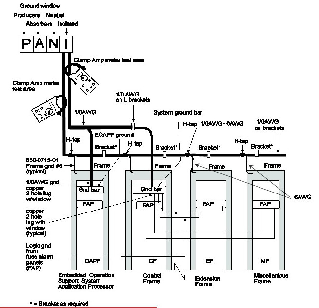

Frame Ground and Logic Ground Cabling Procedures
This section covers these procedures:
Grounding Requirements
danger:
Strictly observe all grounding requirements to reduce the risk of electric shock.
The system operates as a digital isolated ground plane system in a central office environment and requires a single connection to the central office ground window. The system’s ground cables must provide the sole grounding connection between the entire system and the central office grounding.
Recommended Tools
Oracle tools should be labeled “Property of ORACLE” with either a press-on Field Tool Identification label or Field Tool Identification wrap.
  • Safety glasses
  • Power knife
  • Cable cutters
  • Cable stripper
  • Flush cutters
  • Crimping tool with embossing dies (test before using)
  • Socket wrench set, 1/4-inch or 3/8-inch drive or open-end wrenches
  • Non oxidizing grease
    It is a requirement that when mating dissimilar metals non oxidizing grease is used between them as a corrosion inhibitor.
  • Lacing cord and nylon cable ties
  • Heat-shrink gun (hot air blower)
  • Torque wrench
  • Fiber paper

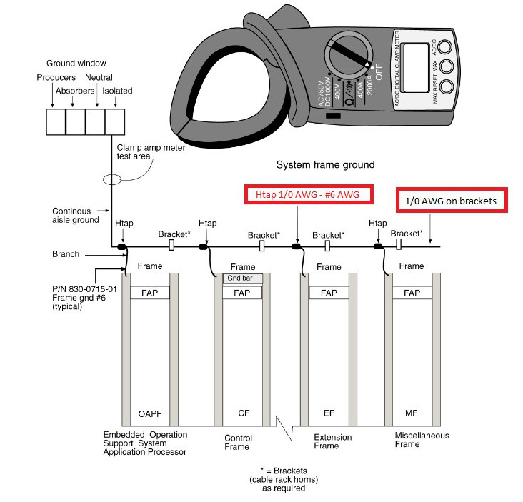

Ground Frame
  1. Install the continuous ground conductor to the Ground Window. Run the conductor the length of the equipment lineup (see the figure below).
    The separate #6 American Wire Gauge (AWG) cable ground that runs to each frame will allow removal of a frame from the lineup without interrupting the grounding of other frames in the lineup.
  2. Install the branch ground conductor to the frame using screws and washers.
    The continuous aisle ground conductor will be H-tapped to the branch (see the figure below). Torque screws to 45 inch-pounds.
    Figure 5-17 System Frame Grounding
    img/t-system-frame-grounding.jpg
  3. Secure the cable to the cable brackets with lacing cord.
  4. Cables must be labeled, 145P tags should have “TO” and “FROM” location information.
    Example: FROM MGB (Main Ground Bar), TO system ground bar Control Frame, CF00.
  5. DO NOT “double lug”: The practice of using one bolt through a lug and the ground bar, and through another lug on the other side of the ground bar, held in place by one nut.
  6. A bolt through any nut must show at least two threads beyond the nut but no more than four threads should be showing.

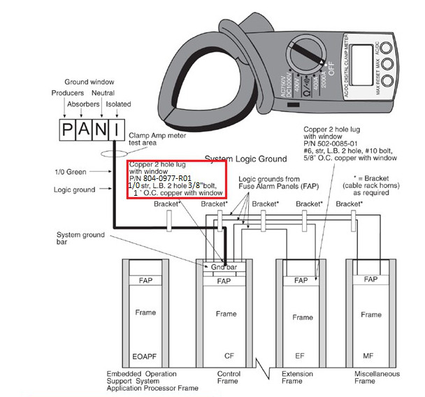

Connect Ground Cable to Control Frame
Caution:
This equipment has a connection between the earthed conductor of the DC supply circuit and the earthing conductor.
  1. Run the 1/0 ground cable from the central office Main Ground Bar (MGB) over the cable rack horns to the system Control Frame, CF-00.
  2. At the control frame end of the cable:
    1. Cut the 1/0 Green Ground Cable (P/N 690-0108-R07) to length and strip the end.
    2. Slide the clear heat-shrink (P/N 804-0229-01) on the cut and stripped end of the cable.
      Move the heat-shrink past the stripped portion of the cable to allow access to the uncovered wire.
    3. Apply a thin coat of non oxidizing grease to the stripped end of the cable.
    4. Slide the 1/0 pink lug (P/N 804-0977-R01) to the stripped cable.
      Secure the lug to the cable by double crimping the barrel of the lug using a crimping tool with embossing dies. The stripped cable must fill lug completely to the end of the barrel of the lug and be visible in the end window of the lug.
    5. Slide the heat-shrink down over the barrel of the lug and the cable.
    6. Use a Heat-shrink gun (hot air blower) to shrink the clear heat-shrink to the barrel of the lug and cable.
  3. Secure the cable to the cable rack horns with lacing cord.
    Tie-wraps are not allowed on the top frame horn or above. On the top horn/bracket and above use only lacing cord.
  4. Apply a small amount of non oxidizing grease to the mounting holes on a copper system ground bar where the lug contacts the ground bar; on a tinned ground bar non oxidizing grease is not needed.
  5. Install the ground cable lug using the 3/8-inch # 6 copper-plated hardware provided.
    Use the attachment sequence shown in Figure 5-18.

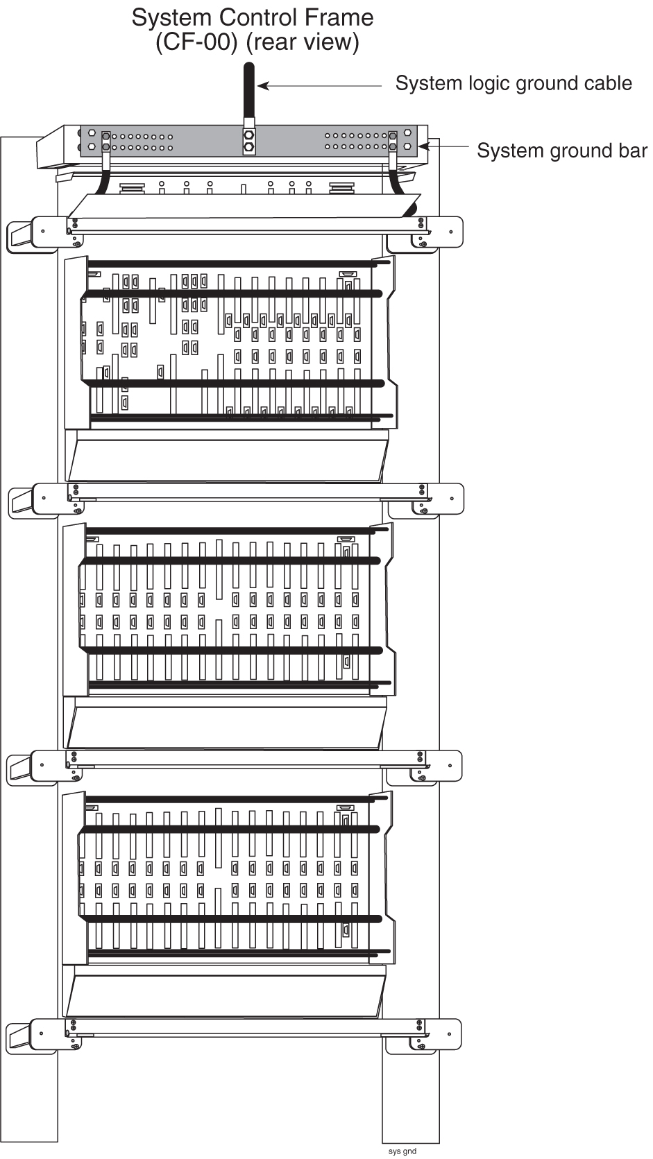

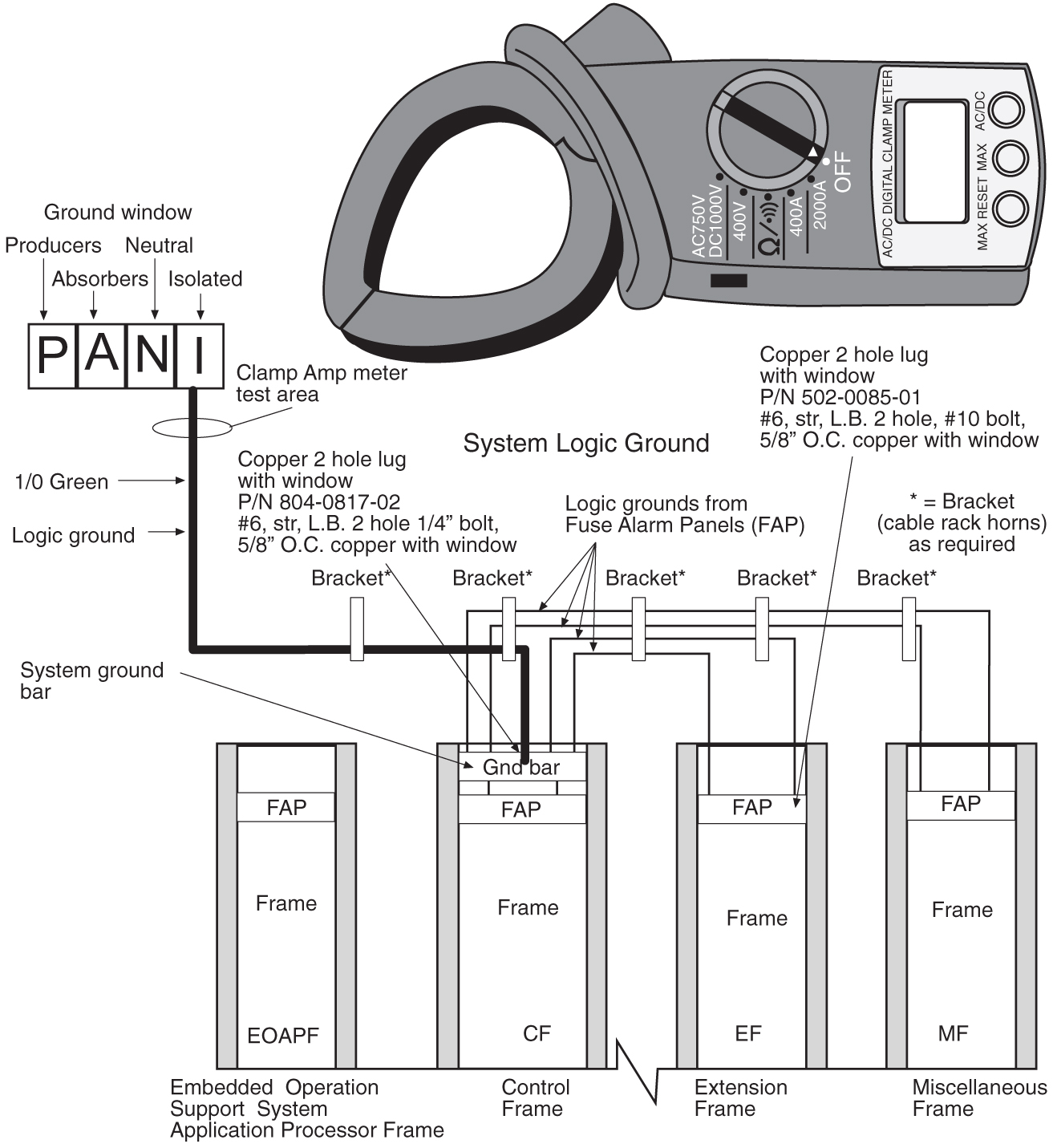

    Figure 5-18 System Logic Grounding
    img/t-system-logic-grounding.jpg
  6. Tighten the bolts to 15.5 foot-pounds of torque.
  7. Use the lacing cord to secure a “DONOTDISCONNECTLEAD” tag at each end of the cable, just beyond the lug.
    System Ground: 1/0 cable from the system ground bar to the “I” section of the ground window. If no ground window exists, the customer will designate the termination point.
    Frame Ground: A cable #6 AWG from a frame is H-tapped into 1/0 cable and also terminates on the “I” section of the ground window.
    The size of the cable is determined by the overall length of the cable run. Refer to the Site File Book.
    Figure 5-19 Clamp Reading on System Frame and Logic
    img/t-system-clamp-reading.jpg

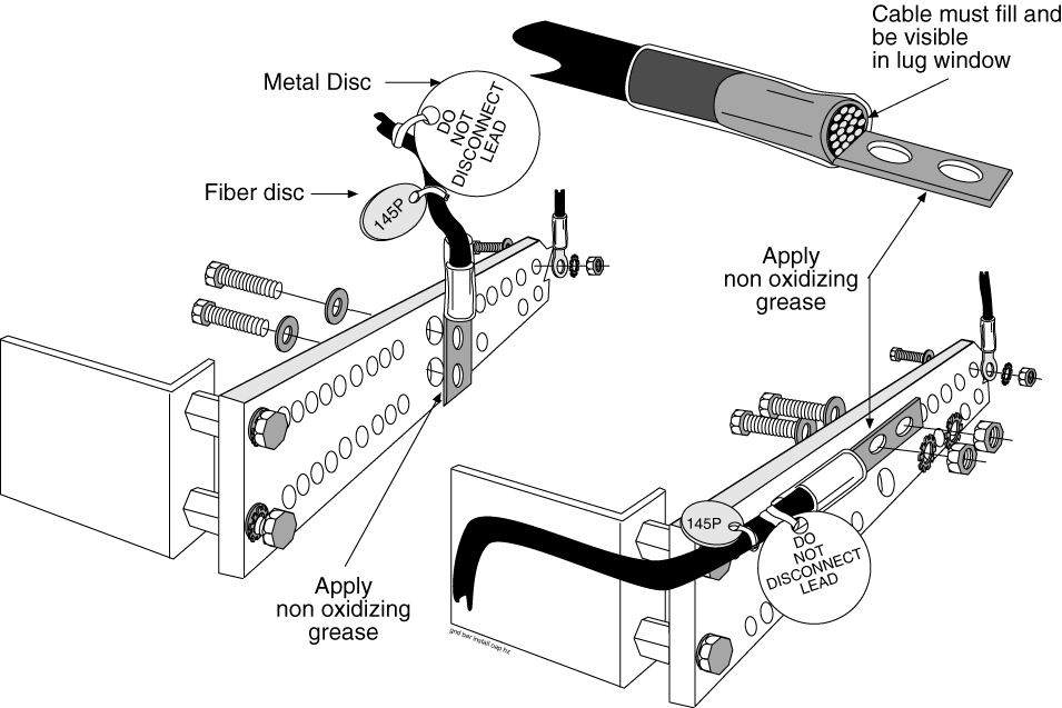

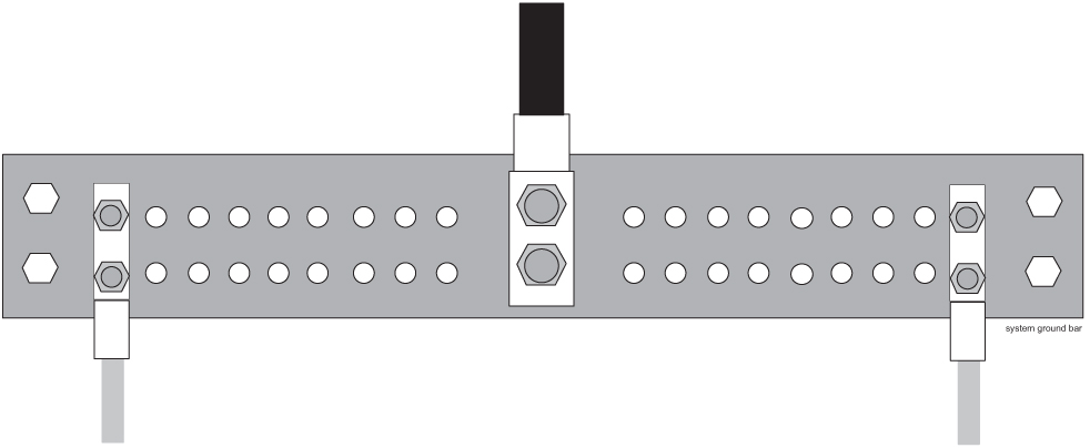

Logic Ground Connections to the System Ground Bar
  1. Place a clear heat-shrink on the cable.
  2. Butt, strip the end of the cable, and apply a small amount of non oxidizing grease to the conductor.
  3. Crimp #6 American Wire Gauge (AWG) lug with window on the cable, using an embossing crimper.
  4. Apply a small amount of non oxidizing grease to the mounting holes on a copper system ground bar, Non oxidizing grease is not needed on a tin ground bar, where the lug contacts the ground bar.
  5. Crimp a #6 AWG lug with a window on the cable.
    Use an embossing crimper. The stripped cable must fill lug completely to the end of the barrel of the lug and be visible in the end window of the lug.
    warning:
    All logic ground connections must be made to the system ground bar.
    Figure 5-20 System Logic Ground Bar and Cable
    img/t-logic-ground-connections-system-ground-bar-im-fig1.jpg
    It may be necessary to drill the central office ground window bar to accept the 3/8-inch bolts on one-inch centers. Apply the 145P cable tags (see Figure 5-24) provided to both ends of the ground cable, including the “Do Not Disconnect”.
  6. Install the logic ground cable lugs P/N 804-0817-R02 using the 1/4-inch 20 copper-plated hardware provided (refer to Figure 5-20).
    Tighten the bolts to 68 inch-pounds.
    Figure 5-21 System Logic Grounding
    img/t-logic-ground-connections-system-ground-bar-im-fig2.jpg
    The only ground cables that are terminated to the system ground bar are the logic grounds from the fuse and alarm panel.
    DONOT run Logic Ground or Power Cables on the cable horns in the top middle of a frame. The horn is for Row Alarm Cables only.
    warning:
  7. Repeat steps 2, 3, and 4, on the fuse and alarm panel end.
    1U FAP: On the frame, use straight, two hole lugs, 1/4-inch hole on 5/8-inch centers, long barrel with window (P/N 804-0817-02). The FAP Chassis GND and Logic GND use 90-degree, 2-hole lug, 1/4" hole on 5/8-inch centers, long barrel with window (P/N 502-0081-02).
    All other FAPs: #6-gauge lug (P/N 502-0085-R01) must be used on the fuse and alarm panel end of the cable.
  8. Terminate the fuse and alarm panel end of the cable on the terminal strip at the position marked LOGICGROUND.
    Figure 5-22 1U Fuse and Alarm Panel Rear (P/N 870-2804-01)
    Figure 5-23 3U Fuse and Alarm Panel Rear (P/N 870-2320-03))
  9. Tighten the nuts on the fuse and alarm panel.
    • 1U FAP, torque to 50 inch-pounds.
    • 3U FAP, torque to 25 inch-pounds.

    1. To install the cable on the system ground bar, wipe a small amount of non oxidizing grease at the mounting hole.
      Attach the lug with the 1/4-inch #20 copper-plated hardware provided. Torque to 68 inch-pounds.
    2. Secure the cable to cable rack horn using lacing cord.
    3. Label each cable TO ____ and FROM ______ for later use.

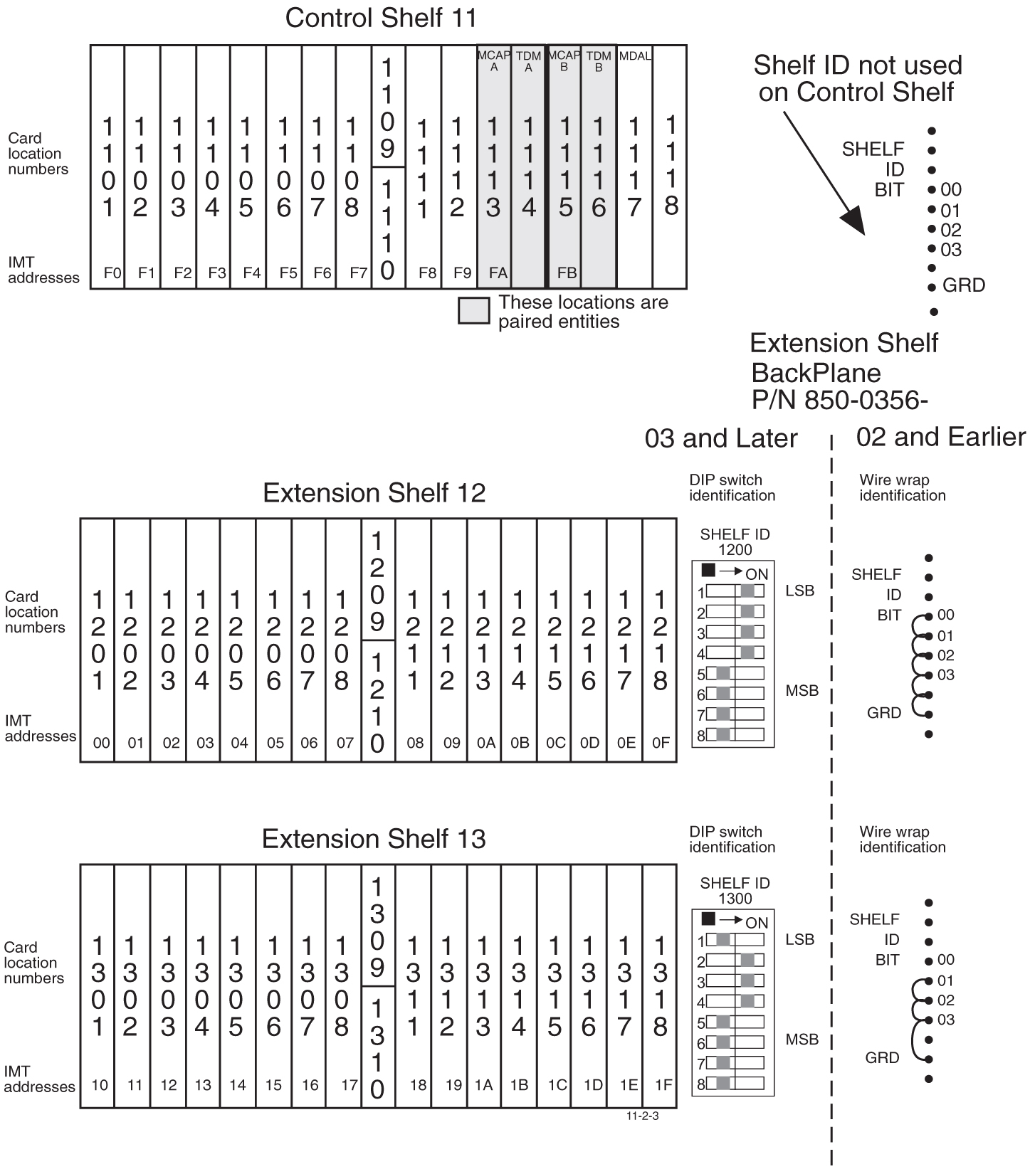

    The card location numbers in the table indicate the shelf and the slot for that card. The left two digits indicate the shelf and the right two digits indicate the card slot in that shelf. For example, a location of 1215 indicates a card in shelf 12, slot 15.
  • Figure 5-2 and Figure 5-8 to physically locate the fuse holders.
  • Fuse and Card Locations to physically locate a card in a shelf.
Table 5-10 Fuse Color Codes of Alarm Flags
Fuse Amp Fuse Flag Color Fuse Amp Fuse Flag Color
0.18A
Orange-Red
2A
Orange
0.2A
Black-Red
2.5A
White-Orange
0.25A
Violet
3A
Blue
0.33A
Yellow-Green
3.5A
White-Blue
0.375A
White-Green
4A
White -Brown
0.5A
Red
5A
Green
0.65A
Black
7.5A
Black-White
0.75A
Brown
10A
Red-White
1A
Gray
12A
Yellow-Green
1.33A
White
15A
Red-Blue
1.5A
White-Yellow
Procedure - Verify Individual Fuse Positions
  1. Ensure that all fuses have been removed.
  2. Ensure that all circuit cards have been removed.
  3. Confirm that the system is receiving power from the –48VDC power source.
    (Ensure that voltage is present by checking it with a volt ohm meter.)
  4. Install a fuse of the rating specified for that position.
  5. Install circuit cards appropriate for the slots powered by that fuse.
  6. Check that LEDs of the applicable cards are on.
    For each fuse position, perform Steps 7 through 16.
  7. Pull the fuse for the A-side position.
  8. Check that the Fuse Alarm LED for the A-side is red.
  9. Check that the LEDs of the cards in the specified locations are illuminated after the removal of the fuse.
  10. Replace the fuse for the A-side position.
  11. Check that the Fuse Alarm LED for the A-side is green.
  12. Check that the LEDs of the cards in the specified locations are illuminated.
  13. Pull the fuse for the B-side position.
  14. Check that the Fuse Alarm LED for the B-side is red.
  15. Check that the LEDs of the cards in the specified locations are illuminated after the removal of the fuse.
  16. Pull the fuse for the A-side position.
  17. Check that the Fuse Alarm LED for the A-side is red.
  18. Check that the LEDs of the cards in the specified locations are not illuminated after the removal of the fuse.
  19. Replace the fuse for the A-side and B-side position.
  20. Check that the Fuse Alarm LED for the A-side and B-side is green.
  21. Check that the LEDs of the cards in the specified locations are illuminated after the replacing of the fuses.
This completes individual fuse position testing of the FAP. Return the frame to service.

    Figure 5-27 Fuse (GMT Brand Name)
    img/t-verification-fuse-alarm-function-im-fig1.jpg

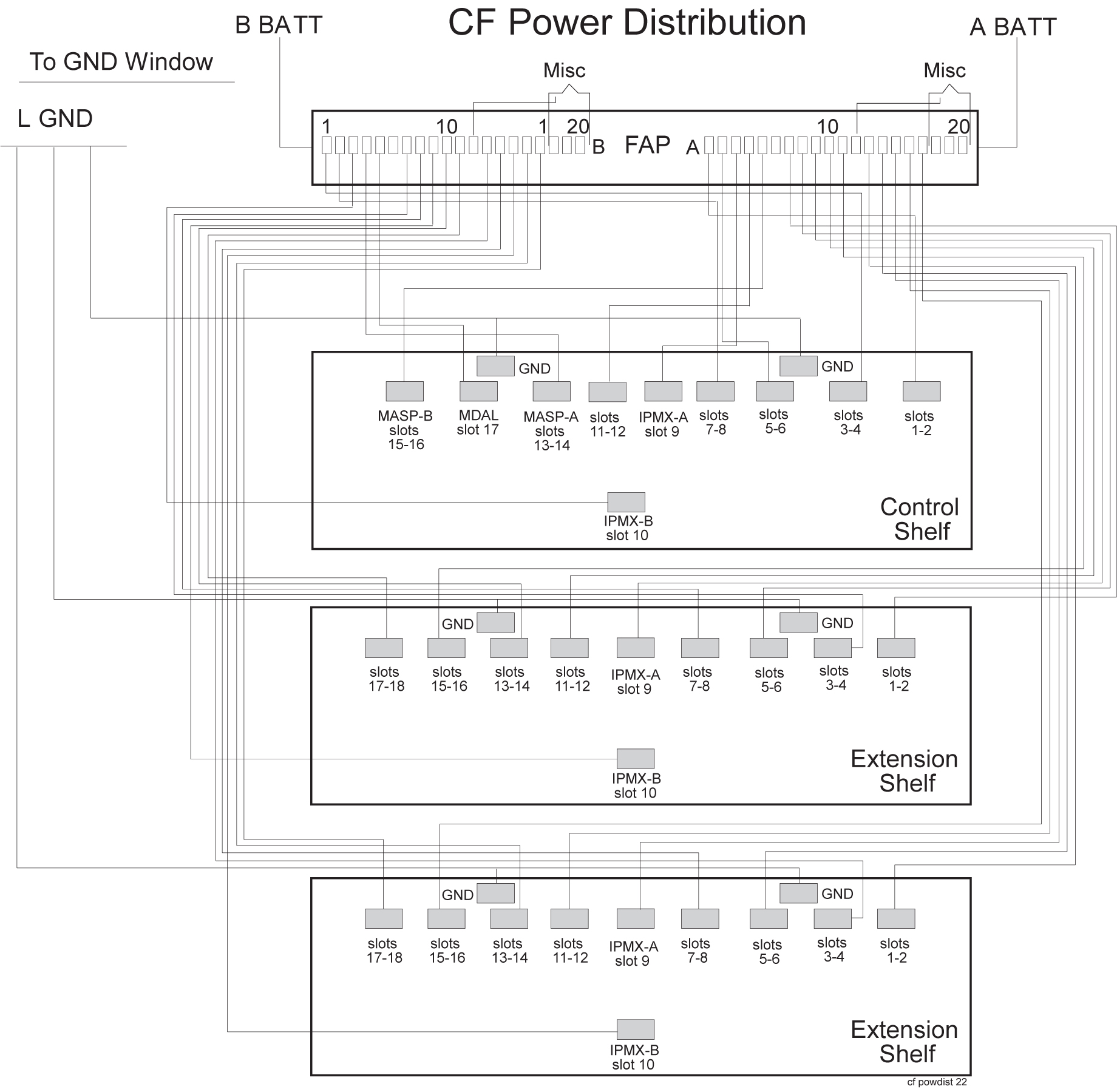

Fuse Assignments

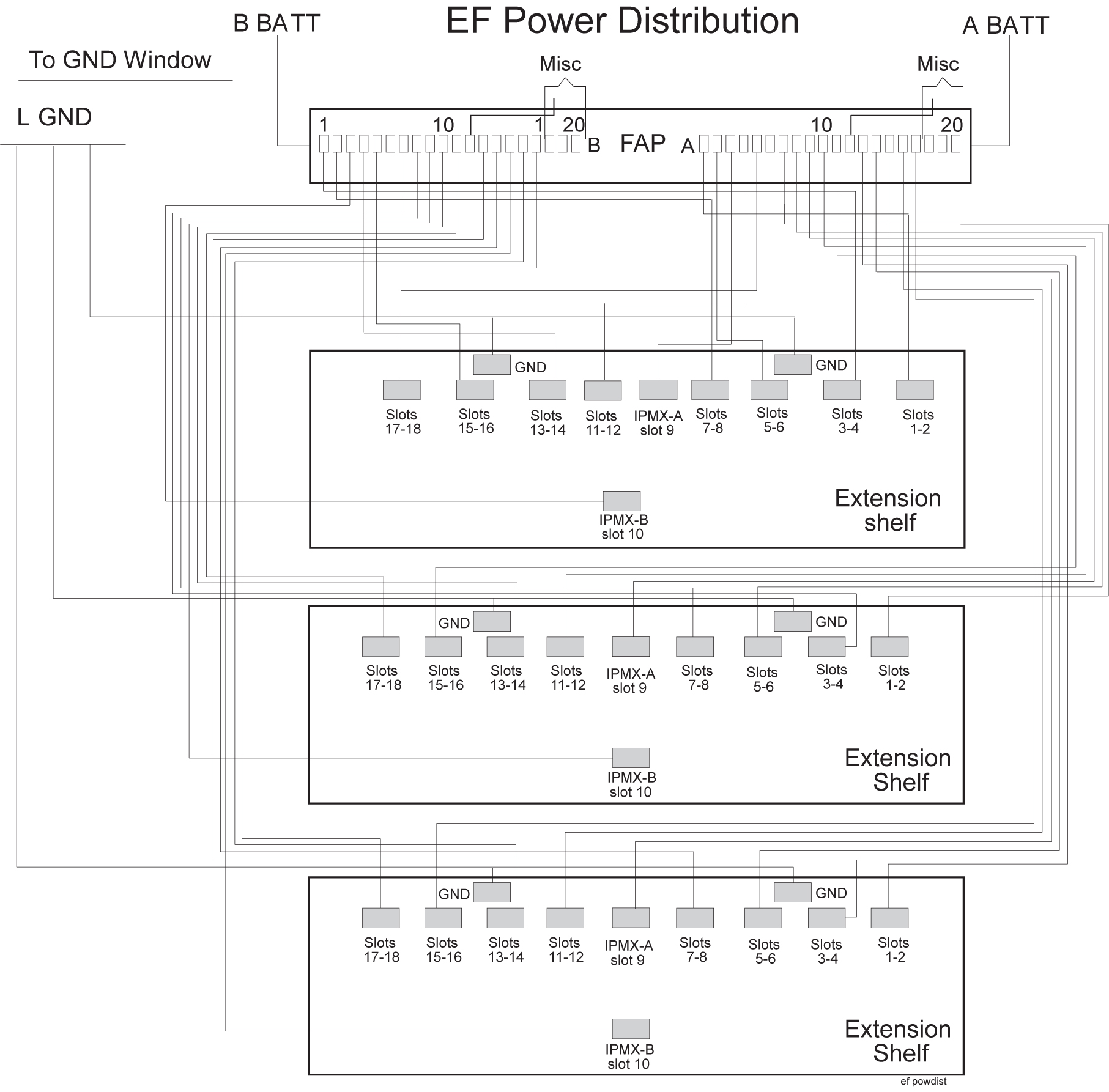

Refer to Installation “Fuse and Card Locations” section for information on the fuse assignments for the Control Frame, CF-00 and five Extension Frames, EF-00 through EF-04.
The power distribution for the control frame and the extension frame are shown in the following figures:
Figure 5-28 Control Frame FAP (P/N 870-0243-08 and P/N 870-1606-xx)
img/c-fuse-assignments-hws-fig1.jpg
Figure 5-29 Extension Frame FAP (P/N 870-0243-08 and P/N 870-1606-xx)
img/c-fuse-assignments-hws-fig2.jpg
This section describes fuse assignments for the Control Frame (CF-00) and five Extension Frames (EF-00 through EF-04) are shown.
Table 5-11 Fuses and Card Locations

Card Locations in Control and Extension Shelves
Figure 5-30 through Figure 5-35 show the card locations in Control and Extension shelves.

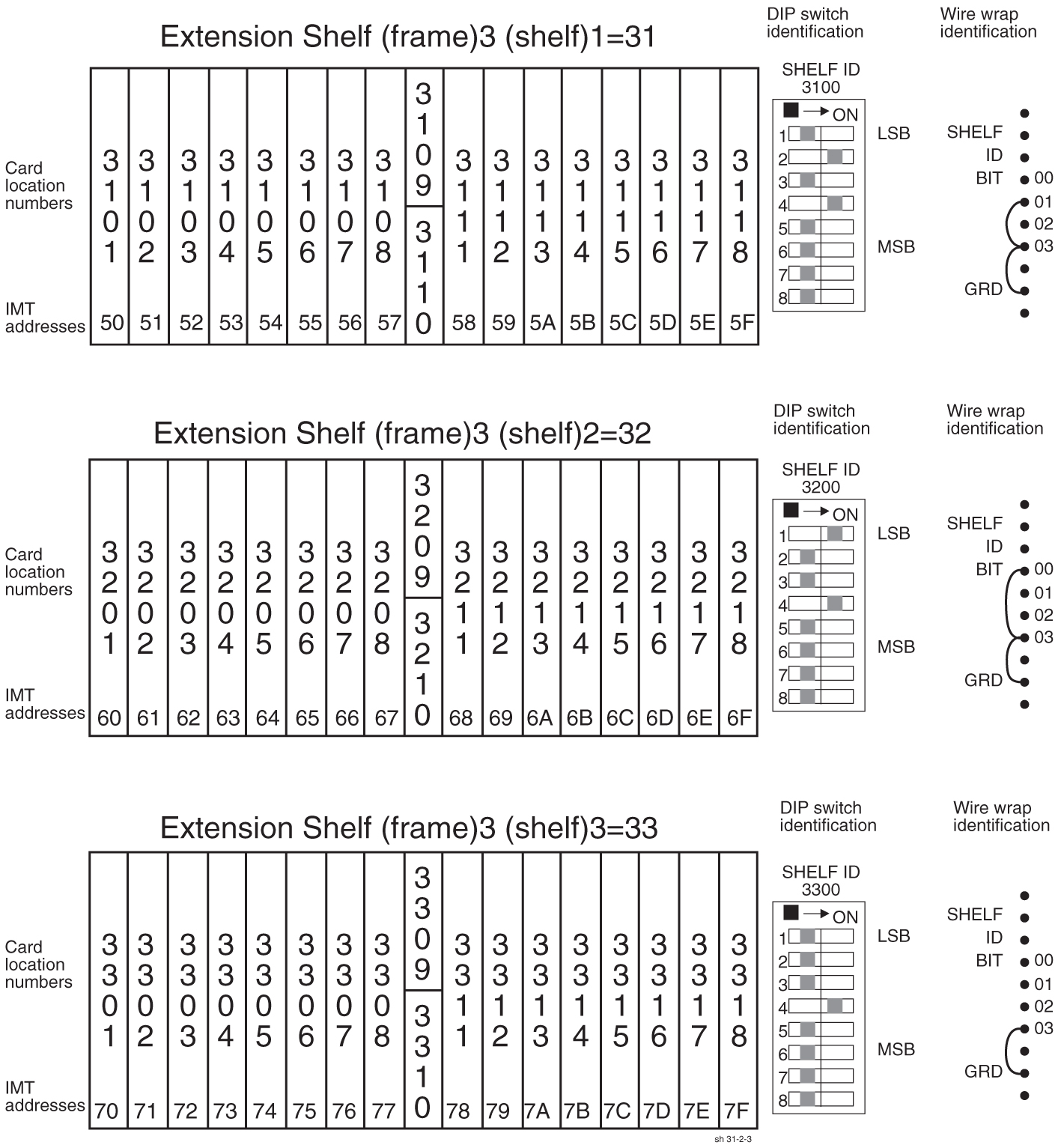

Figure 5-30 shows the numbering of the shelves, with the shelf identification DIP switch settings and backplane wiring, and card locations on theControl Frame (CF) and Extension Frame (EF).
Figure 5-30 Control Frame CF-00 Numbering Plan
img/r-card-locations-control-extension-shelves-im-fig1.jpg

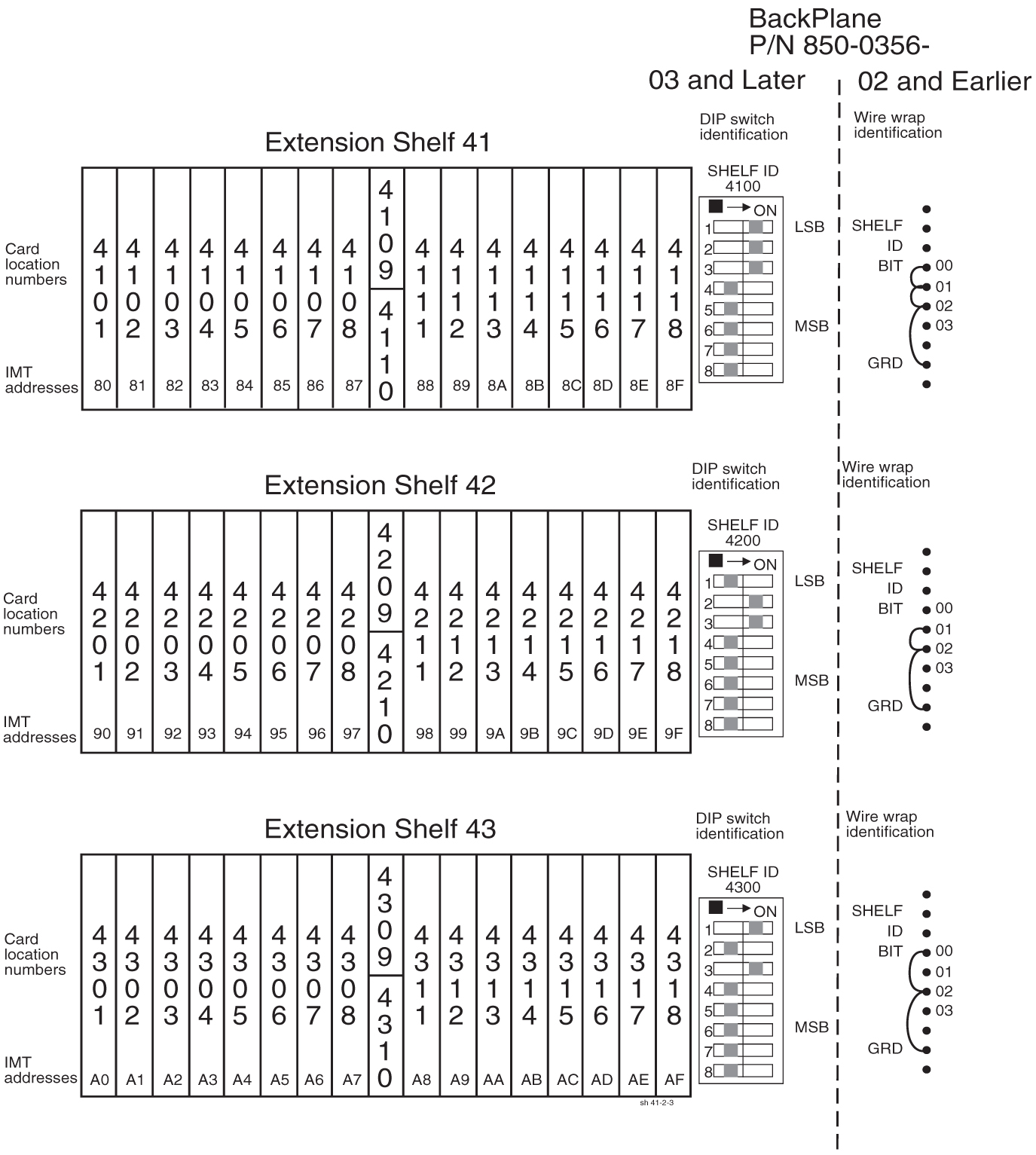

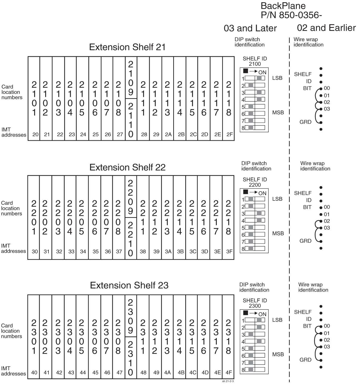

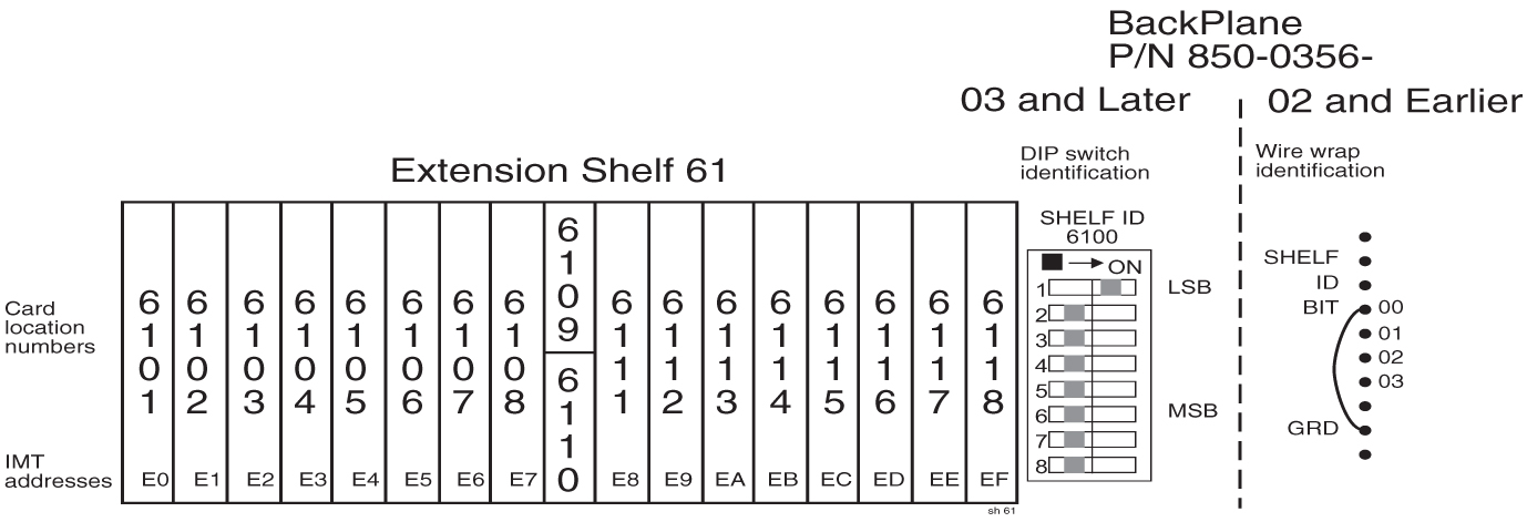

Figure 5-31 through Figure 5-35 show the numbering of the card locations on the extension frames. Along with shelf DIP switch settings and ID wire wrap.
Figure 5-31 Extension Frame EF-00 Numbering Plan
img/r-card-locations-control-extension-shelves-im-fig2.jpg
Figure 5-32 Extension Frame EF-01 Numbering Plan
img/r-card-locations-control-extension-shelves-im-fig3.jpg
Figure 5-33 Extension Frame EF-02 Numbering Plan
img/r-card-locations-control-extension-shelves-im-fig4.jpg
Figure 5-34 Extension Frame EF-03 Numbering Plan
img/r-card-locations-control-extension-shelves-im-fig5.jpg
Figure 5-35 Extension Frame EF-04 Numbering Plan
img/r-card-locations-control-extension-shelves-im-fig6.jpg
