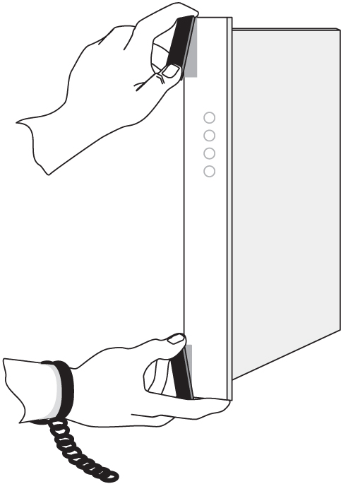

Always wear a wrist strap or other electrostatic protection when handling electronic cards or electrostatic sensitive devices.
Cam-out/lock-in levers on the front edge of the card assist in insertion and removal of the card. Grasp the card at the top and bottom, as shown in the figure below, and slide the card into the appropriate slot. Using the card slot guides in the shelf, slide the card into the shelf until the connectors on the card seat with the connectors on the backplane. Press both tabs in until they lock the card in place. To ensure proper seating, the levers must be held in the release position until the locking tabs can engage with the upper and lower flange on the shelf. Once the locking tabs on the levers engage the shelf plane, the tabs are pressed to the card faceplate, and must be flush with the faceplate when the card is completely seated.
Figure 3-1 Removing an EAGLE card

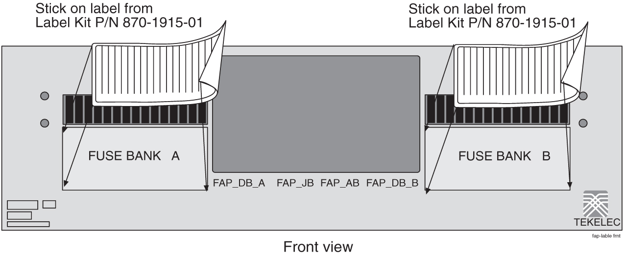

Label Kit for FAP (P/N 870-1606-xx/870-2320-xx)
Label Kit (P/N 870-1915-02) contains large sheets of die-cut stick-on labels for the appropriate frames. There are three large sheets of die-cut, stick-on labels:
  • Sheet (P/N 658-0604-01) is for FUSEBANK A, CONTROLFRAME through EF-04
  • Sheet (P/N 658-0604-02) is for FUSEBANK B, CONTROLFRAME through EF-04
  • Sheet (P/N 658-0604-03) is for MISCFRAME
Also included in the Label Kit (P/N 870-1915-02) are smaller die-cut stick-on labels for different fuses relating to different amps and individual pieces of site-specific equipment; these are to be pressed into fuse OPEN spaces.
  1. Peel the individual die-cut label that designates a specific frame from one of the three large die-cut sheets of labels.
  2. Press the sticky side of the label into the silk screened area on the front of the faceplate of the Fuse and Alarm Panel (P/N 870-1606-xx) for the specific frame. (refer to Figure 5-8).
    The left side of the faceplate is marked A and the right side of the faceplate is marked B.
  3. The labels must be pressed into place on the front faceplate of the correct frame.
    Figure 3-4 FAP, Fuse Label Kit (P/N 870-1915-02)
    img/c-label-kit-fap-pn-870-1606-xx-870-2320-xx-hws-fig1.jpg
The label designates CONTROLFRAME or EF-00 through EF-04.
