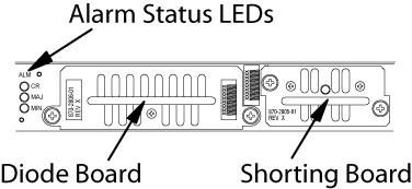

Diode Testing and the Shorting Board
The Diode Board must be tested periodically. To test the Diode Board without powering down the entire EAGLE, peform the following procedures.
Maintenance Mode
This section describes how to place the Shorting Board into maintenance (bypass) mode. Maintenance mode allows the removal of the Diode Board without taking down the system.
Procedure — Shorting Board Maintenance Mode
  1. Check to verify the Shorting Board LED is not on, indicating the FAP is in normal mode.2.
  2. Locate two screws securing the Shorting Board in its slot (see Figure 2-2). Note the orientation of the Shorting Board LED. Turn the screws at each corner of the board to the left until they disengage.
    Figure 2-2 Shorting Board Faceplate, Normal Mode
    img/c_jumper_board_1u_sbops_mode_im-fig1.jpg
  3. Pull the board straight out of the FAP until the board is clear of the frame.
  4. Turn the Shorting Board over and reinsert the board into its slot. Note the orientation of the Shorting Board LED (see Figure 2-3).
    Figure 2-3 Shorting Board Faceplate, Maintenance Mode
    img/c_jumper_board_1u_sbmtc_mode_im-fig1.jpg
    The Shorting Board LED turns green and the fuse alarm LEDs turn red.
  5. Ensure the board is seated properly and tighten the two screws to secure the board.
  6. The Shorting Board is now in the maintenance (bypass) mode of operation.

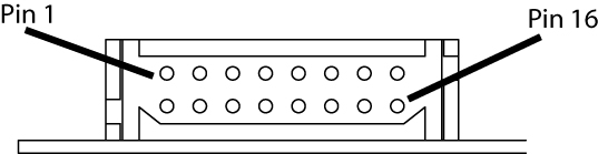

Procedure - Diode Testing
Use this procedure to test the power diodes on the Diode Board. A Digital Volt/Ohm Meter (DVM) with a Diode Setting is required. All testing is performed at the edge connector (J1) on the board.
Figure 2-5 Diode Board Edge Connector J1
img/c_1ufap_location_j1_maintmanual.jpg
  1. Set the DVM to test diodes.
  2. Connect the DVM positive (+) lead and negative (-) lead to the pins indicated for each power diode.
    Table 2-4 Power Diode Test Points
    Diode J1 Pin Positive (+) Lead J1 Pin Negative (-) Lead
    CR1 #1
    3
    16
    CR1 #2
    6
    16
    CR2 #1
    14
    1
    CR2 #2
    11
    1
    CR3 #1
    4
    16
    CR3 #2
    5
    16
    CR4 #1
    13
    1
    CR4 #2
    12
    1
    The DVM should indicate a short circuit (>0.1V, <0.2V). Record the measurement.
  3. Reverse the leads.
    The DVM should indicate an open circuit (OL). Record the measurement.
  4. If any measurements are in error, the diode board must be replaced.

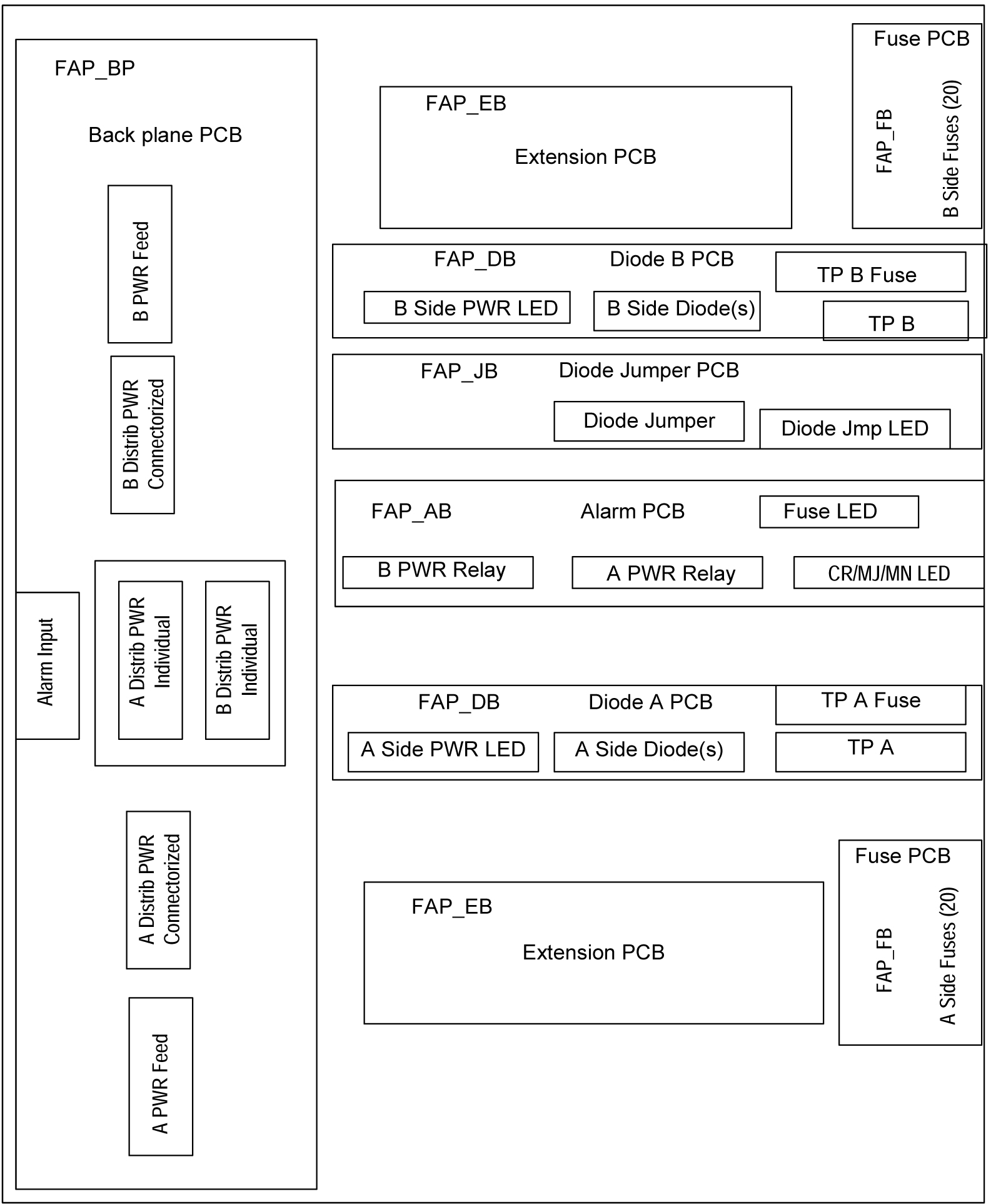

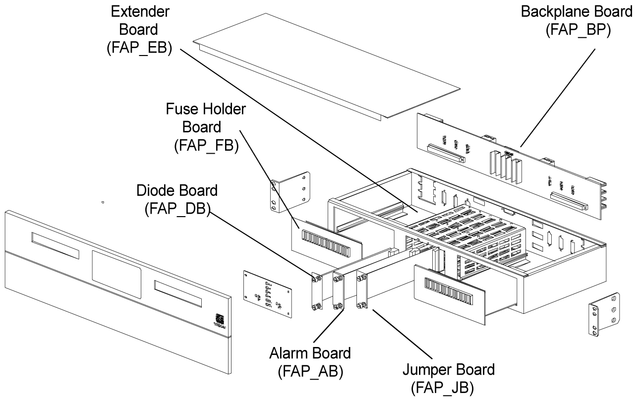

FAP Components
The FAP consists of nine printed circuit boards, each identified by an acronym on its label (see Figure 2-8):
  • Backplane (FAP_BP): Located inside the FAP unit, parallel to the back side of the FAP box.
  • Alarm board (FAP_AB): Located on the center-right of the front panel, set vertically inside the FAP unit, perpendicular to the front panel.
  • Diode boards (FAP_DB): Two boards located on the front panel, flanking the Alarm and Jumper boards on the left and right, and perpendicular to the front panel. Set vertically inside the FAP unit.
  • Extender boards (FAB-EB): Two boards located inside the FAP unit, parallel to the bottom of the FAP box, on the far right and left of the unit.
  • Fuse holder boards (FAP_FB): Two boards located inside and parallel to the front panel, on the far right and left of the FAP unit.
  • Jumper board (FAP_JB): Located on the center-left of the front panel, set vertically in the unit, perpendicular to the front panel.
Figure 2-8 Location of FAP Components
img/c_fap_components_maintmanual-fig1.jpg
Each of the FAP components has associated functions.
Figure 2-9 FAP Component Functions
img/c_fap_components_maintmanual-fig2.jpg
The FAP is composed of nine circuit boards. Eight of these circuit boards are field replaceable, and can be hot-swapped.
Table 2-5 FAP Component Replacement
Component Replacement Requirements Part Number
FAP Backplane
(FAP_BP)
Must be replaced through factory
850-0515-xx
FAPAlarm Board
(FAP_AB)
Field replaceable
850-0518-xx (card)
870-1609-xx (assembly)
FAP Diode Boards
(FAP_DB_A and
FAP_DB_B)
Field replaceable
(one at a time)
850-0517-xx (card)
870-1608-xx (assembly)
FAP Extender Boards
(FAP_EB)
Field replaceable
(one at a time
with service interruption)
850-0519-xx
FAP Fuse Holder Boards
(FAP_FB)
Field replaceable
(one at a time
850-0516-xx
FAP Jumper Board
(FAP_JB)
Field replaceable
850-0523-xx (card)
870-1641-xx (assembly)
The following sections describe each type of circuit board:
Backplane Board (FAP_BP)
The backplane circuit board provides all of the external connections for the FAP. It consists primarily of circuit routing and connectors, but also has one pull-down resistor, which provides a default alarm signal for the Fuse Alarm in the event the alarm board is removed from the FAP.
Alarm Board (FAP_AB)
The alarm circuit board provides indicators and relays for the EAGLE status and fuse alarms. This board includes a jumper (JMP50) for future use. This jumper is installed for all existing configurations.
Diode Boards (FAP_DB)
The diode circuit boards provide power diodes and power input test points. Four diode footprints are included: two for Assembly A and two for Assembly B. Only one of the four positions is intended to be populated; the second footprint is provided for future part rating changes or additional heat-dissipation capabilities.
Extender Boards (FAP_EB)
The extender board provides connection between the backpanel board and the fuse holder boards.
Fuse Holder Boards (FAP_FB)
The fuse holder boards provide 20 fuses with a common alarm.
Jumper Board (FAP_JB)
The jumper board provides the capability to by-pass the diode boards with a fuse. Use this board only for maintenance operations.

Diode Testing and the Diode Jumper
The diode board must be tested periodically. To test a diode circuit board without powering down the entire EAGLE, perform the procedure listed in Table 2-8 for the corresponding FAP part number.
Table 2-8 FAP Part Numbers and Corresponding Procedures
Part Number FAP Procedure
870-1606-01 (all revisions)
Procedure 1
870-1616-02 revision G or lower
Procedure 1
870-1606-02 revision H or higher
Procedure 2
870-2320-01 revision B or lower
Procedure 1
870-2320-01 revision C or higher
(or 870-2320-03)
Procedure 2
Procedure 1
This procedure to test a diode circuit board without powering down the entire EAGLE applies to the following FAPs:
  • 870-1606-01 (all revisions)
  • 870-1616-02 with a revision G or lower
  • 870-2320-01 with a revision B or lower
  1. Check to verify the OP/MAINT LED is green, indicating the FAP is not in maintenance mode.
  2. Unscrew the two thumbscrews securing the FAP jumper board and remove the board.
  3. On the jumper circuit board, move the jumper (the DB-26 male connector) from P71 to P72. Tighten the thumbscrews connecting the jumper to its mate, to ensure a good connection. This repositioning overrides the diodes, establishing a direct connection between input and fuse panels.
    warning:
    If fuses are blown, DO NOT continue with this procedure. Instead, contact My Oracle Support (MOS) at the appropriate number.
  4. Make sure the glass fuses are installed and verify they are “good” by using the multimeter to check for continuity across each of the glass fuses.
  5. Verify that two glass fuses are behind the P72 connector. If these fuses are not present, install them before continuing.
  6. Slide the jumper board back into the FAP and verify both of the following alarms display:
    • the OP/MAINT LED lights red on the FAP
    • an EAGLE fuse alarm displays on the terminal
      You may now remove either or both diode circuit boards without affecting EAGLE service.
    Using the jumper override negates the backpower protection usually provided by the diode board.

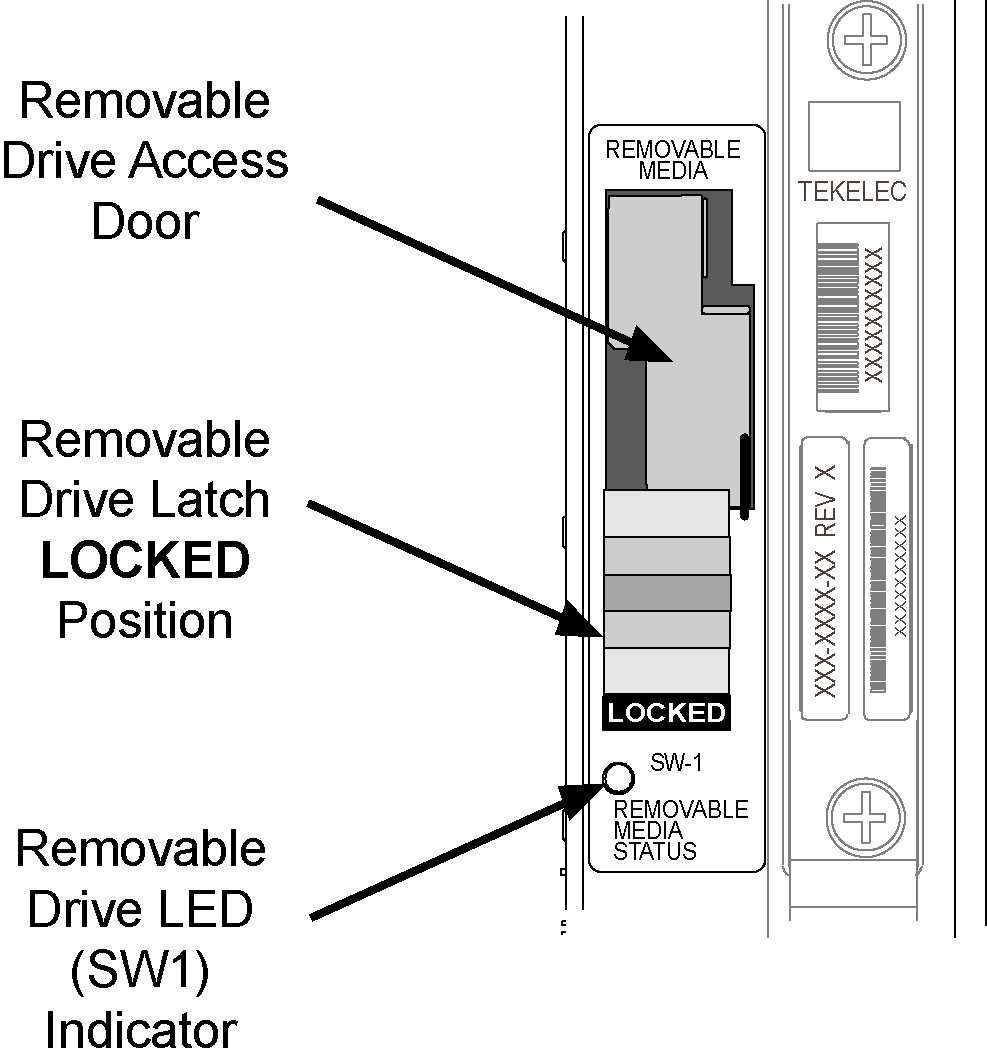

  1. Verify that the removable USB drive is locked in position and in use.
    The removable drive latch (SW1) is in the LOCKED position and the Removable Media Status LED on the E5-MASP is Off. Refer to Figure 2-10.
    Figure 2-10 Removable USB Drive LOCKED
    img/870-2903-xx_e5-masp_removable_drive_latch_locked.jpg
  2. Move SW1 from the LOCKED to the unlocked position and wait for the LED to indicate a steady blue state. See Figure 2-11.
    When SW1 is transitioned from locked to unlocked, the LED will flash blue to indicate the drive is unlocked and in process of shutting down.

  11. Verify that the SATA drive is locked in position and in use. Refer to Figure 2-12.
    The SATA drive latch (SW2) is in the LOCKED position and the SATA Media Status LED on the E5-MASP is Off.
    Figure 2-12 SATA Drive Locked
    img/870-2903-xx_e5-masp_sata_drive_latch_locked.jpg
  12. Move SW2 from the LOCKED to the unlocked position and wait for the LED to indicate a steady blue state. See Figure 2-13.
    When SW2 is transitioned from locked to unlocked, the LED will flash blue to indicate the drive is unlocked and in process of shutting down.
    Caution:
    Removal of the drive prior to the LED indicating steady red could result in drive corruption.
    Caution:
    If locking switch is transitioned from locked to unlocked and the E5-MASP is in service, removal of the drive module will result in a card obit. All drive LEDs will blink red.
    Figure 2-13 SATA Drive UNLOCKED
    img/870-2903-xx_e5-masp_sata_drive_latch_unlocked.jpg
  13. When the LED indicates a steady blue state, the SATA drive can be safely removed. The LED is off when the drive is fully ejected from the drive.
    The drive can now be removed from the slot.
  14. Loosen the SATA drive mounting screws.
  15. Grasp the screws and pull the drive out slowly until it is free from the card.
  16. Slide a SATA drive into the drive slot on the card.
  17. Gently push the drive in slowly until it is properly seated.
  18. Tighten the mounting screws.
  19. Move SW2 from the unlocked to the LOCKED position.
    When SW2 is transitioned from unlocked to locked, the LED will flash blue to indicate the drive is locked and in process of coming online.
  20. When the LED turns Off, the SATA drive is ready for use.

  3. Insert the removable USB drive labeled “Daily Backup” into the removable USB media slot. You can also use the USB storage media in the flush-mounted USB port of the MASP card for backups.
    Reference: Removable Drives

  6. Remove the removable USB drive from the removable USB media slot.

Database Archive (Quarterly)
Purpose:
The purpose of this routine is to create an archive copy of the EAGLE database. This archive copy should be stored off-site and saved for emergency recovery when all other procedures have failed. This routine will reuse the same removable USB drive each quarter.
Requirements
This procedure requires a removable USB drive formatted for system data.
Interval
Quarterly
Procedure _Database Archive (Quarterly)
  1. Enter the following command to check the operational status of the database:
    rept-stat-db
    If necessary, refer to Commands User's Guide to interpret the output.
  2. Insert the removable USB drive labeled “Archive” into the removable USB drive media slot. You can also use the USB storage media in the flush-mounted USB port of the MASP card for backups.
  3. Enter the following command to create a backup of the database on the removable USB drive:
    chg-db:action=backup:dest=remove
    BACKUP (REMOVABLE) : MASP A - Backup starts on active MASP.
    BACKUP (REMOVABLE) : MASP A - Backup to removable USB drive complete.
    For the USB storage media in the flush-mounted USB port of the MASP card for backups, use the following command:
    chg-db:action=backup:dest=usb
  4. Verify that the databases on the removable USB drive (RDBKUP) and the current partition of the active MASP (FDCRNT) are coherent by entering the following command:
    rept-stat-db
  5. Remove the removable USB drive from the removable USB drive media slot.
  6. Make an entry in the site maintenance log that a backup was performed on the “Archive” removable USB drive.
    Place the removable USB drive in a safe place off-premise. This copy is for emergency recovery in the event all other methods of database recovery failed.
