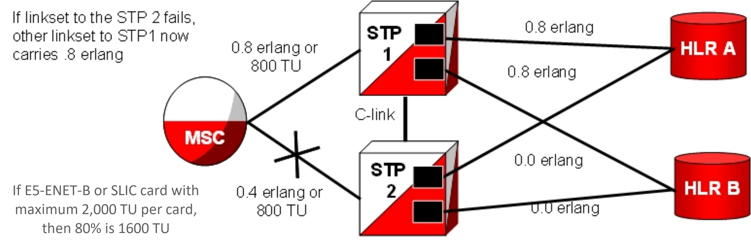

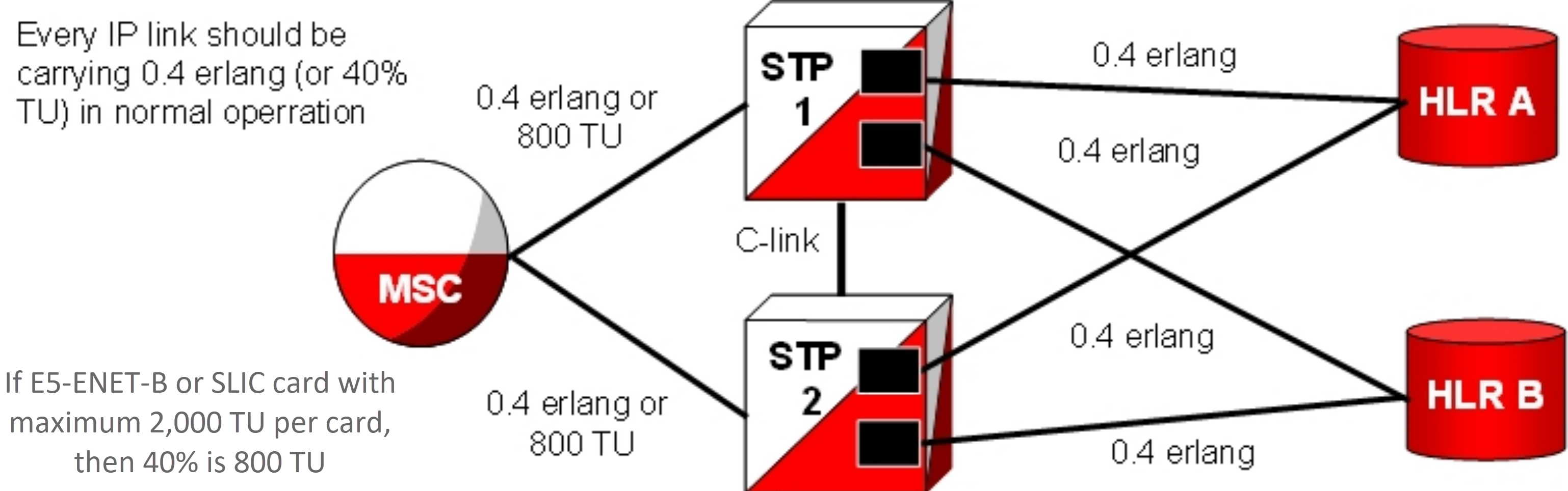

5.3 Achieving IP Signaling Applications’ Advertised Capacity
A goal of properly engineered networks is to eliminate congestion. Advertised Capacity refers to the maximum TPS that can be sustained without congestion. Several factors affect TPS calculations and must be considered when calculating the expected throughput for the IPSG application.

- In a normal scenario, run the card at a maximum of 40% total capacity (0.4 erlang)
- In failover scenarios, the card runs at 80% of total capacity (0.8 erlang)
The IPSG can be configured to support M2PA B-, C-, and D-Links; or to support A- and E-Links (see the note in M3UA (MTP Level 3 User Adaptation Layer) Protocol for more information about A-links).
Every IP link should carry 0.4 erlang (or 40% TU) in normal operation. For an E5-ENET-B card with a maximum of 2,000 TU per card, 40% is 800 TU. This scenario is depicted in Figure 5-1.
Figure 5-1 SIGTRAN: Every IP Link at 0.4 Erlang
If the linkset to STP2 fails, another linkset to STP1 now carries 0.8 erlang. For a SLIC card with a maximum of 2,000 TU per card, 80% is 1,600 TU. This scenario is depicted in Figure 5-2.
Figure 5-2 SIGTRAN: Failover at 0.8 Erlang

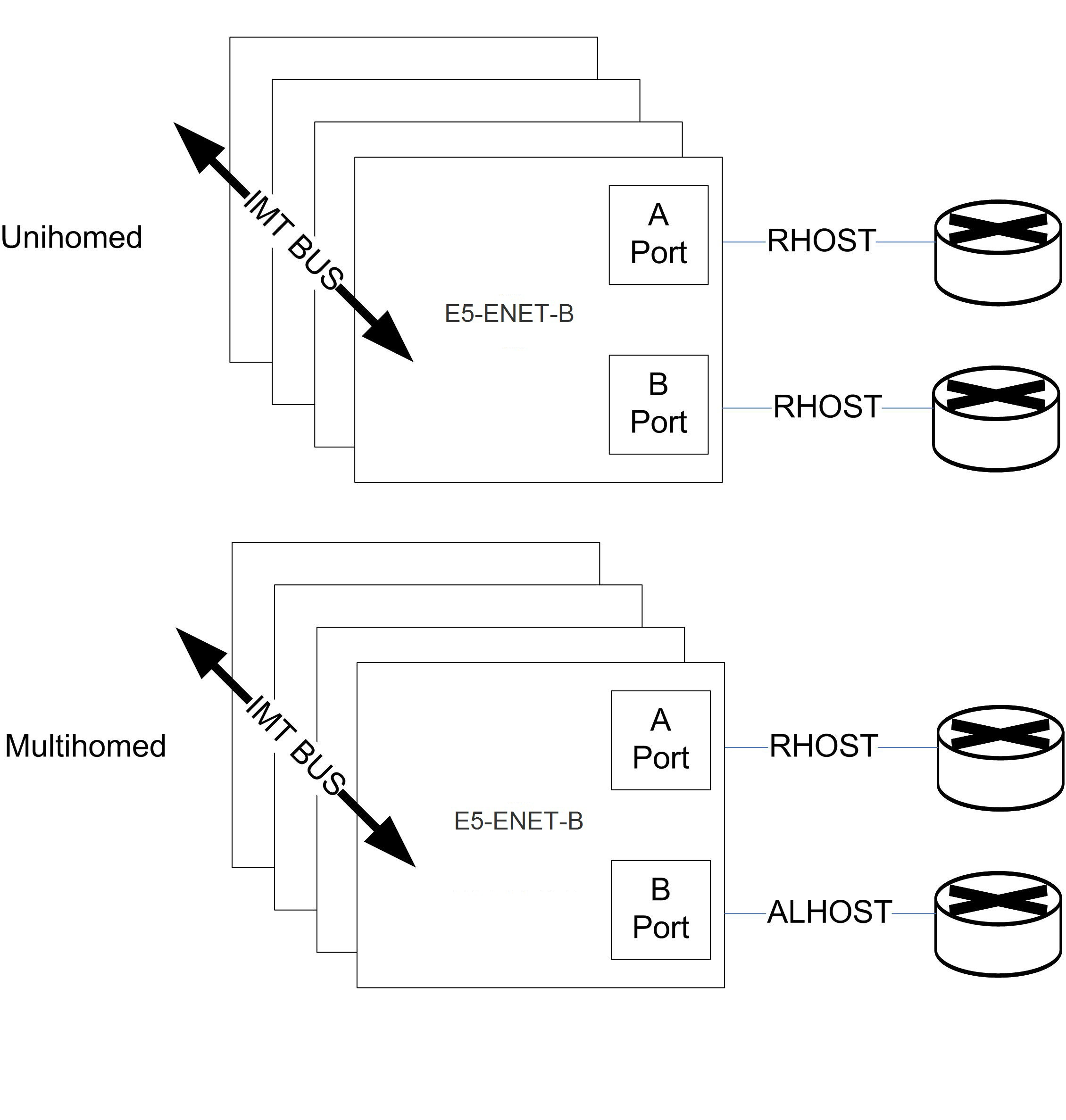

5.5.1 Unihoming versus Multihoming
EAGLE can be deployed with completely redundant IP network paths, each of which must be capable of sustaining the worst-case traffic load. Either of these two methods can be applied, depending on the application used:
- Unihomed links (for M2PA links)
- Multihomed links (for M2PA, M3UA links)
Unihoming
For unihoming, a set of IPSG cards, which are configured for worst-case traffic load, hosts one signaling link per linkset. Each signaling link is assigned to a unihomed SCTP association, where half of the associations are assigned to one independent IP network path, and the other half are assigned to another independent IP network path. Each network path must have dedicated bandwidthsufficient to sustain the worst-case traffic load.
Since each IPx card maintains a single static IP route table utilized by all Ethernet interfaces or ports, associations from only one of the local hosts (IP ports) of an IP card to a particular remote host address is possible. Associations from multiple local hosts of an IP card to the same remote host address is not possible.Multihoming
For multihoming, a set of IPSG cards, which are configured for worst-case traffic load, is hosting one signaling link per linkset. Each signaling link is assigned to a multihomed SCTP association, which is mapped to an IP network having at least two completely redundant paths. Each network path must have dedicated bandwidth sufficient to sustain the worst-case traffic load.
Multihoming is very important for M3UA connections because it is the only means of lossless handover in the event of a path failure.
Multihoming provides network-level resilience for SCTP associations by providing information on alternate paths to a signaling end point for a single association.
SCTP multihoming supports only communication between two end points, of which one or both are assigned with multiple IP addresses on possibly multiple network interfaces. Each IPx card maintains a single static IP route table, utilized by both Ethernet interfaces or ports. By checking the destination address in this IP route table, the router determines the port from which the message is transmitted by the IPx card.
This means that it is not possible to have a route to a single destination from both ports of an IP card – it must be one port or the other. SCTP multihoming does not support communication ends that contain multiple end points (i.e., clustered end points) that can switch over to an alternate end point in case of failure of the original end point.
Figure 5-3 Unihoming versus multihoming
Multi-homing can be used for M2PA links if the M2PA linkset has only one link.
If the M2PA linkset has more than one link, then the value of the M2PA Timer T7 should be lower than RMIN * RTIMES in order for the MTP3 level to trigger a Change Over procedure for MTP3 links.
RMIN*RTIMES is the minimum time required for an association to restart due to the RTIMES retransmission (via the primary and alternate path in round robin fashion) for an association without receiving any SACK. If the association is closed before the T7 expiration, then the buffer is cleared before the Change Over procedure is triggered by the MTP3 level.5.5.2 Choosing a Redundancy Method for M2PA Links
Unihoming is simpler to configure but more expensive than multihoming, in terms of computational power and network bandwidth to handle worst-case failure. Unihoming requires change-over procedures and rerouting if a network path is interrupted, whereas a multihomed SCTP association will simply switch to the alternate network path.
SCTP multihoming, in general, is less mature than MTP3 change-over procedures. In addition, the lack of ARHOST configurability in the EAGLE can result in asymmetrical traffic on a multihomed connection when both paths are available, which may be undesirable.
The EAGLE fully supports both options for M2PA, but Oracle recommends unihoming.
