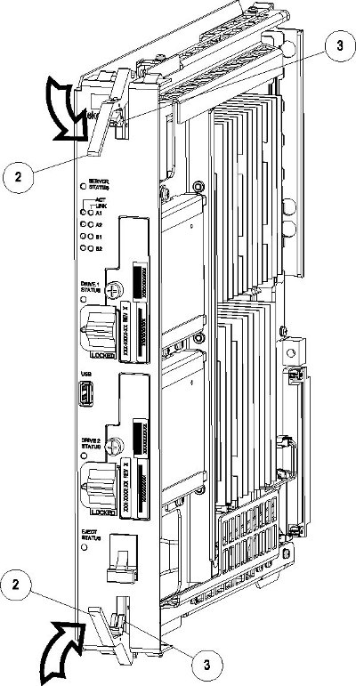

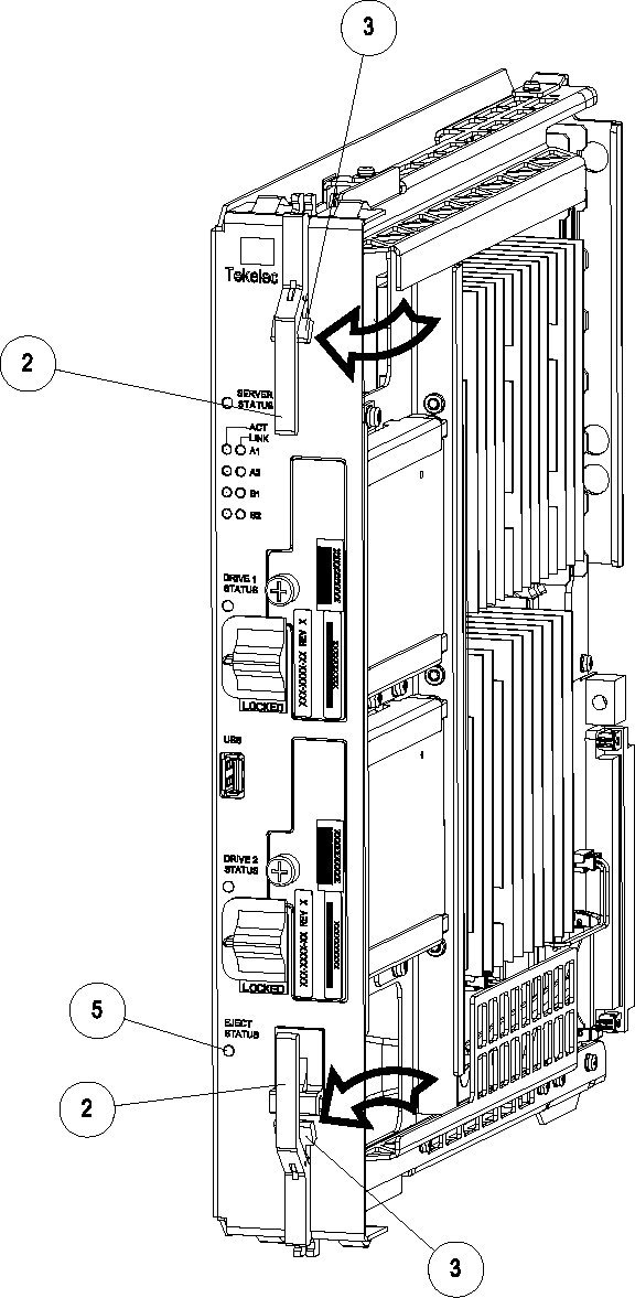

  2. Grasp the upper and lower card Inject/Eject (I/E) lever release (3) just underneath the I/E lever, and press it to meet the I/E lever. This is the mechanical interlock for the card (see Figure 4-3).
  3. While holding the I/E interlock and lever, pull the levers (2) away from the card until they are parallel to the floor.

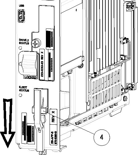

  6. Slide the E5-APP-B H/S switch (4) down to the LOCKED position (see Figure 4-4).
    When the Ejector switch goes from UNLOCKED to LOCKED, the E5-APP-B Eject Status LED blinks red as the E5-MASP card goes online.

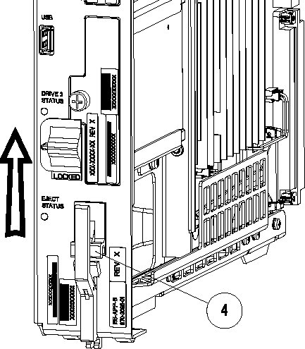

  1. On the E5-APP-B card, slide the Ejector switch (4) up to the UNLOCKED position (see Figure 4-5).
    Caution:
    When the Ejector switch goes from locked to unlocked and the E5-APP-B card is in service, the card will halt.

  3. Grasp the upper and lower card Inject/Eject (I/E) lever release (3) just underneath the I/E lever, and press it to meet the I/E lever. This is the mechanical interlock for the card.
    See Figure 4-6
    Figure 4-6 E5-APP-B Card UNLOCKED
    img/card-eject-2.jpg
  4. While holding the I/E interlock and lever, pull the levers (2) away from the shelf until they are parallel to the floor.
