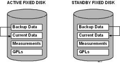

The dest parameter can be specified only when action=backup. If the dest=fixed parameter is specified, or the dest parameter is not specified, the database on the current partition of the fixed disk is copied to the backup partition of the fixed disk. This action is shown in Figure 4-1.
Figure 4-1 chg-db:action=backup:dest=fixed

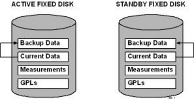

The src parameter can be used only when action=restore. To restore the database, if the src=fixed parameter is specified or the src parameter is not specified, the backup partition of each fixed disk is copied to the current partition of the fixed disk. This action is shown in Figure 4-2.
Figure 4-2 chg-db:action=restore:src=fixed

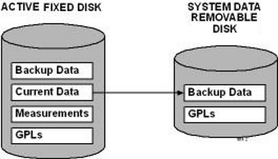

If the dest=remove parameter is specified, the database on the current partition of the active fixed disk is copied to the removable drive. This action is shown in Figure 4-3.
Figure 4-3 chg-db:action=backup:dest=remove

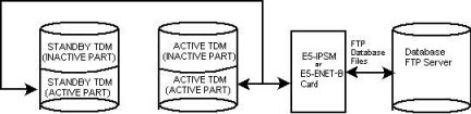

If the chg-db:action=restore:src=server:filename=xxxxxx.tar or chg-db:action=backup:dest=server command is entered, the database partitions are copied from or to the remote server application through an IPSM card. This action is shown in Figure 4-4.
Figure 4-4 Remote Backup or Restore

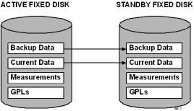

If the action=repair parameter is specified, the current and backup database partitions are copied from the active fixed disk to the standby fixed disk. This action is shown in Figure 4-5.
Figure 4-5 chg-db:action=repair

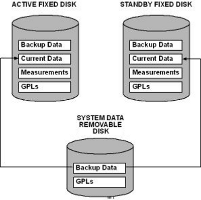

If the src=remove parameter is specified, the database on the removable drive is copied to the current partitions on both the active and standby fixed disks. This action is shown in Figure 4-6.
Figure 4-6 chg-db:action=restore:src=remove
