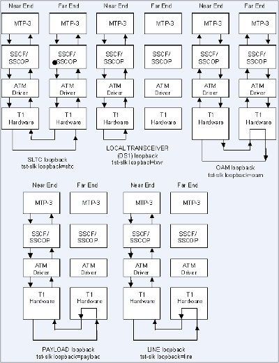

tst-slk OAM EAGLE initiated Level 1 ATM test
Link State-Down
Equipment tested-Near and far end level 1 software and hardware including all hardware on the cards
Purpose-Test the entire near and far end level 1 hardware by exchanging ATM cells
Description-Sends OAM cells out to far end for 60 seconds if no errors, or 2 minutes if errors are received
Typical use-Verifies ATM cells can be exchanged between 2 signaling points
  • E5-ATM-B
1024 concurrent link tests per system
tst-slk LINE EAGLE initiated Level 1-2 ATM test
Link State-Down
Equipment tested-Near end hardware up to level 2 and far end hardware level 1 interface
Purpose-Hardware continuity check between near and far end
Description-The following steps occur:
  1. Device under test (DUT) sends T1 Payload bit-oriented code (BOC) to remote device
  2. Remote device receives BOC and programs hardware
  3. DUT attempts level 2 alignment
  4. If link aligns (level 2), test passes, else test fails
  5. DUT sends BOC to remote device to remove loopback
  6. Remote device receives BOC and re-programs hardware
If the DUT boots in the middle of sequence, activate or de-activate the link, and the remote device returns to the original programming.
Typical use-Checks continuity from the near end level 2 hardware to the level 1 interface at the far end for a link in line timing
  • E5-ATM-B (T1 mode)
tst-slk PAYLOAD EAGLE initiated Level 1-2 ATM test
Link State-Down
  1. Device under test (DUT) sends T1 Payload bit oriented code (BOC) to remote device
Typical use-Checks continuity from the near end level 2 hardware to the level 1 interface at the far end for a link in master timing
tst-slk LXVR (DS1 loop) EAGLE initiated Level 1 Internal card loopback
Link State-Down
Equipment tested-Local card
Purpose-Test the near end card only
Description-Test the near end card up through level 2.
Typical use-Validates the card on the Eagle as good
  • E5-E1T1-B
  • E5-ATM-B

Figure A-1 ATM Loopback Tests
img/loopback_background.png
