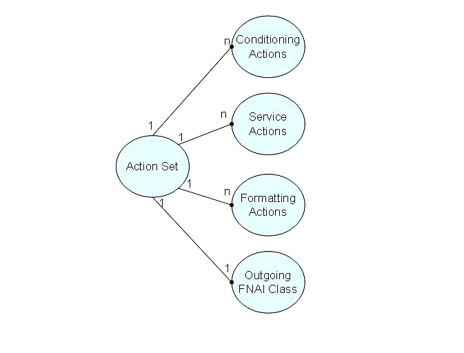

Action Sets
NPP allows customized numbering plan processing behavior to be provisioned as an Action Set. Up to 1024 Actions Sets are supported by an EAGLE.
An Action Set consists of three types of Actions and an outgoing FNAI class:
  • Conditioning Actions (CAs; up to 12 per Action Set) determine how a digit string is manipulated prior to applying service-specific behavior Digit manipulation includes number conditioning to international format and extraction of digits to use in formatting the outgoing digit string.
  • Service Actions (SAs; up to 8 per Action Set) determine what service-specific behavior to apply to a digit string (such as corrective dialing and number portability checking).
  • Formatting Actions (FAs; up to 12 per Action Set) determine how the outgoing digit string is formatted after Service Action execution.
  • Outgoing FNAI Class (outgoing FNAI or OFNAI ; one per Action Set) setting communicates the NAI of the outgoing digit string to the calling service.
Figure 4-1 shows the relationship between Actions and Action Sets.
Figure 4-1 Action and Action Set Relationship

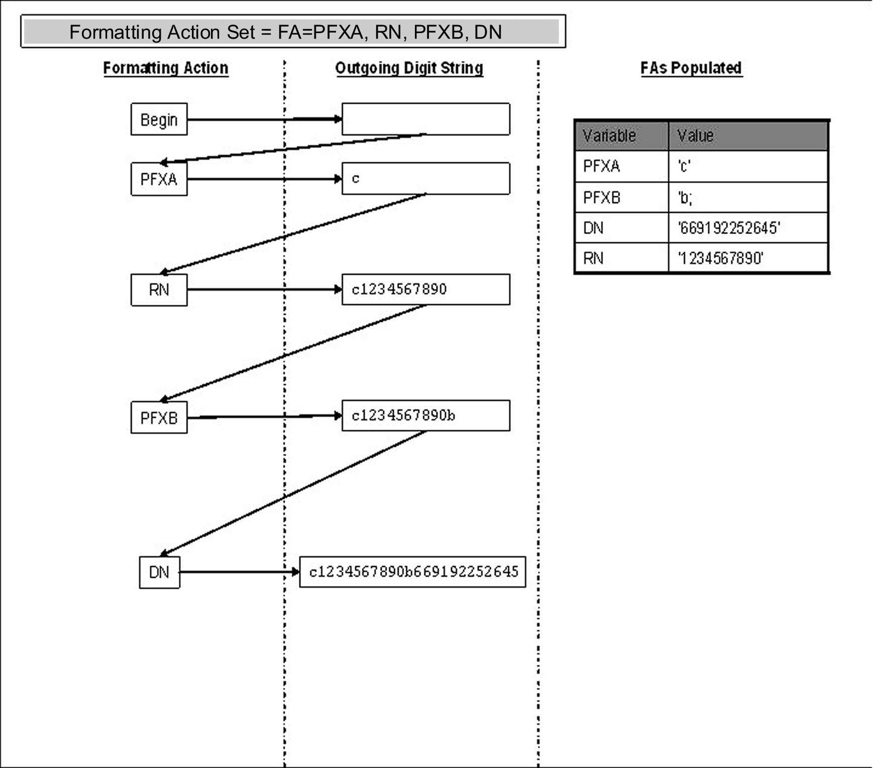

Formatting Action Execution
Conditioning Actions and Service Actions populate Formating Action digit string values that are used to construct the outgoing digit string during Formatting Action execution.
Formatting Action execution occurs after Service Action execution is complete for a digit string. The Service Action can indicate whether Formatting Action execution will or will not occur for the string.
NPP begins with an empty outgoing digit string, and inserts digits into the string in the order in which the Formatting Action values are provisioned in a sequenced list of comma-separated parameter values consecutively number parameter values. If a provisioned Formatting Action is not populated, the outgoing digit string is not modified for that Formatting Action.
After successful digit string processing and Formatting Action execution, NPP sends an outgoing NAI value (see Outgoing FNAI Class with the outgoing digit string to the calling service.
Formatting Actions Examples
The effects of Formatting Actions on digit strings are shown in Table 4-6, Table 4-7, Table 4-8, and Table 4-9. The examples include assumptions for required Conditioning Actions and Service Actions.
Table 4-6 FA Example 1
Example 1: Standard national calls all receive the same handling

Figure 4-2 shows the Formatting Action Execution for FA Example 4.
Table 4-9 FA Example 4
Generic Example
Assumptions:
  • Variables (Formatting Actions): PFXA = c, PFXB = b, DN = 669192252645, RN = 1234567890
Formatting Action set = {FA1=PFXA, FA2=RN, FA3=PFXB, FA4=DN}{FA=PFXA, RN, PFXB, DN}
Action ==> Resulting Outgoing Digit String
Begin ==>
PFXA ==> c
RN ==> c1234567890
PFXB ==> c1234567890b
DN ==> c1234567890b669192252645
Figure 4-2 Formatting Action Execution Example
img/c-formatting-execution-example-npp.png
