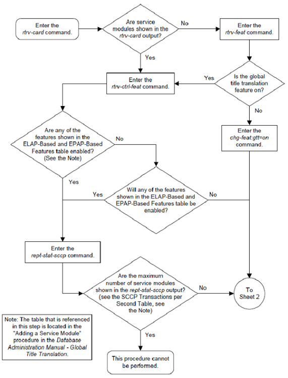

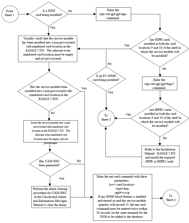

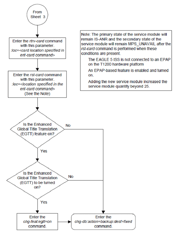

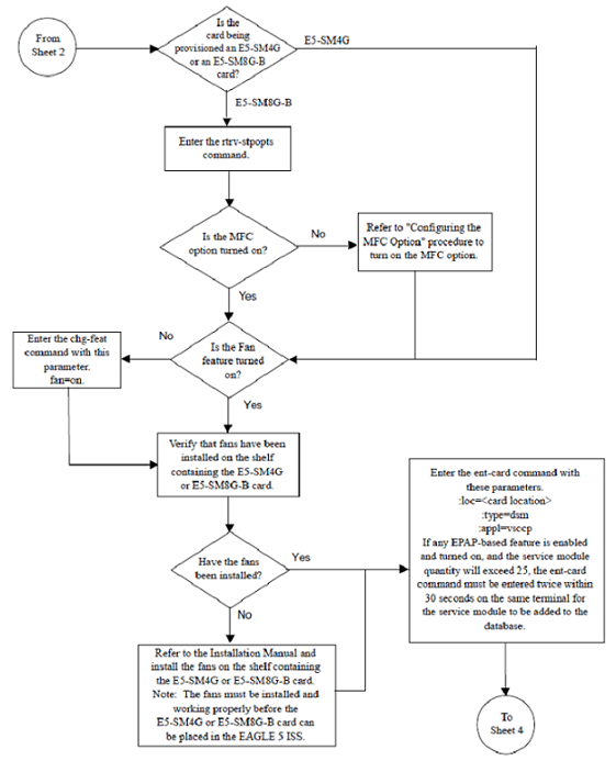

Adding a Service Module
This procedure is used to add a service module to support the Global Title Translation or Enhanced Global Title Translation feature to the database using the ent-card command.
A service module can be one of these cards.
  • E5-SM8G-B
  • SLIC
The card that is used as a service module depends on the GTT related features that are being used and the features that will enabled after this procedure is performed. The features or feature Table 4-5 combinations shown in show the type of card that must be installed in the EAGLE to meet the minimum EAGLE performance requirements. The features that are currently being used by the EAGLE are shown in the rtrv-feat or rtrv-ctrl-feat command outputs.
Table 4-5 Service Module and Feature Combinations
Card Features
E5-SM8G
SLIC
Any of these features:
  • Throughput Capacity - SMs can be used if this feature is enabled, but to achieve the maximum transactions per second for the EAGLE, shown in Table 4-9, all service modules must be E5-SM8G cards.
  • Support for 16 GTT Lengths in VGTT
  • Flexible Linkset Optional Based Routing
  • ELAP configuration feature and a LNP Telephone Number Quantity of 240 million numbers to 384 million numbers
  • GTT Action - DUPLICATE
  • Pre-LNP Query Service GTT Processing
  • Fall-Back to GTT after LNP Message Relay Service
  • ANSI-41 Analyzed Information Query (ANSI41 AIQ)
  • GTT Action - DISCARD
  • GTT Action - FORWARD
  • Info Analyzed Relay Base
  • Service Portability
  • Enhanced GSM MAP Screening
  • G-FLEX
  • V-FLEX
  • G-Port
  • INP
  • Prepaid SMS Intercept Phase 1 (PPSMS)
  • ELAP Configuration feature and an LNP Telephone Number Quantity that is less than 240 million numbers. Refer to Administration and LNP Feature Activation Guide for ELAP for the minimum requirements for service modules used with the LNP feature.
  • XGTT Table Expansion for 1,000,000 GTT entries
  • Equipment Identity Register(EIR)
  • Flexible GTT Load Sharing
  • IDP Screening for Prepaid
  • Prepaid IDP Query Relay
  • Origin-Based SCCP Routing
  • Hex Digit Support for GTT
  • A-Port)
  • IS41 GSM Migration
  • Weighted GTT Load Sharing
  • Transaction-Based GTT Load Sharing
  • ANSI-41 INP Query
  • MO SMS B-Party Routing
  • MO-based GSM SMS NP
  • MO-based IS41 SMS NP
  • MO SMS IS41-to-GSM Migration
  • MO SMS ASD
  • MO SMS GRN
  • Portability Check for MO SMS
  • TIF Number Portability
  • TIF SCS Forwarding
  • TIF Simple Number Substitution
  • TIF ASD
  • TIF GRN
  • ATI Number Portability Query (ATINP)
  • GSM MAP Screening
or
GTT and EGTT (if the Enhanced Global Title Translation feature is on) in combination with at least 2 of these features:
  • Variable-Length Global Title Translation (VGTT)
  • Advanced GT Modification (with or without the ANSI/ITU SCCP Conversion feature)
  • IGTTLS
  • XGTT Table Expansion enabled for 400,000GTT entries
  • XMAP Table Expansion enabled for either 3000 or 2000MAP table entries
The E5-SM8G-B can be inserted only in the odd numbered card slots of the control or the extension shelf. Slots 09 and 10 of each shelf contains the HIPR2 card, thus the E5-SM8G-B cannot be inserted in slot 09 and 10. The E5-SM8G-B can be inserted in the control shelf, but only in slots 01, 03, 05, 07 and 11. The E5-SM8G-B occupies two card slots, so the even numbered card slot adjacent to the odd numbered slot where the E5-SM8G-B has been inserted must be empty, as shown in Table 4-6. The E5-SM8G-B is connected to the network through the odd numbered card slot connector. The E5-SM8G-B requires two HIPR2 cards in the shelf where it is installed.
The SLIC can be inserted only in the odd numbered card slots if it is provisioned with the type=dsm parameter of the ent-card command. The SLIC can be inserted in odd or even numbered card slots if it is provisioned with the type=slic parameter of the ent-card command.
Table 4-6 Card Locations
Location of the E5-SM8G-B Empty Card Location
Slot 11 Slot 12
Slot 13 Slot 14
Slot 15 Slot 16
Slot 17 Slot 18
The ent-card command uses these parameters:
:loc – The location of the card being added to the database.
:type – The type of card being added to the database. The value of this parameter is dsm or slic.
:appl – The application software that is assigned to the card. The value of this parameter is vsccp.
:data – The data type of the card when running the EPAP Data Split feature and the Dual ExAP Configuration feature. The value of this parameter is dn or imsi for the EPAP Data Split feature and ELAP, EPAP or GTT for the Dual ExAP Configuration feature.
The shelf to which the card is to be added must already be in the database. This can be verified with the rtrv-shlf command. If the shelf is not in the database, perform the "Adding a Shelf" procedure in Database Administration – System Management User's Guide.
The card cannot be added to the database if the specified card location already has a card assigned to it.
If you want to add an E5-SM8G-B or SLIC card as the service module, verify the temperature threshold settings for the appropriate card by performing the "Changing the High-Capacity Card Temperature Alarm Thresholds" procedure in Database Administration - SS7 User's Guide. The E5-SM8G-B card also requires a fan tray.
  1. Display the cards in the EAGLE using the rtrv-card command to verify that the card location for the new service module is not provisioned. This is an example of the possible output.
    Cards should be distributed throughout the EAGLE for proper power distribution. Refer to Installation Guide for the shelf power distribution.
    This is an example of the possible output:

    If service modules are shown in the rtrv-card output, shown by the entry VSCCP in the APPL column, continue the procedure with step 4.
    If service modules are not shown in the rtrv-card output, continue the procedure with step 2.
  2. Verify that the GTT feature is on by entering the rtrv-feat command. If the GTT feature is on, the GTT field should be set to on. For this example, the GTT feature is off.
    The rtrv-feat command output contains other fields that are not used by this procedure. To see all the fields displayed by the rtrv-feat command, refer to the rtrv-feat command description in Commands User's Guide.
    If the GTT feature is on, continue the procedure with step 4.
    If the GTT feature is off, continue the procedure with step 3.
  3. Turn the global title translation feature on by entering this command.
    chg-feat:gtt=on
    Once the Global Title Translation (GTT) feature is turned on with the chg-featcommand, it cannot be turned off.
    The GTT feature must be purchased before turning it on. If you are not sure whether you have purchased the GTT feature, contact your Sales Representative or Account Representative.
    When the chg-feat has successfully completed, this message should appear.
    rlghncxa03w 09-07-25 09:57:41 GMT EAGLE5 41.1.0
    CHG-FEAT: MASP A - COMPLTD
    Continue the procedure by performing one of these steps.
    • If a card is being added, continue the procedure with step 7.
    • If an E5-SM8G-B card is being added, continue the procedure with step 6.

Figure 4-1 Add a Service Module - Sheet 1 of 4
Figure 4-2 Add a Service Module - Sheet 2 of 4
Figure 4-3 Add a Service Module - Sheet 3 of 4
Figure 4-4 Add a Service Module - Sheet 4 of 4
