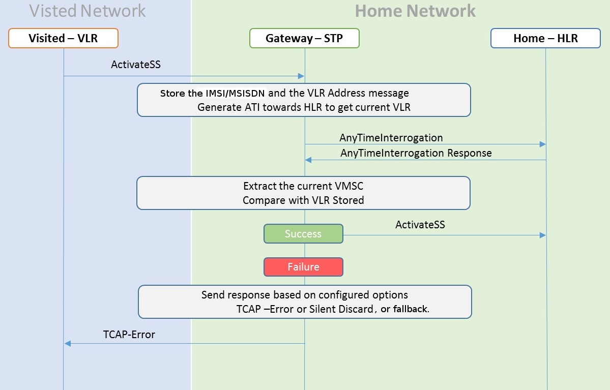

VLR Validation
As seen in the following figure, VLR Validation uses the information stored in the HLR about the current VLR to validate the VLR from which the message is received.
Figure 2-1 Call Flow for VLR Validation
img/stateful-apps-call-flow-vlr.jpg
  1. The incoming message will be decoded.
    1. An Error will be generated in case of decode failure.
  2. The message information will be stored in the local database.
  3. The Any Time Interrogation (ATI) request will be generated towards the HLR.
    1. The ATI Request will be coded so that Acknowledgment is received on the same SLIC card, as the DB is local.
  4. For a successful response from the HLR:
    1. The ATI Response will be decoded to get the current VLR address.
    2. The current VLR address will be compared with the CgPA stored in the local database for the subscriber.
    3. On a successful Match, the message will be routed as per the GTT result.
    4. In case of failure,
      1. Send the configured response.
      2. Increment the measurement for failed messages.

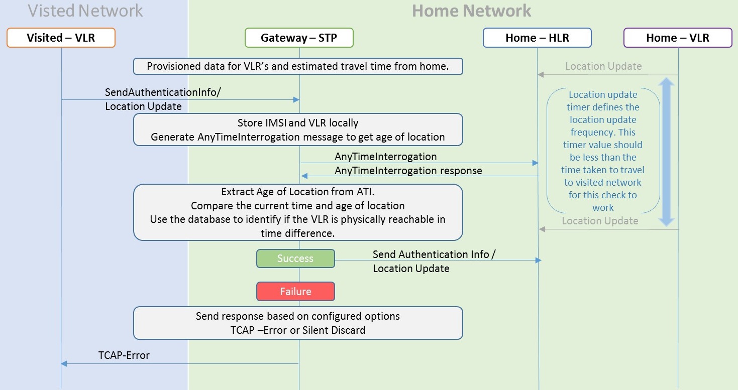

Velocity Check Using ATI
As seen in the following figure, Velocity Check using ATI uses the information stored in the HLR about the current VLR and the age of location parameter to identify if the new VLR is reachable from the current VLR stored in HLR.
This use case is dependent on the validity of the information stored in the VLR and the T3212 timer (periodic update location timer). This timer governs the rate at which the mobile subscriber autonomously updates their location. In case the time distance between two networks is less than the value of T3212 timer configured for the network, this use case test would provide false positives since the location age information would not have been properly updated in the VLR.
The assumption for successful execution of this use case are:
  1. The First location update can be identified using the IMSI only in the address.
  2. The Age of Location provided by HLR is accurate.
  3. The quantum of information (Age of Location) will not be less than the time to get travel.
The ATI-based check can be completed in a reasonable amount of time for Location Update to succeed.
Figure 2-2 Call Flow for Velocity Check Using ATI
img/stateful-apps-call-flow-velocity-check.jpg
  1. A local database on EAGLE will be configured to identify the network locations (using country codes for VLR addresses) and the shortest amount of time it may take to travel between them.
  2. The incoming message will be decoded:
    2. A Measurement will be pegged for the decode failure with OpCode and CgPA.
  3. The message information will be stored in the local database.
  4. The ATI request will be generated toward the HLR identified in the CdPA of the incoming message. The ATI request will be coded so that it is received on the same SLIC card, as DB is local.
  5. In case the HLR sends a failure in the ATI response:
    1. A measurement will be pegged to identify HLR error corresponding message from CgPA (VLR).
  6. For a success response, extract the Age of Location from the ATI Response message and the VMSC address in the HLR.
  7. In case the VLR, from which the SAI/LU was received, matches the VLR in the ATI response, don't do anything.
  8. In case the VLR addresses do not match:
    1. Calculate the time difference between the current time and the Age of Location.
    2. Verify the age of location is less than the travel time configured in the local Database.
    3. In case of time value not within limits:
      1. A measurement will be pegged.
      2. Response will be generated based on the configured option.

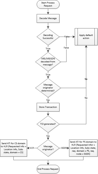

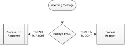

Figure 2-3 SFAPP Process Message
img/sfapp-process-msg.jpg
Figure 2-4 SFAPP Process Request
img/sfapp-process-request.jpg

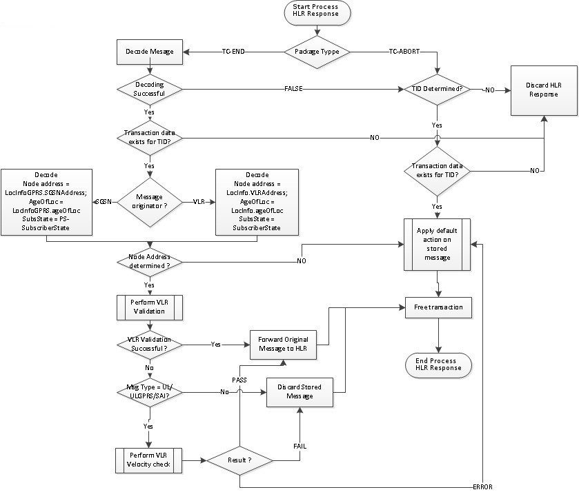

Figure 2-5 SFAPP Process HLR Response
img/sfapp-process-hlr-response.jpg

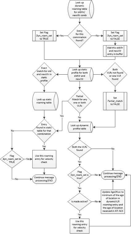

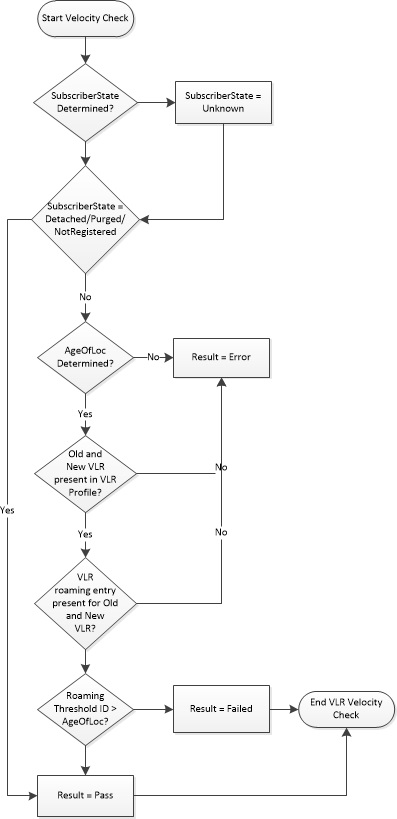

Figure 2-6 Perform VLR Velocity Check
img/sfapp-perform-vlr-velocity-check.jpg

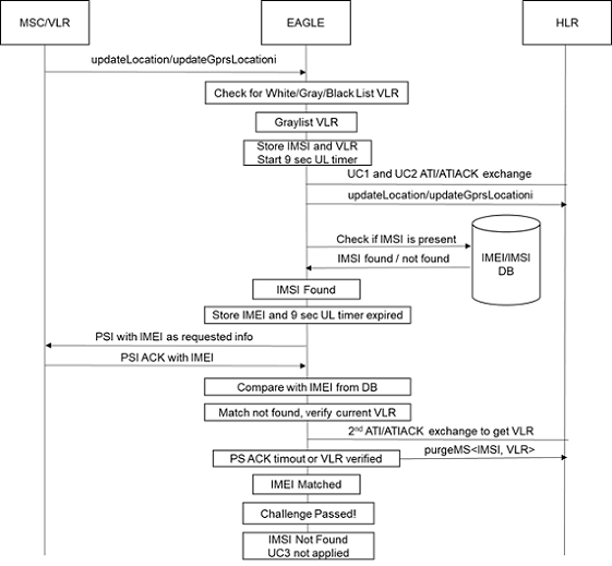

Graylisted VLR Validation Flow Chart
This use case challenges the visited VLR after the procedure for location update has been completed by asking for the subscriber’s IMEI information in a PSI message. After that, one of these actions is taken:
  1. The IMEI information can then be compared against an external database to validate the IMEI and consequently the VLR by either allowing the original procedure to complete or fail it by initiating in a Purge MS operation, or
  2. The IMEI information can be added to/updated in the external database if the VLR is trusted and the IMEI is validated.
Figure 2-7 shows the call flow.

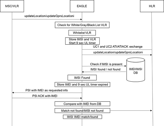

Figure 2-7 Graylisted VLR Challenge
img/graylisted-vlr-challenge.png
  1. Incoming UL message on the LIM card, either from the VLR or SGSN, is forwarded to the SCCP card by GT routing using GTT action for SFAPP. The SCCP card uses GTT based on SFAPP action to forward the message to the SFAPP card.
  2. UL message is decoded on the SFAPP card. An error is generated in case of decoding failure. Details of the decoding failure errors are described in Decoding Errors Generated EAGLE.
  3. The VLR address is checked to see if it is white/gray/blacklisted in the VLR database on the card. If graylisted, IMSI and the VLR address information is stored in a local data structure for further challenging the visited VLR with IMEI information for the mobile subscriber.
  4. After extracting the IMSI and VLR address, the UL message is forwarded to the CdPA(HLR).
  5. UL timer of 9 seconds timeout value is started to wait for update location procedure to complete on the mobile subscriber by the visited VLR to HLR. At the expiry of the UL timer, IMEI challenge begins.
  6. The IMEI information for the subscriber is retrieved from the EEDB, if present. If not found, use case 3 is terminated and no further action is taken.
  7. If found, the IMEI is stored and a PSI message is encoded by EAGLE with the IMSI and VLR from the original UL message and sent to the visited VLR. The SCCP portion of the PSI message is encoded to route on SSN SFAPP. CgPA from the original UL message is copied as the CdPA. CGPA is created from the psirescgmodid parameter of ent-gtmod command. TCAP layer of the PSI message is filled with the PSI opcode and IMSI tag/length/value, and requested information in the component portion is updated with IMEI tag/length fields. Transaction ID for an outgoing PSI message is encoded as described in Routing of PSI Response Back to Originating SFAPP Card.
  8. Encoded PSI message is routed on SSN SFAPP to the SCCP card and is further GTT routed on to the visited VLR by the LIM card. A transaction timer of 4 seconds timeout (with a unique transaction_id) is started to track the PSI message sent. If the timer expires, the challenge is considered to have failed and a purgeMS is generated as described in 13.
  9. When a PSI ACK arrives at EAGLE, upon arrival of the MSU at the SCCP card, if the mate_id in the TCAP transaction ID matches with the stored STP_ID of EAGLE, PSI ACK is sent to the SFAPP card. The details of the implementation of this functionality on the SCCP card is discussed in Routing of PSI Response Back to Originating SFAPP Card.
  10. FAILACTID is enforced on the SFAPP card for the IMEI challenge just like in the case of velocity check challenge. If the IMEI decoded from the PSI_ACK does not match the IMEI retrieved from the EEDB and the VLR is graylisted, the provisioned FAILACTID is enforced.
    1. If the FAILACTID is FALLBACK, then the PSI_ACK is not decoded (for example, no further data is decoded from the PSI_ACK) and the IMSI is not marked with an ms_purged_flag in HLR.
    2. If the FAILACTID is DISCARD, then it is used to send a purgeMS message to the HLR for a given IMSI.
  11. If the FAILACTID is not provisioned by the customer, every PSI_ACK message is decoded at the SFAPP card by matching TID (transaction_index) in the TCAP information with the appropriate PSI_ACK_TID and looking for PSI map_opcode to look for the IMEI tag in the ACK message. If the IMEI tag is present and the value matches with what was retrieved from the EEDB, the IMEI challenge is considered as passed. An absent IMEI tag in the PSI_ACK is considered a failure.
  12. An IMEI challenge failure results in generating another ATI to the HLR (as in use case 2) to verify the subscriber’s current VLR. Upon receiving the ATI ACK or a timeout, a purgeMS is sent by EAGLE to the HLR. The encoding of the purgeMS message is as follows:
    1. HLR address (CdPA - used at SCCP layer) is obtained by the saved copy of the UL message in the local data structure.
    2. CgPA is the EAGLE self PC.
    3. The SCCP portion of the PSI message is encoded to route on SSN SFAPP.
    If the timer for the ATI ACK expires, no UIM displays indicating the expiration.
  13. If the challenge has failed, the SFAPP categorizes the VLR as an intruder and generates a purgeMS message to the HLR for the subscriber from the original UL. The purgeMS incorporates the IMSI tag/length/value. The important piece in the TCAP layer component portion is msPurgingContext 5 bytes value which is as follows: 0x02-operation tag 0x01-length, 0x43-purge MAP opcode 0xa3-sequence tag, 0x00-length. There is no requested information built into the purgeMS message at the TCAP layer. EAGLE does not expect and process response from HLR for purgeMS. Hence, the transaction ID at the TCAP has 4 bytes OTID as 'ff ff ff ff' to indicate an INVALID TID.
  14. HLR marks the mobile subscriber as MS_purged_flag so that any request for routing information for a mobile-terminated call or mobile-terminated short message is treated as if the MS were not reachable.

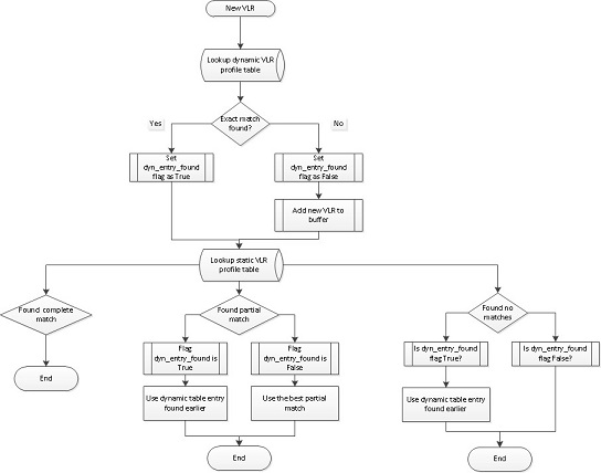

When a new VLR in the incoming network message is received on a secondary SFAPP card, the VLR is first searched in the dynamic VLR profile table. If exact match is found, a control flag - for example, dynamic_entry_found - is set and a subsequent static VLR profile table search is applied. If an exact match is NOT found, the new VLR is added to a buffer, but the static VLR profile table search is still applied. In static table search, there can be three cases:
  • Complete match found: If complete match is found, nothing needs to be done.
  • Partial match found: If partial match is found, use the best matching partial static VLR profile entry.
  • No matches found: If no matches are found for new VLR in static VLR profile table, check the value of dynamic_entry_found flag.
If the flag is set, use matching dynamic VLR profile entry for VLR validation. Otherwise, nothing needs to be done. A secondary SFAPP card keeps populating said buffer with such new VLRs either until the end of 500ms tick or when buffer has 48 VLRs in it, whichever occurs first. When either of these two conditions are met, secondary SFAPP cards send their buffer to the primary SFAPP card.
A secondary SFAPP card only makes one buffer worth up to 48 VLRs in one 500ms cycle. But since there could be n number of secondaries in EAGLE, the primary SFAPP card receives n number of new VLR buffers in one 500ms cycle.

VLR Velocity Check Flow
Secondary SFAPP Cards
Figure 2-10 shows the VLR velocity check flow.
Figure 2-10 VLR Velocity Check
img/vlr-velocity-check.png
The dynamic VLR roaming table is used on these occasions:
  • When both new VLR and old VLR are found in the dynamic VLR profile table.
    In this case, we look up the dynamic VLR roaming table with the dynamic VLR profile table indices of new VLR and old VLR to get threshold and subscriber state. If the threshold value is less than or equal to the age of location found in the ATI ACK, then VLR validation is considered successful.
  • When one VLR is found in the dynamic VLR profile table and the other VLR is found in the static VLR profile table.
    In this case, the VLR entry found in the static VLR profile table is duplicated into the dynamic VLR profile table on that SFAPP card. This is done so as to obtain both new and old VLR indices from the same profile table.
    For example, say new VLR is found in the dynamic profile table, but the old VLR is found in the static profile table. We replicate the old VLR entry from the static profile table into the dynamic profile table and get the indices of both the new VLR entry and the newly-created old VLR entry from the dynamic profile table. With these indices, the search is performed in the dynamic VLR roaming table to get the threshold, subscriber state, and last activity time.
If the same combination of old VLR and new VLR is observed again in another VLR validation and the value of age of location is the same as that in the dynamic VLR roaming entry, age of location value in roaming entry is not updated.
If the same combination of old VLR and new VLR is observed again in another VLR validation and the value of age of location is different than that in the dynamic VLR roaming entry, age of location value in roaming entry is updated to a minimum of the age of location in dynamic VLR roaming entry and the age of location received in ATI ACK. Here, we take the minimum of both age of locations since we assume the ATI ACK is always coming from the True VLR since ATI and ATI ACK are internal messages for the SS7 network.
For example, say combination of old VLR=123 and new VLR=456 is searched into the dynamic VLR roaming table. A matching entry is found in the table and the age of location entered as 10 hours. But, the value of age of location in the ATI ACK is 8 hours. Then, we update the age of location of the existing dynamic VLR roaming entry to 8 hours using the following formula.
