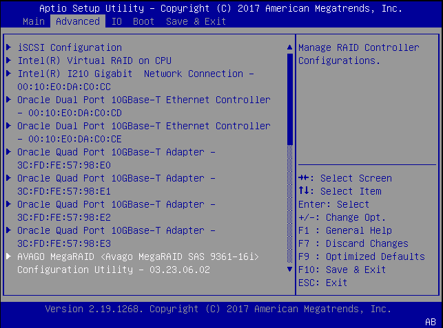

Figure 1-6 Selecting RAID Configuration

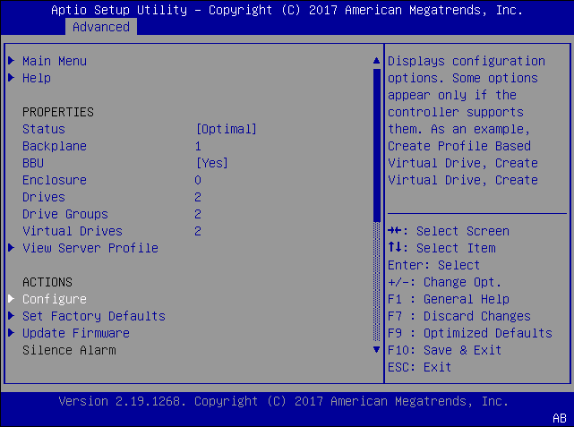

- Navigate the utility to
establish your virtual drive's operation, initially including the
Configure action.
Figure 1-7 Begin RAID Configuration

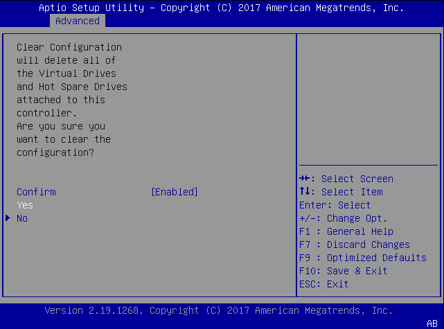

- Clear the configuration,
regardless of the initial state.
Figure 1-8 Clear Any Existing RAID Configuration

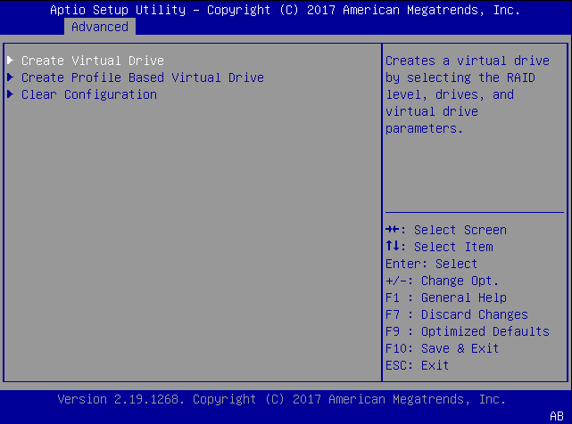

- Access the menu from which you
create a virtual drive.
Figure 1-9 RAID - Create Virtual Drive

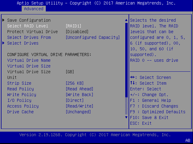

- Set the RAID level to RAID-1.
Figure 1-10 Set Drive to RAID1

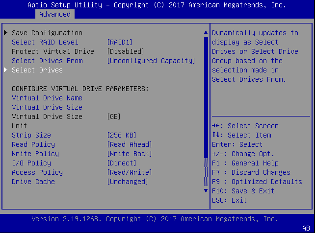

- Select your drives.
Figure 1-11 RAID - Select Drives

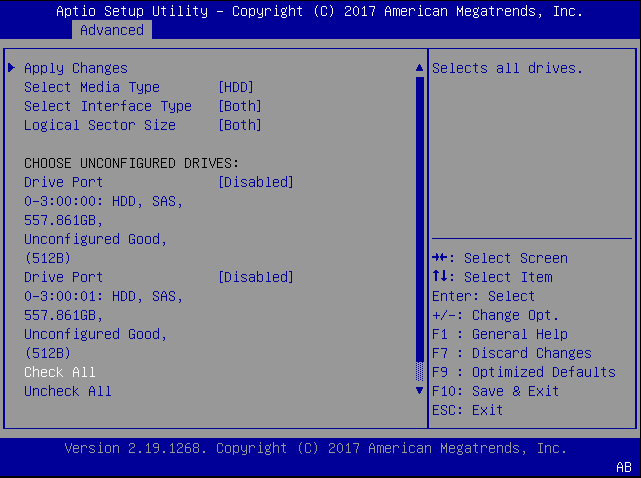

- It is common to select all
drives at this point.
Figure 1-12 Select All Drives

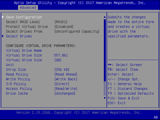

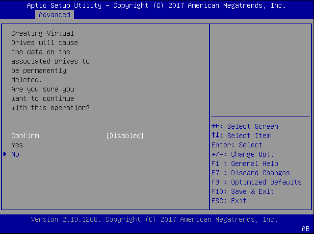

- Save the RAID configuration.
Figure 1-13 Save RAID Configuration
- The system allows you to
Confirm your configuration and continue with initialization.
Figure 1-14 Initialize RAID Configuration

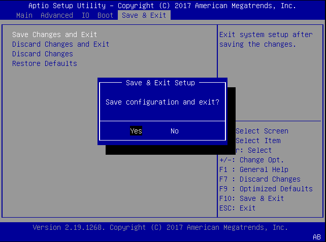

- After the initialization
completes, return to the Main Menu to Save and Exit.
Figure 1-15 Exit RAID Configuration
