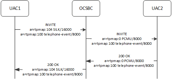

In this first example, you set the allow-diff2833-clock-rate-mode parameter on the ingress interface to use-2833-clock-rate. The diagram below shows the Enterprise SBC accepting a different clock rate for the SILK codec and the tel-event from UAC1. This interface is ingress to UAC1. The Enterprise SBC presents PCMU, and telephone-event with a clock rate of 8000. The Enterprise SBC maintains the original offer and presents the 200OK to UAC1 using the clock rates it offered.
Supporting different clock rates for SILK and Tel-events

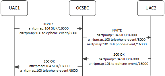

In this next example call flow, the diagram shows the Enterprise SBC using the same allow-diff2833-clock-rate-mode configuration as the example above, allowing it to accept a different clock rate for the opus codec and the telephone-event from UAC1. Again, the Enterprise SBC presents PCMU, and telephone-event with a clock rate of 8000. The Enterprise SBC maintains the original offer and presents the 200OK to UAC1 using the clock rates it offered.
Supporting different clock rates for OPUS and Tel-events
In this next example call flow, the diagram presents the Enterprise SBC handling differing telephone-event and codec clock rates without transcoding. Notice that the "top" codec in A0 and O1 are the same. Without enabling features such as dtmf-in-audio detection or RTCP generation, which you could expect would force a transcoded call, the system treats the call as passthrough, even though the telephone-event clock rate differs on ingress and egress. This is because the audio codecs negotiated between ingress and egress are the same. Nevertheless, the Enterprise SBC maintains the differing telephone-event clock rates and supports the flow.
Supporting different clock rates without transcoding.
