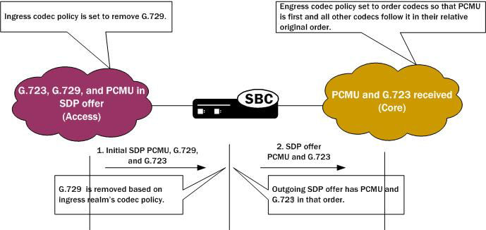

  • Order—List of the codecs where you specify their preferred order in the outgoing media offer. The Enterprise SBC arranges matching codecs according to the rule you set, and any remaining codecs are added to the list in the same relative order as in the incoming media offer. When your list specifies a codec that is not present, the ordering proceeds as specified but skips the missing codec.
    You can use an asterisk (*) as a wildcard in this list, too. The placement of the asterisk is important, as shown in the following examples:
    • For an order rule set this way
      ORACLE(codec-policy)# order (A B C *)
      codecs A, B, and C will be placed at the front of the codec list in the order specified. All other codecs in the offer will follow A, B, and C in the same relative order as in the original SDP offer.
    • For an order rule set this way:
      ORACLE(codec-policy)# order (* A B C)
      codecs A, B, and C will be placed at the end of the codec list in the order specified. All other codecs in the offer will come before A, B, and C in the same relative order as in the original SDP offer.
      ORACLE(codec-policy)# order (A * B C)
      codec A will be placed at the beginning of the codec list, followed by all other codecs in the offer in the same relative order as in the original SDP offer. B and C will end the list.

    The following example shows a codec policy configuration:
    codec-policy
            name            private
            allow-codecs    g723:no pcmu video:no
            order-codecs    pcmu *
