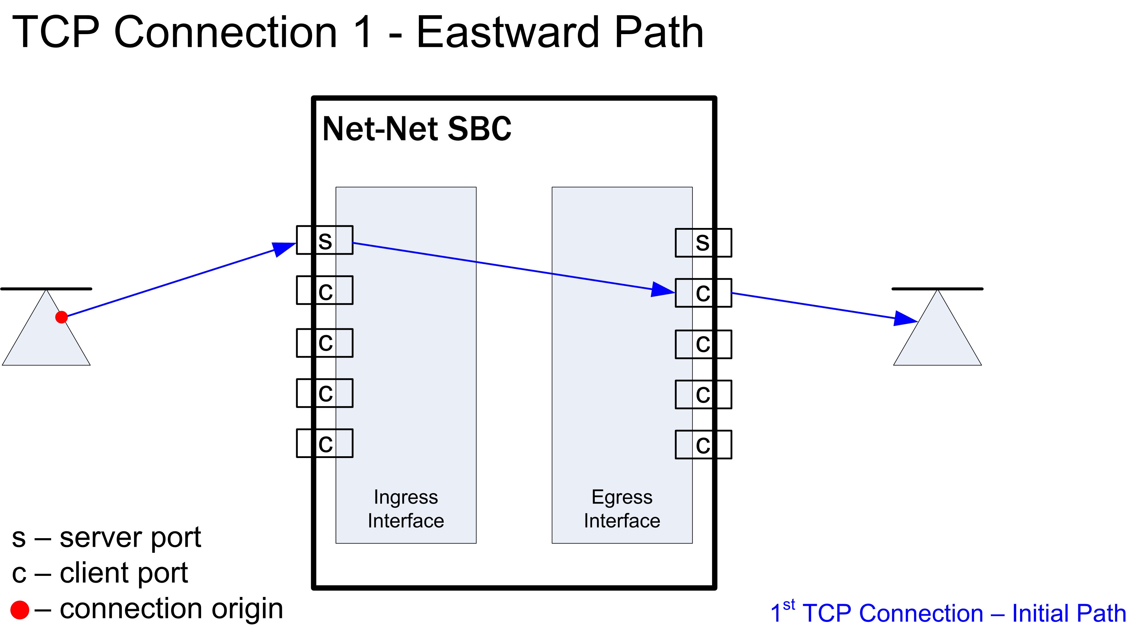

The server port is used for initiating a new TCP connection. An endpoint sends the first packet to a server port on the ingress interface. The packet is forwarded out of the Oracle Enterprise Session Border Controller through a client port on the egress interface toward an endpoint:
This image shows an eastward TCP flow through the SBC.

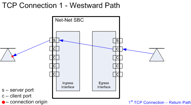

The endpoint responds back to the client port on the egress interface. This message traverses the Oracle Enterprise Session Border Controller and is forwarded out of the server port on the ingress interface where the initial packet was sent. The remainder of the TCP flow uses the server and client port pair as a tunnel through the Oracle Enterprise Session Border Controller:
This image shows an westward TCP flow through the SBC.

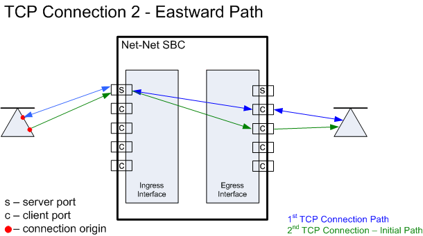

When the second TCP connection is set up in the same direction as in the first example, the first packet is still received on the server port of the ingress interface. The next unused client port is chosen for the packet to exit the Oracle Enterprise Session Border Controller:
This image shows a second eastward TCP flow, while a first TCP flow is established, through the SBC.

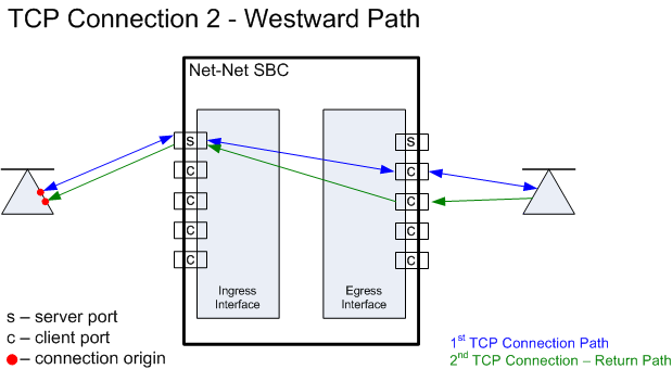

The response takes the same path back to the caller. The remainder of the second TCP connection uses this established path:
This image shows a second westward TCP flow, while a first TCP flow is established, through the SBC

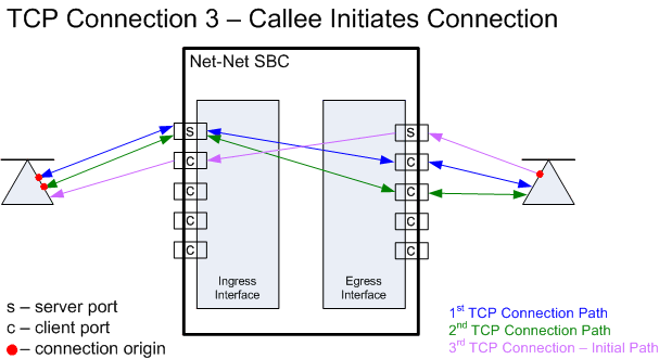

When the callee initiates a TCP connection, it must send its initial traffic to the server port on its Oracle Enterprise Session Border Controller ingress interface. The packet is forwarded out of the first free client port on the egress side of this TCP connection toward the caller.
This image shows a callee's initial TCP flow after two additional flows are established.

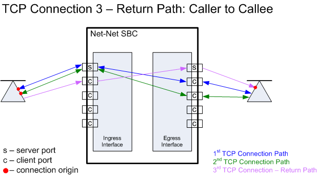

The caller’s response takes the same path back to the callee that initiated this TCP connection. The remainder of the third TCP connection uses this established path.
This image shows a caller's initial TCP flow after two additional flows are established.

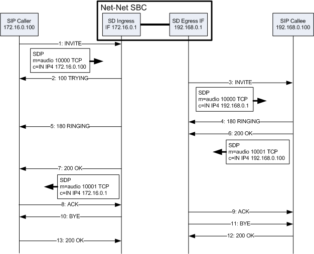

SDP Offer Example
The following abbreviated call flow diagram sets up a media-over-TCP flow. Observe that the caller listens for audio over TCP on 172.16.0.10:10000, as described in the SDP offer (1). The Oracle Enterprise Session Border Controller re-writes the m and c lines in the SDP offer to reflect that it is listening for audio over TCP on its egress interface at 192.168.0.1:10000 (3). The Oracle Enterprise Session Border Controller then forwards the SIP invite to the callee.
The SIP callee responds with an SDP answer in a 200 OK message. The callee indicates it is listening for the audio over TCP media on 192.168.0.10:10001 (6). The Oracle Enterprise Session Border Controller re-writes the m and c lines in the SDP answer to reflect that it is listening for audio over TCP on the call's ingress interface at 172.16.0.1:10001 (7). The Oracle Enterprise Session Border Controller then forwards the SIP invite to the caller.
The SDP Offer example image is described above.
All interfaces involved with the end-to-end TCP flow have now established their listening IP address and port pairs.

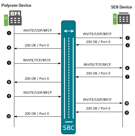

The following illustrates the call flow between a Polycom device and a SEN device when an INVITE is sent from the Polycom device.
The Polycom SEN Device call flow is described below.
The following list describes the call flow process.
  1. Polycom device initiates a call to the SEN device by sending a SIP INVITE to the Enterprise SBC with SDP, using UDP and BFCP.
  2. Enterprise SBC forwards the SIP INVITE to the SEN device.
  3. SEN device does not support BFCP, and therefore, rejects the INVITE and sends a 200 OK with port '0' from the SEN side to the Enterprise SBC.
  4. Enterprise SBC forwards the 200 OK response to the Polycom device.
  5. Polycom device looks at port ‘0’ and changes the media transport type from UDP to TCP. It then sends a re-INVITE to the Enterprise SBC.
  6. Enterprise SBC forwards the re-INVITE to the SEN device.
  7. SEN device does not support BFCP, and therefore, rejects the re-INVITE, and sends a 200 OK with port ‘0’ from the SEN side to the Enterprise SBC.
  8. Enterprise SBC forwards the 200 OK response to the Polycom device.
  9. Polycom device looks at port ‘0’ and changes the media transport type from TCP to UDP. It then sends a re-INVITE to the Enterprise SBC.
  10. Enterprise SBC forwards the re-INVITE to the SEN device.
  11. SEN device does not support BFCP, and therefore, rejects the re-INVITE, and sends a 200 OK with port ‘0’ from the SEN side to the Enterprise SBC.
  12. Enterprise SBC forwards the 200 OK response to the Polycom device.
  13. Process repeats Steps 5 through 12 until the call is accepted by the SEN device.
