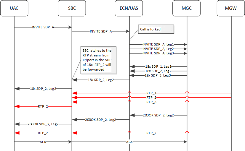

In the call flow below, you have configured restricted-latching to sdp-ip-port on the UAS realm. The called stations could be behind the Media Gateway (MGW) interfacing the PSTN/PLMN) or multiple IP’s, and served by a Media Gateway Controller (MGC).
The SBC latches to the RTP stream from IP/port in the SDP of 18x before the call is answered.

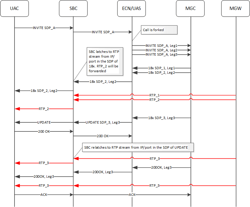

Parallel Ringing and Re-Latching before Answer Based on an UPDATE
If an UPDATE comes from the ECN before the call is answered, the Enterprise SBC is able to re-latch to a new RTP stream, as shown below. In the call flow, the Enterprise SBC latches to SDP_2, forwarding only that RTP. The MGC, however, issues a 18x requesting SDP_3 before the call is answered. Upon receiving this UPDATE, the Enterprise SBC re-latches to SDP_3. Subsequently, the call is answered and RTP_3 media proceeds without issue.
The SBC re-latching to a new RTP stream using the IP/port in the SDP of an UPDATE before the call is answered.
