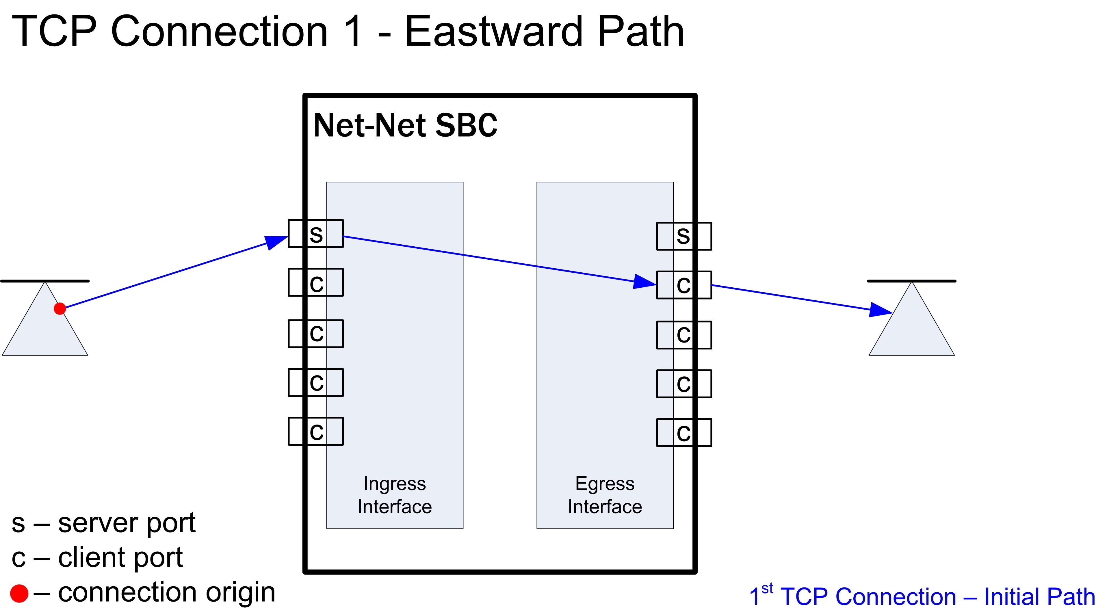

The server port is used for initiating a new TCP connection. An endpoint sends the first packet to a server port on the ingress interface. The packet is forwarded out of the Oracle® Enterprise Session Border Controller through a client port on the egress interface toward an endpoint:
This image shows an eastward TCP flow through the SBC.

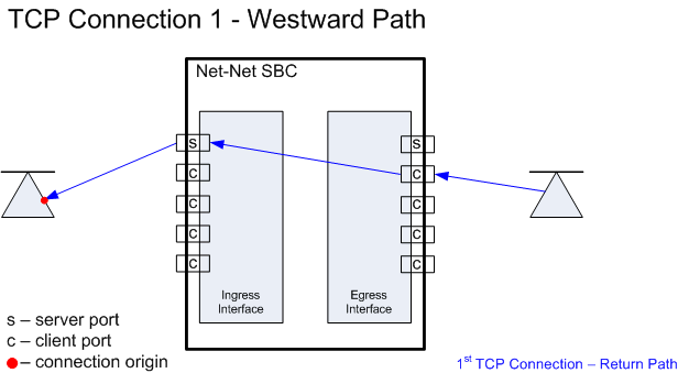

The endpoint responds back to the client port on the egress interface. This message traverses the Oracle® Enterprise Session Border Controller and is forwarded out of the server port on the ingress interface where the initial packet was sent. The remainder of the TCP flow uses the server and client port pair as a tunnel through the Oracle® Enterprise Session Border Controller:
This image shows an westward TCP flow through the SBC.

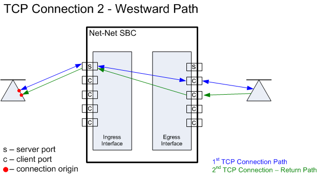

The response takes the same path back to the caller. The remainder of the second TCP connection uses this established path:
This image shows a second westward TCP flow, while a first TCP flow is established, through the SBC

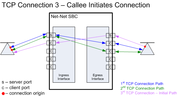

When the callee initiates a TCP connection, it must send its initial traffic to the server port on its Oracle® Enterprise Session Border Controller ingress interface. The packet is forwarded out of the first free client port on the egress side of this TCP connection toward the caller.
This image shows a callee's initial TCP flow after two additional flows are established.

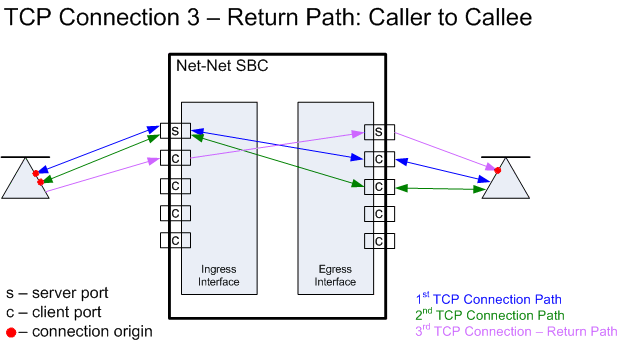

The caller’s response takes the same path back to the callee that initiated this TCP connection. The remainder of the third TCP connection uses this established path.
This image shows a caller's initial TCP flow after two additional flows are established.

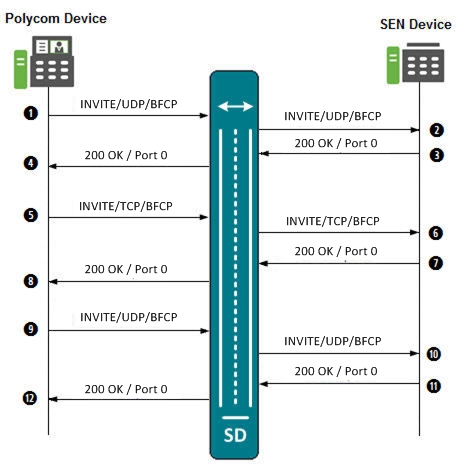

Transparent BFCP Support over UDP and TCP
Binary Floor Control Protocol (BFCP) is a protocol for controlling the access to the media resources in a conference, such as conference and media session setup, conference policy manipulation, and media control (as defined in RFC 4582).
The Enterprise SBC does not support using both BFCP and a codec policy. When a codec policy is applied, the Enterprise SBC sets the BFCP and ixmedia ports to zero.
The Enterprise SBC supports BFCP for interworking between Polycom video devices and Siemens Enterprise Communications (SEN) endpoints. When a SIP INVITE request containing a Session Description Protocol (SDP) from a Polycom device is sent to a SEN device, the Enterprise SBC passes the INVITE request between the two devices regardless of the transfer protocol being used by the devices (UDP or TCP). It also passes the INVITE whether or not it is accepted or rejected by the destination device. The transfer protocol changes between UDP and TCP during the dialog between both endpoints on either side of the Enterprise SBC.
If both endpoints on either side of the Enterprise SBC support BFCP, the BFCP is answered with the first SDP offer/answer cycle.
The following illustrates the call flow between a Polycom device and a SEN device when an INVITE is sent from the Polycom device.
The Polycom SEN Device call flow is described below.
The following list describes the call flow process.
  1. Polycom device initiates a call to the SEN device by sending a SIP INVITE to the Enterprise SBC with SDP, using UDP and BFCP.
  2. Enterprise SBC forwards the SIP INVITE to the SEN device.
  3. SEN device does not support BFCP, and therefore, rejects the INVITE and sends a 200 OK with port '0' from the SEN side to the Enterprise SBC.
  4. Enterprise SBC forwards the 200 OK response to the Polycom device.
  5. Polycom device looks at port ‘0’ and changes the media transport type from UDP to TCP. It then sends a re-INVITE to the Enterprise SBC.
  6. Enterprise SBC forwards the re-INVITE to the SEN device.
  7. SEN device does not support BFCP, and therefore, rejects the re-INVITE, and sends a 200 OK with port ‘0’ from the SEN side to the Enterprise SBC.
  8. Enterprise SBC forwards the 200 OK response to the Polycom device.
  9. Polycom device looks at port ‘0’ and changes the media transport type from TCP to UDP. It then sends a re-INVITE to the Enterprise SBC.
  10. Enterprise SBC forwards the re-INVITE to the SEN device.
  11. SEN device does not support BFCP, and therefore, rejects the re-INVITE, and sends a 200 OK with port ‘0’ from the SEN side to the Enterprise SBC.
  12. Enterprise SBC forwards the 200 OK response to the Polycom device.
  13. Process repeats Steps 5 through 12 until the call is accepted by the SEN device.
