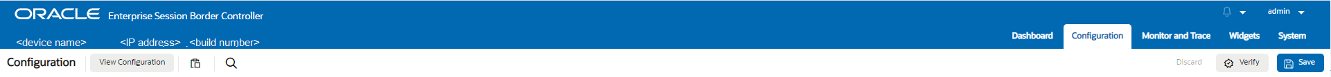

The Configuration tab displays configuration objects in the navigation pane organized much like they are on the ACLI command line. When you click a top-level object in the navigation pane, the center pane displays the sub-objects in alphabetical order. You can also click the twister by the high-level object in the navigation pane to display an alphabetical list of the sub-objects in the navigation pane. The Configuration tab header displays the system identification at the left end of the banner and the Notifications alarm and the User menu at the right end of the banner. Below the banner, the page displays the controls for View Configuration, Search, Discard, Verify, and Save.
Configuration Tab Controls
The Configuration tab displays controls to help you find, review, and work with the configurations that you set on the Oracle® Enterprise Session Border Controller.
Device Name—IP Address—Build Number—Use to identify the system and the software version. When you deploy your SBC in a High Availability (HA) pair, the system identification also states whether the device is the Active or Standby peer.
View Configuration—Use to see the configuration Inventory, Editing Configuration Short, Running Configuration Short, Configuration Version, and Realm Specifics.
Paste—Use to paste a configuration that you want to duplicate into a dialog where you can make edits, if you want, and save the configuration.
Search—Use to find and display configuration objects to edit. The first time you place the cursor in the search field, the Web GUI displays a drop-down list of all the configuration objects in alphabetical order. You can refine your search by entering a parameter, an attribute, a value, or an object. When you use Search and switch to another tab, the system retains the search criteria when you return to the Configuration tab.
Discard—Use to undo all configuration changes made in the current session. The system can only discard the changes that you saved. It cannot discard any changes that you activated.
Verify—Use to validate the configuration is valid before saving.
Save—Use to save the current configuration session. Upon Save, the system displays a prompt with a choice of whether or not to activate the configuration. If you do not activate the configuration, you can continue to make changes and Save again. When finished, you can save and activate all of the configuration changes.

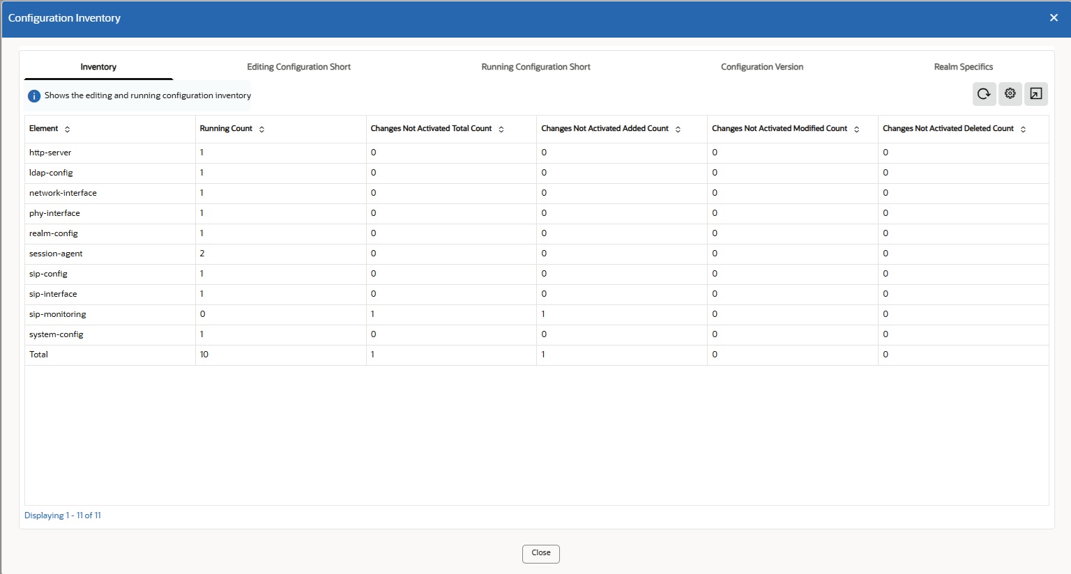

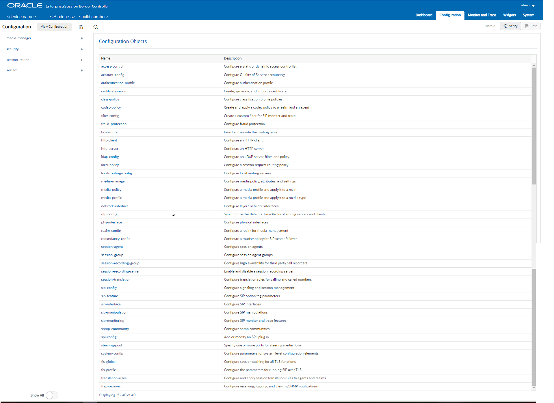

View the Enterprise SBC Configuration Inventory
When you want to see aggregated information about the state of the configuration on the Oracle® Enterprise Session Border Controller (Enterprise SBC), click View Configuration on the Configuration tab. The Web GUI displays the Configuration Inventory page by default with tabs for the other views.
The following screen capture shows the default landing page after you click View Configuration.
When you set the process level or system log level to DEBUG, the Web GUI may not display any configuration information for large configurations when you click "View Configuration".
View Configuration Tabs
Inventory—Shows the Element list, Running Count, Changes Not Activated Total Count, Changes Not Activated Added Total Count, Changes Not Activated Modified Count, and Changes Not Activated Deleted Count.
Editing Configuration Short—Shows only the modified attributes in the editing configuration.
Running Configuration Short—Shows only the modified attributes in the running configuration.
Configuration Version—Shows the configuration version number table, which shows both the Current Version and the Running Version.

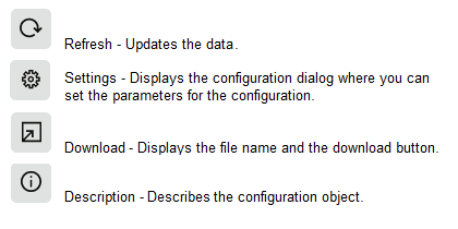

Controls
Each tab, except for Realm Specifics, displays a set of controls in the upper right corner. The following list includes all of the available controls, but note that the controls vary per tab.
Refresh—Use to manually refresh the data on the tab.
Settings—Use to set the Auto Refresh Interval and to enable the option to Show Only Differences.
Download—Use to download data to the Configuration Inventory.
Description—Use to see a description of the view.
ESR Configuration Inventory View
When you want to see aggregated information about the state of the configuration on the Oracle® Enterprise Session Border Controller, click View Configuration the Configuration tab. The Web GUI displays the Configuration Inventory page by default with tabs for the other views.
When you set the process level or system log level to DEBUG, the Web GUI may not display any configuration information for large configurations when you click View Configuration.
Realm Specifics—Allows you to set the Realm parameter and Auto Refresh interval.

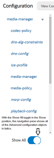

Show or Hide Advanced Configuration Objects in the Navigation Pane
Each category of configuration objects includes additional objects that are not required to complete a basic configuration. Such objects are called Advanced objects, which you use to customize your configuration. If you do not need to see the advanced objects, you can hide them from view with the Show All toggle located at the bottom of the navigation pane. The Show All toggle affects all categories of configuration objects. You can toggle between show and hide at anytime.
The following screen capture shows the navigation pane with the Show All toggle in the hide position. In this example, media-manager displays only five configuration objects because the Advanced configuration objects are hidden.
The following screen capture shows the navigation pane with the Show All toggle in the Show All position. The Web GUI displays the advanced elements in italics.

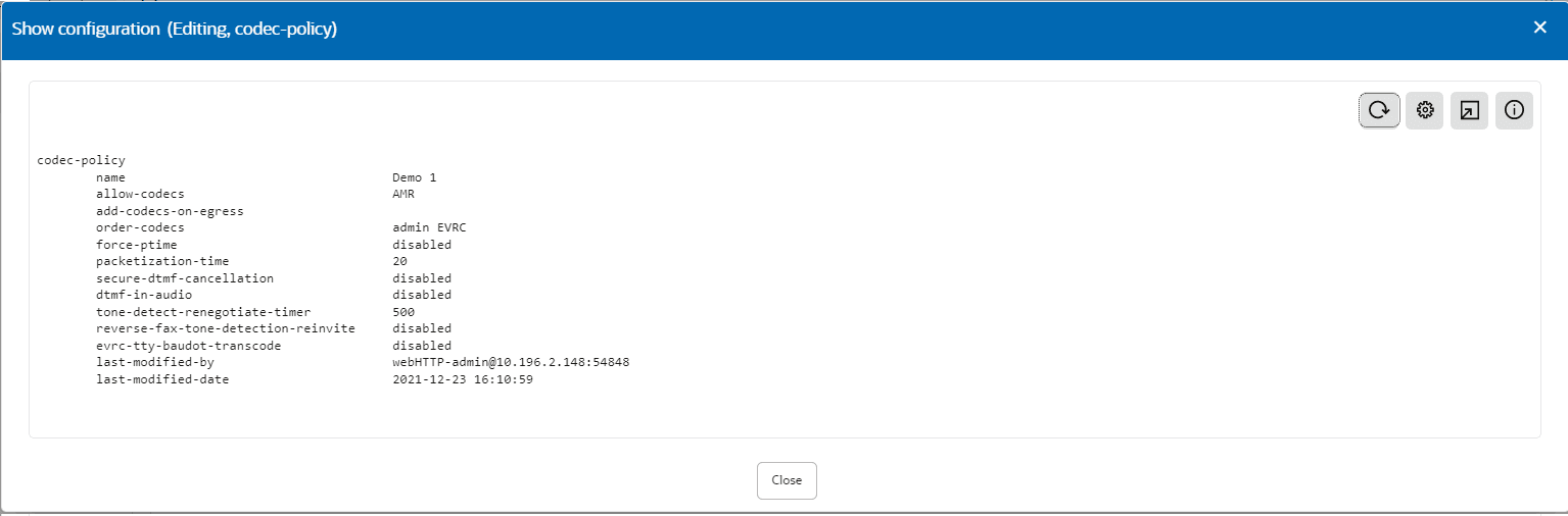

Show the Configured Parameters of a Configuration Object
After you add a new configuration or modify an existing one, you might want to view the settings to confirm your work before activation. Every configuration object includes the Show Configuration button in the title banner, which you can click to see the editing version of the configuration.
The following screen capture shows the Show
Configuration button, which is located at the right end
of the configuration object title banner.
The list shows only the parameters you edited.
Descriptions of the Show Configuration Controls
The Show Configuration page displays the following icons in the upper right corner that you can use to work with the configuration.

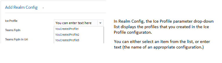

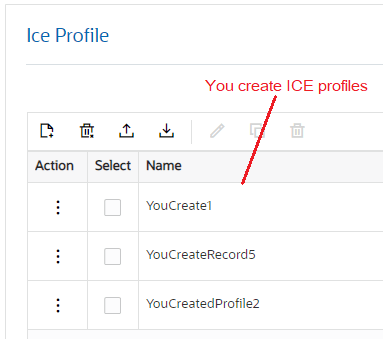

Drop-Down Lists
To make configuration easier, the Web GUI displays drop-down lists for selecting values for configuration parameters. Drop-down lists behave in the following ways:
System Populated—The system populates the list. You can only select an item that exists on the list and you cannot edit the list. For example, the system populates the list for the Strategy parameter in the Add Session Group configuration dialog.
User Populated—You can populate the list by configuring the objects in advance or by entering text in the field. For example, in the Add Realm configuration, the Ice Profile parameter can display a drop-down list of Ice Profiles. You create the list by configuring one or more profiles in the Ice Profile configuration.
In Realm Config, the system displays the name of each Ice profile that you created in the Ice Profile drop-down list. You can either select an entry from the list or enter the name of one that you plan to create.

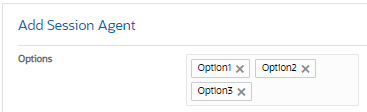

Some configuration parameters allow you to select multiple items from the drop-down list.Options Fields
Options fields require you to enter each option separately with a delimiter between options. Without delimiters the system considers all of the entries as one, which can lead to unpredictable behavior. The Options text box accepts commas, semi-colons, full stops, and parens as delimiters.
To add one option:Type the name of the option.
Click outside of the text box and the GUI sets the option in its own tab.
To add multiple options:
Type the name of each option, separated with either the comma, semi-colon, or space characters. The following example shows commas as the delimiters.
Click outside of the text box and the GUI sets each option as a separate tab.
If you have a list of options in a text document and they are delimited with a comma, semi-colon, full stop, or parens, you can copy the list into the Options field and the system will add each option as a separate tab as soon as you click outside of the tab.
To delete an Option, click the X on the tab.

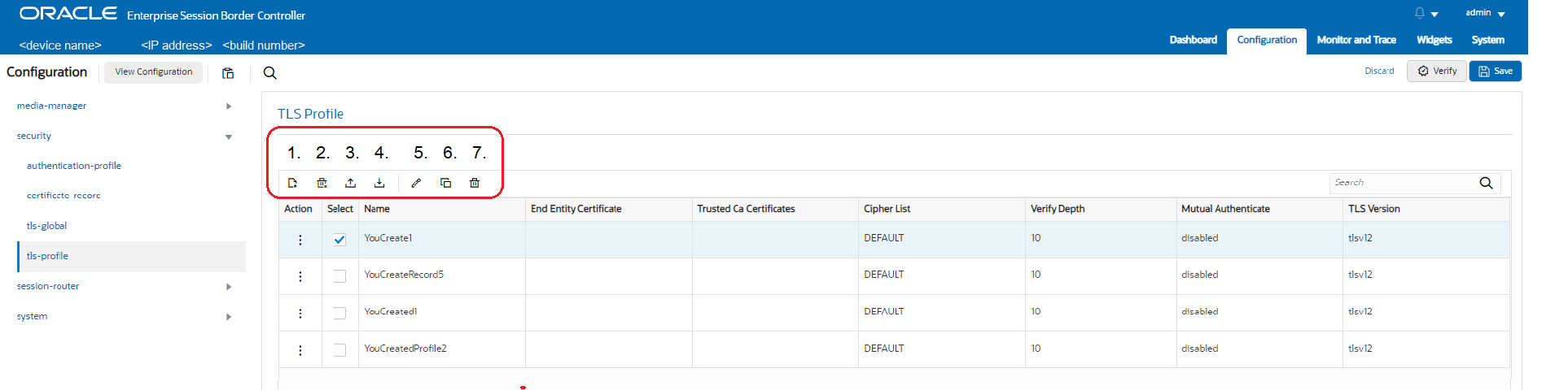

Controls for Managing Multi-instance Configurations
Some configuration objects allow you to create multiple instances of the configuration, which the system displays in a list on the configuration object landing page. You can manage multi-instance configuration objects with the buttons and controls displayed on the landing page and within the configuration dialog. Buttons display at the top of the dialog and controls display when you right-click elements of the configuration in the list.
Controls for Managing Configuration Lists
Web GUI configuration pages display controls for managing lists of multi-instance configurations. You can use certain controls to affect multiple instances, while others can affect only one instance at a time.
Global Controls
At the top of a multi-instance configuration list, the Web GUI displays the controls for managing the list. All the controls are active when you select a single row in the table. When you select multiple rows in a table, the system activates only the icons for supported actions. For example, when you select multiple rows, the Add, Delete, Upload, and Download icons remain activated. The system deactivates the Edit and Copy icons because those operations work on a single row, only.
1. Add—Click to add a configuration instance to the list.
2. Delete All—Click to delete all instances. You do not need to select the instances, just click the Delete All icon.
3. Upload—Click to upload one or more CSV configuration files to the configuration displayed.
4. Download—Click to download one or more configurations to a CSV file.
5. Edit—Click to edit the selected configuration.
6. Copy—Click to copy the selected configuration.
7. Delete—Click to delete the selected configuration.
When you Add, Edit, or Copy in a table, the table reloads and returns to the record you were on.Row Controls
You can also access the Edit, Copy, and Delete controls from a row in the list. Either click the ellipses or right-click the row. When you right-click, the menu also includes the sorting choices.

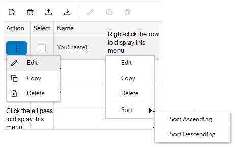

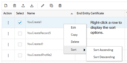

Controls for Ordering Table Rows in a Multi-Instance Configuration

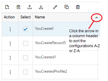

You can set the order of the configurations in most multi-instance configuration lists to display in either ascending or descending alphabetical order. The exception occurs in the Local Policy configuration, where you can manually set the rows in any order.
Set the Sort Order for All Lists Except Local Policy
Right-click the configuration, and the system displays the control menu that includes Sort. Click Sort, and click either Sort Ascending or Sort Descending.
You can also set the sort order by clicking the arrow in the column header.

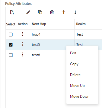

Set the Sort Order for the Local Policy Table
Right-click the row that you want to move, and the system displays the control menu that includes Move Up and Move Down.

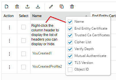

Controls for Showing and Hiding Column Headers
Each multi-instance configuration list supports a unique array of column headers and you can choose the ones that you want displayed and hidden. Right-click a column header to display the list of column headers that is available for the table displayed.
The same list displays regardless of which column you click.Configuration Error Messages
