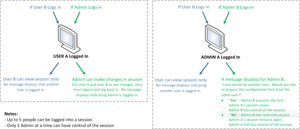

Simultaneous Logons
The Web GUI allows the User and Administrator to log on simultaneously. Session availability to the User and Admin depends on which type of user is logged on to the session. The following illustrations depict and explain the system behavior when a User and an Administrator log on to a Web GUI session.
This illustration and text explain system behavior when either user a or admin a is logged on and either user B or admin B also log on.
In the illustration where Admin A logged in first, the behavior is as described. If Admin B logs in first, then the system shows the lock message to Admin A. The first Admin to log in acquires the lock.
Up to five users can log onto the same session at the same IP address at the same time. Only one Administrator at a time can have full control of a simultaneous session.

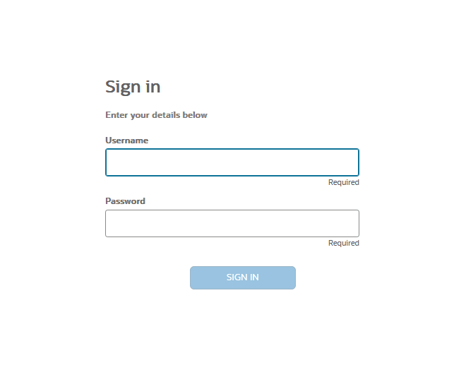

  3. In the Sign in dialog, enter your Enterprise SBC credentials, and click Sign in. The Login banner is displayed. For more information on the Sign in Banner, see Login Banner.
    Figure 2-1 Sign in
    This screen capture shows the Web GUI log on dialog

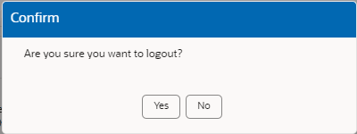

Log Off from the Web GUI
To log off from the Web GUI, open the User menu, and click Log Out.
  1. On the User menu located in the upper right corner of the Web GUI, click Log Out.
    This screen capture shows the user menu with Logout highlighted.
    The Web GUI displays a confirmation message that depends on whether or not unsaved changes exist.
  2. In the Confirm dialog, take the appropriate action.
    Click Yes when no unsaved changes exist.

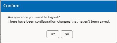

    Click the action you want when unsaved changes exist.
    This screen capture shows the confirmation dialog that the system displays after you click Log Out and unsaved changes exist.
