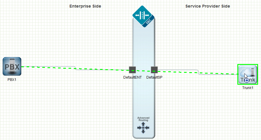

Network Configuration Using the Workspace Icons
You can configure the network by dragging-and-dropping the icons from the Device tool bar onto the Basic mode workspace below the titles of Enterprise Side and Service Provider Side. After you drop the icon onto the workspace, click the icon to display the corresponding configuration dialog.
The following steps describe the process for configuring a typical network by way of the Web GUI in Basic mode.
- Drag the PBX icon to the Enterprise Side, and complete the Add PBX dialog.
- Drag the SIP Trunk icon to the Service Provider Side, and complete the Add SIP Trunk dialog.
- Click the two-way Routing icon, click the center of the PBX icon, drag to the center of the SIP Trunk icon, and complete the Add Two-Way Route Information dialog.
- Click the Network button, click Network Interface, and confirm that the Network Interface on the Oracle® Enterprise Session Border Controller is correct on the Enterprise and Service Provider sides.
- Save and Activate the configuration.

Add a One-Way Local Routing Policy
You can perform the minimum configuration needed to add a one-way local routing policy to the Oracle® Enterprise Session Border Controller (E-SBC) from the Configuration tab in Basic mode.
- Note the IP addresses of the devices that you want to affect with this policy.
- Confirm that the system displays the Basic mode.
This procedure provides an example of creating a one-way local route policy between two network devices, the PBX and the Trunk. You can perform this procedure between other elements of the network, such as other Devices and Remote Workers.
Drag and drop the one-way routing icon from the device toolbar onto the PBX icon and connect it to the Trunk icon. The system displays the Add One-Way Route Information dialog, where you enter the local routing policy parameters. After you perform the configuration and click OK in the Add One-Way Route Information dialog. The one-way route icon persists on the workspace. You can edit the local policy configuration any time by double-clicking the icon and modifying the configuration in the Modify One-Way Route Information dialog box. Save and activate the configuration after the initial configuration and after modifying the configuration.
Add a Two-Way Local Routing Policy
You can perform the minimum configuration needed to add a two-way local routing policy to the Oracle® Enterprise Session Border Controller (E-SBC) from the Configuration tab in Basic mode.
This procedure provides an example of creating a two-way local route policy between two network devices, the PBX and the Trunk. You can perform this procedure between other elements of the network, such as other Devices and Remote Workers.
Drag and drop the two-way routing icon from the device toolbar onto the PBX icon and connect it to the Trunk icon. The system displays the Add Two-Way Route Information dialog, where you enter the local routing policy parameters. After you perform the configuration and click OK in the Add Two-Way Route Information dialog. The two-way route icon persists on the workspace. You can edit the local policy configuration any time by double-clicking the icon and modifying the configuration in the Modify Two-Way Route Information dialog box. Save and activate the configuration after the initial configuration and after modifying the configuration.
