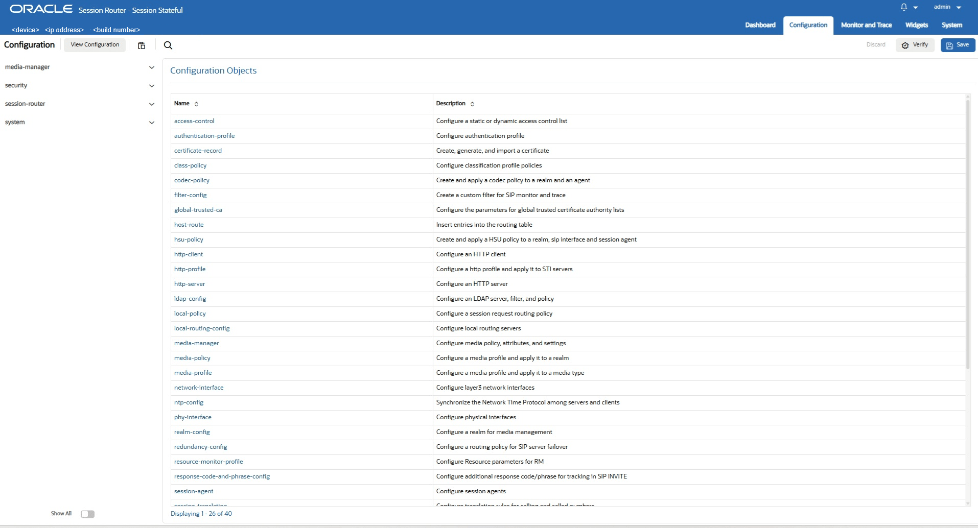

The Oracle® Enterprise Session Router Web GUI provides access to the dialogs and controls that you need to set up, administer, and maintain the configuration objects used on your Oracle® Enterprise Session Router through the Configuration tab.
The Configuration tab displays configuration objects in the navigation pane organized much like they are on the ACLI command line. When you click a top-level object in the navigation pane, the center pane displays the sub-objects in alphabetical order. You can also click the twister by the high-level object in the navigation pane to display an alphabetical list of the sub-objects in the navigation pane. The Configuration tab header displays the system identification at the left end of the banner and the Notifications alarm and the User menu at the right end of the banner. Below the banner, the page displays the controls for View Configuration, Search, Discard, Verify, and Save.

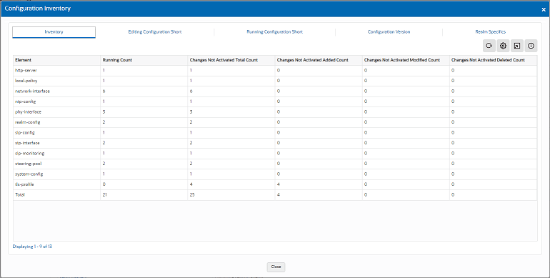

View the ESR Configuration Inventory
When you want to see aggregated information about the state of the configuration on the Oracle® Enterprise Session Router (ESR), click View Configuration on the Configuration tab. The Web GUI displays the Configuration Inventory page by default with tabs for the other views.
The following screen capture shows the default landing page after you click View Configuration.
When you set the process level or system log level to DEBUG, the Web GUI may not display any configuration information for large configurations when you click "View Configuration".
View Configuration Tabs
Inventory—Shows the Element list, Running Count, Changes Not Activated Total Count, Changes Not Activated Added Total Count, Changes Not Activated Modified Count, and Changes Not Activated Deleted Count.
Editing Configuration Short—Shows only the modified attributes in the editing configuration.
Running Configuration Short—Shows only the modified attributes in the running configuration.
Configuration Version—Shows the configuration version number table, which shows both the Current Version and the Running Version.
Realm Specifics—Allows you to set the Realm parameter and Auto Refresh interval.
Controls
Each tab, except for Realm Specifics, displays a set of controls in the upper right corner. The following list includes all of the available controls, but note that the controls vary per tab.
Refresh—Use to manually refresh the data on the tab.
Settings—Use to set the Auto Refresh Interval and to enable the option to Show Only Differences.
Download—Use to download data to the Configuration Inventory.
Description—Use to see a description of the view.

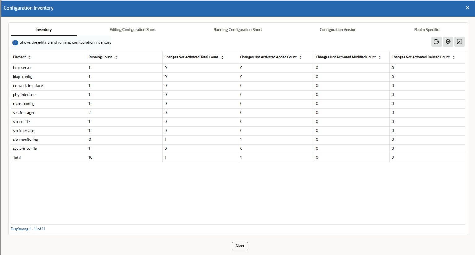

ESR Configuration Inventory View
When you want to see aggregated information about the state of the configuration on the Oracle® Enterprise Session Router, click View Configuration the Configuration tab. The Web GUI displays the Configuration Inventory page by default with tabs for the other views.
When you set the process level or system log level to DEBUG, the Web GUI may not display any configuration information for large configurations when you click View Configuration.
Controls

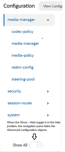

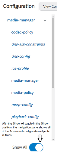

Show or Hide Advanced Configuration Objects in the Navigation Pane
Each category of configuration objects includes additional objects that are not required to complete a basic configuration. Such objects are called Advanced objects, which you use to customize your configuration. If you do not need to see the advanced objects, you can hide them from view with the Show All toggle located at the bottom of the navigation pane. The Show All toggle affects all categories of configuration objects. You can toggle between show and hide at anytime.
The following screen capture shows the navigation pane with the Show All toggle in the hide position. In this example, media-manager displays only five configuration objects because the Advanced configuration objects are hidden.
The following screen capture shows the navigation pane with the Show All toggle in the Show All position. The Web GUI displays the advanced elements in italics.

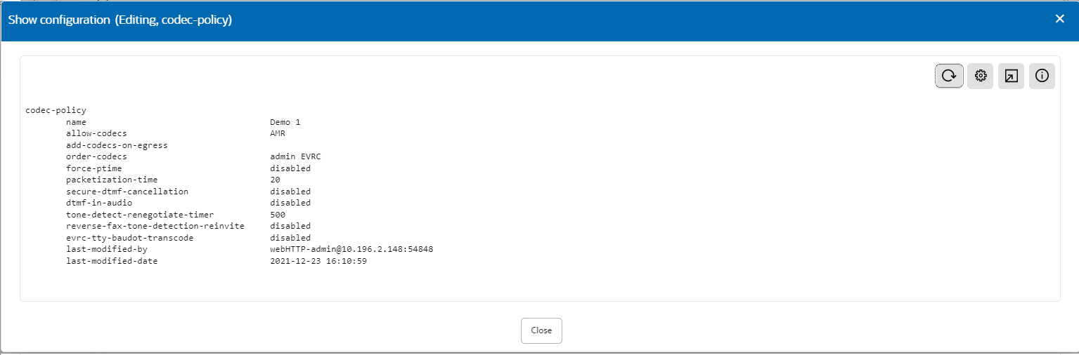

Show the Configured Parameters of a Configuration Object
After you add a new configuration or modify an existing one, you might want to view the settings to confirm your work before activation. Every configuration object includes the Show Configuration button in the title banner, which you can click to see the editing version of the configuration.
The following screen capture shows the Show
Configuration button, which is located at the right end
of the configuration object title banner.
The list shows only the parameters you edited.
Descriptions of the Show Configuration Controls
The Show Configuration page displays the following icons in the upper right corner that you can use to work with the configuration.

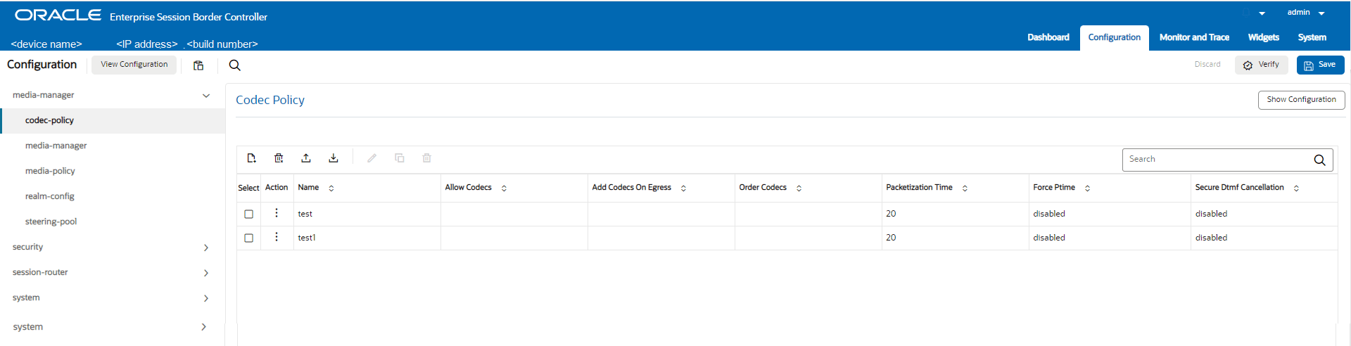

Controls for Managing Multi-instance Configurations
Some configuration objects allow you to create multiple instances of the configuration, which the system displays in a list on the configuration object landing page. You can manage multi-instance configuration objects with the buttons and controls displayed on the landing page and within the configuration dialog. Buttons display at the top of the dialog and controls display when you right-click elements of the configuration in the list.
Controls for Managing Configuration Lists
Web GUI configuration pages display controls for managing lists of multi-instance configurations. You can use certain controls to affect multiple instances, while others can affect only one instance at a time.

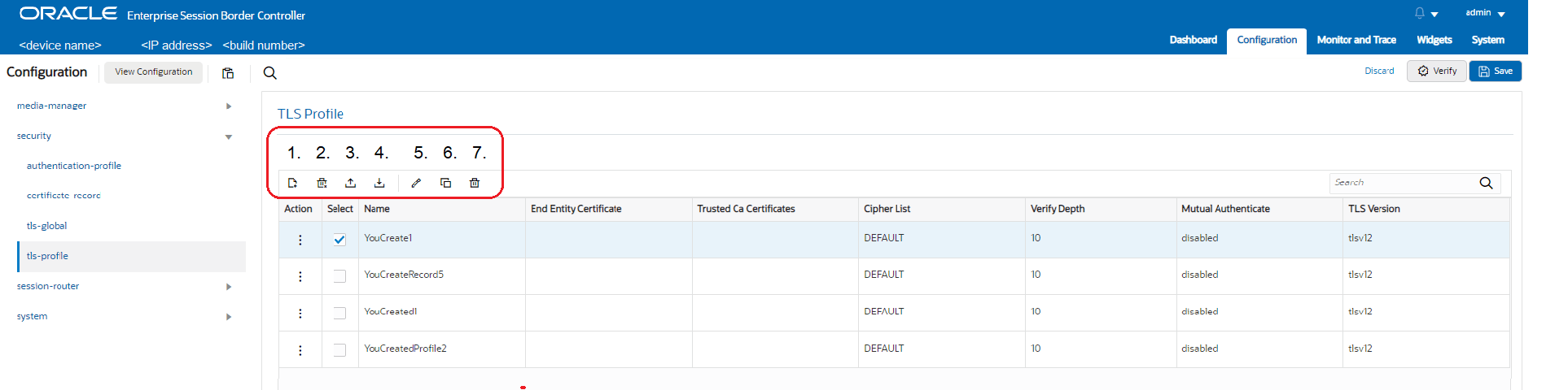

Global Controls
At the top of a multi-instance configuration list, the Web GUI displays the controls for managing the list. All the controls are active when you select a single row in the table. When you select multiple rows in a table, the system activates only the icons for supported actions. For example, when you select multiple rows, the Add, Delete, Upload, and Download icons remain activated. The system deactivates the Edit and Copy icons because those operations work on a single row, only.
1. Add—Click to add a configuration instance to the list.
2. Delete All—Click to delete all instances. You do not need to select the instances, just click the Delete All icon.
3. Upload—Click to upload one or more CSV configuration files to the configuration displayed.
4. Download—Click to download one or more configurations to a CSV file.
5. Edit—Click to edit the selected configuration.
6. Copy—Click to copy the selected configuration.
7. Delete—Click to delete the selected configuration.
When you Add, Edit, or Copy in a table, the table reloads and returns to the record you were on.Row Controls
You can also access the Edit, Copy, and Delete controls from a row in the list. Either click the ellipses or right-click the row. When you right-click, the menu also includes the sorting choices.
