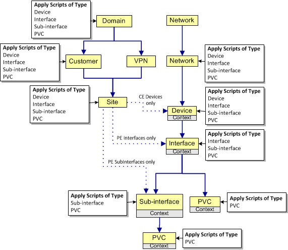

Figure 2-1 shows a diagram of device script inheritance.
In situations where more than one script applies to an object, no priority ordering is carried out. You should ensure that multiple scripts do not result in conflicts.

In addition to an object's local context, each object inherits specific context from its parent objects. For example, a PVC endpoint can potentially inherit context defined for its parent sub-interface device and network. Figure 2-1 shows the way in which driver scripts are inherited.

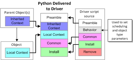

When a script is to install configuration, it is constructed and run in the following order:
Preamble section
Inherited context
Local context
Common section
Install section
Figure 2-2 shows how a concrete driver script to apply configuration is constructed.

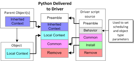

Scripts to Remove Configuration
When a script is designed to remove configuration, it is constructed and run in the following order:
Preamble section
Inherited context
Local context
Common section
Remove section
Figure 2-3 shows how a concrete driver script to remove configuration is constructed.
