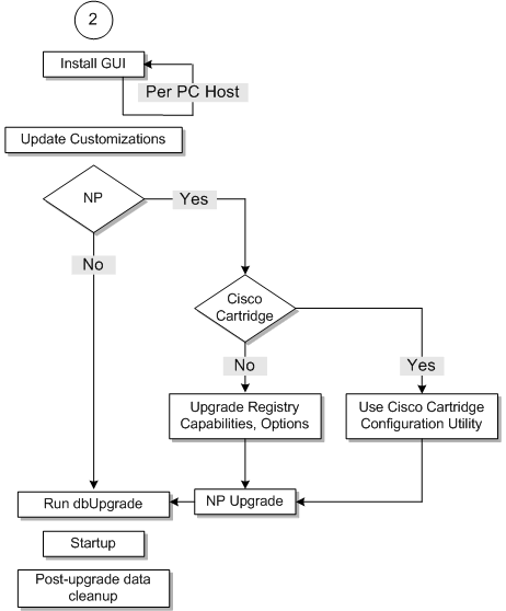

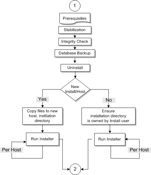

The flow charts in Figure 9-1 and Figure 9-2 illustrate the upgrade process.
Figure 9-1 IP Service Activator Upgrade Process: Stage 1
Description of "Figure 9-1 IP Service Activator Upgrade Process: Stage 1"
Figure 9-2 IP Service Activator Upgrade Process: Stage 2
Description of "Figure 9-2 IP Service Activator Upgrade Process: Stage 2"

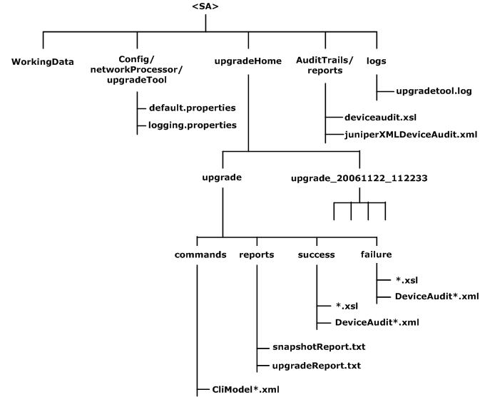

About Network Processor Upgrade Tool Script - npUpgrade
npUpgrade performs the following tasks after the new version of IP Service Activator is installed:
Sets up the database schema or modifies it if one exists
Transitions all the network processor device data to the new database schema
Computes the commands generated by the new network processor for each device
The following files are created by the Network Processor Upgrade tool:
Service_Activator_home/logs/upgradetool*.log
upgrade_home/upgrade/reports/upgradeReport.txt
upgrade_home/upgrade/success/DeviceAudit_componentId.xml
upgrade_home/upgrade/failure/DeviceAudit_componentId.xml
where:
Service_Activator_home is the IP Service Activator home directory (typically: /opt/OracleCommunications/ServiceActivator)
upgrade_home is a configurable location anywhere on the server (the default value is Service_Activator_home/upgrade_home)

See "Network Processor Upgrade Directory Structure" for more information.
Capabilities files, options files, and the cartridge registry are covered in a later step.
As well, you need to produce a new, merged version of the Service_Activator_home/Config/AutoDiscovery.cfg file. In the new file:
New entries that were added to the new file must remain in the new, merged file
Added and changed entries that were in the old file must be propagated to the new, merged file.
Entries commented out from the old file must also be commented out in the new, merged file.
Produce new, merged versions of other system configuration files. Compare the backed up version of the following files against the new installed versions. For each file, identify any custom changes that you need to carry forward (that you need to merge into the 7.4.0 version of the file). You can refer to the backed up versions of the files you created in "Backing Up IP Service Activator".
Files included in this process for network processor installations only:
Capabilities files. Once updated, copy these files to the following directory:
Service_Activator_home/ Config/networkProcessor/com/metasolv/serviceactivator/cartridges/vendor/capabilities/XMLfile
See "Updating Capabilities" for more information on upgrading capabilities files.
Any other files configuration files including those that were extracted from the cartridge .jar files and customized including:
logging.properties
default.properties
ErrorMessages.xml
SuccessMessages.xml
If your IP Service Activator old installation does not use the network processor, run the dbUpgrade script. For information, see "Running dbUpgrade to Upgrade the Database".
Updating Cartridge Registry (MIPSA_registry.xml)
To update the MIPSA registry:
Inspect the backed up version of the custom MIPSA_registry.xml file (from the Service_Activator_home/Config/NetworkProcessor directory) for custom entries.
If you have the Cisco IOS Cartridge, use the Cisco Cartridge Configuration Utility to generate an initial MIPSA_registry.xml file. For more information, see IP Service Activator Cisco IOS Cartridge Guide.
Create a copy of this file and edit the copy to create the new version of the MIPSA_registry.xml file that is compatible with the new IP Service Activator version. (See IP Service Activator System Administrator's Guide for details on creating or editing a cartridge registry file.) Following is an example for regex used in MIPSA_registry.xml:
<osVersion useRegex="true">(12.2.*\)T.*|12.2.*\)ZH.*|12.2.*\)B)</osVersion>
Update the retained custom entries so that each entry properly points to the intended Cartridge Unit directory. You can see the new version of the cartridge unit structure in the sample MIPSA_registry.xml file in:
Service_Activator_home/samples/vendorSampleRegistry.
After the MIPSA_registry.xml file is updated, copy the capabilities files to the locations as specified in the MIPSA_registry.xml file. The default location for capabilities files is Service_Activator_home/Config/networkProcessor.
If you are using IPv6 functionality, see IP Service Activator Installation Guide for release 5.2.4 for more information about consolidating capabilities.
You need to produce a new, merged version of the capabilities files. In the new files:
New entries that were added to the new files must remain in the new, merged files.
Added and changed entries that were in the old files must be propagated to the new, merged files.
Entries commented out from the old files must also be commented out in the new, merged files.
Some capabilities are now unused and will cause a validation failure of the capabilities.xsd file (at the device level). In order to avoid this, compare the capabilities in your old files with the capabilities in the capabilities.vsd file and remove any capabilities that are not in the capabilities.xsd file.
The following are examples of now unused capabilities:
- <caps:supports_gre_vpns> - <caps:ike_support> - <caps:ike_algorithms_supported> - <caps:dh_groups_supported> - <caps:supports_shared_keys> - <caps:ipsec_support> - <caps:esp_algorithms_supported> - <caps:ah_algorithms_supported> - <caps:compression_algorithms_supported> - <caps:ipsec_modes_supported> - <caps:ca_support> - <caps:supports_ca> - <caps:supports_ca_trusted_roots>
The error raised if capabilities files contain the above lines is similar to the example below:
20081119-165638|255|WARN|[main] (RegistryResourceLoader.java:42) - Resource failed validation should be valid: /opt2/OracleCommunications/ServiceActivator/Config/networkProcessor/cisco_12K_10K.xml:0: error: cvc-complex-type.2.4a: Expected elements 'saa_support@http://www.metasolv.com/serviceactivator/capabilities lasserre_support@http://www.metasolv.com/serviceactivator/capabilities vlan_support@http://www.metasolv.com/serviceactivator/capabilities' instead of 'supports_gre_vpns@http://www.metasolv.com/serviceactivator/capabilities' here in element device@http://www.metasolv.com/serviceactivator/capabilities . . . 20081119-165638|257|WARN|[main] (CartridgeLoader.java:1395) - Registration failure, registration entry: (resource=file:/opt2/OracleCommunications/ServiceActivator/Config/networkProcessor/MIPSA_registry.xml resourceName=com.metasolv.serviceactivator.cartridges.cisco.units.cu1.10008.12.0 line:-1). Unable to load file "cisco_12K_10K.xml"
If you are deploying the Cisco IOS Cartridge, you must generate the required options files. For more information, see the Cisco Cartridge Configuration Utility procedures in IP Service Activator Cisco IOS Cartridge Guide.
Edit the options entries in your custom file to point to the applicable customized options file for each device.
Save the changes.
An example options entry (in bold text) follows:
<cartridgeUnit> <name>[your_company_name].cisco.units.cu3.7505.12.2(25)S</name> <driverType>cisco</driverType> <deviceType>Cisco 7505</deviceType> <osVersion>12.2(25)S</osVersion> : <capabilities>com/metasolv/serviceactivator/cartridges/cisco/capabilities/cisco_default.xml</capabilities> <options>custom_options/cisco/7500-12.2_25_S_QoSoptions.xml</options> : </cartridgeUnit>
Remove the cartridge.cisco.saa.actionType.Nmvt.isDefault entry from the existing cisco options files before upgrading IP Service Activator.
Any previous changes made to the Service_Activator_home/Config/cisco_options.csv need to be reflected in the new cisco_options.csv files before regenerating the options using the Cisco Cartridge Configuration Utility. You must merge any changes to the version of the file that you backed up using the procedure in "Backing Up IP Service Activator".
Upgrading a CTM Template Schema to Version 4 or later
You can upgrade a template created in schema versions 1, 2, or 3. Do this by exporting the file and then re-importing the file back into a new CTM template.
See Design Studio Modeling Activation online Help for information about how to import and export a template file.
Upgrade Tools
The Network Processor upgrade and database upgrade tools are installed with the IP Service Activator Installer. Perform the activities in this section to configure upgrade properties, and to run the upgrade.
If you are not running the Network Processor, you can run the dbUpgrade script. For more information, see "Running dbUpgrade to Upgrade the Database".
Network Processor on Multiple Servers
The npUpgrade script runs against the database. If you have the IP Service Activator Network Processor installed on multiple servers:
If they all use the same database connection parameters (as specified in the Configuration GUI), you need to run npUpgrade only once.
If they use different database connection parameters, you need to repeat the Network Processor Upgrade once for each Network Processor database.
Running npAdmin to Update Network Processor Internal Data
This section provides information about how to update the Network Processor version in the database after upgrading to a new version of the IP Service Activator.
To complete this operation, you need the database connection details used by the IP Service Activator.
To update the Network Processor version in the database:
Run the npAdmin script.
Enter the following command to retrieve the current version number of the processor:
bash-3.2$ ./npAdmin.sh get_version
Enter the following command to update the version number of the network processor:
bash-3.2$ ./npAdmin.sh set_version 7.5.0
The following warning appears:
Warning! This will modify the Network Processor internal data. Do you want to continue? (yes/no):
Enter yes.
Enter your username and password.
To confirm the update, enter:
The version is updated.
Running npUpgrade: Network Processor Upgrade Script
This section provides information about running the Network Processor upgrade script.
In order to improve the performance of this process, set the log level for npUpgrade to info in the following file:
Config/networkProcessor/upgradeTool/logging.properties
To run the npUpgrade script:
Run the npUpgrade script.
As the IPSA_admin_unix_account user, enter:
cd Service_Activator_home/bin npUpgrade.sh -allNote:
Do not run the npUpgrade script unless all required cartridges and service cartridges are installed.
Review the Service_Activator_home/upgradeHome/upgrade/reports/upgradeReport.txt file for errors.
Check the upgradetool.log for errors.
Refer to the reference sections at the end of this chapter for information about how to handle errors you encounter in the upgrade report or log files:
If you receive an error when running the npUpgrade tool on a Linux server, you must make sure that the Linux setup library is installed. See "Problem Running npUpgrade on Linux" for more information.
Running Failure Analysis on npUpgrade Results
To analyze the Device Audit files for those devices identified as upgrade failures:
Copy the contents of the upgrade_home/upgrade/failures directory to a separate workstation with a browser.
For each device identified as an upgrade failure, open its DeviceAudit.xml file, check for red text, and analyze it against the failure cases listed in "Performing Post-Upgrade Data Cleanup". (Certain red text entries are acceptable.)
If the upgrade of some devices fails, the devices must be unmanaged in IP Service Activator before the next Network Processor restart. To unmanage the failed devices, start all the IP Service Activator components except the Network Processor(s), unmanage the devices that have failed upgrades, then start the Network Processor(s). You can then deal individually with the devices with failed upgrades without affecting other devices. To obtain help dealing with these failures, Oracle recommends that you contact Oracle GCS for assistance using the service request process. Attach a .zip file containing the contents of the upgrade_home/upgrade/failures directory to the service request.
When problem devices have been fixed, you can use the npUpgrade script with appropriate options to upgrade individual devices, or a specified list of devices. For example:
Usage: npUpgrade.sh [-all] | [-device ipAddress1,ipAddress2,*] | [-file filename] | [-help] Example 1: npUpgrade.sh -device 10.13.3.158,10.13.4.120 where the -device value can be one device IP address, or a comma-separated list of device IP addresses Example 2: npUpgrade.sh -file <filename> where <filename> contains a list of device IP addresses, with one IP address per line. <filename> must include the relative path from <upgradeHome>.
Figure 9-3 shows the directory structure of the files involved in the upgrade (assuming default file locations).
Figure 9-3 Network Processor Upgrade Directory Structure
Description of "Figure 9-3 Network Processor Upgrade Directory Structure"
