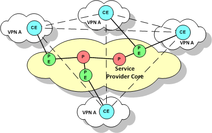

The number of tests performed depends on the VPN's topology and whether the probe properties are set to half or full duplex:
In a fully-meshed VPN, IP Service Activator tests the connection between each pair of sites, as shown in Figure 2-2.
Figure 2-2 Connection Tests in a Fully-Meshed VPN
Description of "Figure 2-2 Connection Tests in a Fully-Meshed VPN" -

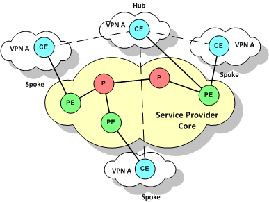

In a hub and spoke VPN, IP Service Activator tests the connection between the hub site and each spoke site, as shown in Figure 2-3.
Figure 2-3 Connection Tests in a Hub and Spoke VPN
Description of "Figure 2-3 Connection Tests in a Hub and Spoke VPN"If there are multiple hub sites and they are meshed, IP Service Activator also tests the connection between each pair of hub sites.

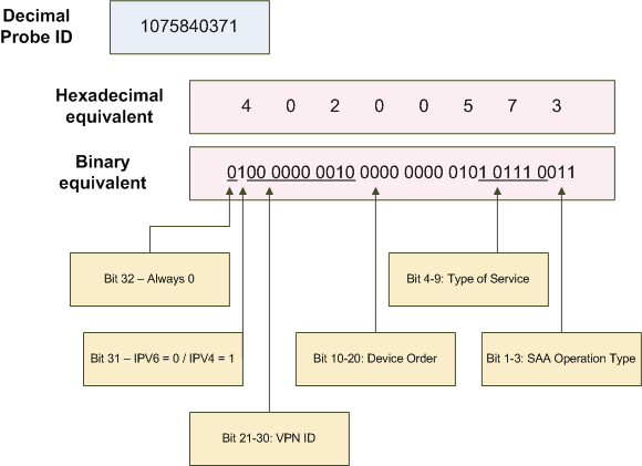

The following is a breakdown of the SAA probe calculation method. Figure 2-8 demonstrates how the calculation is broken down into its components and Table 2-1 explains the individual components.
Figure 2-8 Example of SAA Probe Calculation
Description of "Figure 2-8 Example of SAA Probe Calculation"
Table 2-1 Components of the SAA Probe Calculations
| Component | Description |
VPN ID |
This is taken from the VpnId attribute of the SAA VPN object. |
Device order |
This is taken from the VpnOrder attribute of the hub-site concrete object in the SAA VPN. |
Type of service |
This is the DSCP value for the class of probe. |
SAA Operation type |
This is the value for the type of operation. |

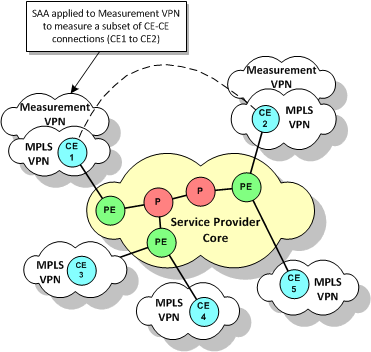

A measurement-only VPN allows you to apply SAA to a subset of devices in an MPLS VPN or to apply SAA without configuring an MPLS VPN. A measurement-only VPN can be used to:
Group a subset of devices that belong to an MPLS VPN and apply SAA to those devices.
This enables you to measure the connection between selected devices in an MPLS VPN, where the size of the VPN or its topology makes measuring all connections unfeasible.
Figure 2-9 illustrates this concept. All CE devices are members of an MPLS VPN. To reduce the number of operations configured, however, only the connection between CE1 and CE2 is measured. This is achieved by overlaying the MPLS VPN with a measurement-only VPN and applying SAA to the measurement-only VPN.
Figure 2-9 Measurement-only VPN Overlay

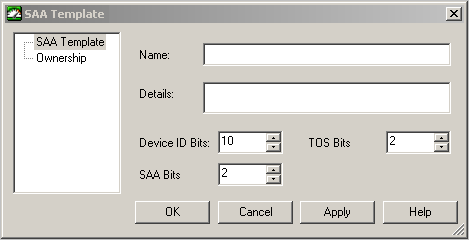

SAA Measurement is configured in IP Service Activator by defining an SAA template that holds one or more SAA operations and applying the template to a VPN.

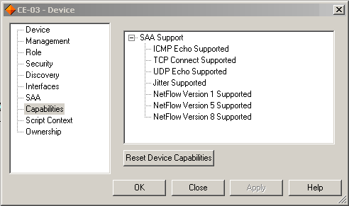

Check the device's capabilities to determine which operation types are supported. The operation types can be found on the device object's Properties page in the Capabilities section, as shown in Figure 2-10.

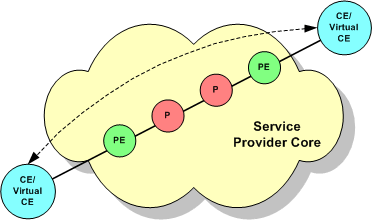

Configuring SAA for a CE to CE Connection

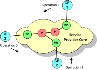

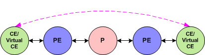

By deploying SAA on CE devices (or Virtual CEs), as shown in Figure 2-11, you can capture information about the complete end-to-end performance of a VPN service.
You can only test a CE to CE connection where one or both CE devices are managed. An unmanaged device may be modelled as a virtual router and a one-way test performed. See "Unmanaged Devices".
There are two alternatives for monitoring a CE to CE connection:
Apply SAA to the MPLS VPN: this setup is feasible only in some scenarios. See "Configuration Considerations" and "MPLS VPN".
Overlap an MPLS VPN with a measurement-only VPN populated by a subset of the CE devices and apply SAA to the measurement-only VPN

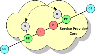

Configuring SAA for a PE to PE Connection using Shadow Routers
PE to PE measurement provides information about the performance across the network backbone.
To collect PE to PE metrics, you must deploy shadow routers. In IP Service Activator, a shadow router behaves in a similar way to a CE device: it may be associated with a site and have a VRF table associated with it, a protocol may be specified for connection to the PE device, and so on.
IP Service Activator includes a system-defined Shadow role which must be assigned to the shadow devices. For information about assigning a role to a device, see IP Service Activator User's Guide.
Figure 2-12 SAA for PE to PE Connections using Shadow Routers
Description of "Figure 2-12 SAA for PE to PE Connections using Shadow Routers"
The PE device to which a shadow router is attached may participate in more than one MPLS VPN, where each VPN belongs to a different customer. If you wish to view performance metrics per customer in IP Service Activator using an integrated reporting tool, you must create a measurement-only VPN for each customer. Populate the measurement-only VPN with the relevant shadow routers and apply SAA to the VPN.

Configuring SAA for a PE to CE Connection using a Shadow Router
PE-CE metrics provide information about the connection between the service provider's POP and a customer site. A shadow router must be deployed at the PE device, as shown in Figure 2-13.
Figure 2-13 SAA for PE to CE Connections using a Shadow Router
Description of "Figure 2-13 SAA for PE to CE Connections using a Shadow Router"
If the CE device is not managed it is possible to test the connection to it by modelling the device as a virtual router. See "Unmanaged Devices".

Creating an SAA Template
By default, an SAA template has the following:
A maximum of 1024 devices that can participate in the VPN
A maximum of 4 Type of Service (ToS) values that can be used within the VPN
A maximum of 4 operation types that can be applied to the VPN
However, you can adjust these VPN-specific limits by specifying the amount of space that IP Service Activator allocates to store device, ToS value, or operation type data.
Figure 2-14 Adjusting the SAA Template Values
Description of "Figure 2-14 Adjusting the SAA Template Values"
By adjusting the values of Device ID Bits, TOS Bits, and SAA Bits, you can increase the number of devices within the VPN, the number of operations, or the number of operation types that can be applied. The values specified for these three fields must add up to exactly 14. If you choose to increase the number of bits allocated to the device ID, you must reduce either the number of bits allocated to the ToS value or the SAA operation type.
If you want to apply more than one operation to a single peer-to-peer connection in a VPN, you must ensure that either the ToS value or the operation type differs between the operations. This is because IP Service Activator bases each operation's unique RTR (Round Time Response) number on the ToS value and operation type (in combination with other types).
To create an SAA template:
On the System tab, right-click the SAA Templates folder.
Select Add SAA Template.
The SAA Template dialog box opens.
Specify values including Name, Details, Device ID Bits, TOS Bits, and SAA Bits.
Click OK and commit the transaction.

Creating a Measurement-only VPN
You can use SAA to measure the point-to-point connection between any pair of devices without configuring an MPLS VPN.
To apply SAA without configuring an MPLS VNP:
Apply the appropriate roles to the relevant devices.
You can associate devices tagged with the Access or Shadow role with sites in a VPN.
Associate each device with a site. For Virtual CE measurements, you also associate the Virtual CE to the site.
You do not need to associate an interface with the site.
If needed, specify the device's (or Virtual CE's) SAA destination and source measurement address as follows:
Open the Device/Virtual CE dialog box.
Select the SAA property page. Note that attributes on the Virtual CE SAA property page are different than those on the Device SAA property page.
Configure Measurement Probe Destination Address in one of two ways:
Select Use device management address to use the device management IP address set up on the Device property page as the SAA destination measurement address.
Select Use, and from the list choose one of the interfaces previously discovered on the device.
Configure Measurement Probe Source Address in one of four ways:
Select Use Measurement Probe Destination Address to use the Measurement Probe Destination Address as the Measurement probe source address in the device.
Select Use Device Management Address to use the Device Management Address as the Measurement probe source address in the device.
Select Use and from the menu select an address from the other available addresses in the device as the Measurement probe source address.
Select Not configured to avoid configuring the Measurement probe source address in the device.
Select Use and select an IP address from the list of interfaces that have been discovered by the device.
For each site:
Right-click the site and select Properties from the menu.
The Site dialog box opens.
Select the Connectivity property page.
In the Routing Type field, select None.
Create a VPN by right-clicking the VPN folder and selecting Add MPLS VPN from the menu.
Ensure that the Use MPLS option on the VPN property page of the VPN dialog box is cleared to effectively create a measurement-only VPN.
Add the relevant sites to the VPN.
