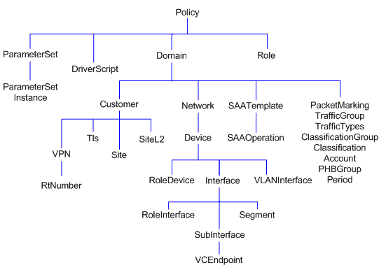

Object Hierarchy
The following diagrams illustrate the basic structure of the object hierarchy for navigation purposes.

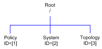

Figure 4-1 shows the Root object hierarchy. Note the standard ID numbers for these objects.
Figure 4-2 shows the Policy object hierarchy.

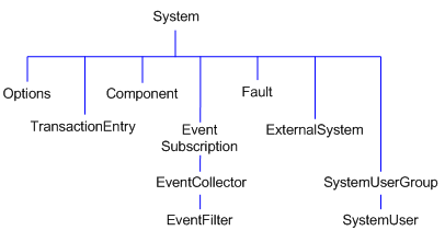

Figure 4-3 shows the System object hierarchy.
Figure 4-4 shows the Topology object hierarchy. Note that whenever further objects are created or existing objects linked they appear as children of the appropriate object. For example, if a rule is created at the device level it appears as a child of the device, or if a PE interface is linked to a site, it will appear as a child of the site.

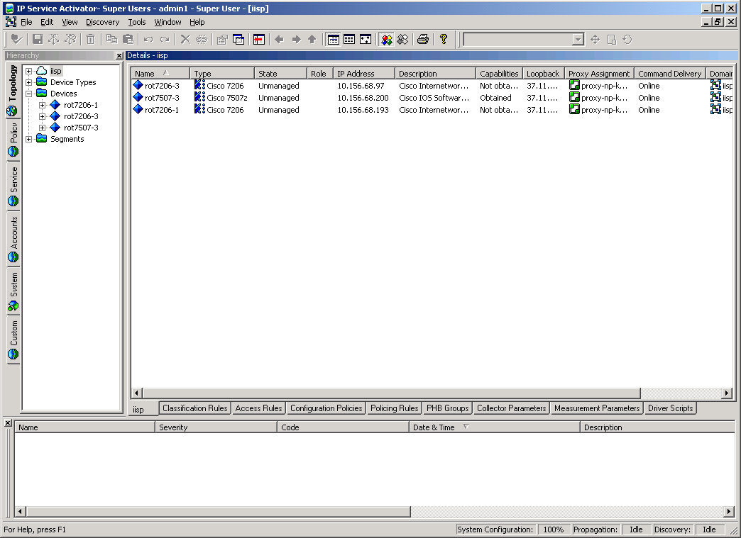

discover device-idExample
In this example, three devices are discovered within a network (ID=18)
discover [18] IpAddress=10.0.0.91 AccessStyle=anonymous LoginPassword=cisco EnablePassword=cisco discover [18] IpAddress=10.0.0.92 AccessStyle=anonymous LoginPassword=cisco EnablePassword=cisco discover [18] IpAddress=10.0.0.93 AccessStyle=anonymous LoginPassword=cisco EnablePassword=cisco />GetChildren [18] [2707] Device:"rot7206-1" [2731] Device:"rot7206-3" [2799] Device:"rot7507-3"
The user interface is as in Figure 4-6.
The three devices appear as children of the network object. As part of the discovery, any role assignment rules that have been set up using the user interface will also be applied to the newly-discovered objects.

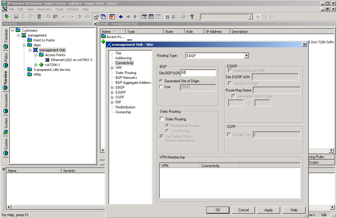

Next the routing protocol for the site should be set to EBGP, and the BgpAsn attribute is set to a nominal value (in this case 60).
modify Site:"Management Hub" RoutingProtocol=EBGP BgpAsn=60 commit

Figure 4-7 shows that a customer and a site have been created. The Connectivity properties page shows that the ASN has been correctly set.
Figure 4-7 The Connectivity Properties Page
Description of "Figure 4-7 The Connectivity Properties Page"

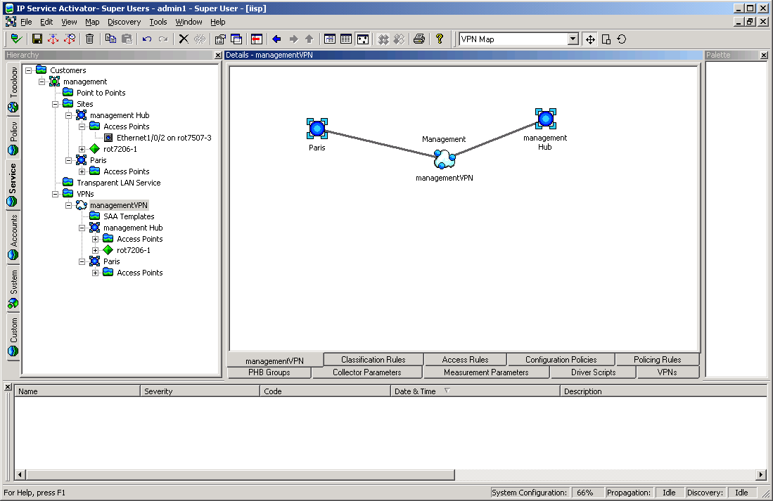

Figure 4-8 shows the management VPN containing the two sites.

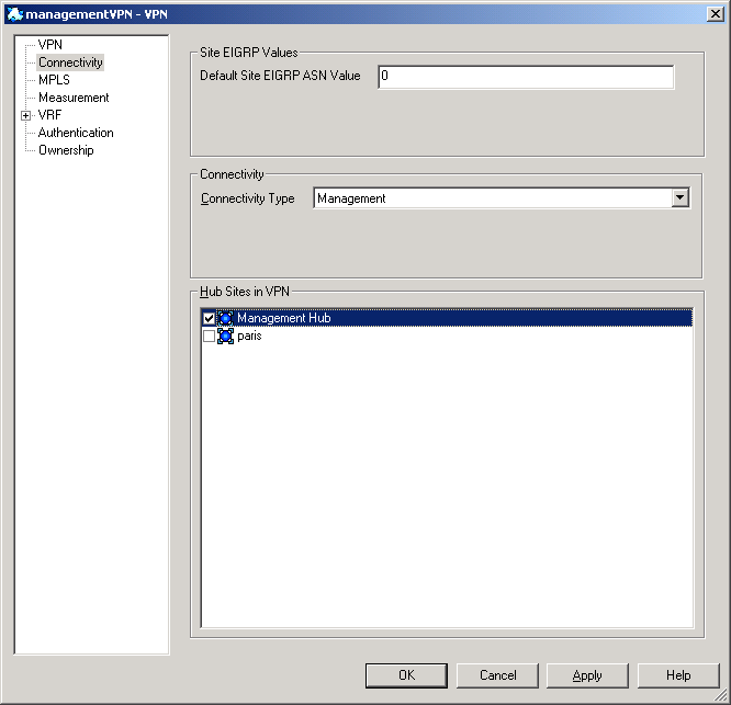

Figure 4-9 shows the properties box of the VPN, showing that “Management Site" is a hub, and “Paris" is a spoke.

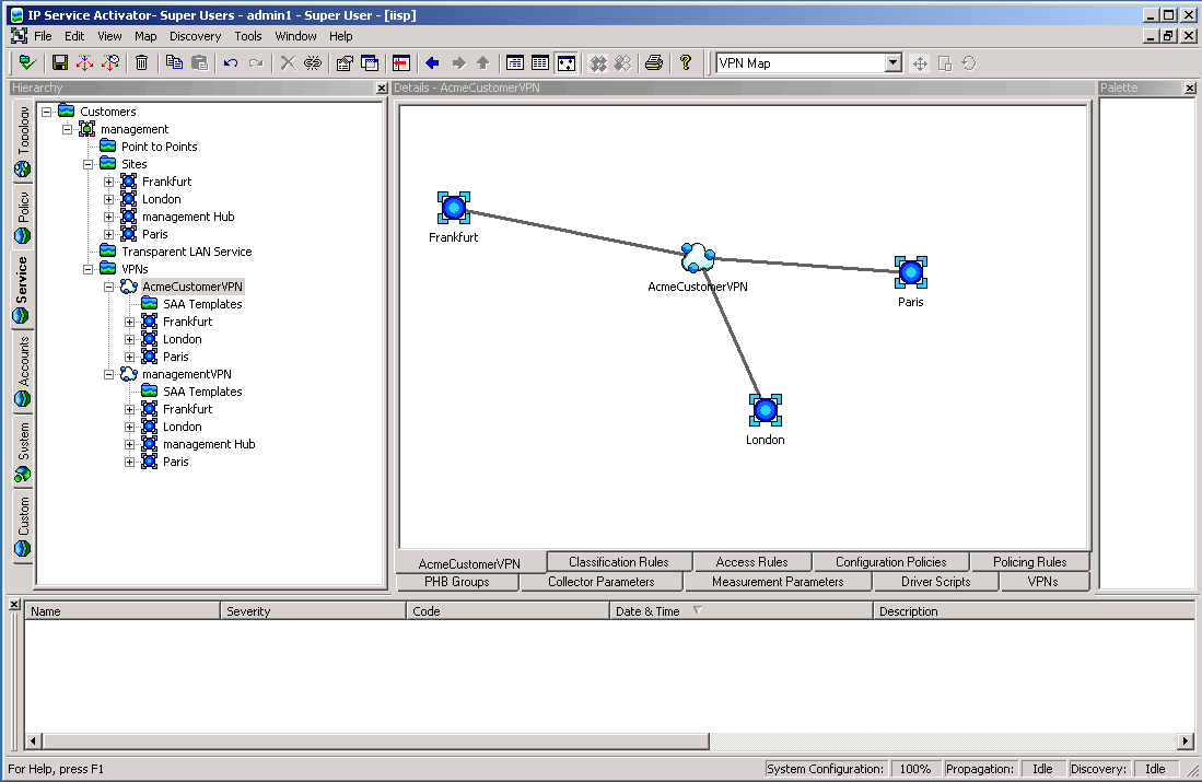

This example creates a full mesh VPN containing three customer sites (assumed to be already created, but not yet linked to the management VPN).
OIM Commands
First a VPN object is created as a child of Customer 1 (ID=3012).
setPath [3012] create VPN:"Acme Customer VPN" commit
The VPN is defined as full mesh:
modify VPN:"Acme Customer VPN" MplsVpnType=FullMesh commit
The three customer sites are linked to the VPN object:
link VPN:"Acme Customer VPN" Site:"London" link VPN:"Acme Customer VPN" Site:"Paris" link VPN:"Acme Customer VPN" Site:"Frankfurt" commit
The three customer sites are also linked to the management VPN (ID=3084).
link [3084] Site:"London" link [3084] Site:"Paris" link [3084] Site:"Frankfurt" commit
Figure 4-10 shows the Customer VPN containing three sites.

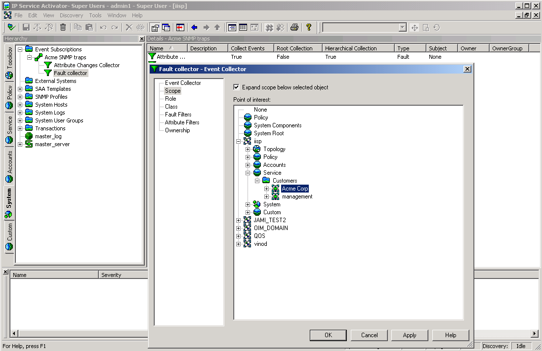

Figure 4-14 shows that an EventSubscription object and two EventCollector objects have been created. The dialog box shows that the “Attribute Changes" EventCollector object's scope is defined as the Acme Corp customer.
