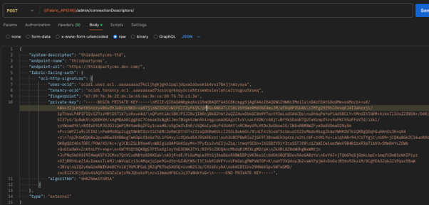

| OCIHttpSignature |
"system-descriptor": "thirdpartycms-ttd",
"endpoint-name": "thirdpartycms",
"endpoint-url": "https://thirdpartycms.dev.com/",
"fabric-facing-auth": {
"oci-http-signature": {
"user-ocid": "ocid1.user.oc1..aaaaaaaaz7kcljhgkjgkhlpqljdqxwlobuvmi64vxr7bkjjnmzysya",
"tenancy-ocid": "ocid1.tenancy.oc1..aaaaaaaad7ioxocqnkeqydccehtrswmbsievlnhie2rrqguu5ruxq",
"fingerprint": "67:39:76:36:2f:de:1e:65:6e:3e:ce:03:75:7d:c1:3e",
"private-key": "-----BEGIN PRIVATE KEY-----\\n+pIkanDm==\\n-----END PRIVATE KEY-----",
"algorithm": "SHA256withRSA"
"type": "external"

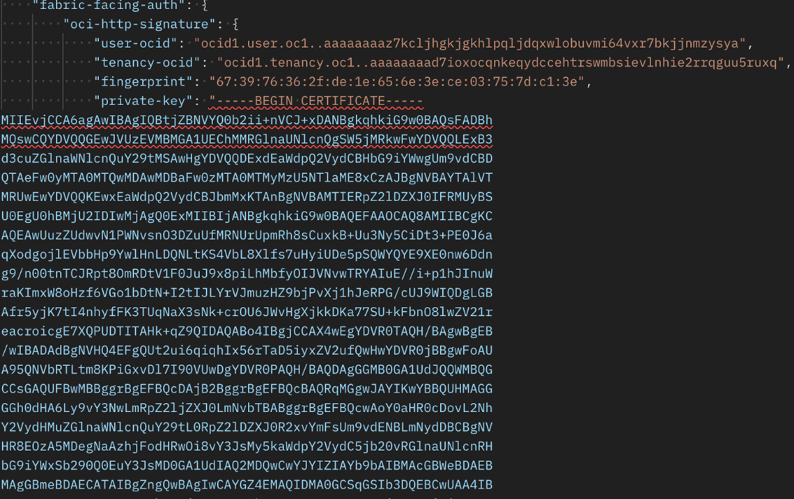

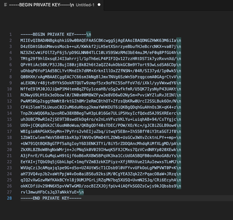

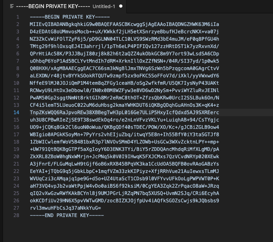

In the case of OCIHttpSignature, the postman or other similar tools may not accept the value of “private-key” with multiline (will error out like below image).- Open the text editor and paste the private key.
Figure 5-2 Step for Formatting Private Key

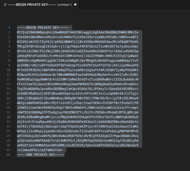

- All the line ends would have an additional line break empty character (see below
image).
Figure 5-3 Private Key with additional line break empty character

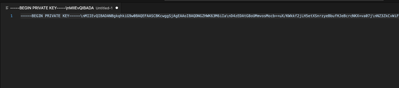

- Append “\n” to the end of each line (see below image).
Figure 5-4 Private Key with Appended with \n
- Now make the entire string single line.
- Now use the same value in request.

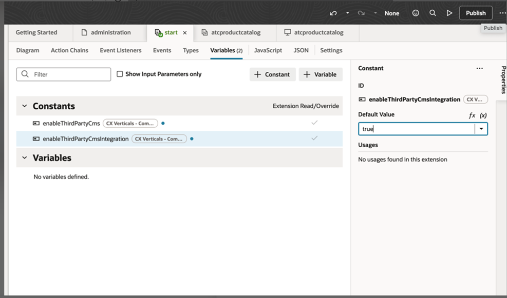

Enable Third Party CMS in Visual Builder Studio

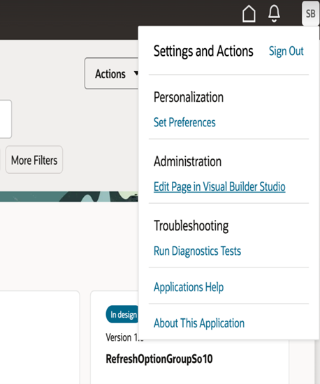

- Login to LaunchX UI as a user with admin role.
- Click the profile icon and then open VB studio by clicking Edit Page in Visual Builder Studio.

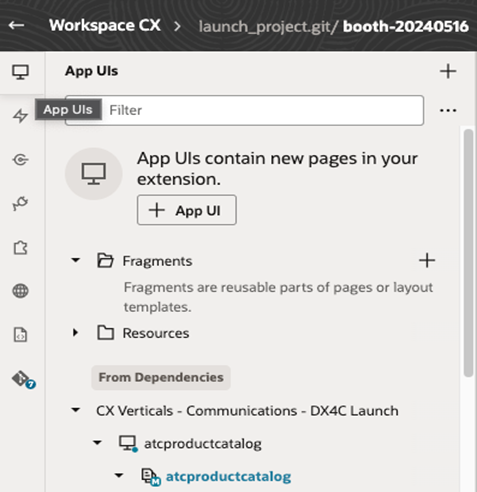

- In the Visual Builder Studio, ensure that you are on the App UIs section by clicking the monitor icon as shown in Figure 5-8.
- Click the second atcproductcatalog.
- Find the file containing the enableThirdPartyCmsIntegration variable (usually a configuration or constants file).
- Change the value of enableThirdPartyCmsIntegration to true.
- Click Publish to save and apply the changes.
Figure 5-9 Publishing Page in Visual Builder Studio
