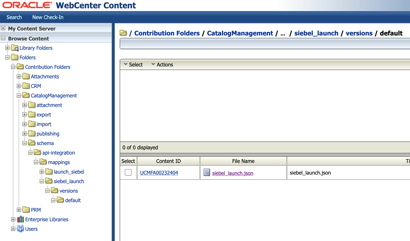

- Get the mapping file with extension changes done in current release from Fusion
"Content Store" default version folder using below endpoint.
GET - {{FA_APIGW}}/mappingSchema/cx/industry/apiIntegration/v1/mappingSchema- Headers to be passed:
- X-Source-System : <<sourceName>>
- X-Target-System : <<targetName>>
FA_APIGW in the endpoint is Fusion Application API Gateway.
- Verify the response of the above GET endpoint. It should have all the mapping extension done in current release. Save the response of the above GET endpoint to a file in your local machine.

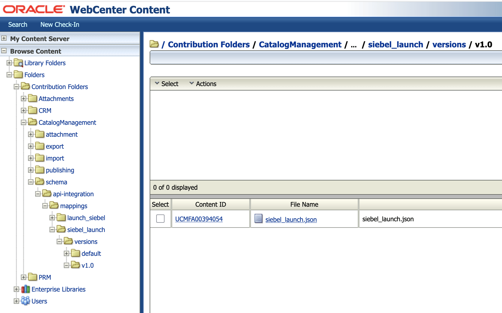

- Create a folder with another version say v1.0 in Fusion "Content Store" having
backup of the above saved mapping file with added extensions using below
endpoint:
PUT - {{FA_APIGW}}/mappingSchema/cx/industry/apiIntegration/v1/mappingSchema- Headers to be passed:
- X-Version : v1.0
- Body to be passed:
- File : <<file saved in earlier step to be uploaded here>>
Figure 8-2 Version 1.0 Folder in Fusion Content Store

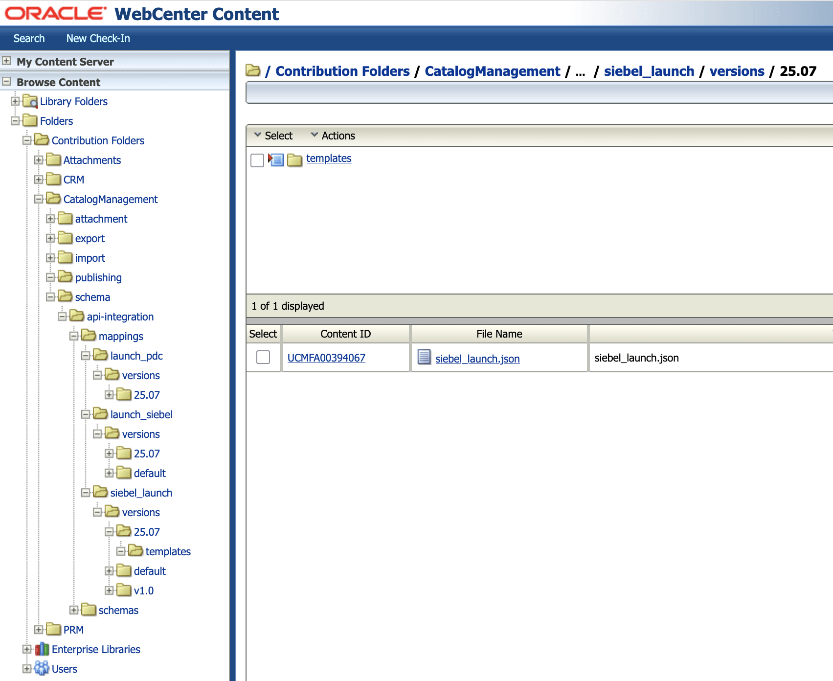

- Invoke the below endpoint and create mapping files and templates
shipped by Oracle for next release (current + 1) in Fusion "Content Store". The
response status code for endpoint should be 200 with no response body. See Figure 8-3 for Content Store structure for changes done after the endpoint is run
successfully. This endpoint creates a new folder under versions with name taken
from VERSION file shipped as part of mapping service. The release version is
stored in the VERSION file. For example 25.01, 25.04, 25.07, 25.10, and so on.
Endpoint : {{FA_APIGW}}/mappingSchema/cx/industry/apiIntegration/v1/loadSeedFilesMethod Type: GET
Figure 8-3 Version 25.07 Folder in Fusion Content Store

Once the file is updated in UCM (Content Store), do a get call to verify if the file is updated correctly in UCM.
Endpoint : {{FA_APIGW}}/mappingSchema/cx/industry/apiIntegration/v1/mappingSchema
Method Type: GET
Headers to be passed:- X-Source-System : siebel
- X-Destination-System : launch
Another way to verify if the file is updated in UCM is by logging in to UCM (Content Store) in web browser. Download the file from UCM and verify the file content.
Once the mapping file is updated and content is verified, start migrating the data from Siebel to Launch.
Method Type: GET
Headers to be passed:- X-Source-System : launch
- X-Destination-System : siebel
Another way to verify if the file is updated in UCM is by logging in to UCM in web browser. Download the file from UCM and verify the file content.
Once the mapping file is updated and verified, start publishing the data from Launch to Siebel.
