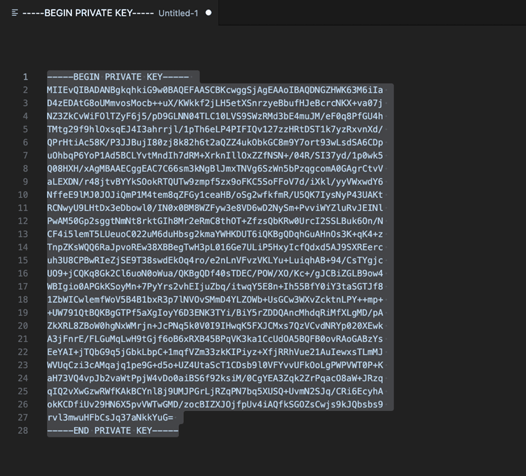

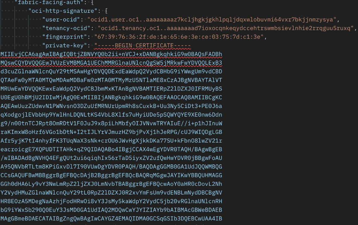

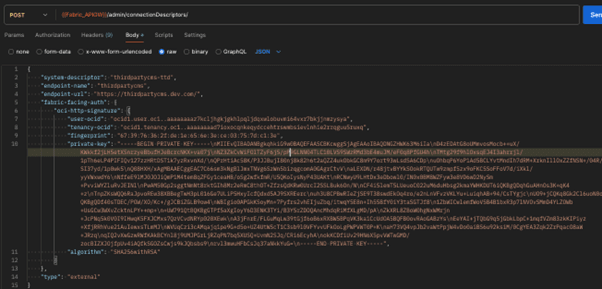

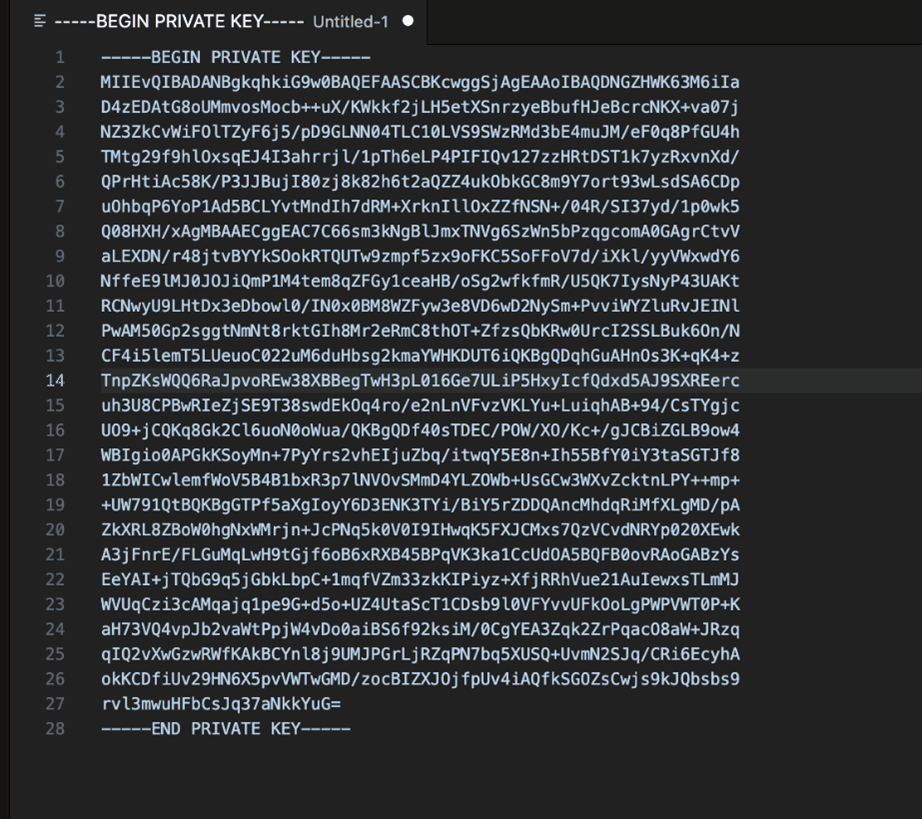

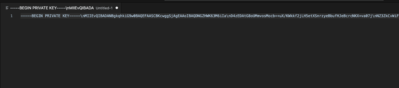

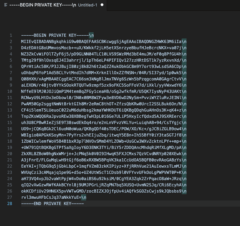

In the case of OCIHttpSignature, the postman or other similar tools may not accept the value of “private-key” with multiline (will error out as shown in Figure 8-1).
Figure 8-1 Error for OCIHttpSignature
To get around this, format the private key as follows:

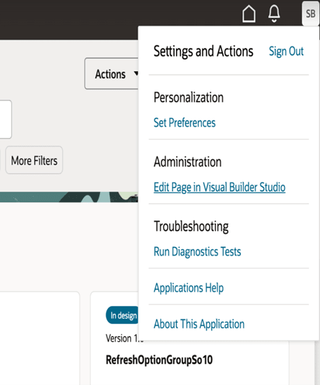

  1. Log in to the Launch UI as a user with admin role.
  2. In the Launch UI, click your profile icon.
  3. Click Edit Page In Visual Builder Studio to open Visual Builder Studio.
    Figure 8-7 Profile Menu in Launch UI

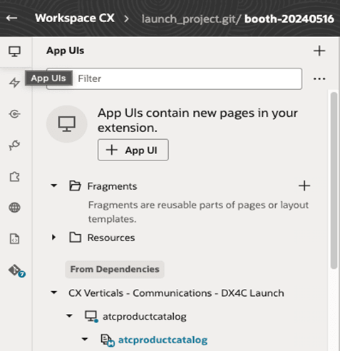

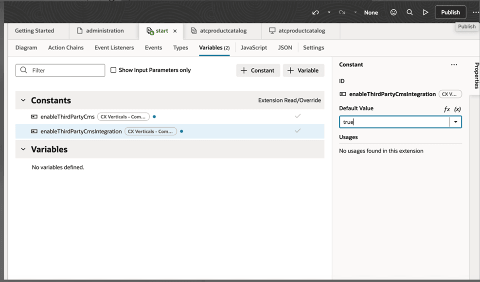

  4. In the Visual Builder Studio, ensure that you are on the App UIs section by clicking the monitor icon as shown in Figure 8-8.
    Figure 8-8 Visual Builder Studio
  5. Click the second atcproductcatalog.
  6. Find the file containing the enableThirdPartyCmsIntegration variable (usually a configuration or constants file).
  7. Change the value of enableThirdPartyCmsIntegration to true.
    Figure 8-9 Configuring enableThirdPartyCmsIntegration
  8. Click Publish to save and apply the changes.
