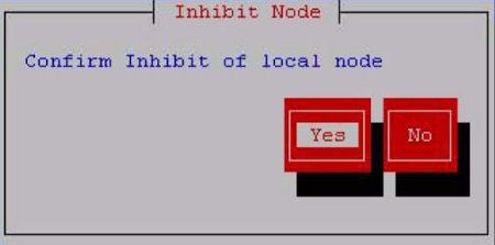

  2. From the main lsmsmgr interface, select Maintenance, and then Inhibit Node.
    The lsmsmgr interface displays the window shown in Figure 6-8.
    Figure 6-8 Inhibit a Non-Active Server
    img/t_inhibiting_a_standby_server_mm-fig1-r13.jpg
  3. Ensure that the Yes button is highlighted and press Enter.

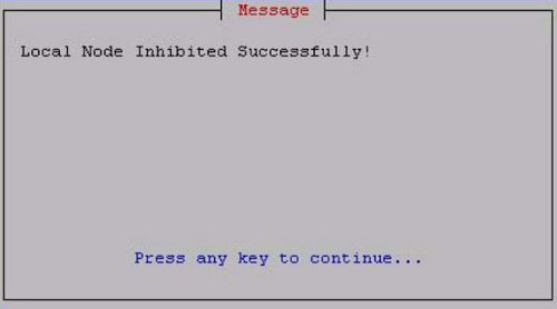

  4. When the server has been completely inhibited, the lsmsmgr interface appears again. Press any key to continue.
    Figure 6-9 Node Successfully Inhibited
    img/t_inhibiting_a_standby_server_mm-fig2-r13.jpg
    The lsmsmgr main menu is displayed again.
Do not allow this server to remain in UNINITIALIZED "INHIBITED" state any longer than necessary. As soon as possible, perform the procedure described in perform the procedure described in “Starting a Server” to change the state of the server to STANDBY state so that it is available if automatic switchover is needed or if manual switchover is desired.
