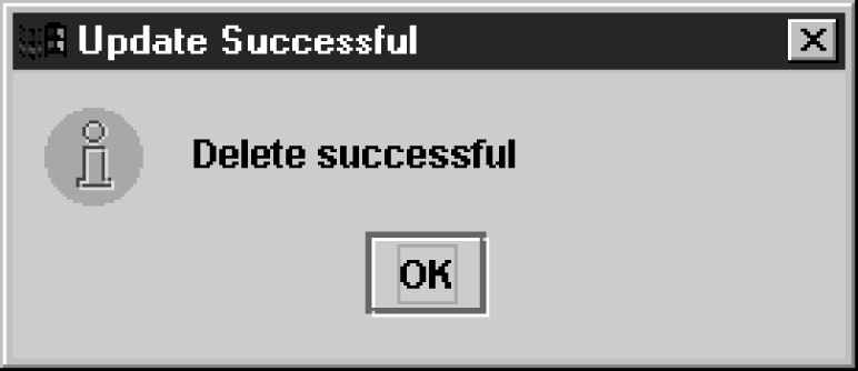

  6. Click Yes or No.
    If you click Yes, an Update Successful message window appears. Click OK to return to the Service Provider Administrative Data Report Delete window.
    Figure 5-3 Update Successful Message Window
    img/t_deleting_a_service_provider_administrative_data_report_dam-fig3.jpg

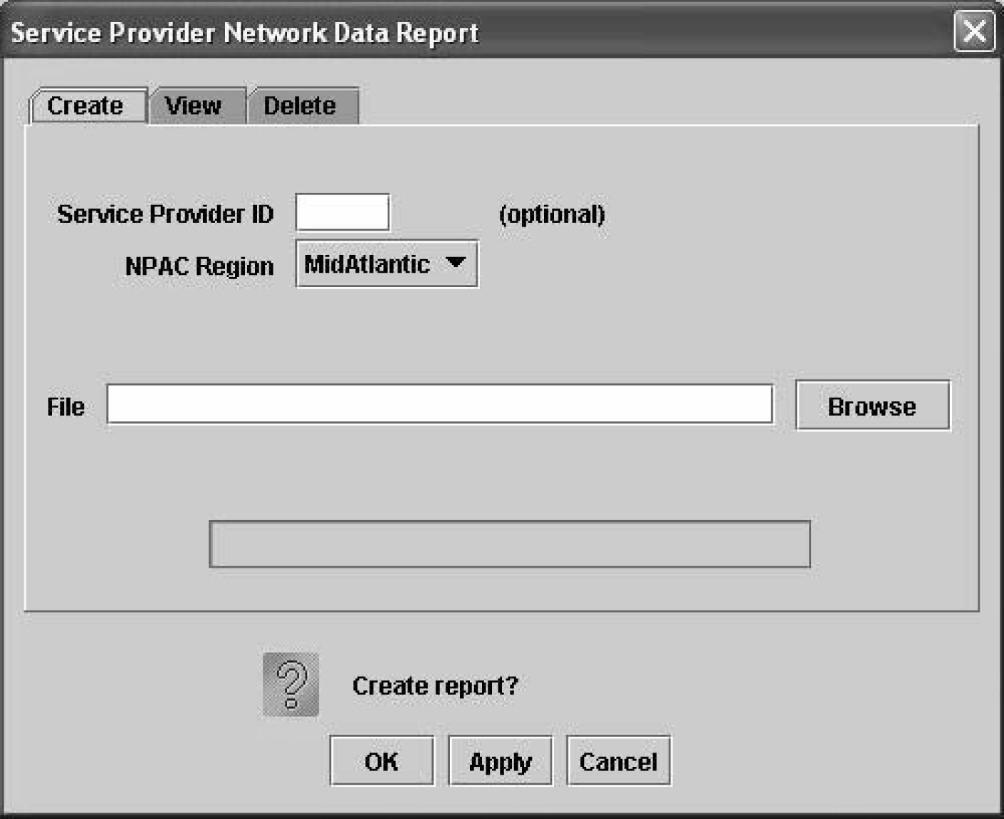

5.3.1 Creating a Service Provider Network Data Report
To create a Service Provider Network Data report:
  1. Log in to LSMS as a member of the permission group that is authorized to perform this operation.
  2. From the LSMS Console window, select Reports, and then Service Provider Network Data .
    The Service Provider Network Data Report Create window appears.
    Figure 5-4 Service Provider Network Data Report Create Window
    img/t_service_provider_network_data_reports_dam-fig1.jpg
  3. In the Service Provider ID field, enter the Service Provider ID (SPID), if desired (this field is optional).
    See Creating a Permission Group Data Report for the report contents that are selected and displayed depending upon whether you specify a value for the optional SPID parameter.
    Table 5-1 Using the Optional SPID Parameter (Service Provider Network Data Report)
    SPID Value Specified? Report Contents Displayed
    N
    All LRN, NPA-NXX, and NPA-NXX-X records
    Y
    LRN, NPA-NXX, and NPA-NXX-X records containing specified SPID value only

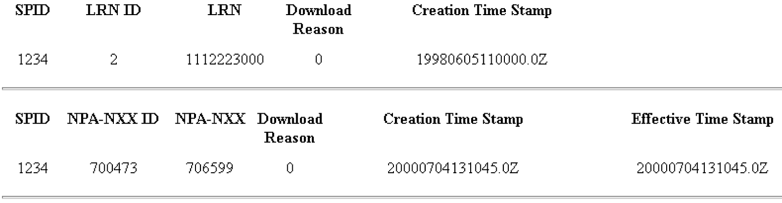

  4. In the File field, enter a file name for the report to be generated.
    Click OK or Apply. The report automatically runs in background mode and does not interfere with LSMS processing tasks such as NPAC traffic processing.
  5. An Update Successful message window appears.
  6. Click OK to view an example of the report.
    A Service Provider ID value of UNKN indicates that the Service Provider information for the particular object could not be found because of an object relationship mismatch. If this occurs, call the My Oracle Support (MOS).
    Figure 5-5 Service Provider Network Data Report Example
    img/t_service_provider_network_data_reports_dam-fig2.jpg

5.6.1 Creating an Override GTT Data Report
To create an Override GTT Data report:
  2. From the LSMS Console window, select Reports, and then Override GTT.
    The Override GTT Data Report Create window appears.
    Figure 5-8 Override GTT Data Report Create Window
    img/t_creating_an_override_gtt_data_report_dam-fig1.jpg
  3. Make a selection from the Service Provider ID listbox.
    In the DPC (Destination Point Code) field, enter a specific destination point code, if desired (this field is optional). See Table 5-3 for the report contents that are selected and displayed depending upon whether you specify a value for the optional DPC parameter.
    Table 5-3 Using the Optional DPC Parameter (Override GTT Report)
    DPC Value Specified? Report Contents Displayed
    N
    Override Translation records containing specified SPID value only
    Y
    Override Translation records containing specified SPID and DPC values only
    Figure 5-9 Override GTT Report Example
    img/t_creating_an_override_gtt_data_report_dam-fig3.jpg

5.6.3 Deleting an Override GTT Data Report
To delete an Override GTT Data report:
  3. Select the Delete tab.
    The Override GTT Data Report Delete window appears.
  4. In the File field, enter the name of the report to be deleted or click the Browse button to select a report.
    Click OK or Apply.
  5. A Confirm Delete message window appears.
  6. Click Yes or No.
    If you click Yes, an Update Successful message window appears. Click OK to return to the Override GTT Data Report Delete window.
  7. If you click No, you return to the Override GTT Data Report Delete window.

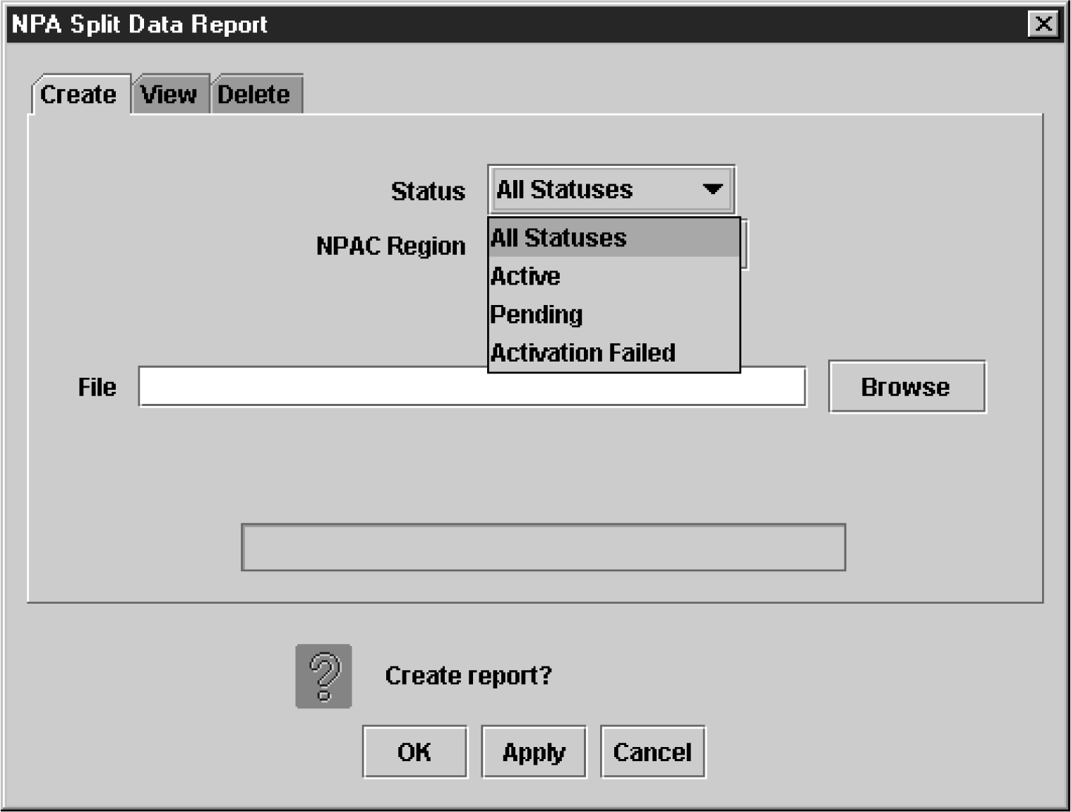

5.7 NPA Split Data Reports
The following procedures explain how to create, view, and delete NPA Split Data reports.
5.7.1 Creating NPA Split Data Reports
To create an NPA Split Data report:
  2. From the LSMS Console window, select Reports, and then NPA Split Data, and then select Create.
    The NPA Split Data Report Create window appears.
  3. In the Status field, select the appropriate status.
    The options available are All Statuses, Active, Pending, and Activation Failed.
    Figure 5-10 NPA Split Data Report Statuses
    img/t_creating_npa_split_data_reports_dam-fig2.jpg
  4. In the NPAC Region field, select the desired region (or All NPAC Regions) for which you require information.
    Figure 5-11 NPA Split Data NPAC Regions
    img/t_creating_npa_split_data_reports_dam-fig3.jpg
  5. In the File field, enter a file name for the report to be generated.
  6. An Update Successful message window appears.
  7. Click OK to view an example of the report.

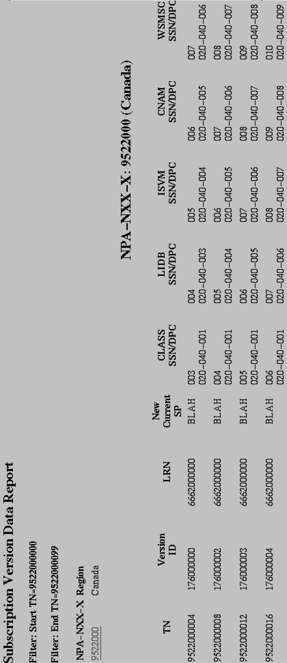

5.9 LSMS Subscriptions by LRN Reports
The following procedures explain how to create, view, and delete LSMS Subscriptions by LRN reports.
5.9.1 Creating an LSMS Subscription by LRN Report
To create an LSMS Subscription by LRN report:
  2. From the LSMS Console window, select Reports, and then LSMS Subscriptions by LRN Data.
    The LSMS Subscriptions by LRN Report Create window appears.
  3. In the Local Routing Number field, if desired, enter the LRN of the subscriptions to be reported.
    This is an optional field.
  4. In the TN Range field, if desired, enter the TN range.
    1. If no TN range is specified, then all Subscription Version records that satisfy the LRN filter are displayed, regardless of its TN.
    2. If only the Start TN is specified, then all Subscription Version records with a TN equal to the Start TN, and that satisfy the LRN filter (if any), are displayed.
    3. If both the Start TN and End TN are specified, then all Subscription Version records with a TN between the Start TN and the End TN, and that satisfy the LRN filter (if any), are displayed.
    Figure 5-13 LSMS Subscriptions by LRN Report Example
    img/t_creating_an_lsms_subscriptions_by_lrn_reports_dam-fig2.jpg

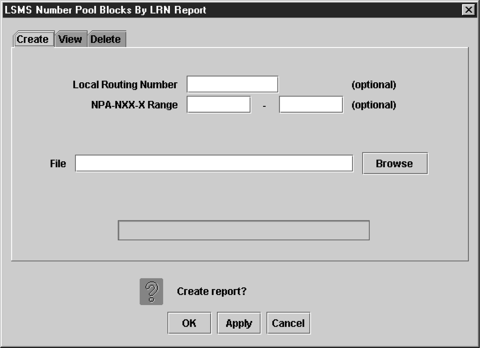

5.11.1 Creating an LSMS Number Pool Block by LRN Data Report
To create an LSMS Number Pool Block by LRN Data report:
  2. From the LSMS Console window, select Reports, and then LSMS Number Pool Blocks by LRN Data.
    The LSMS Number Pool Blocks by LRN Report Create window appears.
    Figure 5-16 LSMS Number Pool Blocks by LRN Report Create Window
    img/t_creating_an_lsms_number_pool_blocks_by_lrn_data_reports_dam-fig1.jpg
  4. In the NPA-NXX-X Range field, enter the appropriate information.
    The NPA-NXX-X Range field is optional.
    1. If no NPA-NXX-X range is specified, then all Number Pool Block records that satisfy the LRN filter are displayed, regardless of its NPA-NXX-X.
    2. If only the Start NPA-NXX-X is specified, then all Number Pool Block records with a NPA-NXX-X equal to the Start NPA-NXX-X, and that satisfy the LRN filter (if any), are displayed.
    3. If both the Start NPA-NXX-X and End NPA-NXX-X are specified, then all Number Pool Block records with a NPA-NXX-X between the Start NPA-NXX-X and the End NPA-NXX-X, and that satisfy the LRN filter (if any), are displayed.
    Figure 5-17 LSMS Number Pool Blocks by LRN Report Window
    img/t_creating_an_lsms_number_pool_blocks_by_lrn_data_reports_dam-fig2.jpg
5.11.2 Viewing an LSMS Number Pool Block by LRN Data Report
To view an LSMS Number Pool Block by LRN Data report:
  3. Select the View tab.
    The LSMS Number Pool Blocks by LRN Report View window appears.
  4. In the File field, enter the name of the report to be viewed or click the Browse button to select a report.
    Click OK or Apply.
  5. The report output window displays.
  6. Click Yes or No.
    If you click Yes, an Update Successful message window appears. Click OK to return to the LSMS Number Pool Blocks by LRN Report Delete window.

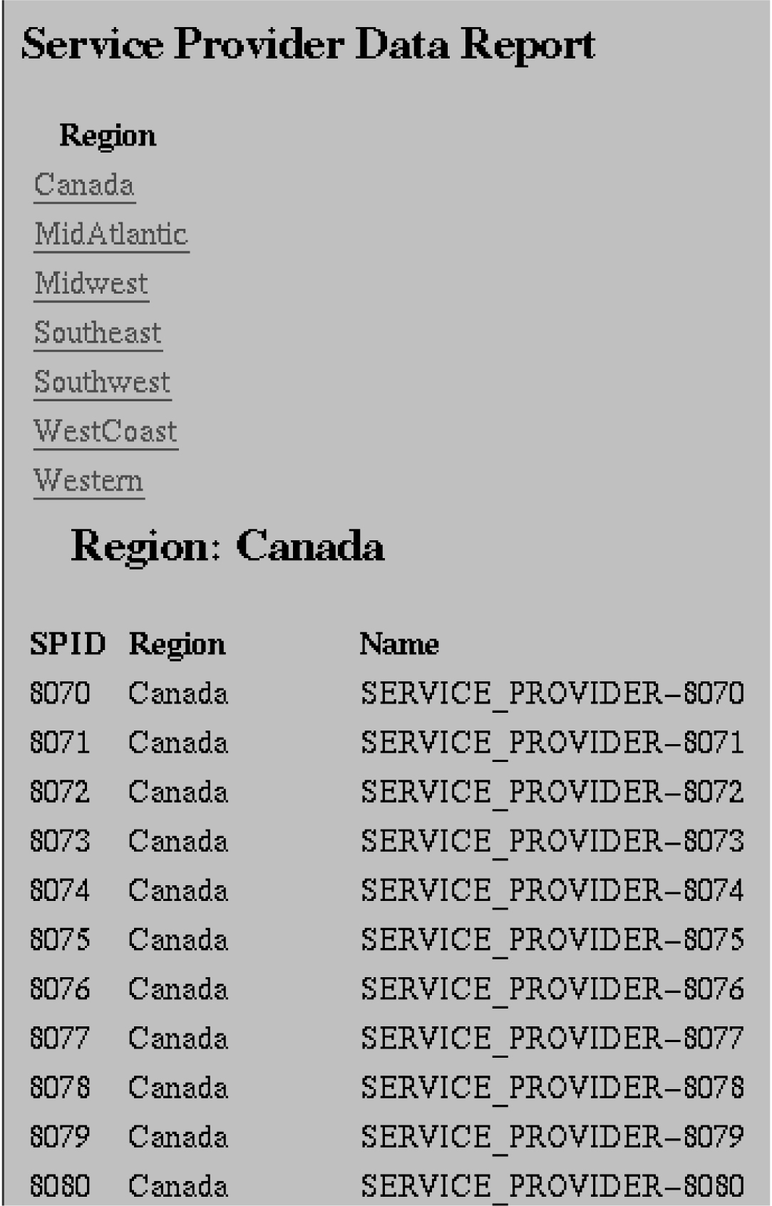

    Figure 5-20 Service Provider Data Report Create Window
    img/t_creating_a_service_provider_data_report_dam-fig1.jpg
  3. In the NPAC Region field, select the desired region (or All NPAC Regions) for which you require information.
    Figure 5-21 Service Provider Data Report NPAC Regions
    img/t_creating_a_service_provider_data_report_dam-fig2.jpg
    Figure 5-22 Service Provider Data Report Window
    img/t_creating_a_service_provider_data_report_dam-fig3.jpg
