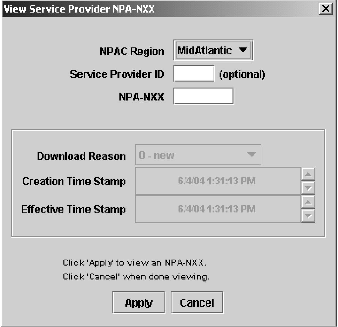

3.4.2 Viewing an NPAC Service Provider NPA-NXX
To view a service provider NPA-NXX:
  1. Log in to LSMS as a member of the permission group that is authorized to perform this operation.
  2. From the LSMS Console window, select NPAC, and then Service Provider NPA-NXX, and then View.
    The View Service Provider NPA-NXX window appears.
    Figure 3-11 View Service Provider NPA-NXX Window
    img/t_viewing_an_npac_service_provider_npanxx_dam-fig1.jpg
  3. Select the desired NPAC region from the pull-down menu.
  4. Optionally, enter the Service Provider ID (maximum four alphanumeric characters).
  5. Enter the NPA-NXX value (six numeric characters required; no spaces, hyphens, or underscores).
  6. Click Apply when the information is complete.
    The Download Reason, Creation Time Stamp, and Effective time Stamp information is returned to the window.
    • The Download Reason box describes the reason that the NPA-NXX was last modified.
      The reason codes are:
      • 0 = new
      • 1 = delete
      • 2 = modify
      • 3 = audit discrepancy
    • The Creation Time Stamp is the date and time that the NPA-NXX was created.
    • The Effective Time Stamp is the date and time that the last modification took effect.
  7. After viewing the information, click Cancel.
