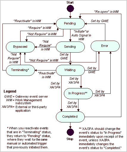

Figure 2-1 provides a view of the lifecycle of event statuses from the point of view of the MetaSolv Solution, and illustrates the function of the Gateway Event server.
Figure 2-1 State Transition Diagram for Gateway Events
Description of "Figure 2-1 State Transition Diagram for Gateway Events"

Gateway Events Through Integration Server
Gateway Events through integration server continuously check the MSS database for events that are ready to be sent to an external application. The integration server also monitors the external application for updates to the status of a gateway event. When an external application sends a status update, the integration server records the new status in the MSS database.
In case of a cluster environment, Oracle recommends that you copy the integration.xml file (with added integration events) to any CORBA gateway event server (EVENTPROC) appserver to ensure that the CORBA gateway event server does not pick up the integration gateway events.
The following sections describe how to create a gateway event for communication between MSS and an external application.
Creating a Gateway Event
To create a gateway event:
Create a new gateway event.
For example: xxx_order_event.
This is done in the Gateway window in MSS. MSS creates a gateway event and assigns an event ID.
Query for the event ID associated with the gateway event, using the following SQL:
select gateway_event_id, gateway_event_nm from asap.gateway_event ge where gateway_event_nm like = <APIGatewayName>
In this case, APIGatewayName is the name associated with the event.
Configure the event by make the following entries in the integration.xml file located at MSLV_Home/appserver:
<handler enabled="true"> <event-id><YourGatewayEventID></event-id> <class>com.mslv.integration.handlers.DefaultEventHandler</class> <destination>api</destination> </handler>where YourGatewayEventID is the gateway eventID generated in step 2.
Restart the MSS application server.
Outbound Events
All outbound events are published to a JMS queue, mss.external.event.queue, using the JMS Factory MSS.QueueConnectionFactory. The following list indicates how outbound events can be subscribed to:
Clients (both, third-party systems not on WebLogic and Oracle clients) can subscribe to the JMS queue externally and receive all events.
Products using SOA can subscribe to the queue through a channel and use event-name-based filtering to trigger appropriate workflows.
Locating Help Information On Gateway Events
Open the Gateway Events window in MSS.
On the navigation bar, select Application Setup, and then click Work Management Setup.
The Work Management Setup window is displayed.
Click Gateway Events.
The Gateway Events window is displayed.
Press F1 for Help.
The Help window for the Gateway Events window is displayed. There are a number of links on this window that explain gateway events and how to create them.
