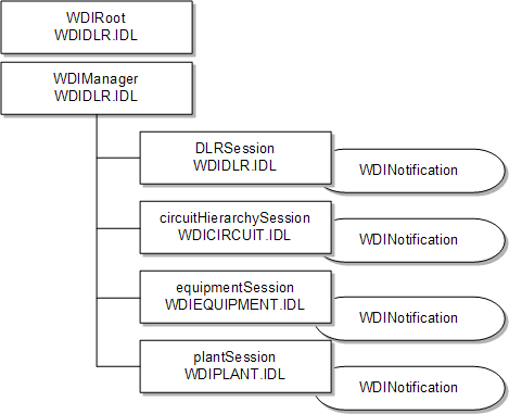

Plant API Interface Relationships
Figure 8-1 illustrates the relationship of the Plant API interfaces.
Figure 8-1 Plant API Interface Relationships
