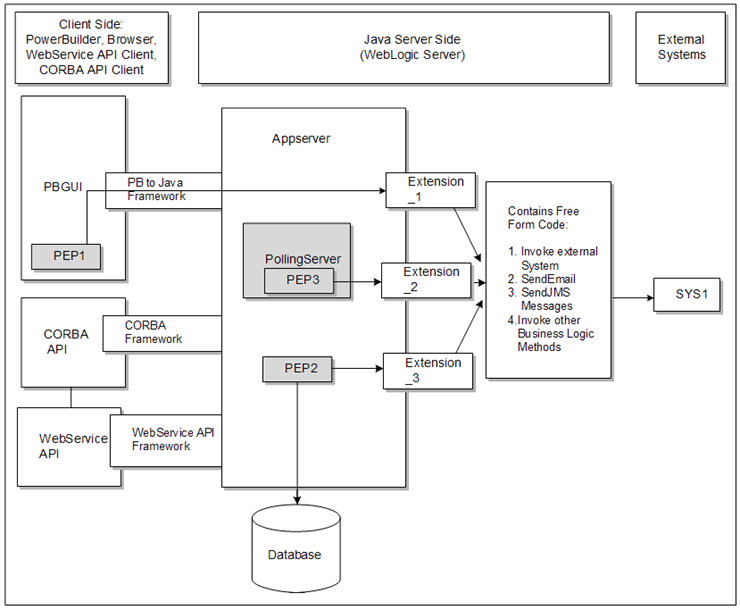

After you define the extension, associate the execution point, and code the logic for your custom extension, it is invoked from one or more of the places listed below. The invocations are dependent upon the execution points associated with your extension.
Figure 1-1 shows the architecture of MetaSolv Solution and how the various system components interact to support custom extension functionality.
Figure 1-1 Architecture Supporting Extension Functionality
Description of Figure 1-1 follows
Description of "Figure 1-1 Architecture Supporting Extension Functionality"
